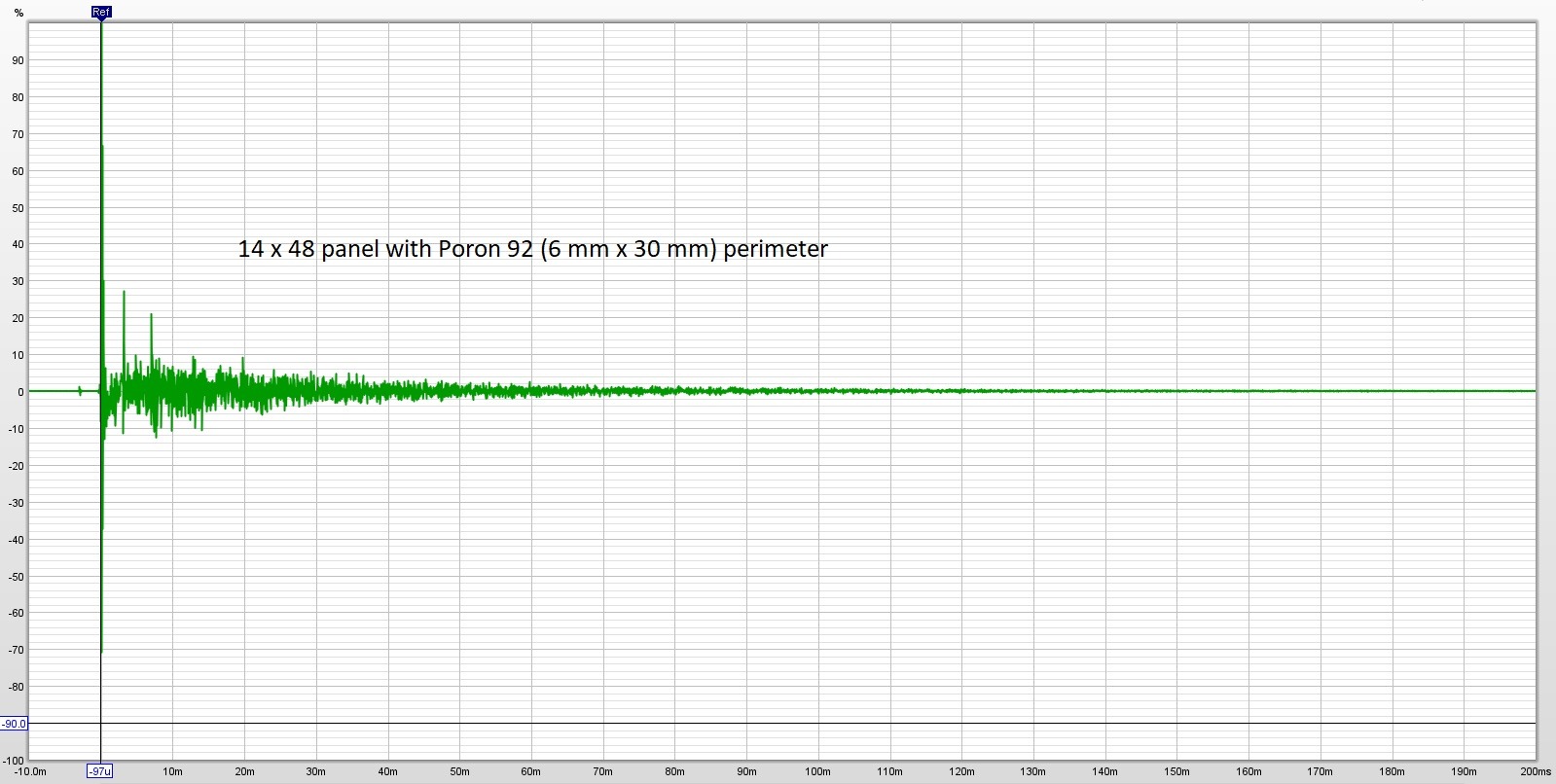

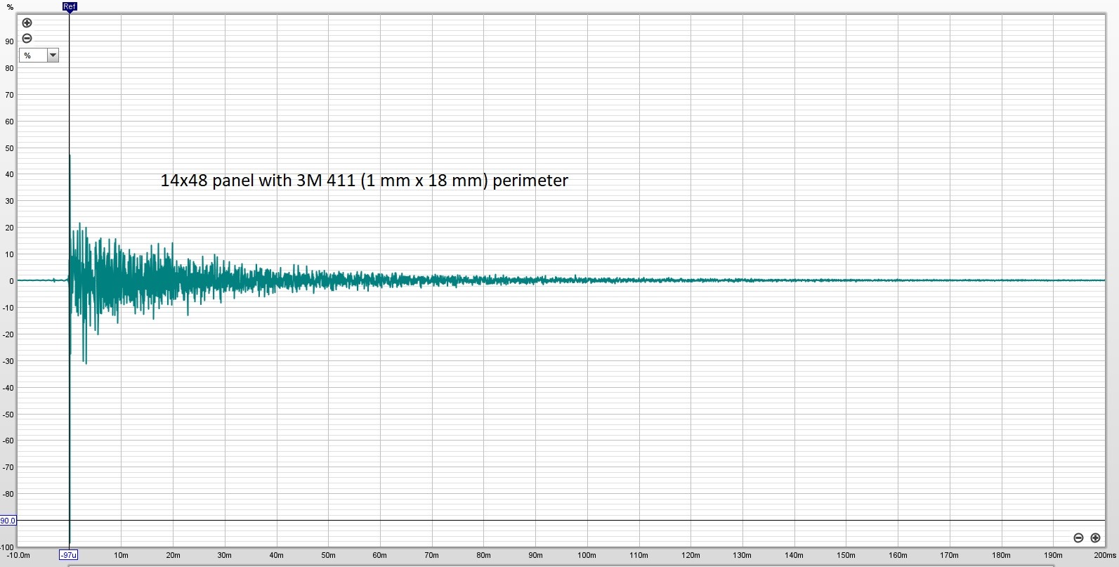

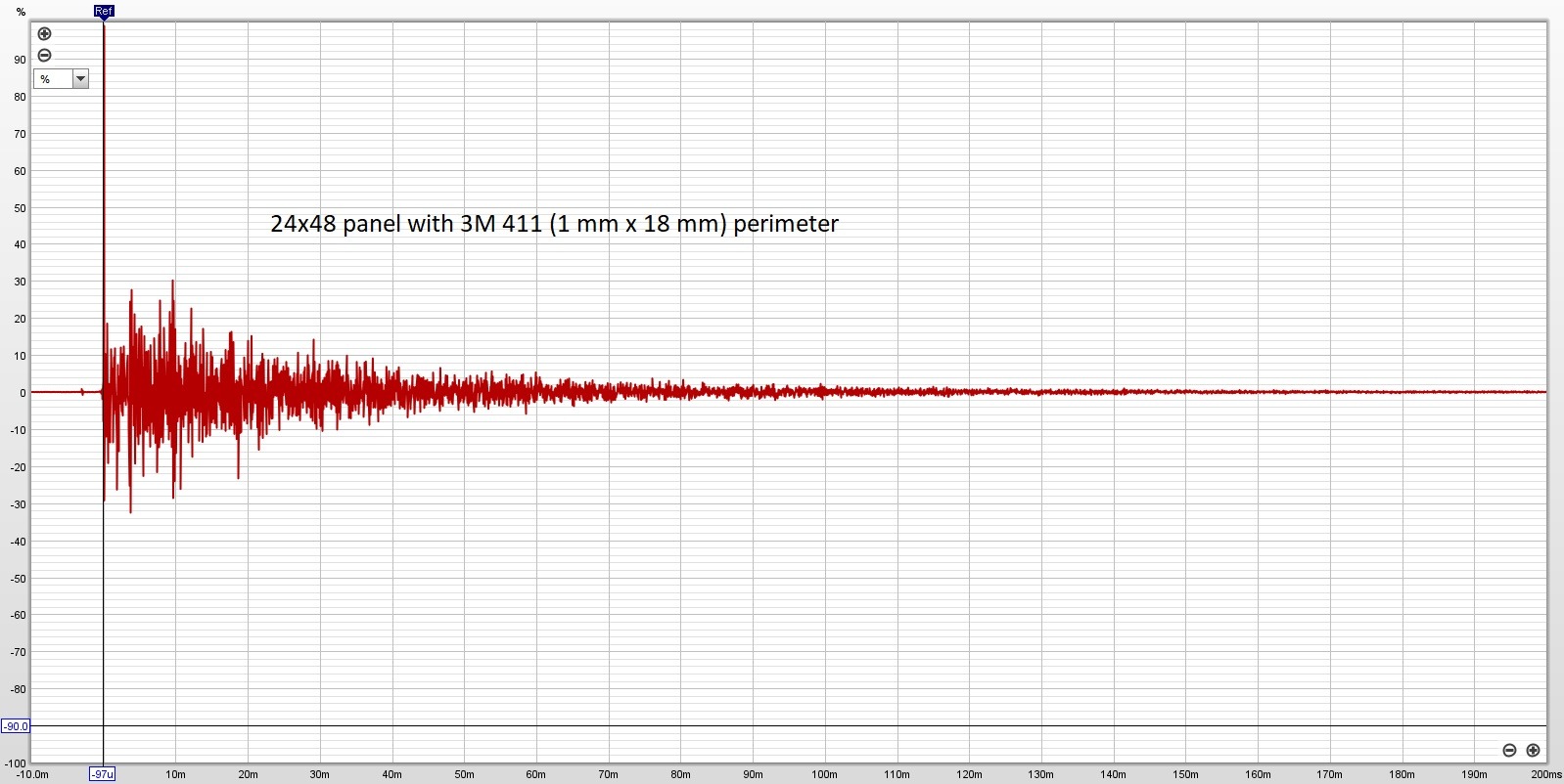

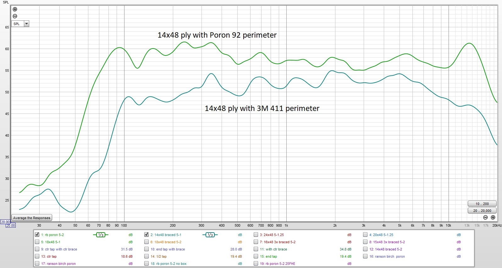

Loeb,A few dB difference in a few bumps here and there will matter a lot less than the prolonged impulse response a larger plate will have.
Indeed, it looks like the narrower panel has a bit better impulse response. See below the impulse responses I measured for the 24" wide panel, the 14" wide panel. and finally the same exact 14" wide panel, but with better damping (Poron 92 foam) on the perimeter, in place of the original 3M 411 double sided tape. The IR of the 24" wide panel is poor, while the the 14" wide panel is slightly better. But improving the perimeter damping made a much bigger improvement in IR than narrowing the panel did.
The 3M 411 is actually a decent perimeter material, but I hadn't learned to optimize it yet. Using a narrower strip (and 2 or 3 layers thick), would likely have given results closer to the Poron 92.
Also, a nice secondary effect of using the Poron perimeter was a slight extension of the low end frequency range. The much softer, thicker Poron constrains the edges less than the 3M 411 did, shifting the natural frequencies a bit lower and hence extending the low end by maybe 10 Hz.

That is quite the difference between the different suspension materials!Loeb,
View attachment 1254113View attachment 1254114View attachment 1254115
Eric

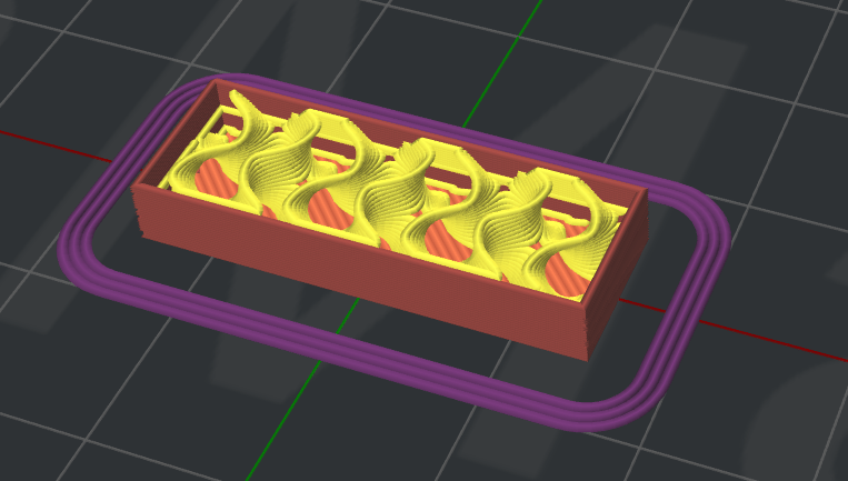

They just look like little blocks 🙂 I currently have them 10x30x6mm.Loeb, could you elaborate a bit more on how you do this and what it looks like please? Maybe a picture or two.
Here is a screenshot from slicer showing how they look on the inside:
So basically you can adjust the density and how compliant they are. You can also get TPU of different hardness, but usually it is like a hard rubber and a completely filled block would be too stiff.

Very cool Leob!They just look like little blocks 🙂 I currently have them 10x30x6mm.

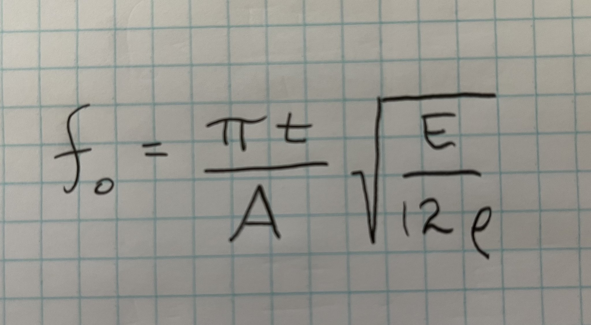

The size (area) of a panel strongly influences its fundamental frequency, which in turn is a lower bound for the panel's low frequency capability. Hence, size is indeed a critical panel measure. The larger the area, the lower the fundamental frequency. So if you want a panel to reach down to, say, 100 Hz, it has to be large enough for its fundamental frequency to be 100 Hz (or less).What is a large plate, and what is a small plate.
I have used small panels down to 3 or 4inches.
Large panels up to 4ft x 8ft , where is the transition between the two, what can be used and what cannot be used.
So I don't really think of a panel's size in terms of its raw area, but rather, in terms of whether or not it is large enough to have a fundamental frequency that is at least as low as the lowest frequency I want the panel to reach.
In addition to area, the panel properties that most strongly determine the panel's fundamental frequency are its thickness (t), elastic modulus (E) and density (ρ). Other factors that affect it are suspension, aspect ratio, and exciter characteristics, but these are relatively minor effects compared to the first three.
There is an equation for estimating the natural frequency of a panel, which is this:
Rearranging gives this:
Using the second version, you can simply enter the panel properties (thickness, elastic modulus and density), along with the frequency you wish to reach (fo) into the equation, and have a pretty good idea if your panel is "large enough". That is, as long as your panel is larger than "A", it is large enough.
Even without doing a single calculation, just examining the equation gives some valuable insights. You might wonder, for example, how does using a thinner panel effect the necessary size? Examining the equation tells you that a panel of half the thickness can be half the size and still reach the same fundamental. What about elastic modulus (stiffness)? The equation reveals that a panel that is four times stiffer will need to be two times larger.
Those equations are only approximations (except for the case of a square, isotropic panel on simple (hinged) supports), but are a good starting point for virtually any configuration.

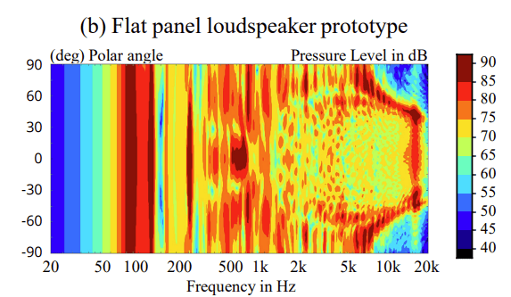

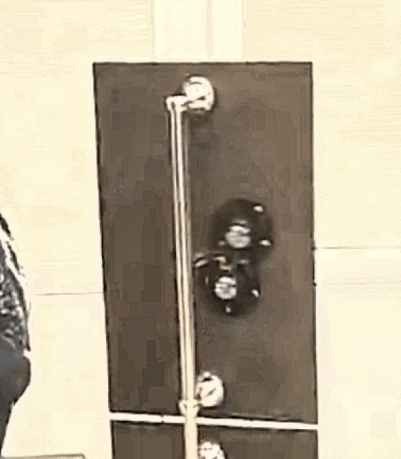

Might it be an evidence of the coincidence frequency? We could expect at this frequency an increase of the SPL off axis and a deep on axis.There is also a region in the HF showing a stronger response off axis, which is somewhat unusual and unexpected.

Christian,Might it be an evidence of the coincidence frequency? We could expect at this frequency an increase of the SPL off axis and a deep on axis.
True. See this image from one of Ben Zenker's papers. Note the high off axis (+/-90) SPL at about the coincidence frequency, which is at 6kHz for this panel.
I've actually been looking for this effect in any of my own panels for some time now but have not been able to clearly detect it.
