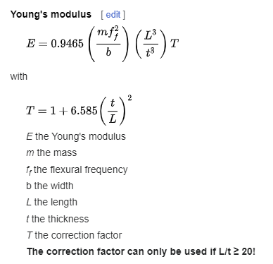

I have to say that I think REW is absolutely amazing, and is absolutely free. There is a bit of a learning curve, but it's worth the effort.Which I do have but wonder about packages other than REW. The docs don't seem to be very task orientated - but that might just be down to me as not used anything like it before. However I have seen better.
So, just to be clear, we are talking about an adaptation for using the impulse technique to measure the elastic modulus, E, right? You are right that there are indeed lots of ways you could support and excite the beam for this test, and then calculate E, as long as you have the equation relating fundamental frequency and modulus for that configuration. And indeed you could drive the sample with an exciter. But the way that seems to work best, is as shown in this video for the "Resonalyser" instrument:The link makes me wonder about an adaptation. Move the supports to the end of the panel and drive one with an exciter. Ignoring constraining the panel some how and assuming there is a solution.
If you don't want to watch the whole thing, just watch from about 1 minute to 2:45. Rather than supporting the beam on rods or the like, they actually hang it from strings. They don't mention it in the video, but the support points are ideally 0.22 times the beam length from either end. The reason for this is that those points are nodes (points that don't move), for the fundamental bending mode, and hence, supporting the beam there has virtually no influence on its frequency of vibration. So you can then use the equation for a so called "free-free" beam, which is well known (below).
You could use an exciter to drive the beam, but adding the exciter changes the natural frequency, so you'd have to be able to account for that somehow. It can be done, but the easier way is simply to tap the beam without an exciter, and not have to worry about the effect of the exciter itself.
In the video, they show how they use an accelerometer to measure the beam vibration. But with REW and a mic, you don't need an accelerometer at all. With REW in RTA mode, place the mic very close to the center of the beam, tap the beam, and watch the signal on REW. There will be peaks in the mic response corresponding to the beam natural frequencies. Find the frequency of the lowest peak, and use it in the appropriate equation (see below). In the video, they mention how the software corrects for the effect of the accelerometer mass, but if you use the mic signal instead, there's no need for any mass correction!
The equation for modulus is here. It's actually a bit simpler than it may appear, as the correction factor (T) is negligible as long as the beam is more than 20 times longer than its thickness. There's no need here for the Resonalyser computer, as this can be easily set up and calculated in Excel.
