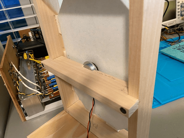

Yes, thanks, I wanted confirmation, for me it is important to reduce the weight as much as possible for professional use, at the moment I used a very hard wooden frame, now I want to understand how to make a rear structure if in metal (very complicated) or just do with the same wood for the frame to hold the exciters, I don't know which one exactly to use to minimize vibrations but also to consider the feasibility of the thing, I would like to look for a system that is also decent to present but I certainly cannot afford structures like tectonic. I accept any advice
now, the foam is tight. Does it need to just barely touch? or how much friction?
What exactly are you referring to here?
Do you mean the exciter to the foam? If so, then the voice coil of the exciter should be adhered to the panel in such away that its resting position is exactly the same as if there was no panel. It must only-just touch.
If you position it tightly by forcing it between the panel and the spine, then you're going to get high distortion and also slam the back of the voice coil into the magnet at bass frequencies.
Im assuming he is talking about the foam within the frame.

It should be tight as possible.
6watts is good for this small panel size.
Either dead center or 1/2inch off dead center.
The magnet of the exciter is glued on directly to the spine while the voice coil of the exciter is glued (2 part epoxy adhesive) directly to the foam.

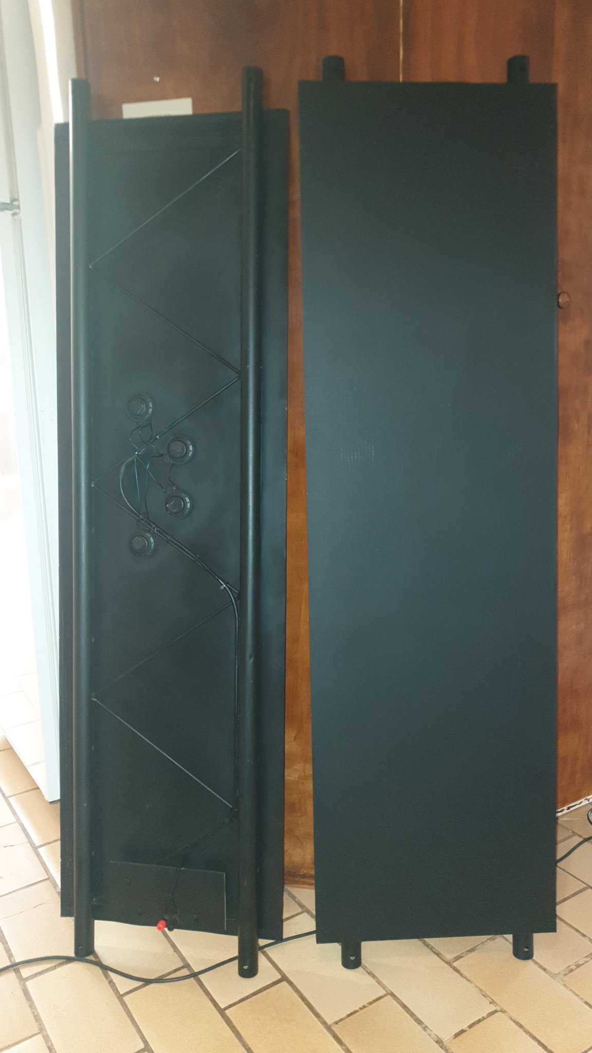

You seem to have accidentally posted a picture of your panels 😱
Is that sound of thunder, the running of feet to the patent office, oh no , its my stomach rumbling, I have not had breakfast yet 🤣
Does this mean you are going to ditch the rug ?
Joking aside, that looks like a solid build.

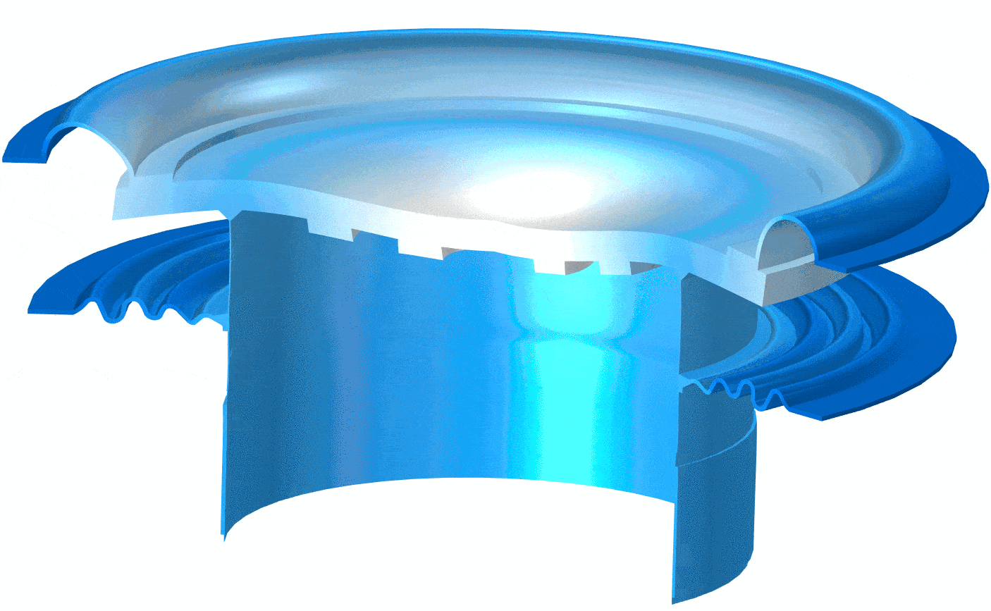

In the animation you posted they have the two rings inside the coil area, does this exciter modal exist?
I have seen this type of animation before, an exaggerated low frequency tin can effect.
The animation is from the BMR Tectonic markets. It is not an exciter.
The questions in the post is about what Sandasnickaren had done with a BMR TEBM65C20F-8. I was debating whether to buy such BMRs and take off the membrane, for they are much cheaper and powerful than exciters.

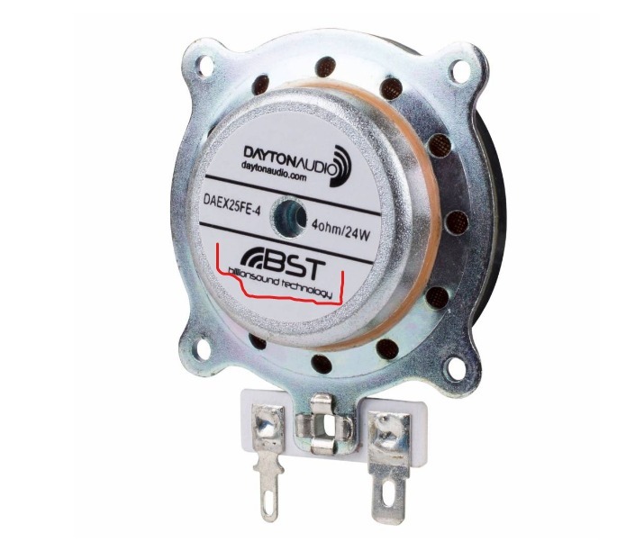

Also, I noticed from the link given in your post #9,291, that the Dayton Audio DAEX25FHE-4 sound exciter advertised there is from Billionsound and made with Billionsound Technology (underlined in red in the image).

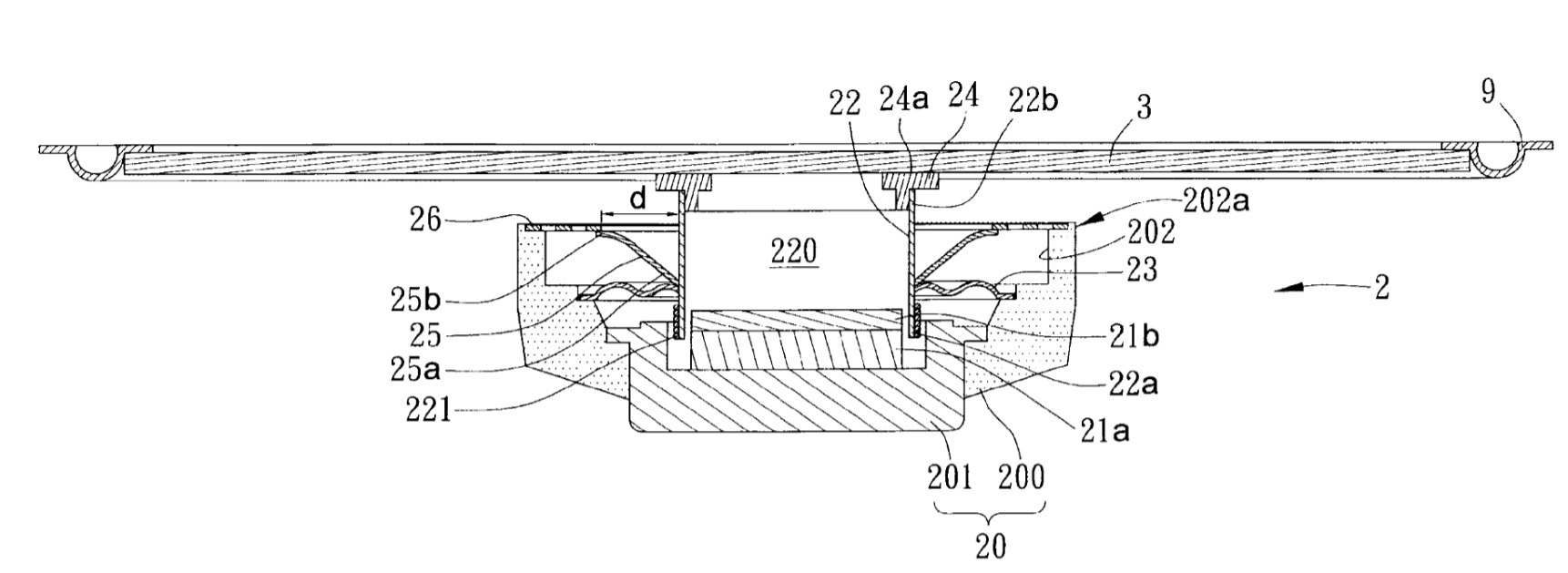

It so appears that those exciters are from this Chinese technology, only rebranded. Since seeing this, I've been looking for Dayton patents, but I didn't find any yet. If anyone can find such patents, I'd be glad to read them.
This is the patent I found which belongs to Billionsound. It is active until 2032.

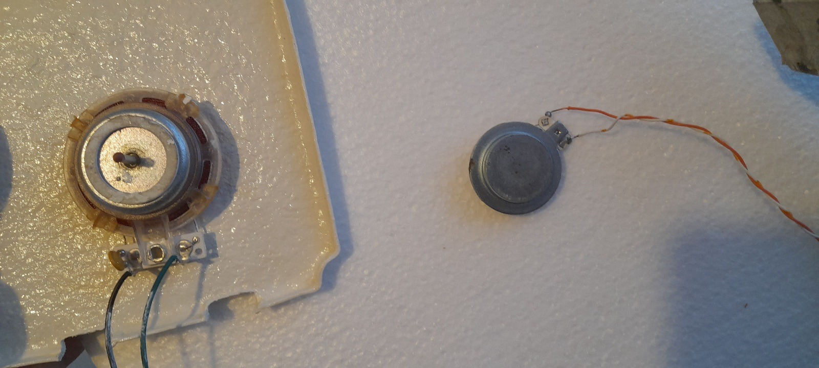

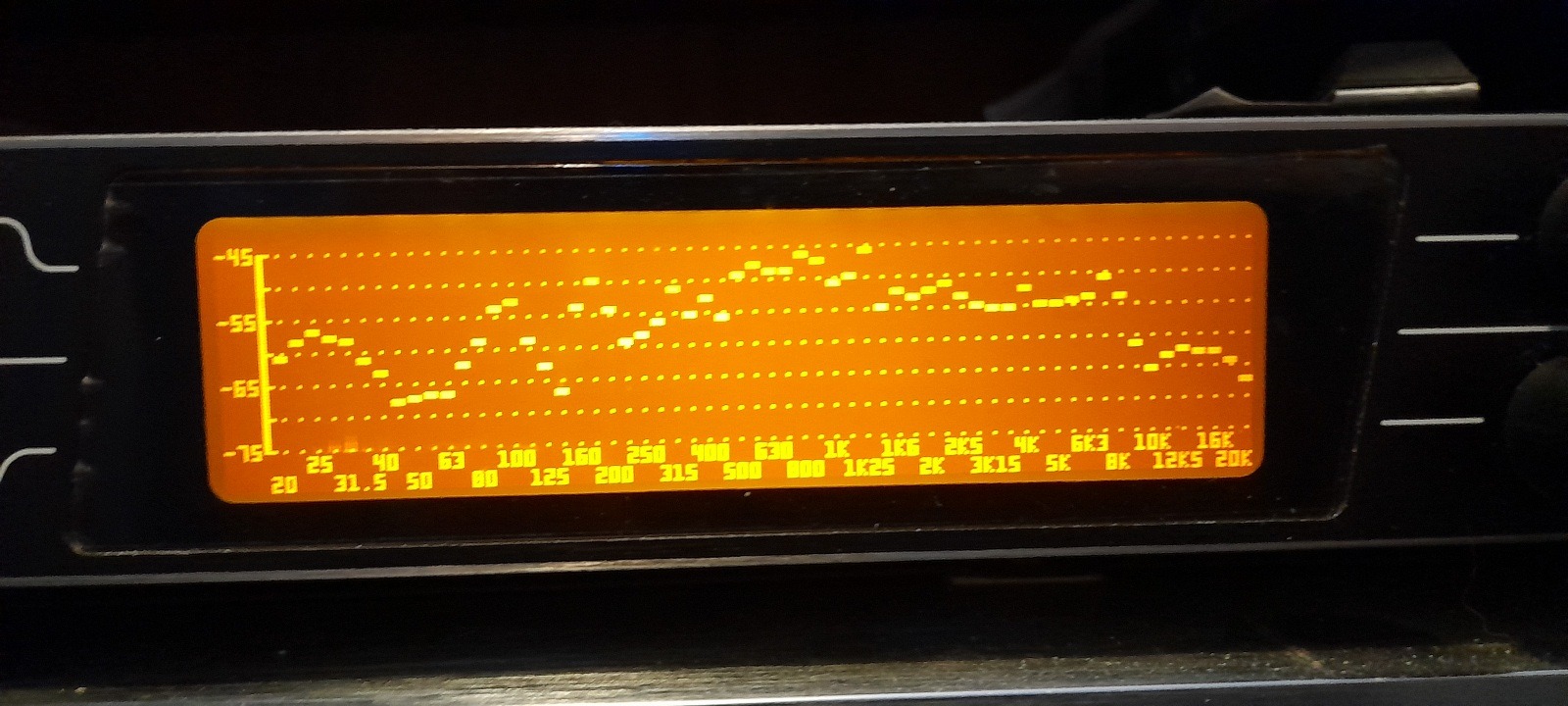

As luck would have it, yesterday I glued this ,what I think is a 3watt exciter to a soft low grade 2cm EPS panel that I just had lying around.
I have not a clue where I got the exciter from some years ago, it might have been from a toy or card ?
I am getting a decent volume out of this exciter xoing at 200hz.
I measured it and as expected the hf above 10k drops significantly.
But not bad considering the response plots shown from dayton.
Will cover this panel with pva and see what happens to the hf.
I will probably eventually try this on my flexible ply pane to see how high the frequency will go and if there are any peaks higher up.
Steve.
this is correct. However, I was about to ask the question Andre answered, as I've got the epoxy job done. what a pain, 2nd time in my life I've used epoxy; happened to have some still.
as for the tightness of the foam within the frame, it's relatively snug, but not evenly so at all contact points. If this is critical, there are several ways to put a screw or dowel or something through to increase tension -- I assume you wouldn't want a screw actually poking into the foam although this would be quick and dirty to try.
Suggest you have a look at birch plywood. It’s predictable, strong , light, stable (moisture and temp variations) and pretty good at handling vibrations.
Stability is important for the parts that is supposed to hold the Exciters as they need to be kept in the proper place for their function.
