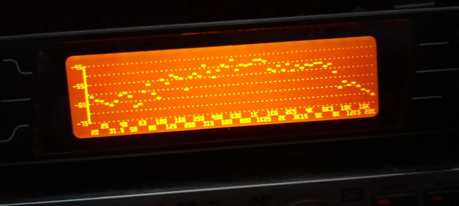

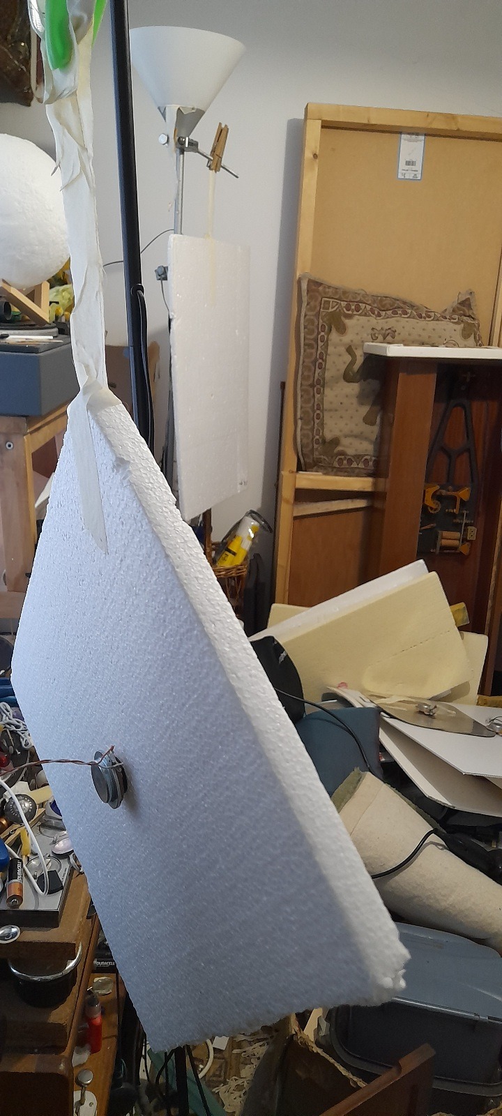

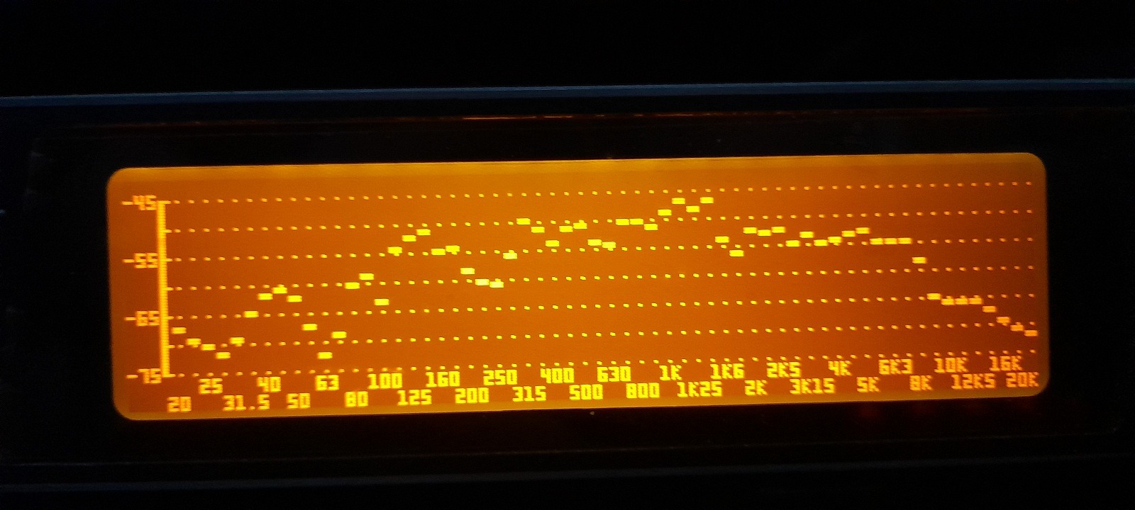

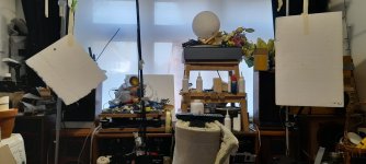

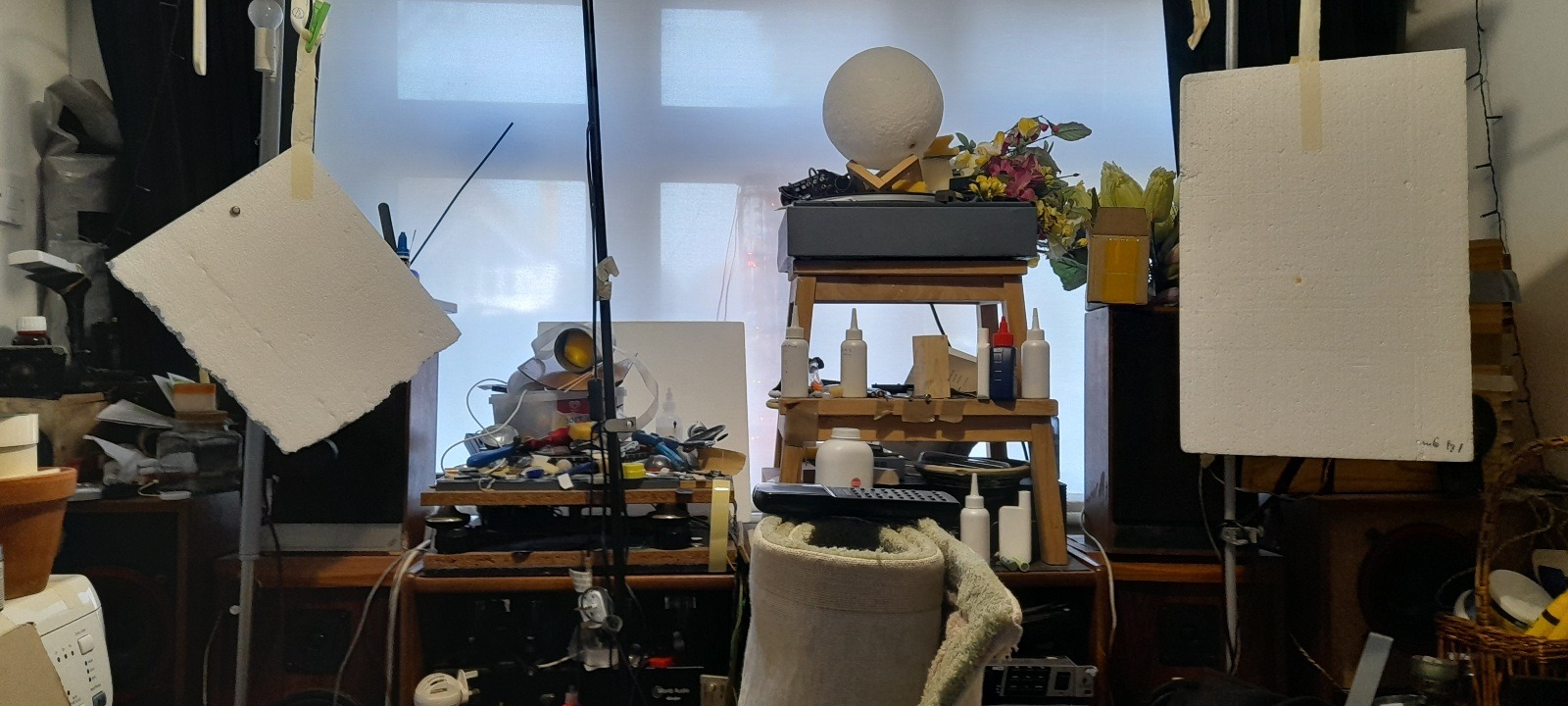

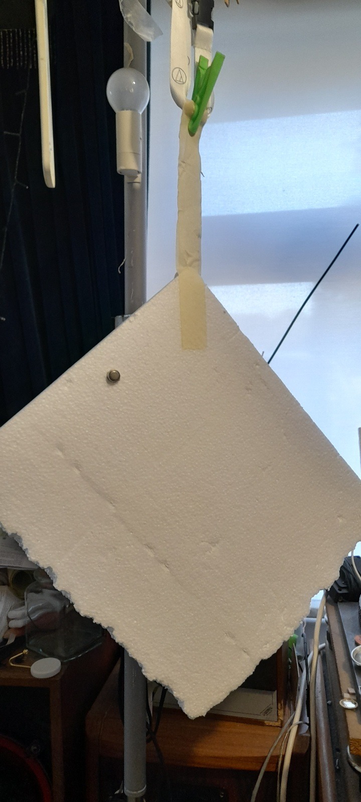

Some pictures and plots of the low density EPS panel.
The first picture is the response at 12inches showing the hf roll off above about 9k.
You can also see a dip in the response at 200hz.
In the second picture you can see that I removed this dip by placing a small button battery in the position showed in picture three.
Picture four just shows the small 3watt exciter and scrap peace or low grade(density)EPS.
Picture five shows the position of the phone on the rug for the recording I have made, which I will post later on when I get time.
You can also see the other low density panel on the right,with the upside-down 14g ,which is the panel weight.
Steve.

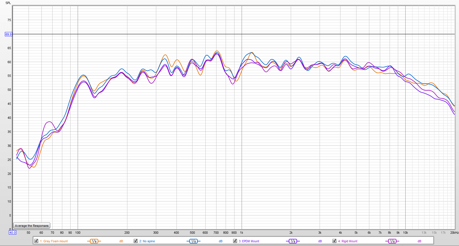

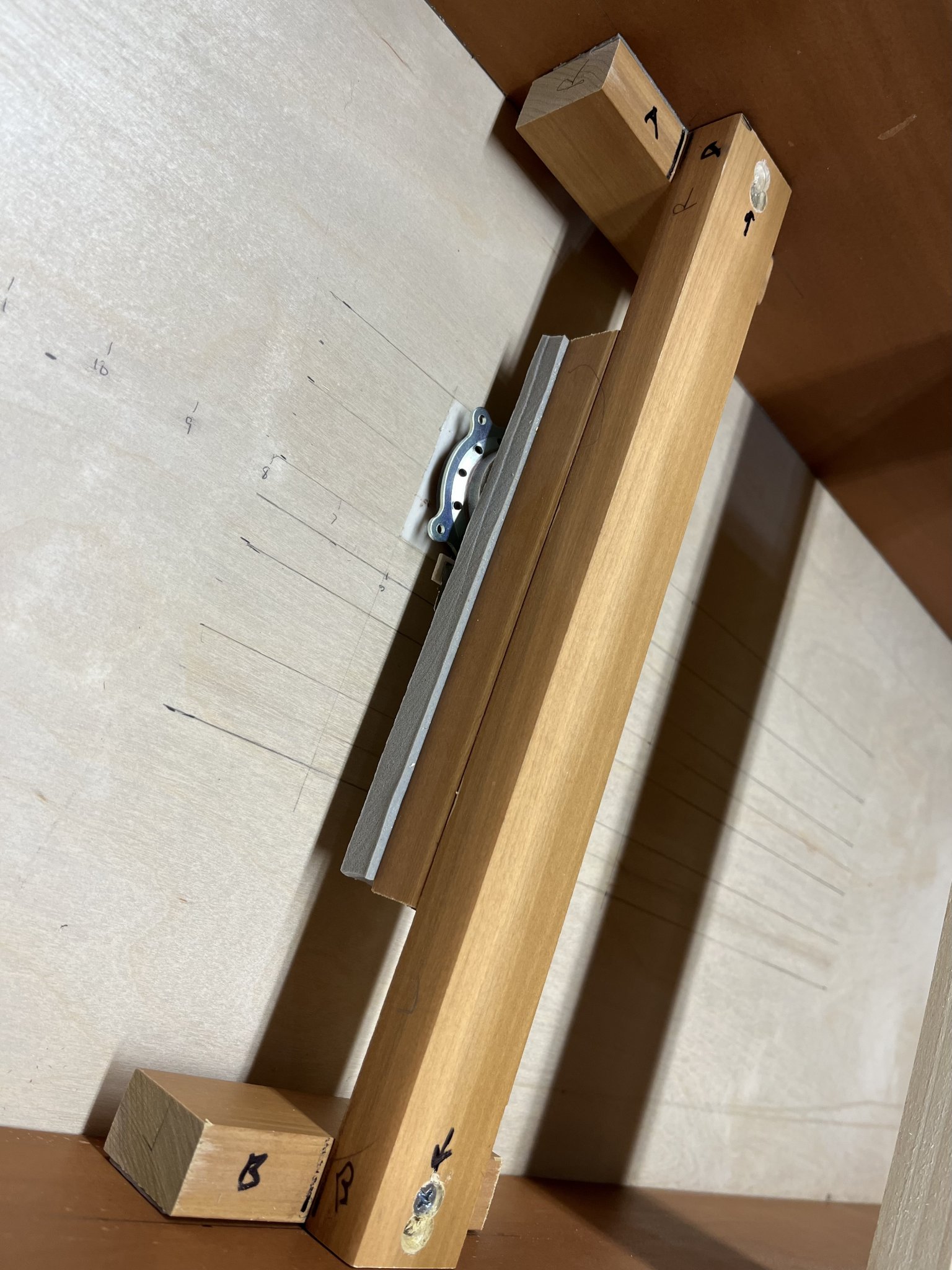

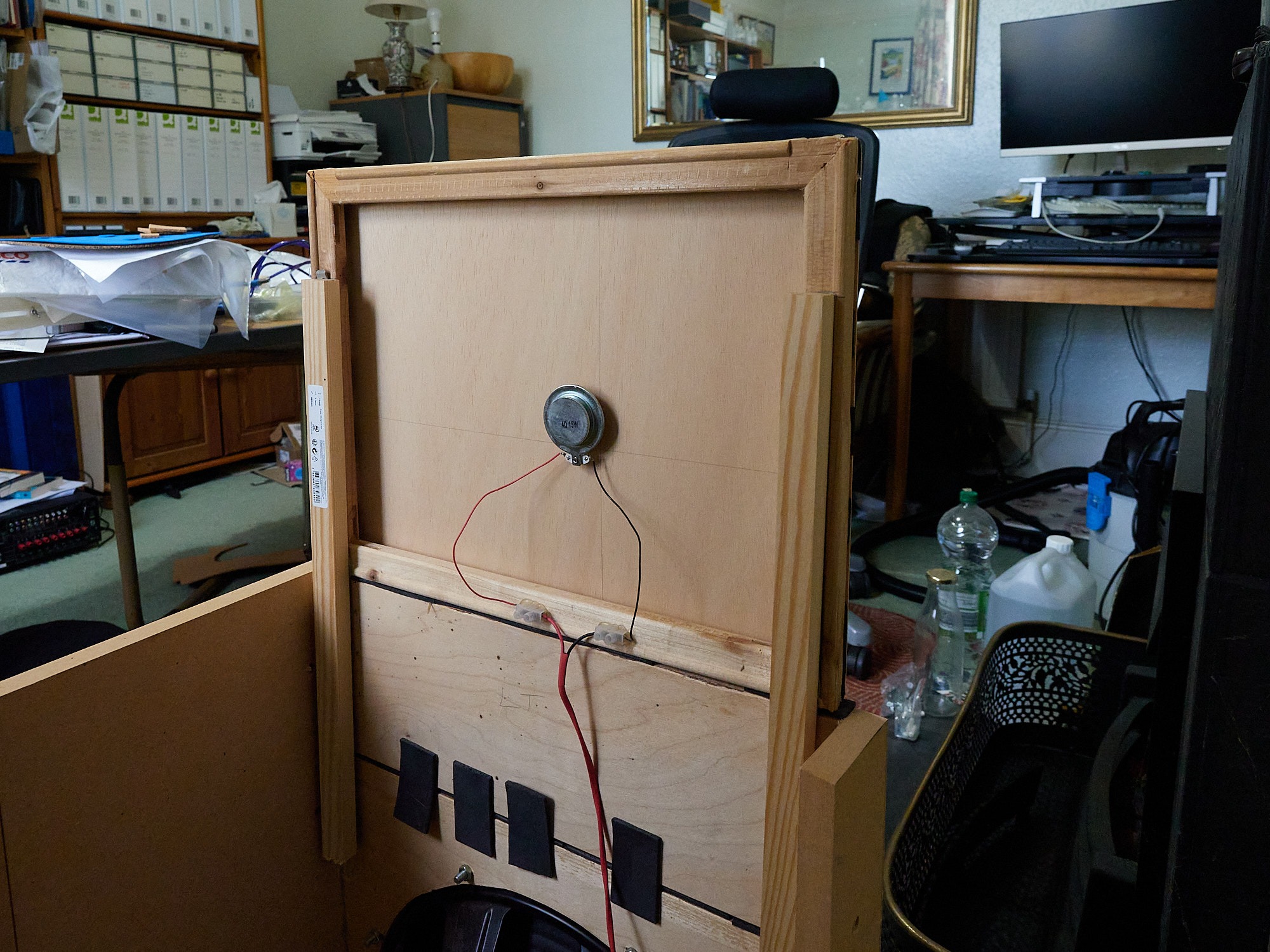

There's been some discussion lately about various mounting methods for exciters, so I thought I'd share some recent comparisons. Below are the results I got for four different mountings of the same exciter (DAEX25FHE-4) on a 4 mm plywood panel in a sturdy frame. In three of the four mountings, I used a brace/spine as shown in the image below, and in a final case I completely removed the spine.
For the mountings with the spine, between the spine and the exciter I included one of either:
That said, for final builds, I always use a spine, mainly because most exciters do need support to prevent the weight of the magnet from causing voice coil to become misaligned, or preven exciter from simply falling off the panel, or from damage by contact or rough handling. And I also typically add some foam in between, but only to give the mounting a bit of compliance so that if the panel or spine warps a bit, not all that deflection has to be taken up the voice coil and surround, as some of it is taken in the foam. But for prototypes I virtually always run tests without the spine, knowing that when I eventually add the spine for the final build the result will be virtually identical.
Eric
- Gray soft closed cell PVC foam (window gasket), as shown in the image
- Black EPDM foam (slightly more rigid than the PVC foam)
- Solid wood block (rigid mounting), no foam.
Eric

Pva doesn't help much.
Epoxy on the other hand worked wonders for the XPS.
Adding PVA adds mass and stiffness so increase the impedance so the bandwidth but reduce the efficiency.
In the case of XPS 5mm, PVA is probably not strong neither heavy enough where epoxy is.
Some measurements of bending stiffness and areal mass might help to understand along with the material chart scales.
