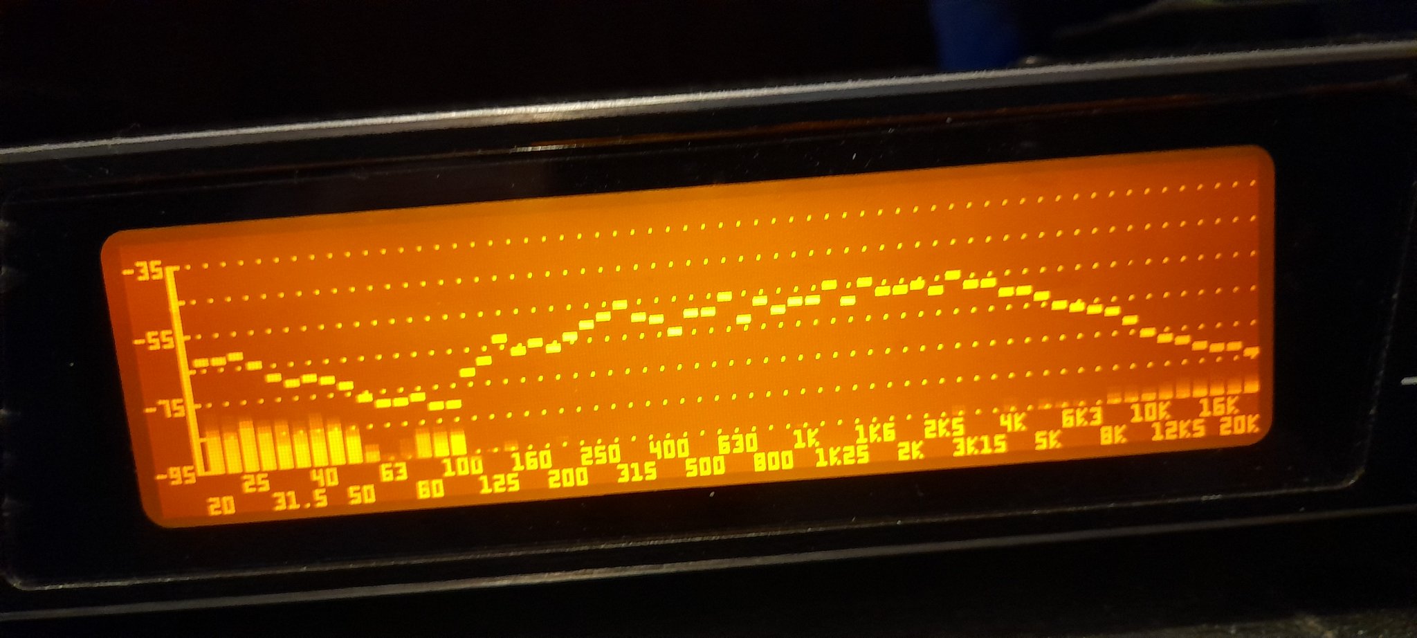

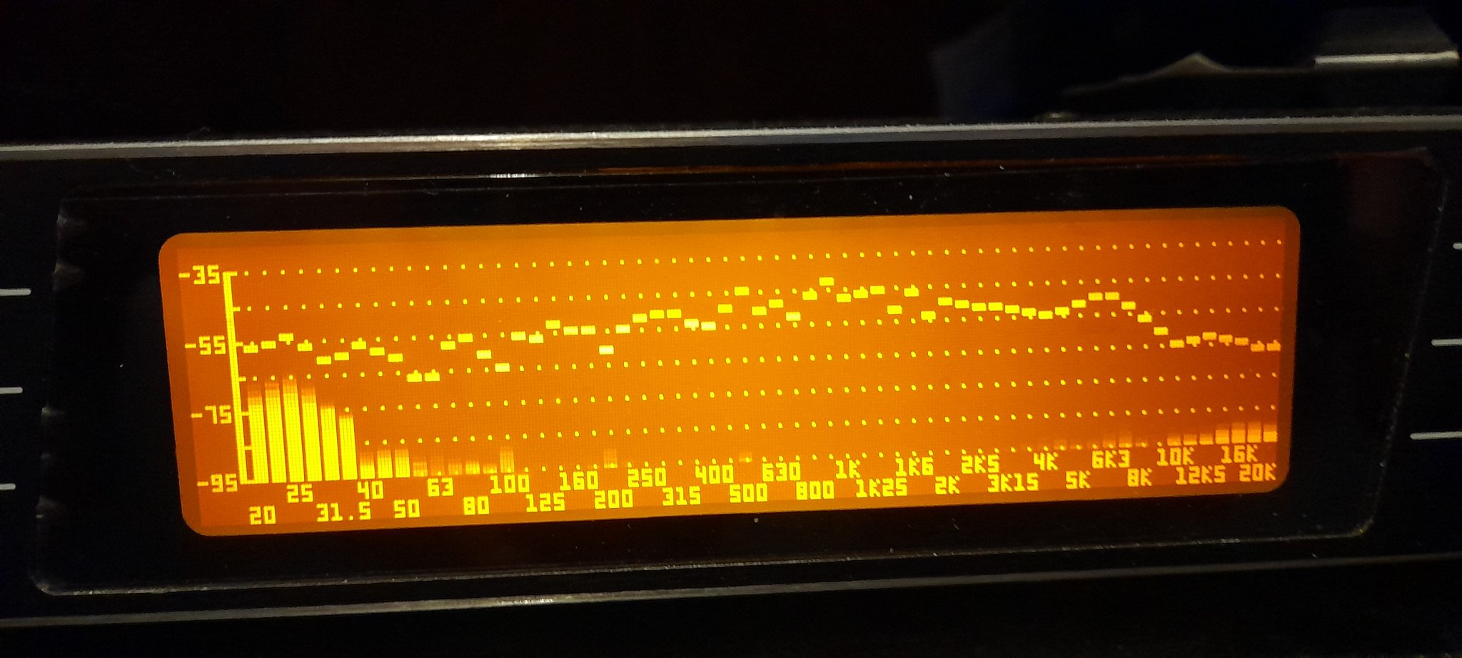

I do not normally show plots with 10db spacing ( dotted lines )as it looks over beautified .
But I thought it might give a better overall picture.
There was a lot of traffic noise below 100hz, especially on the side plot.
The first picture is at 12inches in front of the low grade EPS panel.
The second is the same panel but from 12inches to the side of the panel.
I am now going to see how the small exciter performs on another type of panel.
How will it handle a lower efficiency panel, and how will the hf improve?

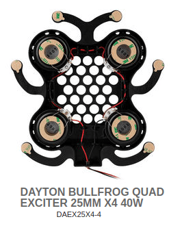

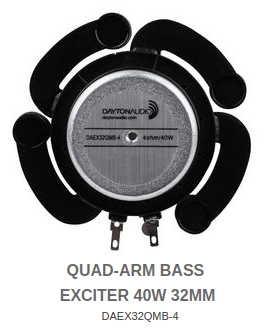

Hi people
I would like your opinions on using a Dayton BASS DAEX32QMB-4 to create an exciter DML sub woofer.
My main panels will be 970 x 600 mm XPS with 40 watt Dayton Bullfrog Quad DAEX25X4-4 .
What size panels have proven successful with the BASS exciter compared to the main DML's ?
For example do smaller or larger panels work best with DML subs ?
Has anyone found a size ratio that works ?
I spent around 2 hours reading this thread so i did not read all 9400 posts , I also watched around 9 Youtube videos and did 10 hours research to arrive at the point where i think i have my mains sorted , just not sure on the Sub.
My Amp will be a TPA3251D
Any suggestions ?

What frequencies are you expecting your dml sub to handle ?

If these are built the same as the DAEX32Q-8 that have the springs and rubber boot I would advise you to stay well clear of them for any project. For bass you're going to want an exciter with a long excursion, this exciter is not that, it's exactly the opposite. I have a few posts on this exciter. :I would like your opinions on using a Dayton BASS DAEX32QMB-4 to create an exciter DML sub woofer.

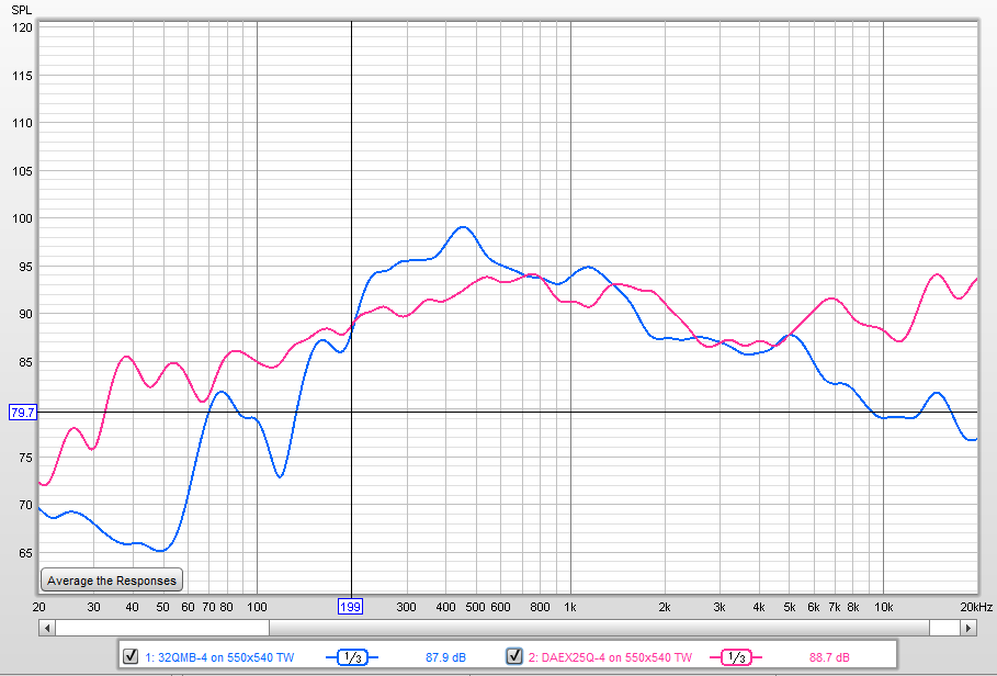

Here are my comparisons. Blue is the DAEX32QMB "Megabass"🙄 40W exciter, the red curve is the DAEX25Q-4, which is only 20w, and sounds a helluva lot better.
These measurements are done on 550 x 450mm Polycarb Twinwall, 70kg/m3 density, mounted with the whole of the top edge fastened to a support with 1.5mm double-sided foam.
I first tested the 32QMB, and I thought that the panel was too small to produce decent bass. Shrug. Carry on... Imagine my surprise when I used the little 25Q instead! And it produced that deep bass that I was missing. AND nice tops too.
So for live gigs I've been using 4 x DAEX25Q-4's per side on 1,400 x 450mm Twinwall panels. Sure that's only 80W per panel, and I'm driving them really hard, maxing out a 150W-per channel amplifier. But they've survived.

There are two problems building a DML-based sub. One is that you need substantial surface area since the whole thing works on quasi-open-baffle principles.I am investigating if it can be done with different thinking but It might be a dead horse that needs to stay under that soil.
A DML would give cleaner architectural aesthetics inside the room , its that simple , If it costs $ 60 instead of $ 350 - 600 thats a also plus.
You will probably need at least the same surface area as 2 x 15" cone drivers to get decent bass. And if you use very a stiff panel, then the panel operates as a piston, and you will need large excursions on your exciter.
Secondly, to get around the excursion problem you might want to use a very floppy panel in order to produce bending waves at low frequencies. But then there's the problem of transient response. Yes, one can get very low frequency reproduction out of a reasonable-size DML panel, but no punch. It will sound 'floppy.'
