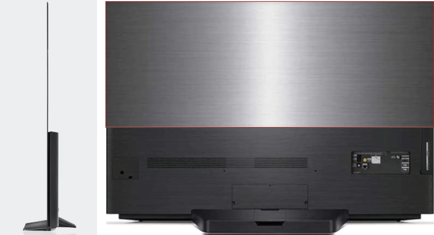

I've pinned down the earlier trouble I reported with respect to my center channel.
As some will remember, I had previously attached a Thruster to the back of my LG OLED TV to use it as a center channel in my home theater system.
The TV as DML has less efficiency than my aluminum honeycomb main DMLs, so I had boosted the trim on the center channel to align their sound output.
It worked and sounded great until some 30 minutes into watching Dune at higher volumes than my neighbors would appreciate. Great fun, but it blew up the center channel exciter.
To address the issue, I've decided to mount two Thrusters on the TV as DML and drive each of them with separate amplifiers (I have a spare NCore stereo module). I'll feed both amps with the same center channel signal from my AV pre/processor.
This should better level the output of the center and main channels.
The attached image, shows the LG TV from the side and back (the red line defines the DML panel area). You'll note that the TV's design has the thin acrylic upper panel fixed to the thicker unit at the lower end of the TV that holds the electronics and connections.
Previously, I had placed a single exciter in the middle of the upper panel.
I'd appreciate suggestions and explanations for where to place the 2 exciters I plan to use now.
Working on my own so I don't have someone to hold the exciters while I listen ;-(

First off I would never place an exciter on a TV as at high volume levels it could damage the tv in the long run, combined with the fact that the tv is not an ideal DML diaphragm, hence the low efficiency.I've pinned down the earlier trouble I reported with respect to my center channel.

You place the exciters side by side with at least a 2 inch gap between them in the middle of the diaphragm. When the exciters are closer together they will tend to act and sound like the sound it coming from a single point source with the midrange/vocals being more prominent. The further away each exciter is placed from each other the less prominent the midrange/vocals will become being harder to localize the exact source. Its personal preference BUT for center channel use I recommend closer together as the center channels main function is dialogue.
Instead of placing the exciters on the TV I would build a dedicated DML center channel speaker using EPS then you wont have to worry about destroying another exciter and you will only need to use one exciter as EPS is very efficient.

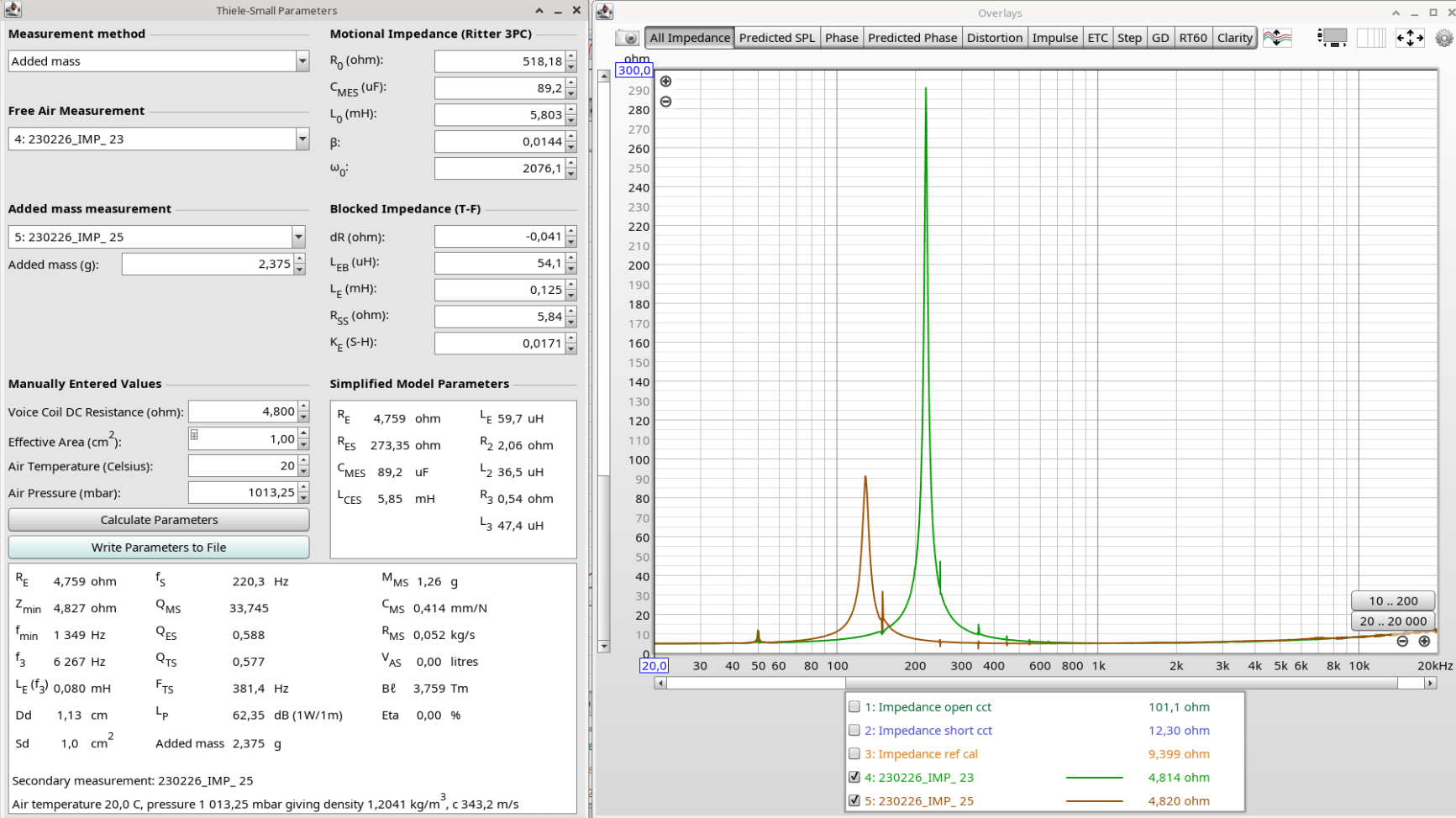

To give a follow-up to your impedance measurement, I did some impedance measurements today with REW and the sound card I have (an old Audigy2NX). Not too bad. I did it with one DAEX25FHE-4. It confirms the data sheet (voice coil mass, inductance, compliance). What is unexpected it is the spikes on the measurements. To be investigated. If somebody has a clue..?
