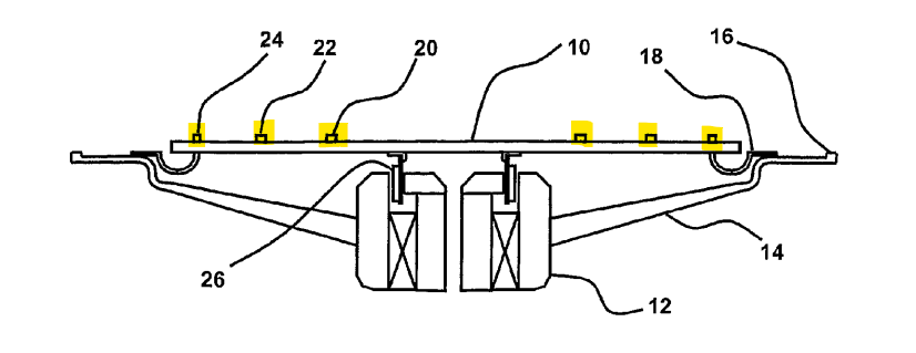

In your BMR builds, did you add any "ring masses" or locate the voice coil at a particular radius ratio in order to "balance the modes" as they describe in the Tectonic literature and patent?
Eric
https://tectonicweb.wpenginepowered...9/05/Tectonic_BMRWhitePaper_Rev2.0_2019-1.pdf
https://patentimages.storage.googleapis.com/1d/e6/29/d4bdc6e58aff65/US7916878.pdf

No, I haven’t add any ring masses. I was planning to but never came around to do it. They sound well enough. The VC former diameter was given by the chosen exciter, so no. The edges are done according to their patent.

If I remember correctly from reading this patent some time ago, the third outer ringe was removed as the rubber surround was placed in this position, to replace it.
So only the two inner rings were used.
Pity they did no feel the need to sort out the inner coil area peak at above 10k.

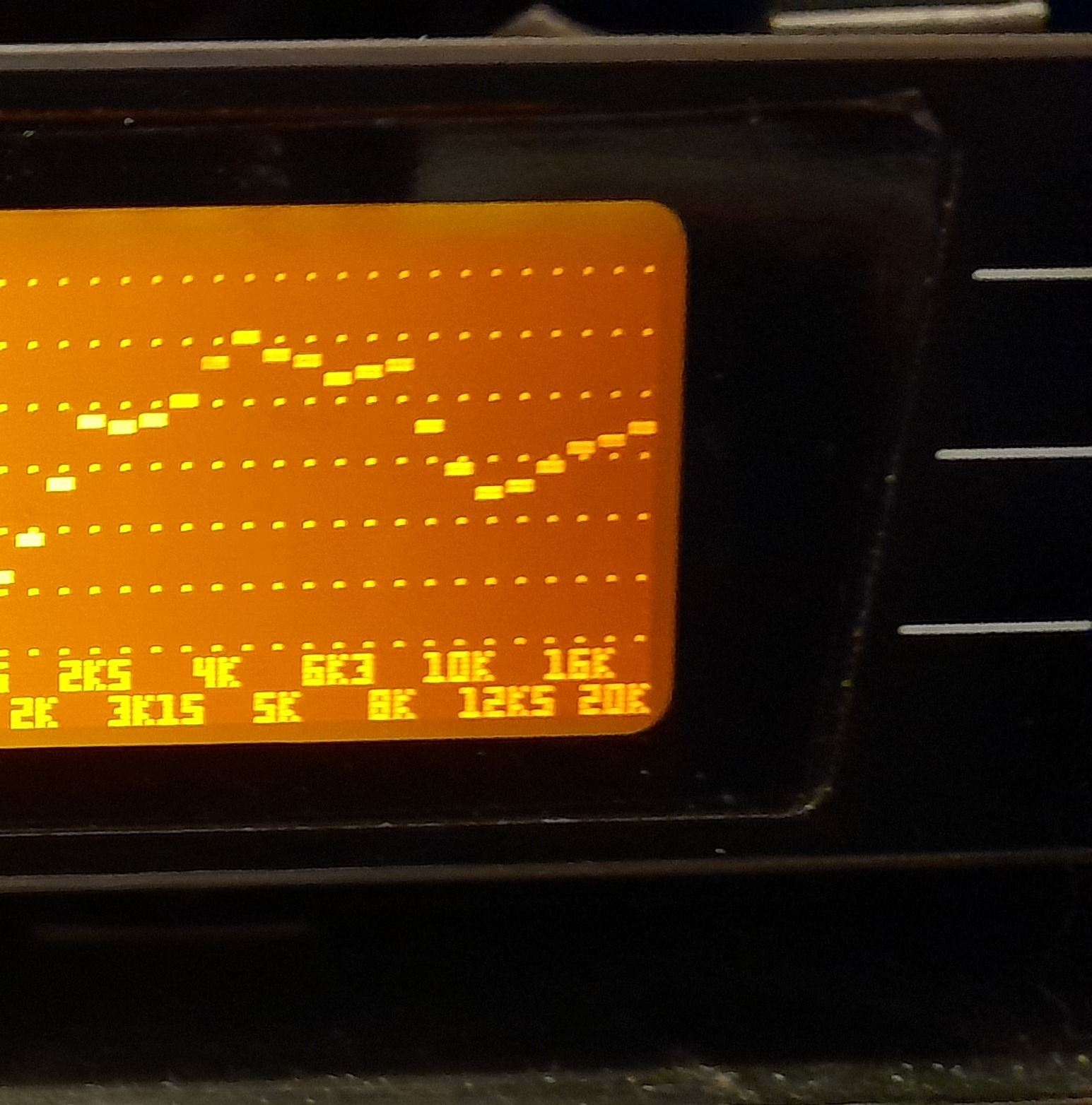

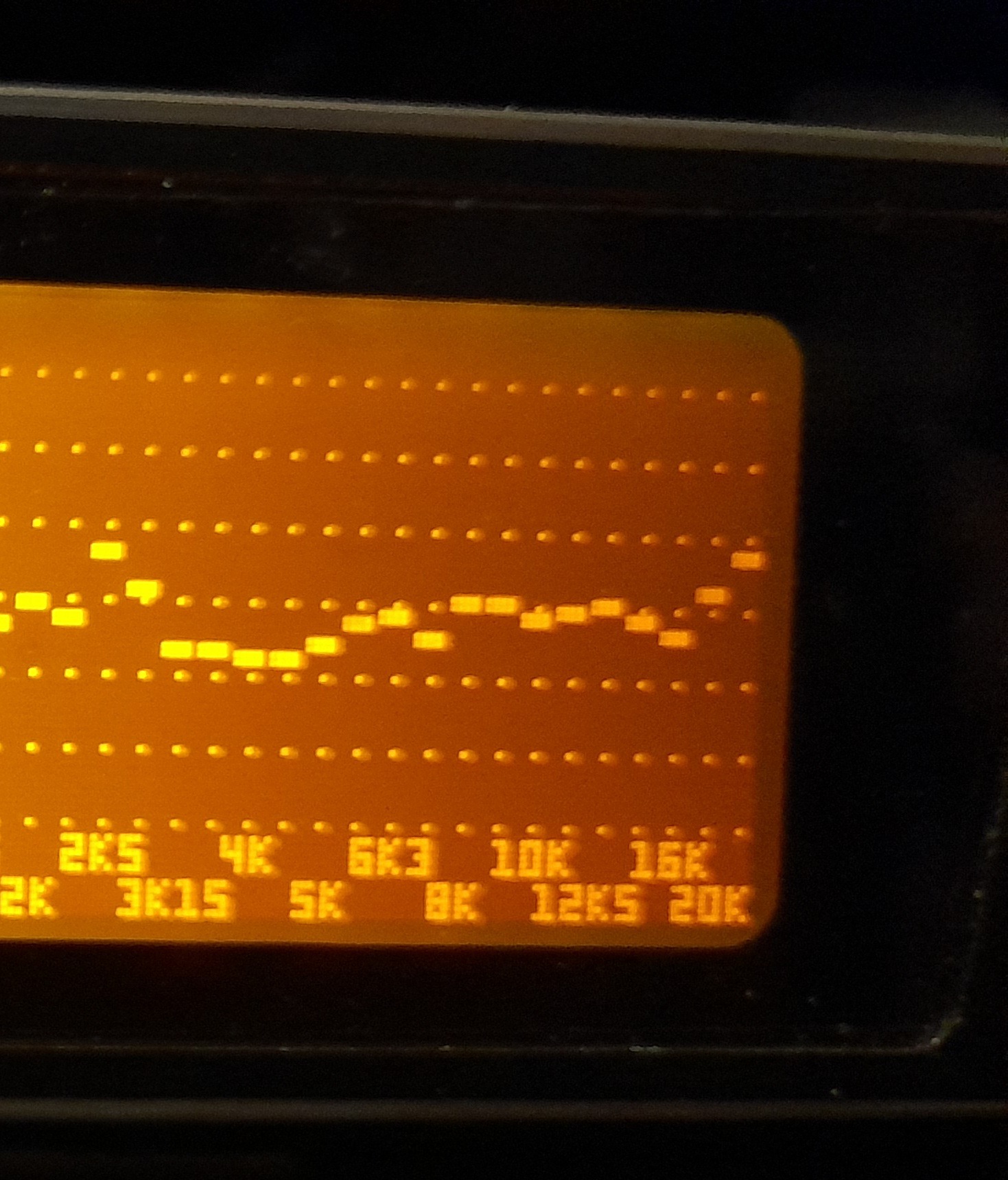

It only took a couple of minutes last night to cut up the can after drinking it 🍺🤪 and applying it to the panel with a very small piece of blu-tack.
The frequency in the 2k to 10k area was increased by about 5db to 10db.
I will send some pictures, and will probably cut the whizzer size down to see if this reduces the dB?
But I must admit sounds such as Bells and metal clanging were very clean and clear sounding .
Not harsh or distorted, I have heard worse from ribbon tweeters.
I was trying to find sounds and music that would show up problems, it was clearer and brighter ,certainly, but I was impressed at just how good it sounded.
I will have to compare this with the coffee whizzer , maybe even another recording?
Not bad for another free upgrade 😉
Steve.
Jaxboy.
Just remembered I took some frequency plots just showing the whizzer increase in the 2k to 10k area.
It sounds much better than it looks, honest😀
And if you have hearing problems this could be a plus benefit.
I have heard hi end audio that sounds bright but also painful sometimes.
It's nice to have the brightness without the pain 😁
The trouble with whizzer cones is trying to match the efficiency of the whizzer to the panel for a flat frequency response for general use,( no volume control ).
Steve.

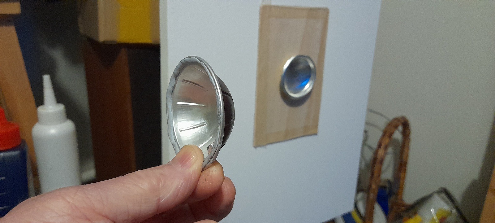

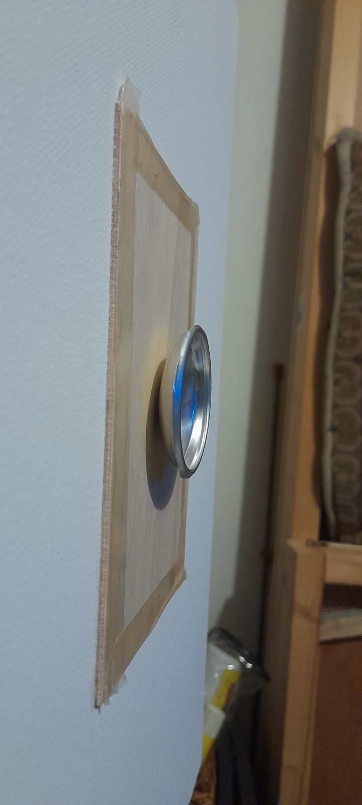

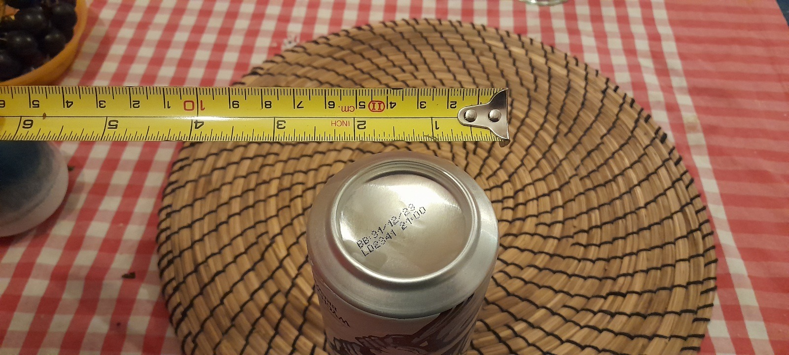

How high up on the can did you go? That is, how tall is the whizzer? Is it a standard drink can? I really appreciate your doing this for me. You are so accommodating for me and so many others to do such experimenting for us.
Jaxboy.
It's OK ,no problems.
Pictures of the can and cut out whizzer .
Plus the coffee whizzer in the first picture.
As you can see I have left the lip on the can whizzer , so far , as I preferred it left on the coffee whizzer.
But I will be cutting it off later, a bit at a time , for the smaller whizzer and dome tests.
Steve.
