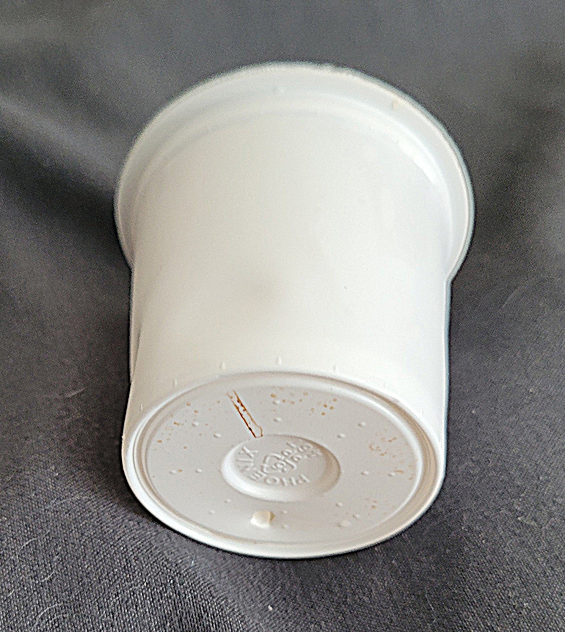

Okay, I read and re-read 346-350 about the whizzer cones, but am a bit confused. I use a Keurig coffee machine. They have a plastic container to hold the coffee grounds that is 39x45mm. There is a paper filter inside that actually holds the grounds. What do I make the cone from? I don't see a way to get the paper part out without tearing it to shreds. If you will notice, on the bottom is where the machine pierces the cup to allow the coffee water to exit. Please explain how I am to use this, or if this is a proper one to use at all. Thanks.

I'm afraid you must have a different coffee container over there, the ones my friends have is made out of aluminium and is a half dome.
You send them back to recycle them.
There is a picture on page 346 post 6918.

I was thinking that was the case. What are the dimensions of them? Maybe I could mush up some paper and make a paper mache whizzer from a suitable mould, or do the same with aluminum foil. It looks like a custard cup is about the right size and shape. What do you think about that idea? That might be too much work for my poor old hand, though.

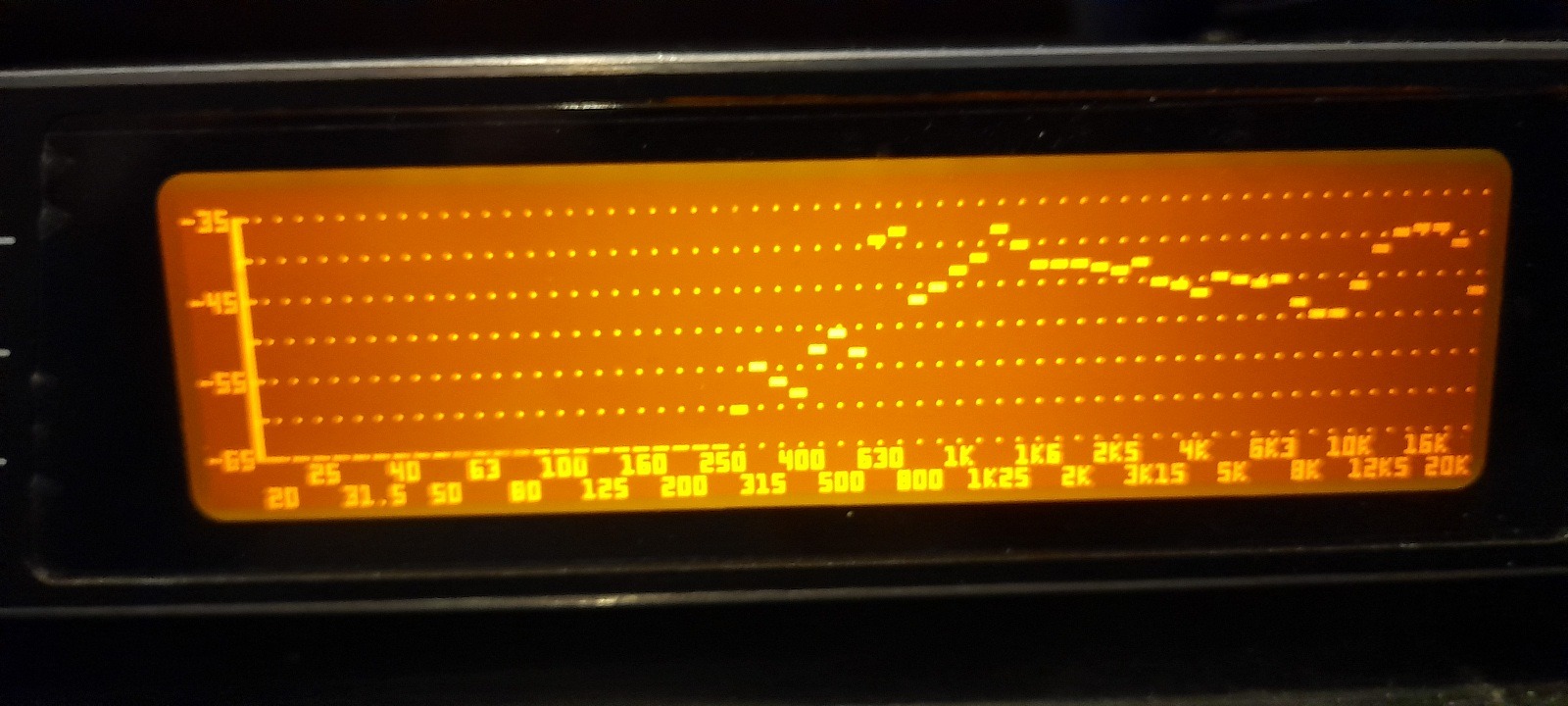

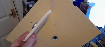

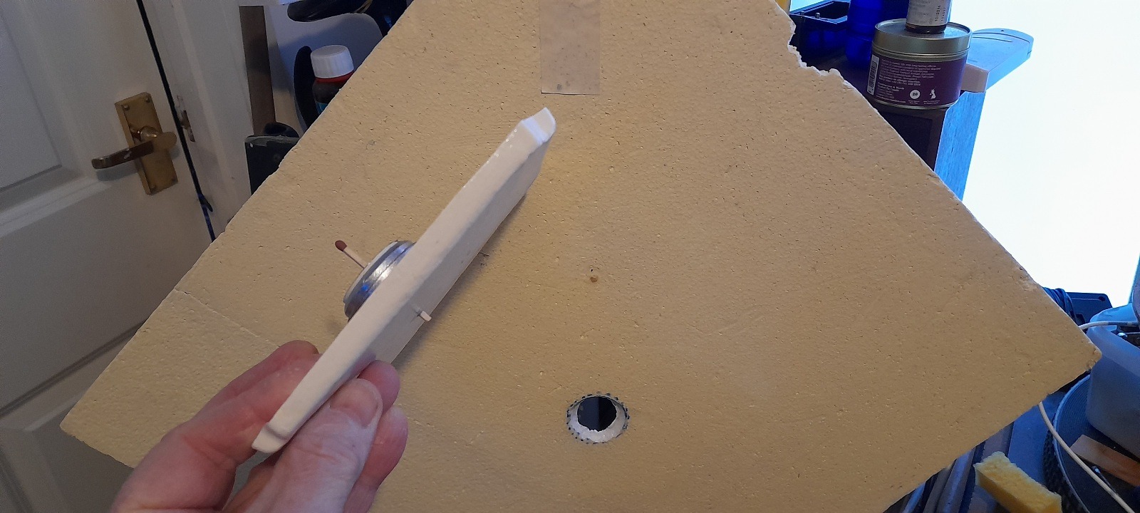

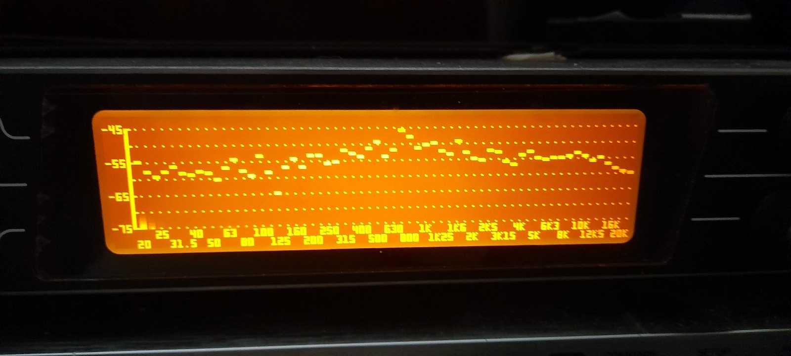

I waited all day yesterday for the glue to dry on this next test panel.
Using the same eps panel I glued a matchstick through the hole in the back of the exciter and through the panel.
The first picture shows the panel with the old smaller (5inch x1mm) panel in front.
The 5inch panel was made from paper machete egg box some years ago, but I never bothered to mention it as it was not a full range panel.
The panel only went down to about 400hz anyway, so the addition of the matchstick made very little difference.
Although if I remember correctly, it did improve the noise from the rear, which was quite important as it is a small panel.
I poked the matchstick in the 5inch panel just for show, as I removed it some years ago.
Pic 2 is the response with the the matchstick at about 1ft with peak above 10k.

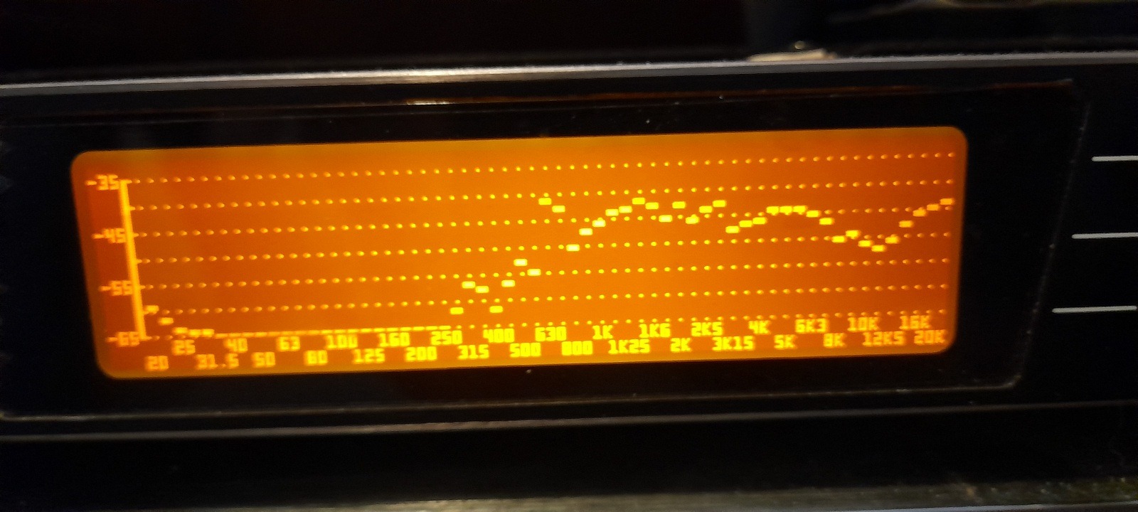

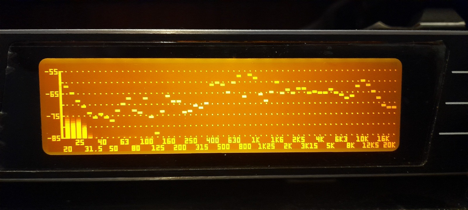

Pic 3 is with a small pea sized blu-tack over the matchstick which reduces the peak.

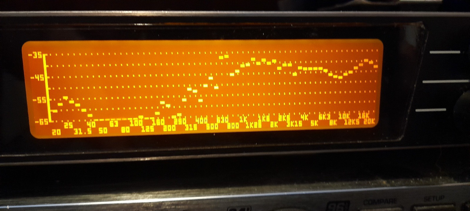

Pic 4 is with a larger blob of blu-tack spread out to cover about 1/2 inch ,this reduces it even more and does a little bit of smoothing.
As the mass is not such a problem , as the matchstick , panel and exciter magnet are joined together.
The sound is good too, as with the 5 inch panel.
I should have posted this years ago.
I was thinking maybe use a spring in the center or something more flexible to increase the low end ?
Maybe central mounting with out the spider even?
It works , but how useful it will be ,I'm not sure?
Steve
