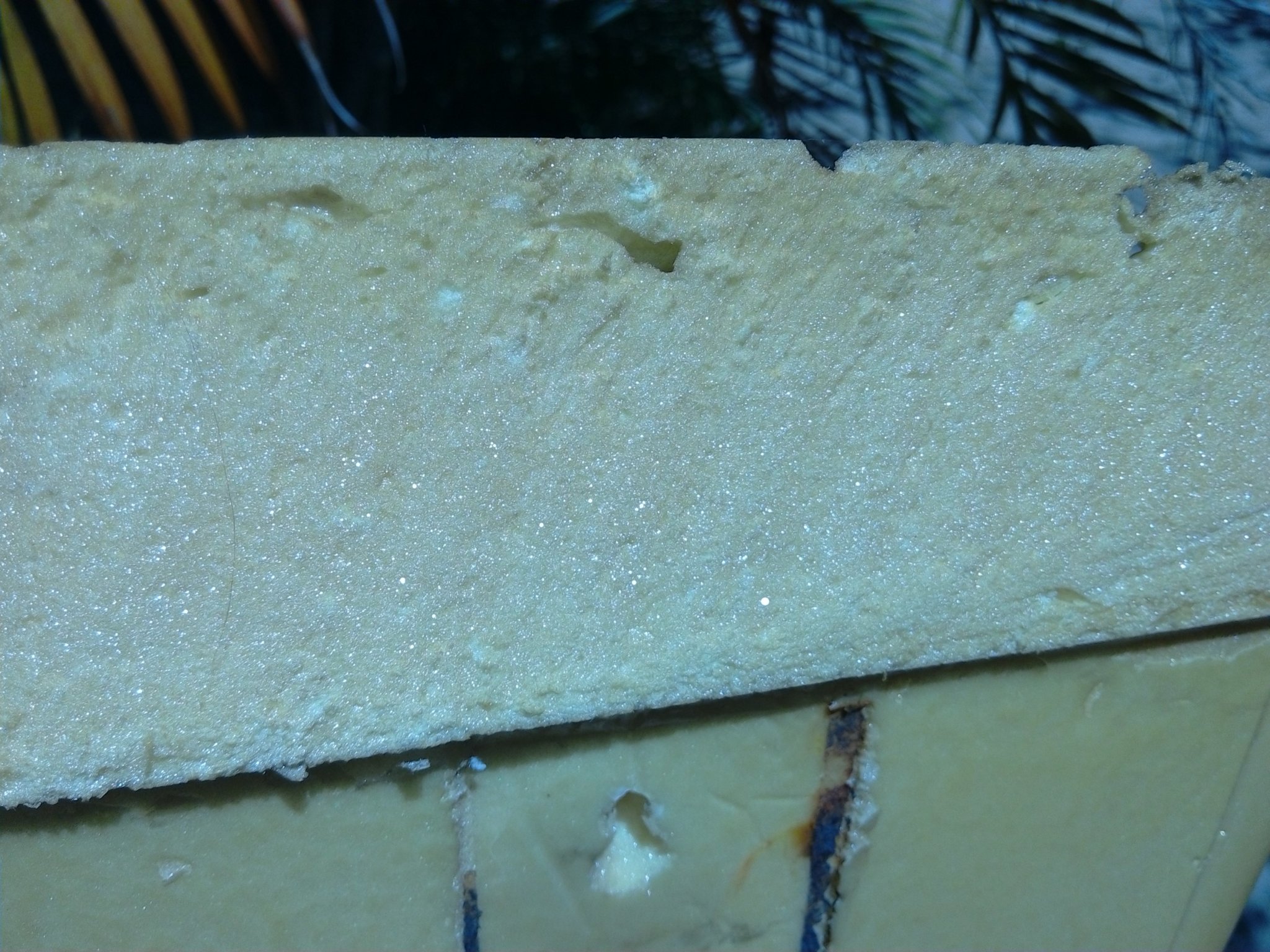

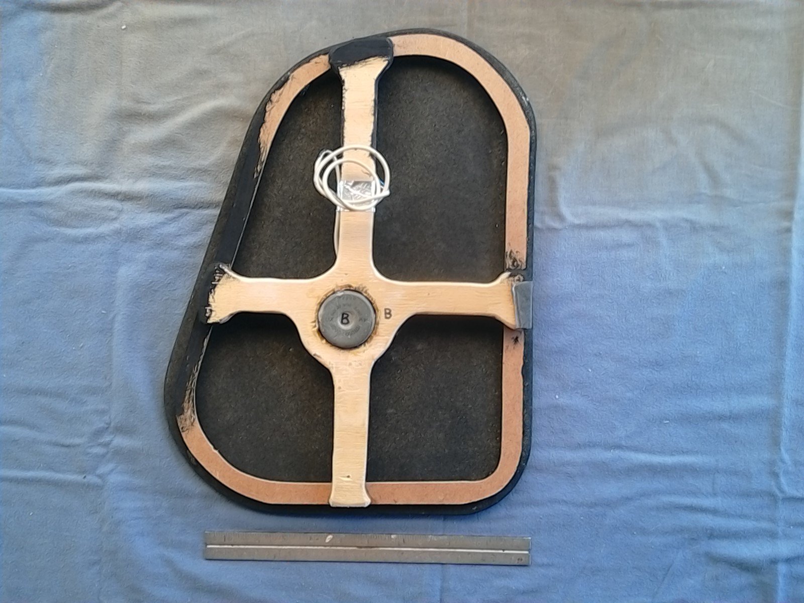

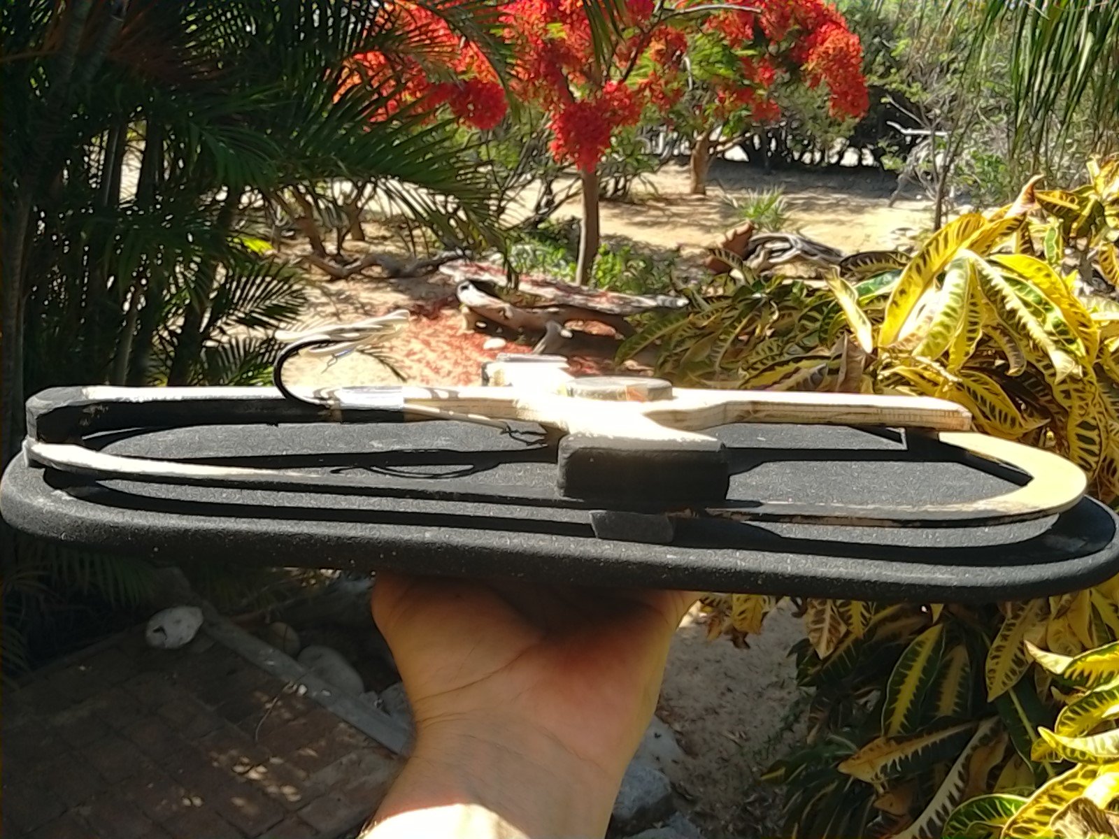

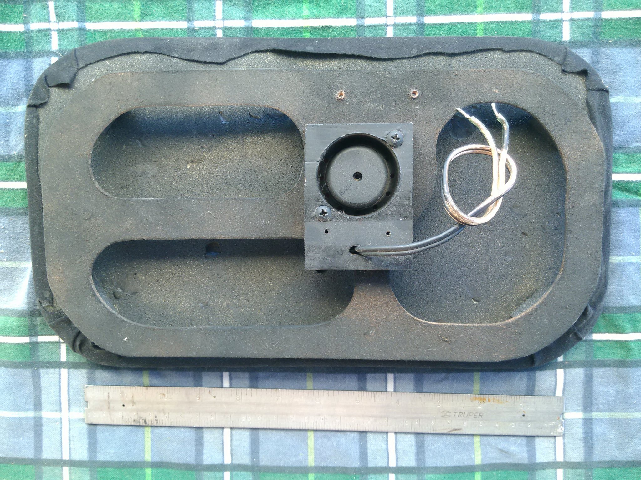

Allllll Right! I've been waiting for someone to try some of this out. I can't say more good things about this material than already stated in prior posts. Please check out some of these images below from said post's and let me know if it is indeed what you have.

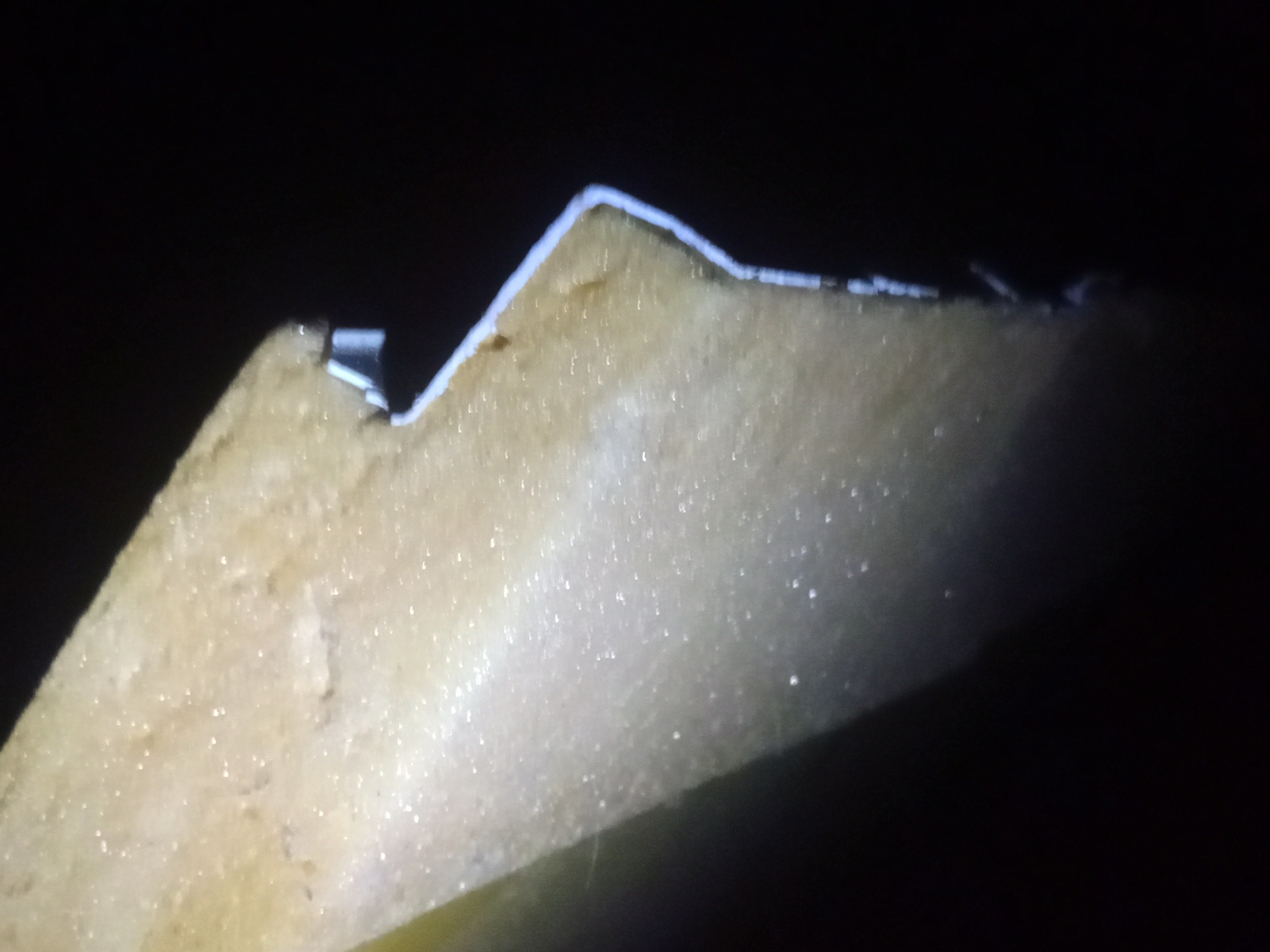

So this is my original build using the spray foam material if interested. They were made with some DIY exciters. These are the same panels (material) my buddy listened to but refurbished using a pair of DAEX25FHE-4's.
Post #3,207.https://www.diyaudio.com/community/threads/a-study-of-dmls-as-a-full-range-speaker.272576/page-161#post-6685870
I made the panels in this basic ear shape via Bertagni and for asthetics as they are mounted about an inch off the wall at an angle with about 4 1/2" clearance in the rear. I mounted the exciters pretty much center.
They average 1/2" thick as they are not perfect, and are 12" at the lower wide section and 16" tall.
Here are a couple of post's with photos where I explain the material: Post #7,748 https://www.diyaudio.com/community/...ll-range-speaker.272576/page-388#post-7208551
Post # 5,781 https://www.diyaudio.com/community/...ll-range-speaker.272576/page-290#post-7036391
Here is a post explaining my center speakers made from this material for better voice clarity and to conform with the R/L speakers which we are discussing. (I used to listen to my R/L's in conjunction with a nice pair of JBL bookshelfs but just use the panels now.)
Post #6,073 https://www.diyaudio.com/community/...full-range-speaker.272576/page-304#post-70756
Below are some photos from above posts:

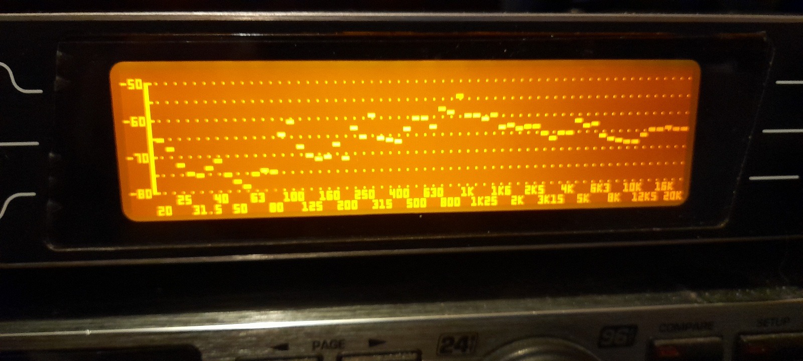

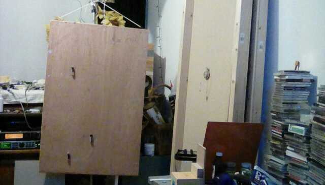

Pixel1.

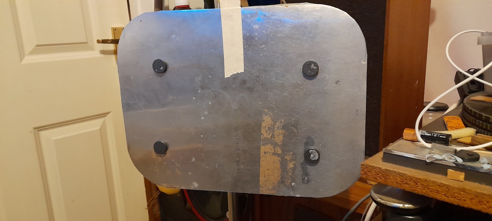

Last night at about 12midnight I went into my room to hook up a eps panel to work on today.
But I changed my mind and put up my aluminium panel instead.

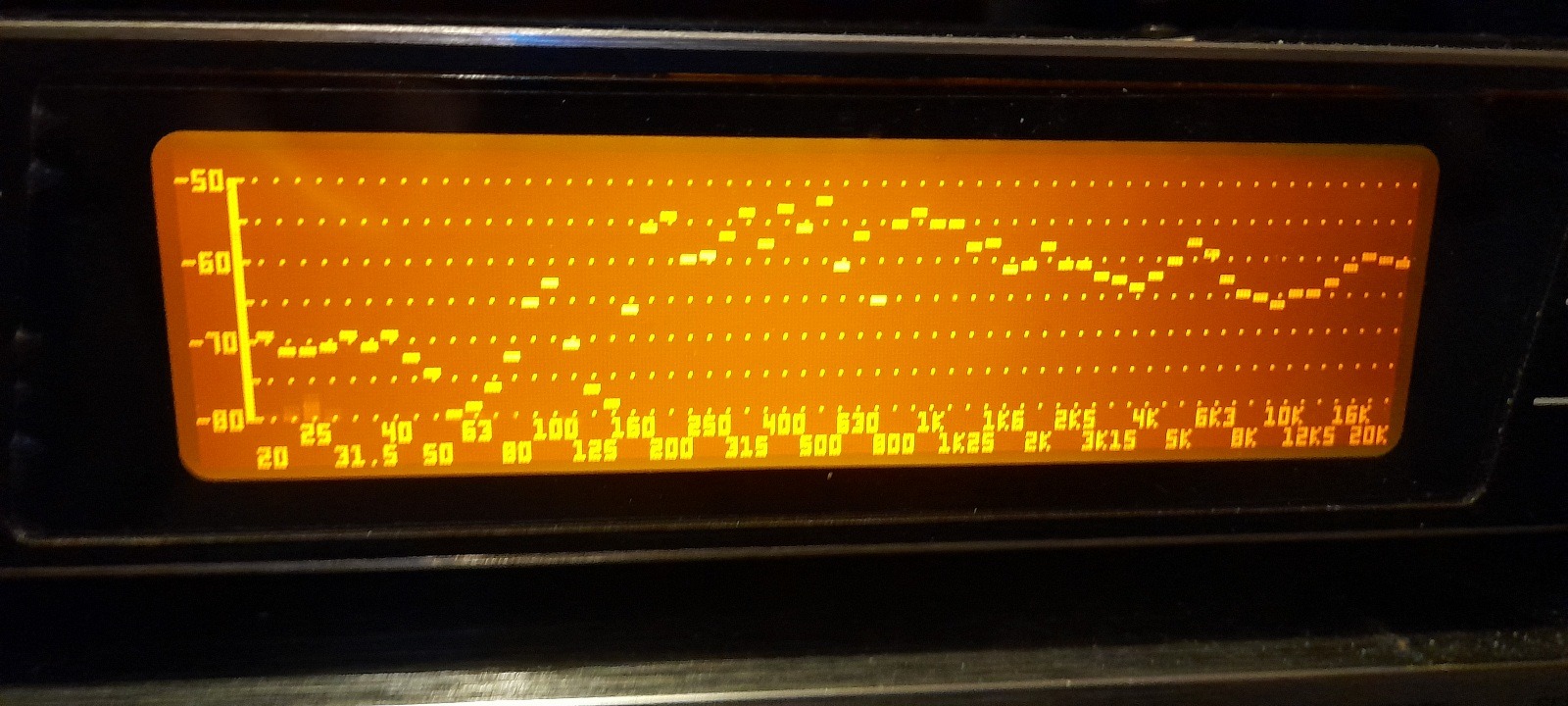

I thought I would do some quick measurements using weights to change frequency response.
I get the impression that no one thinks weights are of much importance ?
If you have a panel that has suck outs in its response in the 100hz to 300hz or any where up to about 1.5k (this is always depending on the particular panel) you can adjust the response (maybe) with weights.
I wanted to get to bed so just quickly attached the magnetic weights into the positions shown in the pictures after moving them around for a few minutes while monitoring the response on my DEQ .
The first picture is the panel with the weights in position.
The second picture is the response without weights.
The third picture is the response with the weights.
The responses with the weights has increased the output in the suck out areas by 10db and by some 5db higher up to about 1.5k.
It took a bit longer than I expected ,as I only have one pair of hands and a rather large dog to contend with,so did not get to bed until 2a.m. 😴
Pictures in next post.
Steve.

The material is of the same family, but specs vary with this stuff. The foam we can buy in a can in Aus has a free expansion of 3x, whereas yours states 25mm filling capacity. The end density is obviously affected by the mould (mold) constraints.
In my previous life as a consulting structural engineer, I was involved in several projects where construction quality Urethane foam was used to lift :
a) a heritage building which had subsided
b) rigid paving areas in building aprons
c) approaches to bridges
The density of the construction material is much higher than the consumer foam.
In the case of a), the foam successfully restored the building, but found and filled breaks in old stormwater pipes, and caused foam geysers to erupt in lawn areas surrounding the building. We were forced to do a dance to avoid the eruptions. 😊
I was experimenting with the foam for a different purpose which I'll spell out in another post, but i would be interested to hear how you made the mould (mold) and what release agent you used.
I believe making a panel from this material is well worth a try
Cheers
Eucy

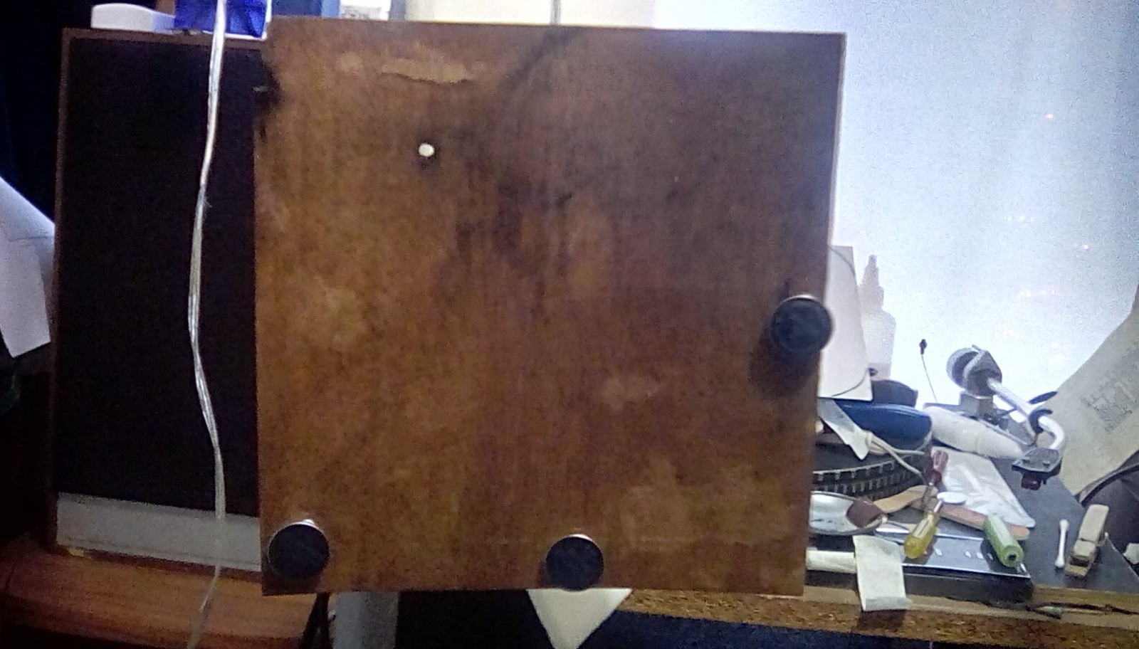

Steve.
Hello Steve
You are probably right. I haven't made test with weight. 2 reasons : in my mind (probably wrongly) added weight is synonym of inertia, maybe loss of efficiency (this is only opinion!), I have no clues (and I haven' explored!) or methodology to to it. Would you help on the way to proceed, the range of weight?
Christian
PS : in Tectonic pictures, if I remember, there are some weight added.
Steve,
Oh, no, just as it sounds. Welcome back. I missed your down-to-earth sanity and good advice. I haven't been doing anything to my panels at all. I have been coping with health issues, another neck surgery, a right hand that has little to no grip strength, and ongoing pain. Your posts provide good relief.
Christian.
every panel is different, so you will have to test your own panels yourself.
The first picture is from the pro dml panel forum on audiocircle.
There are three AA batteries held on with blu-tack, there was originally four but one had fallen off ,I think it was in the top right corner somewhere?
In the second picture I used 6 magnets( 3 pairs) on this smell 1mm veneer panel.
It is easier to just use you fingers to find the correct positions on smaller panels.
some panels ,like the proplex panel ,do not need weights as the frequency response is fine.
The weights I have used here, were only test weights ,and if used permanently I would have tried reducing the size and weight.
or as I have said before, maybe used the positions to mount the panel.
I do not use damping or weights on my EPS panels but maybe very small weights could be used if wanted ?
It all depends if you think the weights improve the sound or are even needed if using a higher XO.
It can be a useful tool of needed.
Steve.
