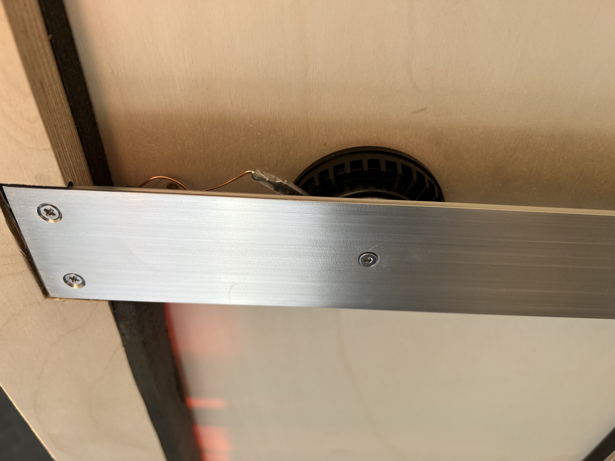

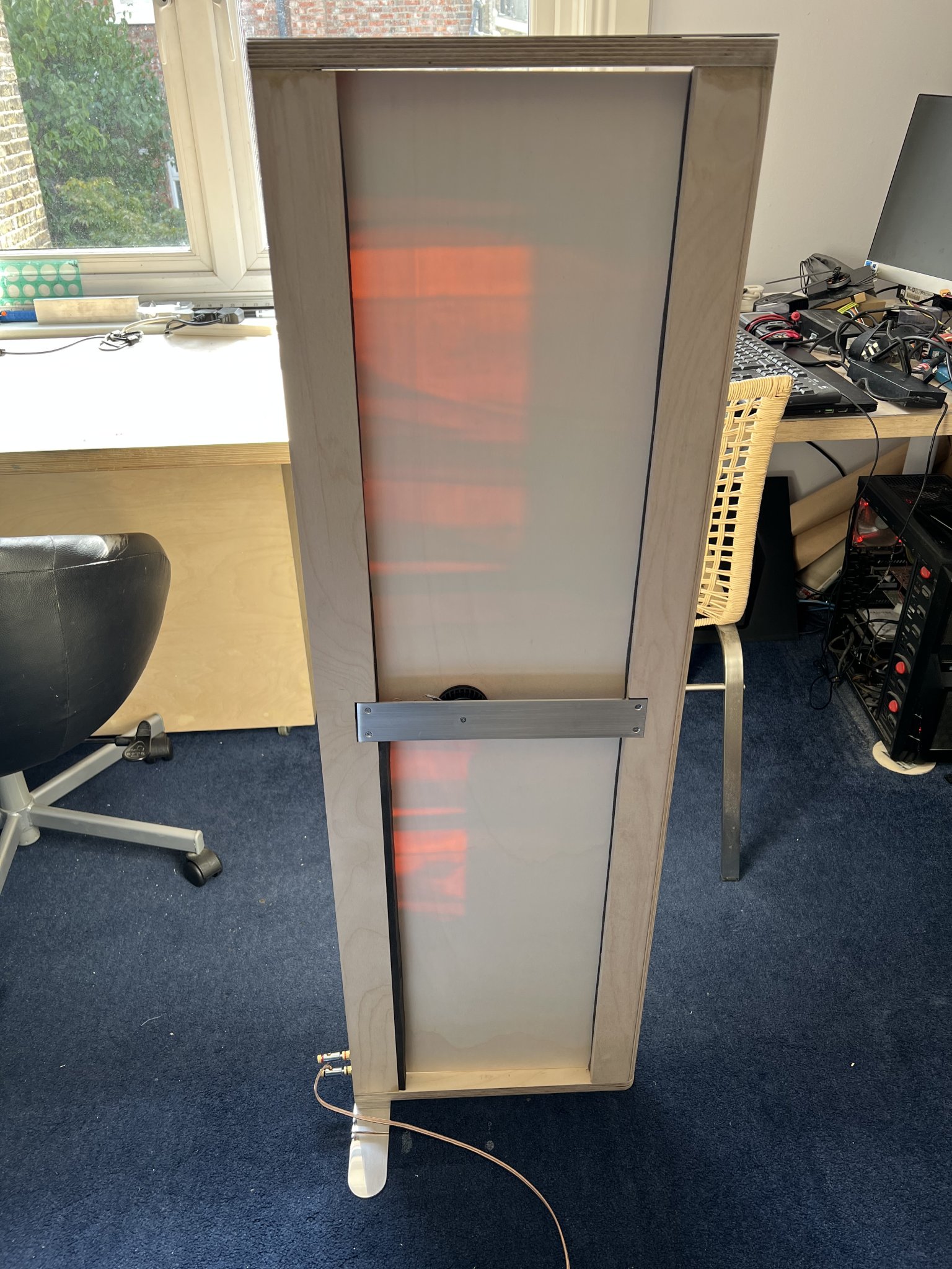

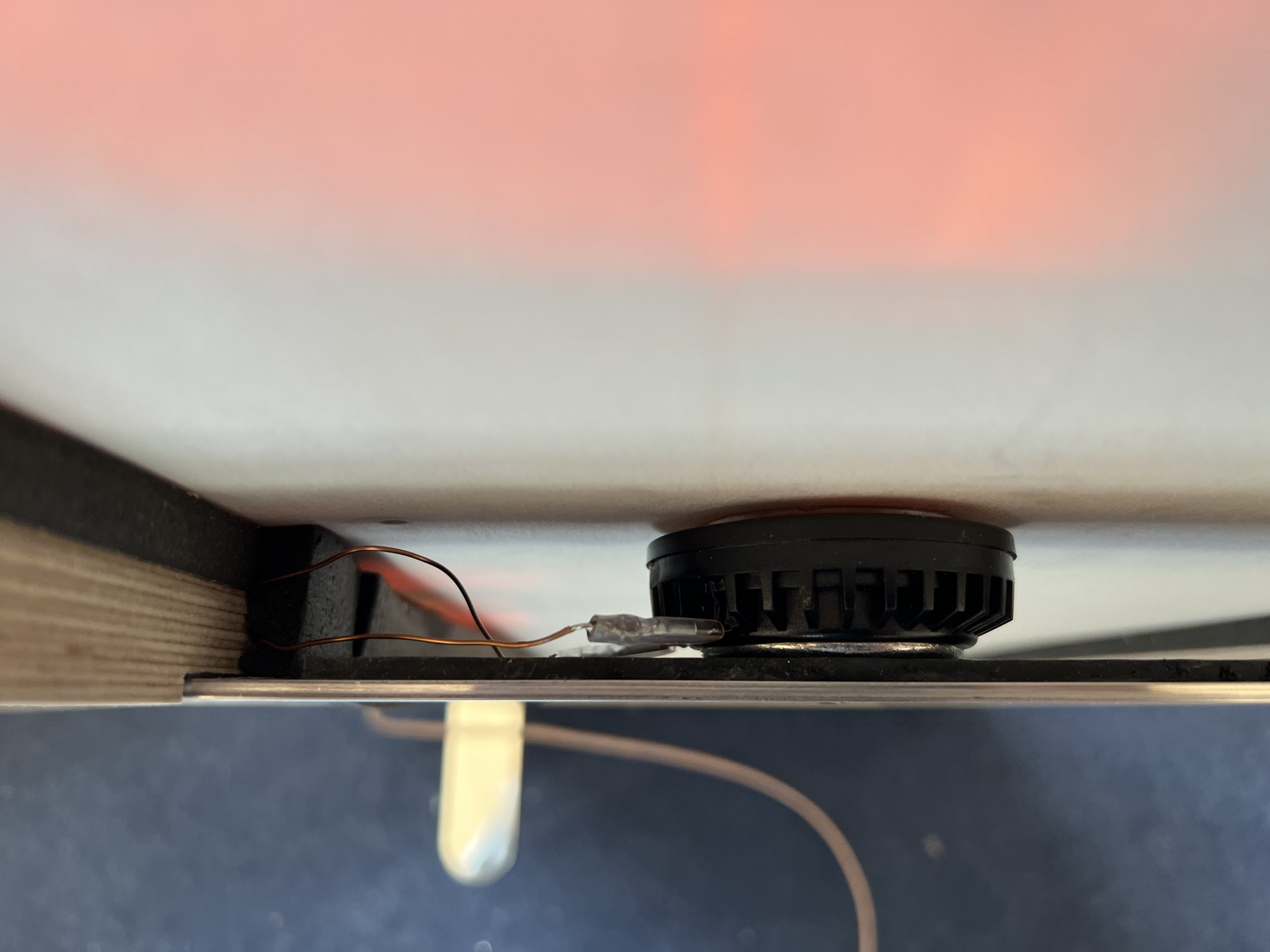

Aluminium isn’t essential for an exciter frame, MDF or Ply would work just as well and can be machined at home using a router. Tectonic use an Aluminium casting because if you are making large numbers then the tooling cost is not high spread over many units and a casting itself is quick and cheap to produce. If you are not happy with routing it yourself the cost of CAD routing by a local machine shop would not be excessive and give you a great result.
If you are dead set on aluminium consider fabricating from Aluminium extrusions. I only use one exciter on a panel substantially larger than Tectonics and use an Aluminium extrusion for the exciter back brace. If you are concerned about stiffness you can epoxy two extrusions together to increase the thickness. As you are using four exciters you could start with an aluminium plate for the four exciter mounting points plus a couple of flat bar extrusions epoxied to the plate to connect to your frame and mechanically it would be the same as the Tectonic frame although you will have to think through the aesthetics a little .
You will see from the photos that I damp the Alu using vibration reduction pads as Eucy is right Alu will ring unless damped.

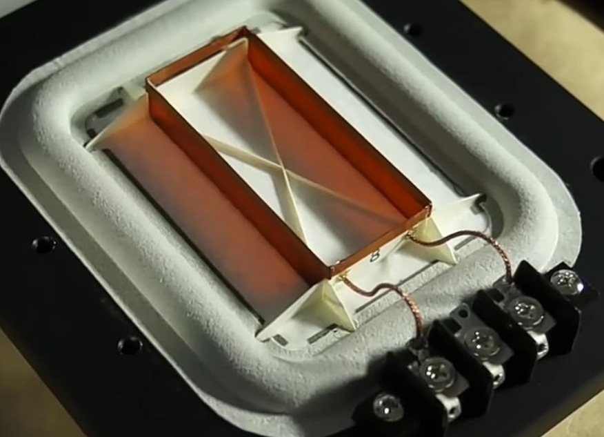

Sure, why should anyone wants to know anything about new motors for DM panels, when they have round exciters?
Anyway, the suspect looks like this, or supposed to be...
And, the older Japanese motor for flat panels...
Has been used for few decades, they say...and, the composite panel can be less that A5...
