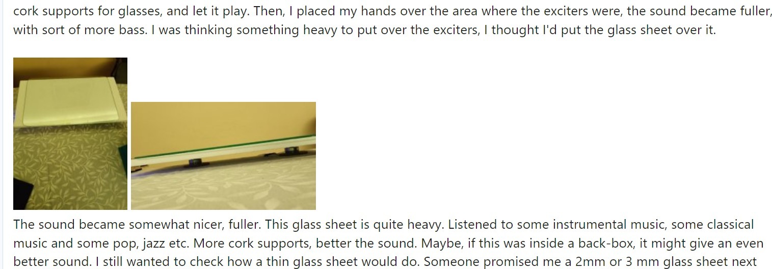

A 60cm x 40 cm 6mm thick ~4kg glass plate over 70cm x 40cm x 2cm EPS sheet. That was purposely done. Rest you can read there. No motion, just vibrations.
Then read the next post...
