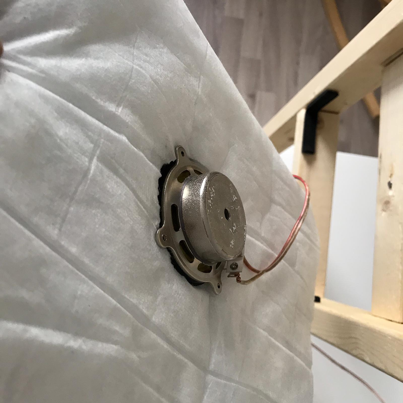

no I meant to ask why my dml even though it works fine doesn't seem immune to feedback? what should i check?
It will depend on materials used and how many exciters used on each panel. Lighter materials (like EPS/XPS) are more diffused while heavier/denser materials (like plexiglass) will be less diffused. Also when using more then one exciter you can get resonance peaks especially on the denser materials causing more mic feed back.

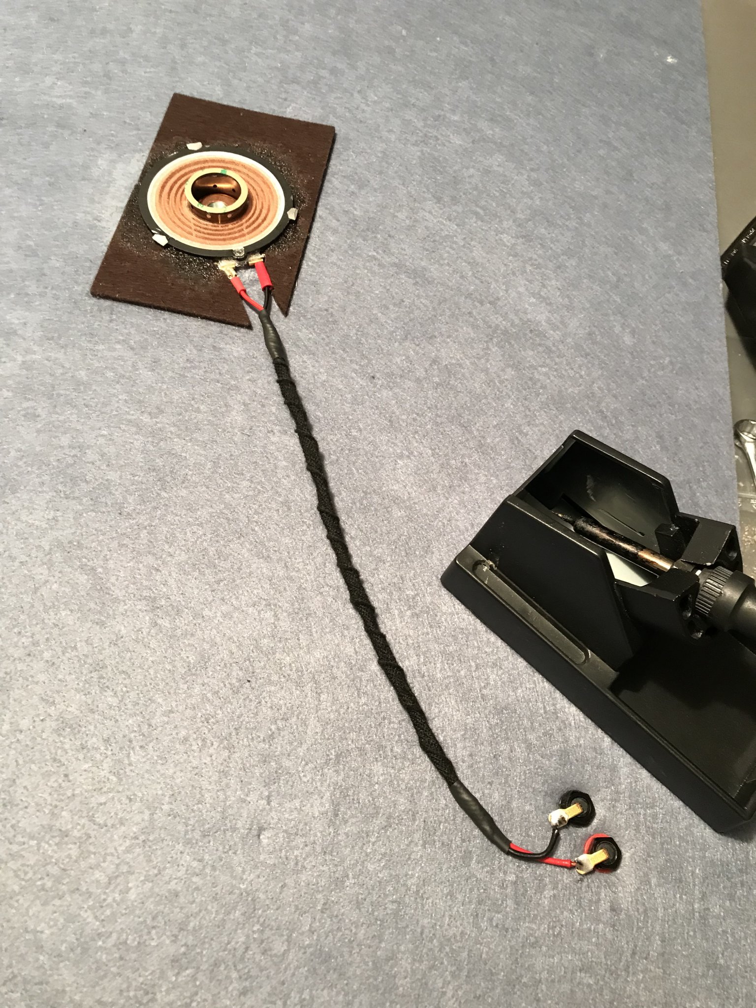

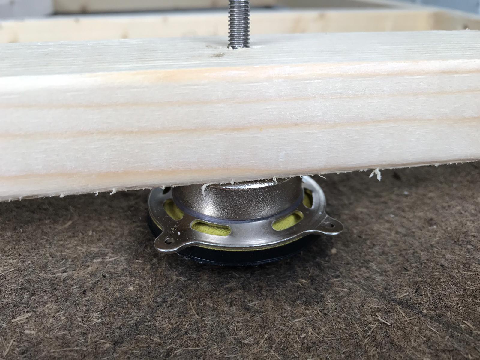

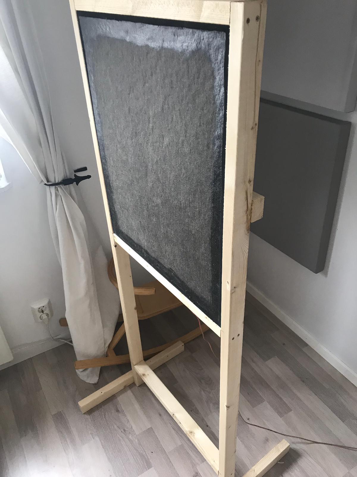

I built some DML speakers for my karaoke system a while back and no feed back even when standing in front of the speaker with the mic. I cant do this with conventional cone speakers.

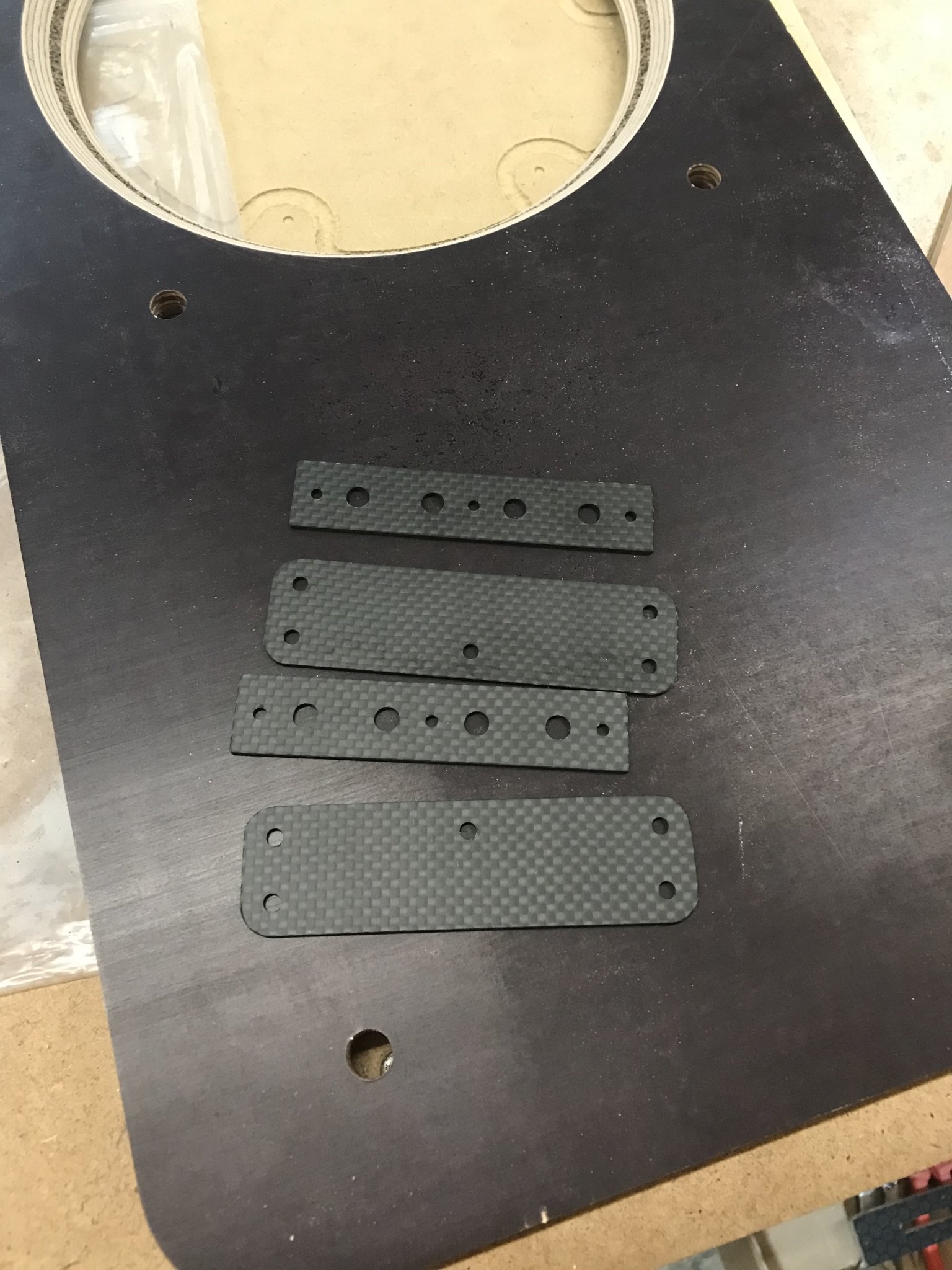

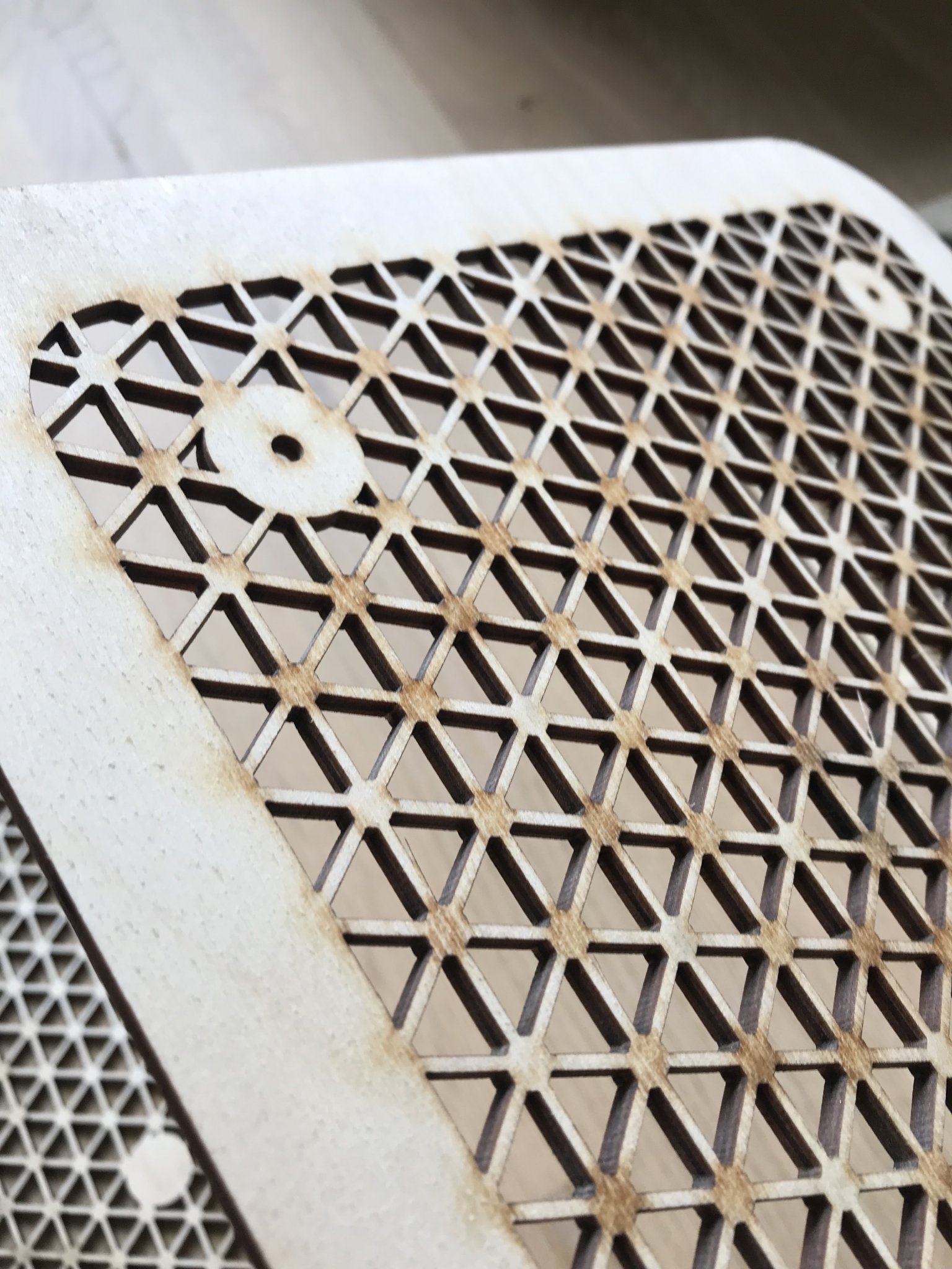

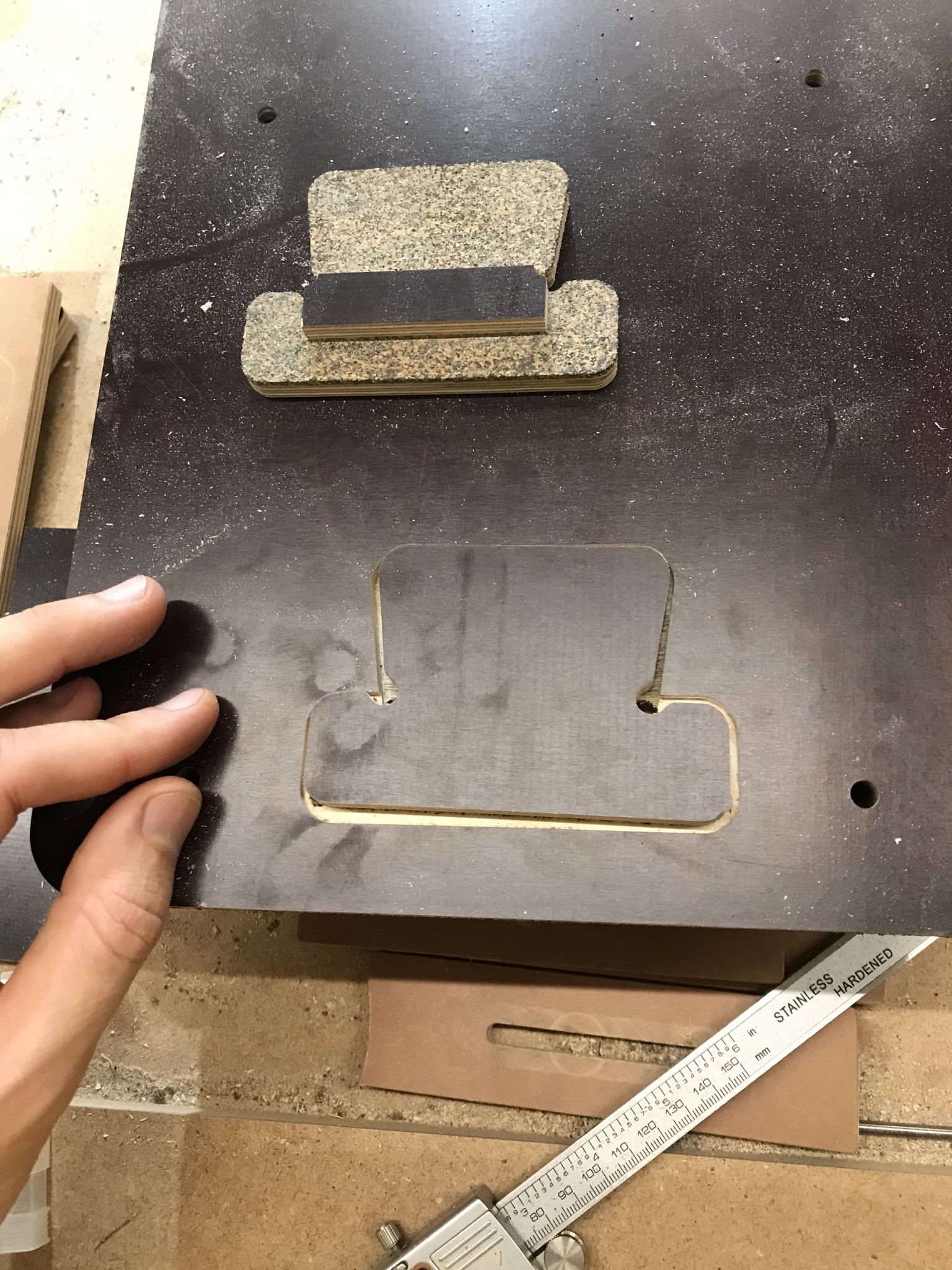

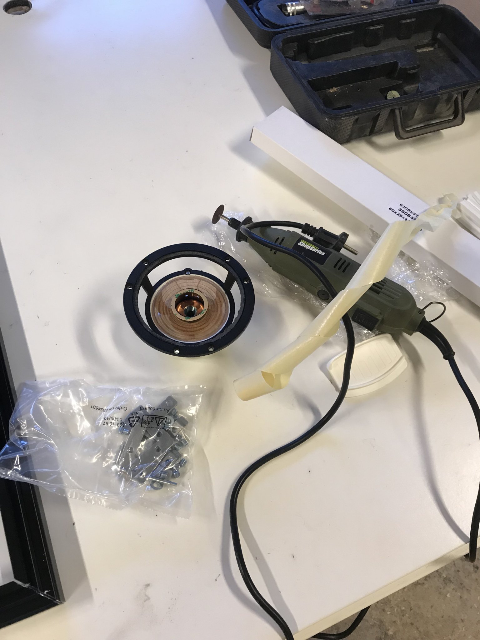

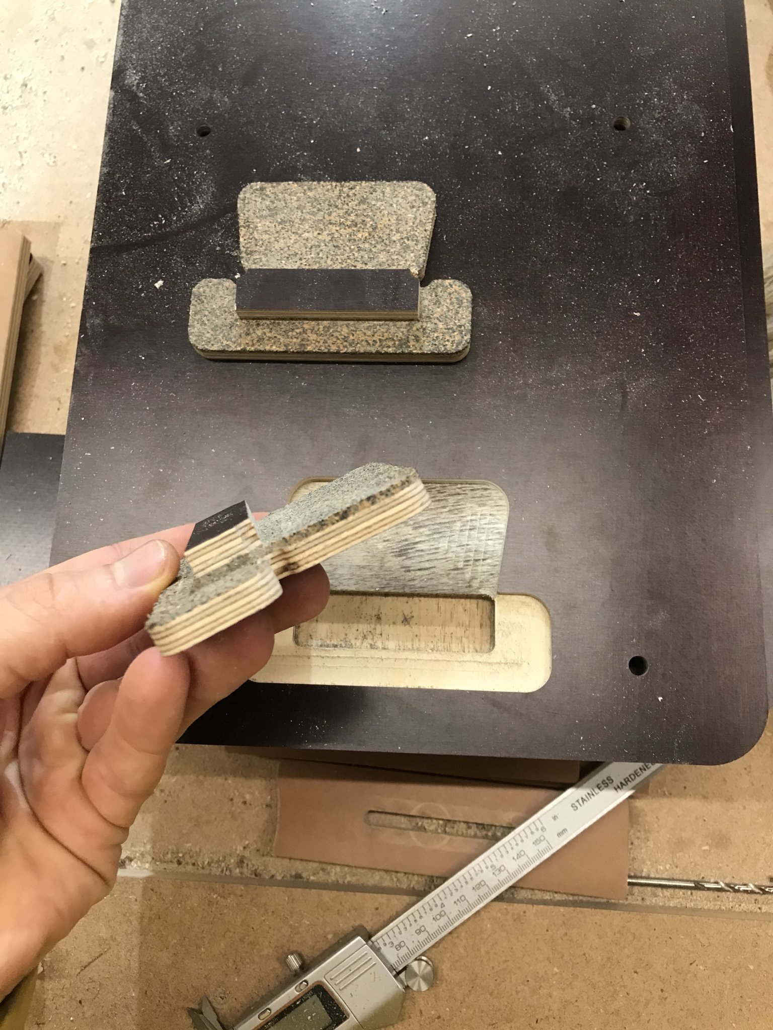

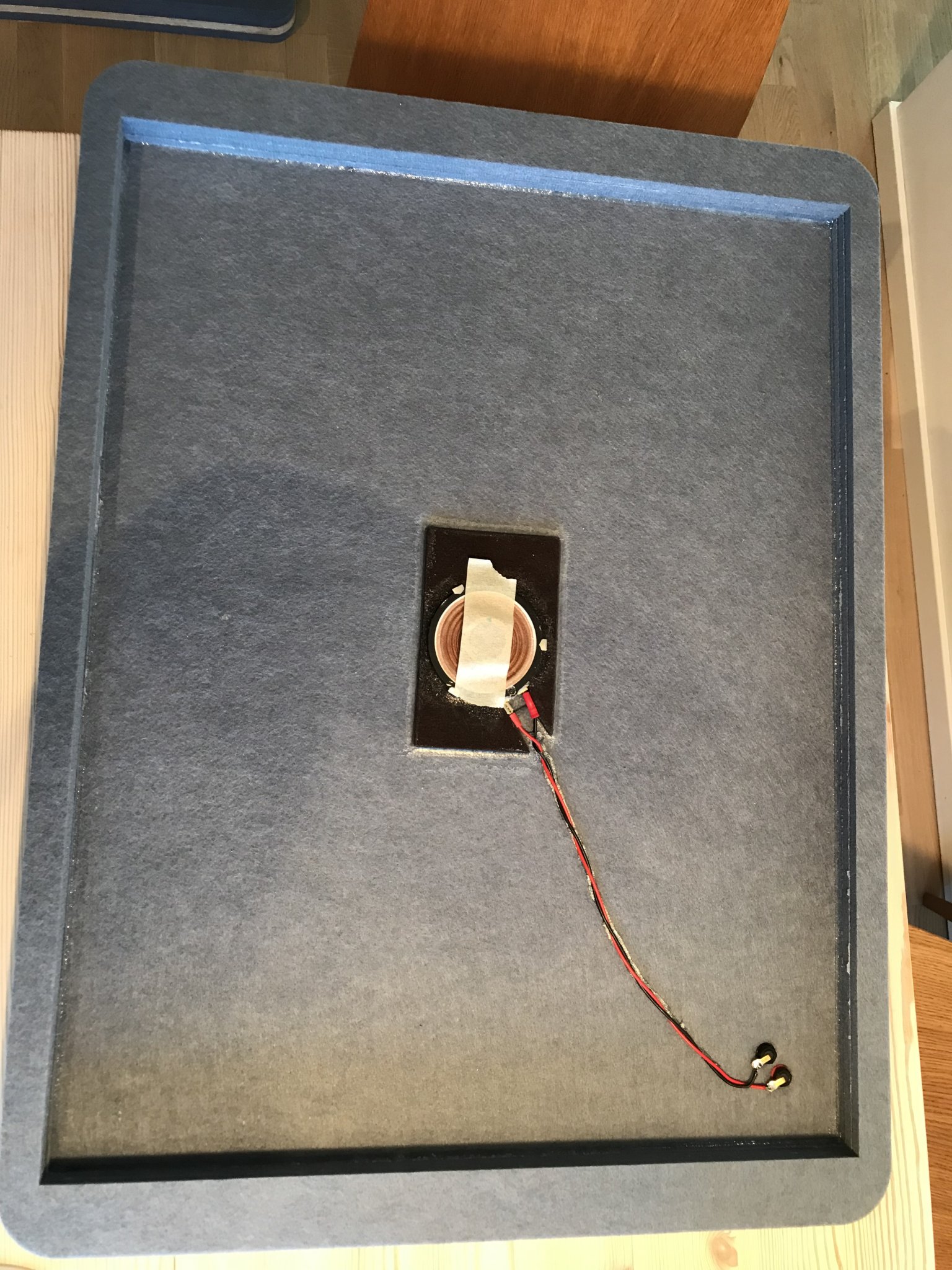

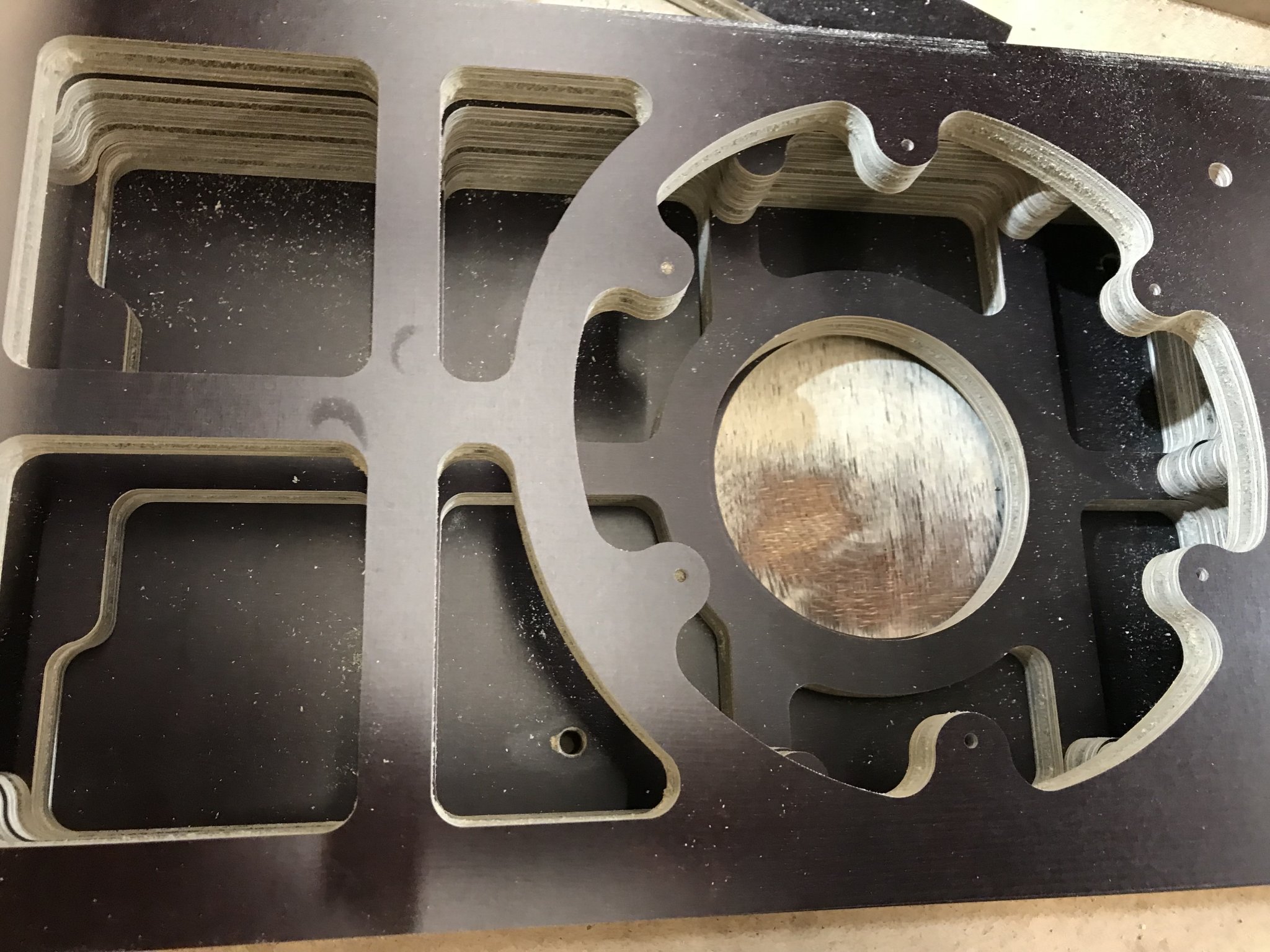

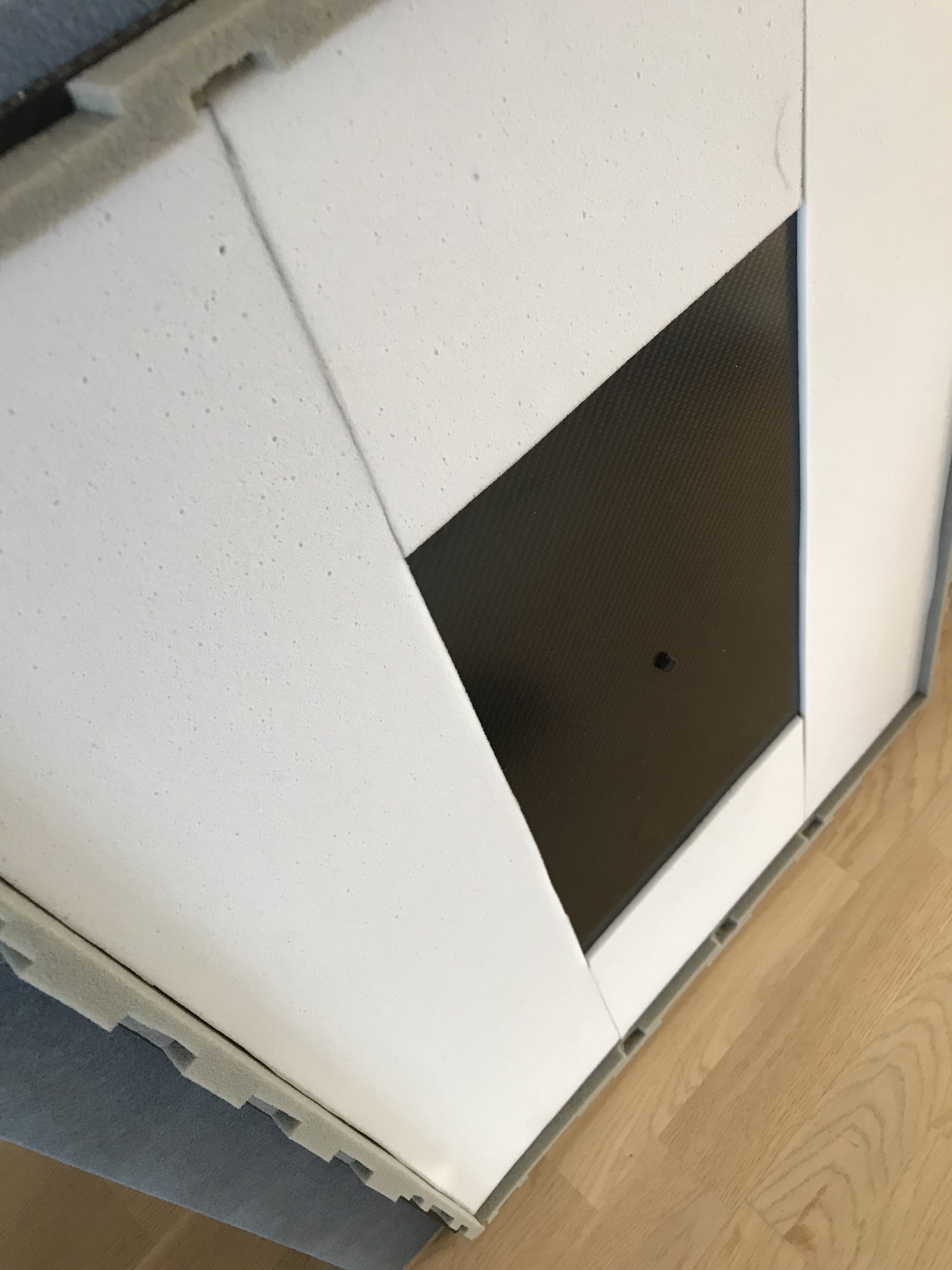

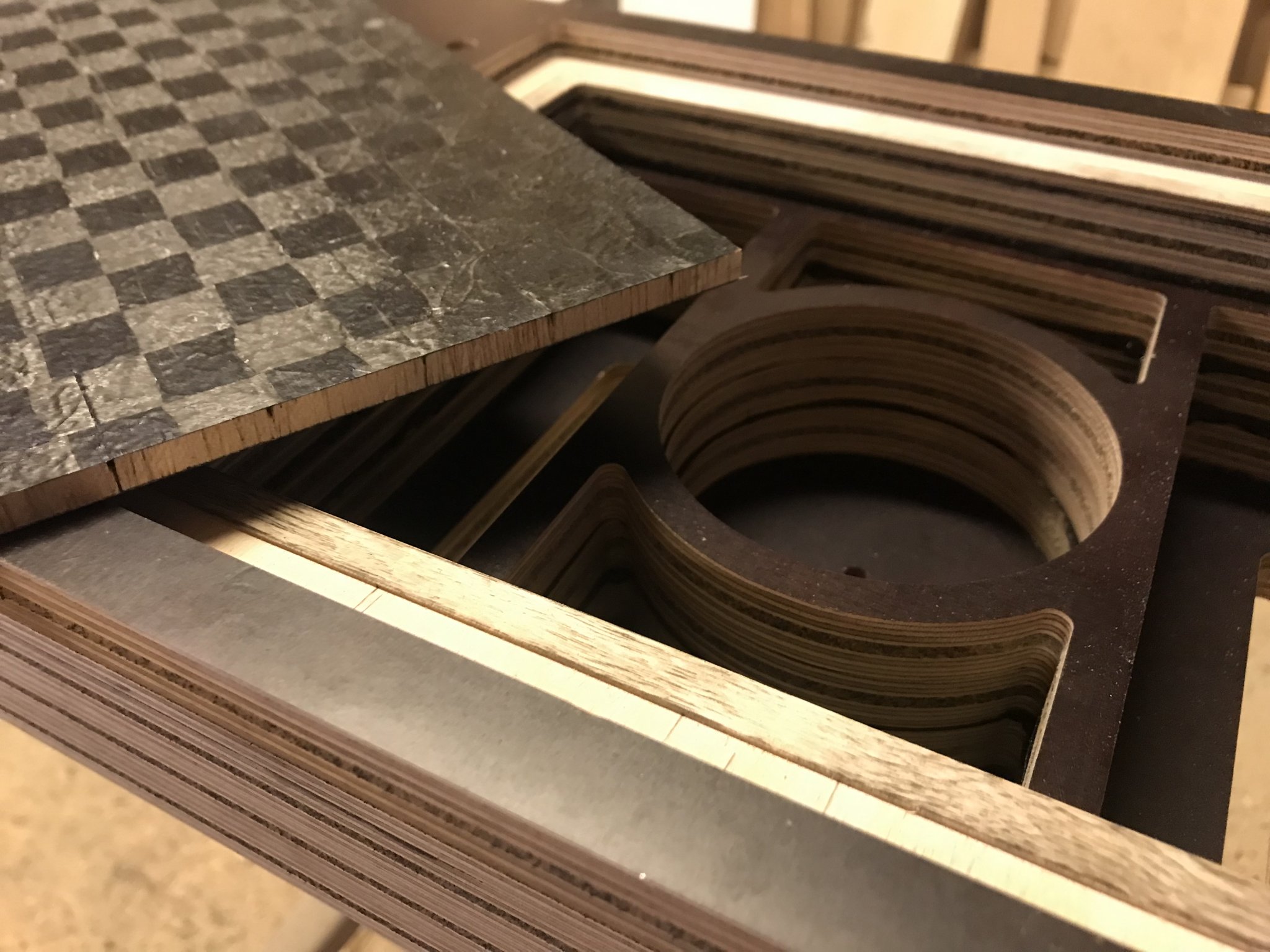

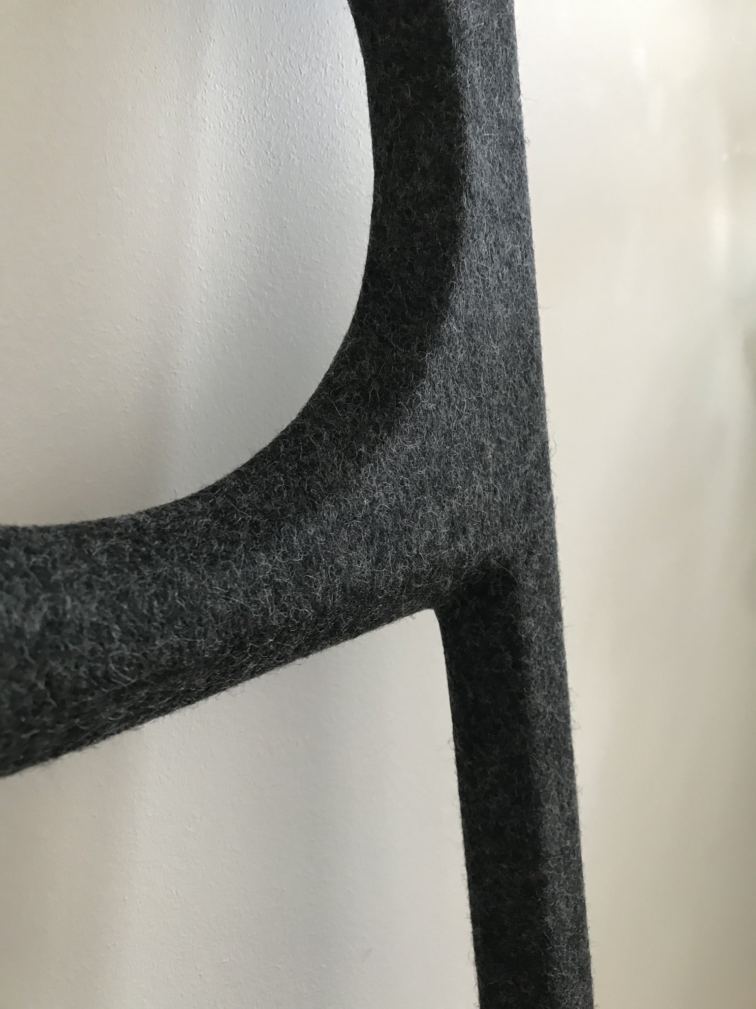

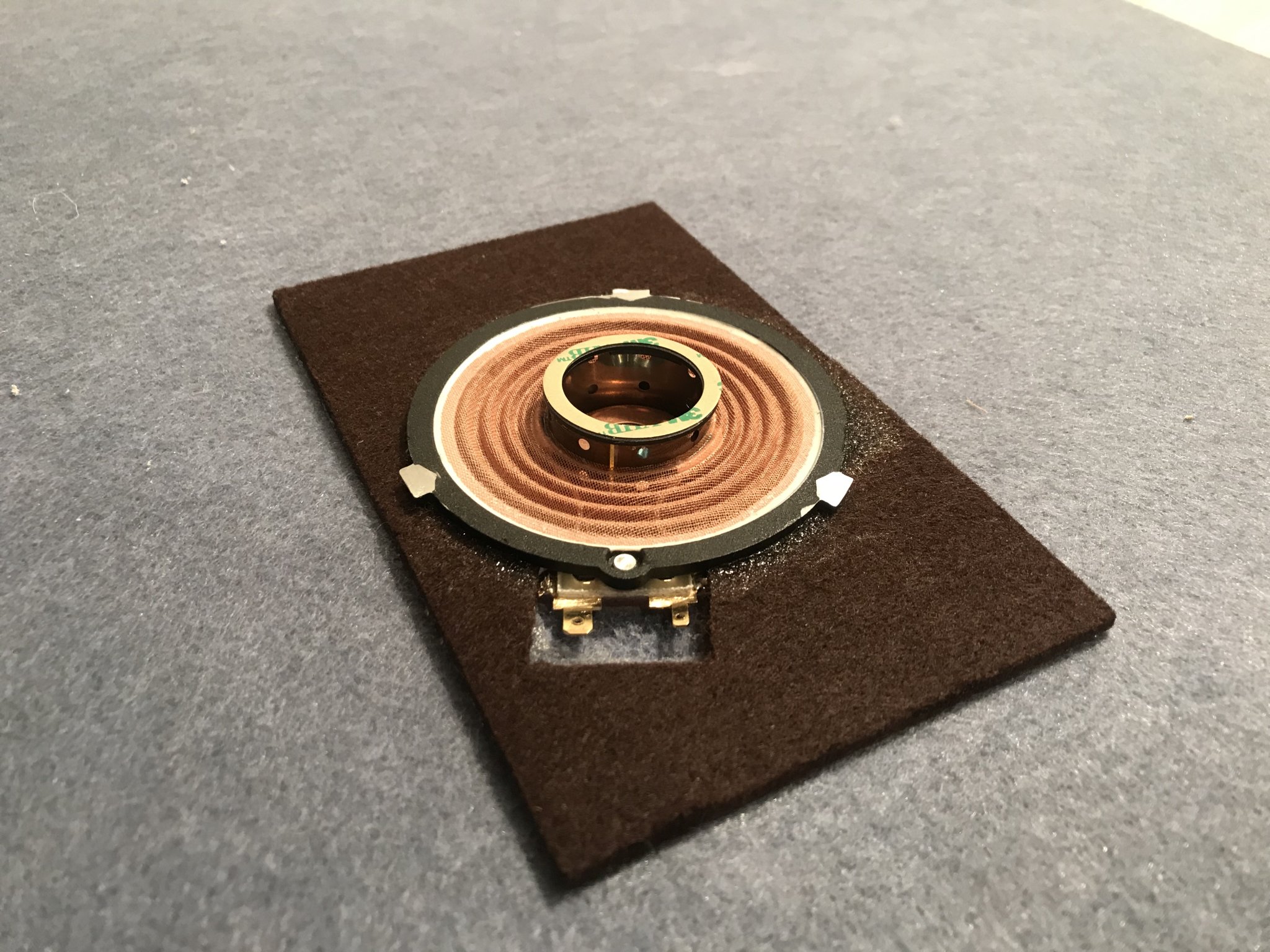

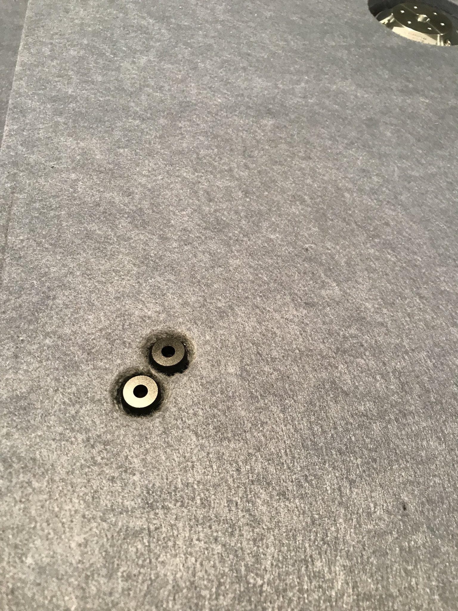

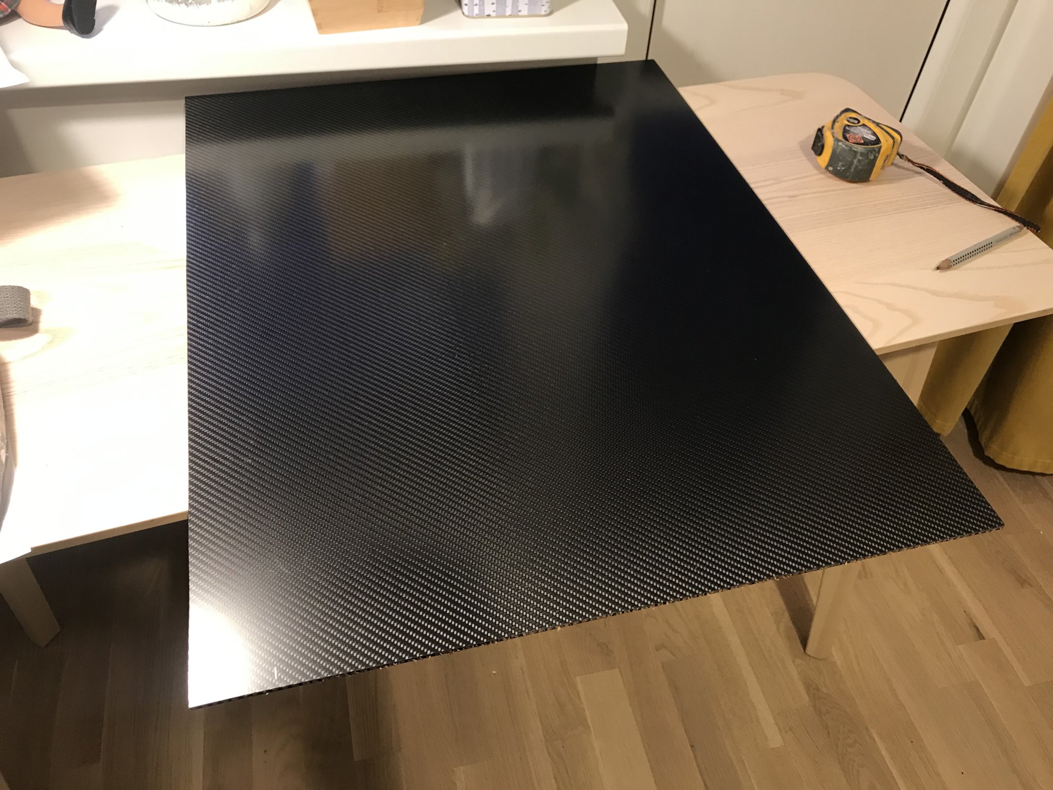

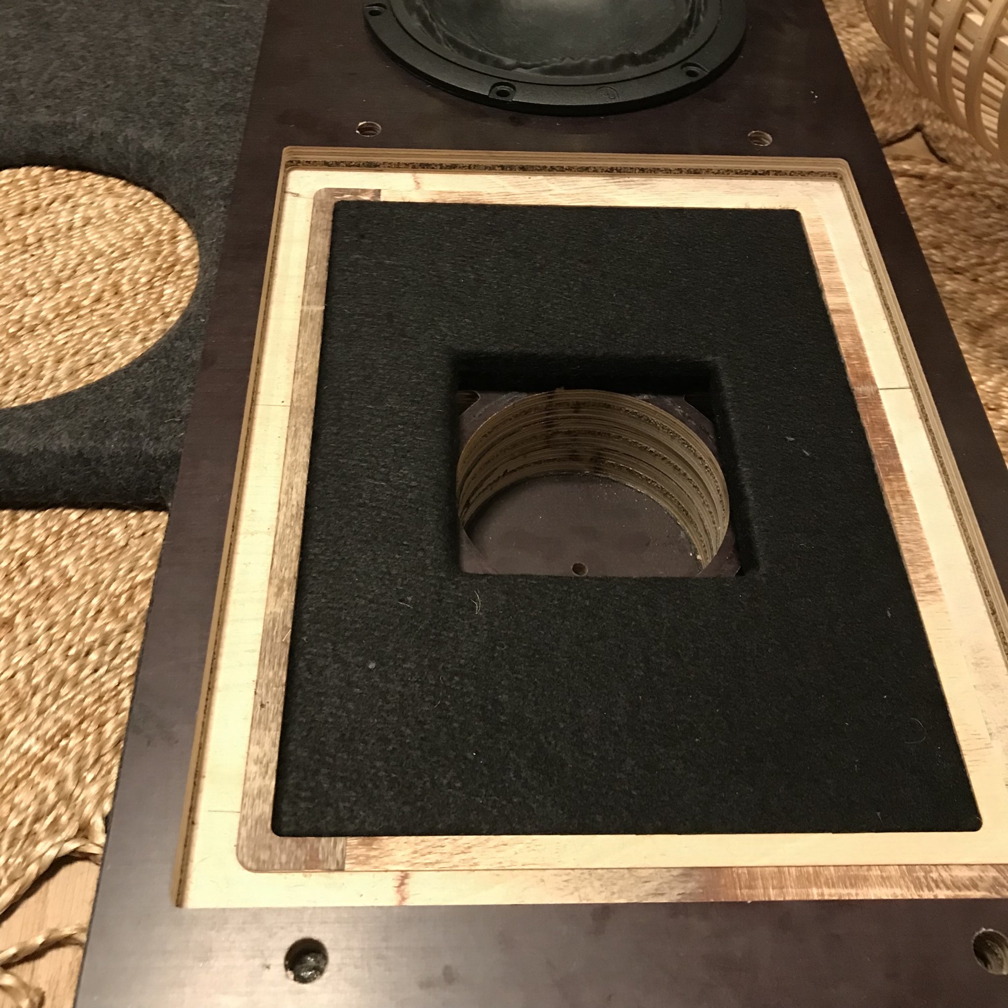

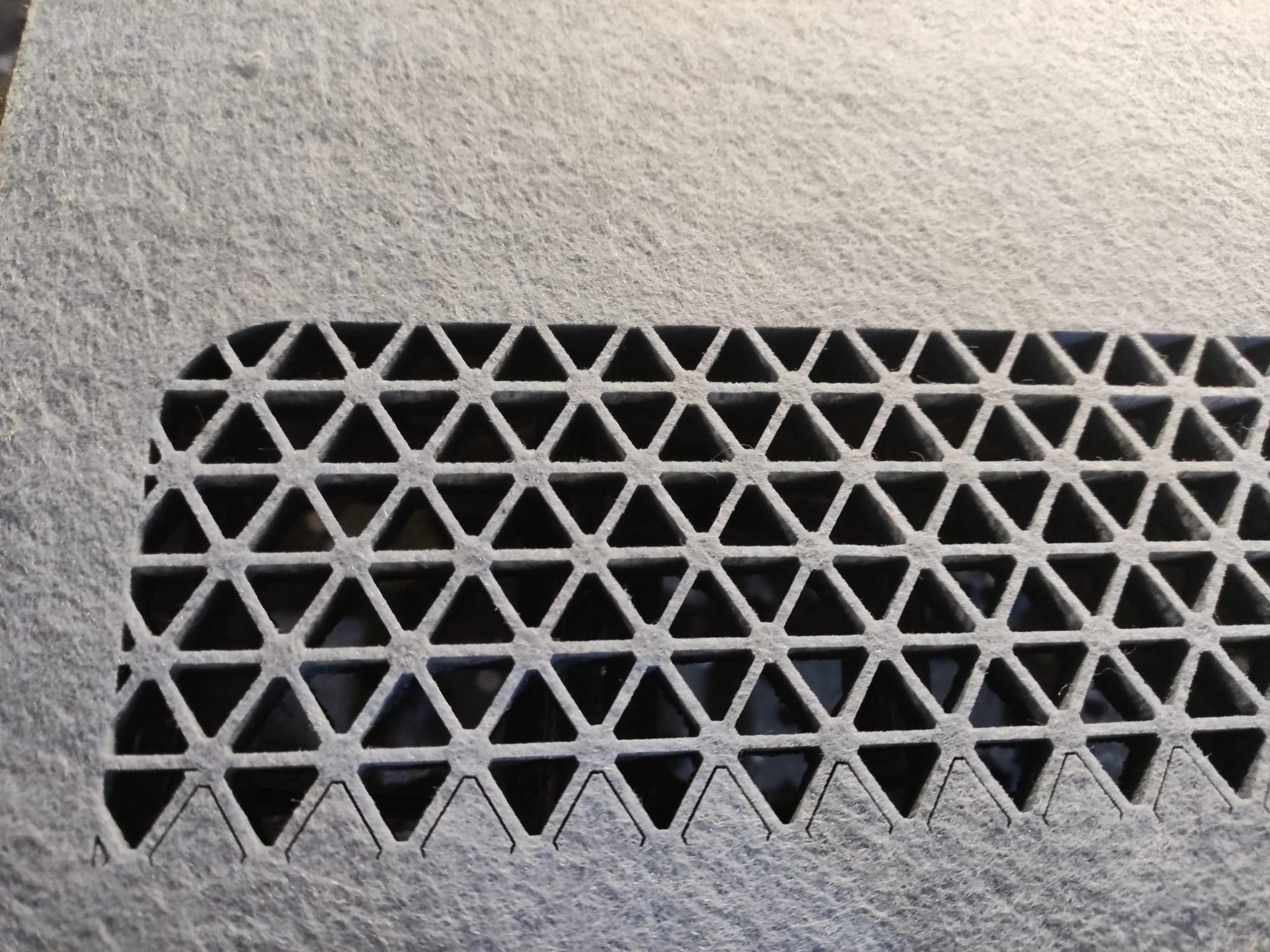

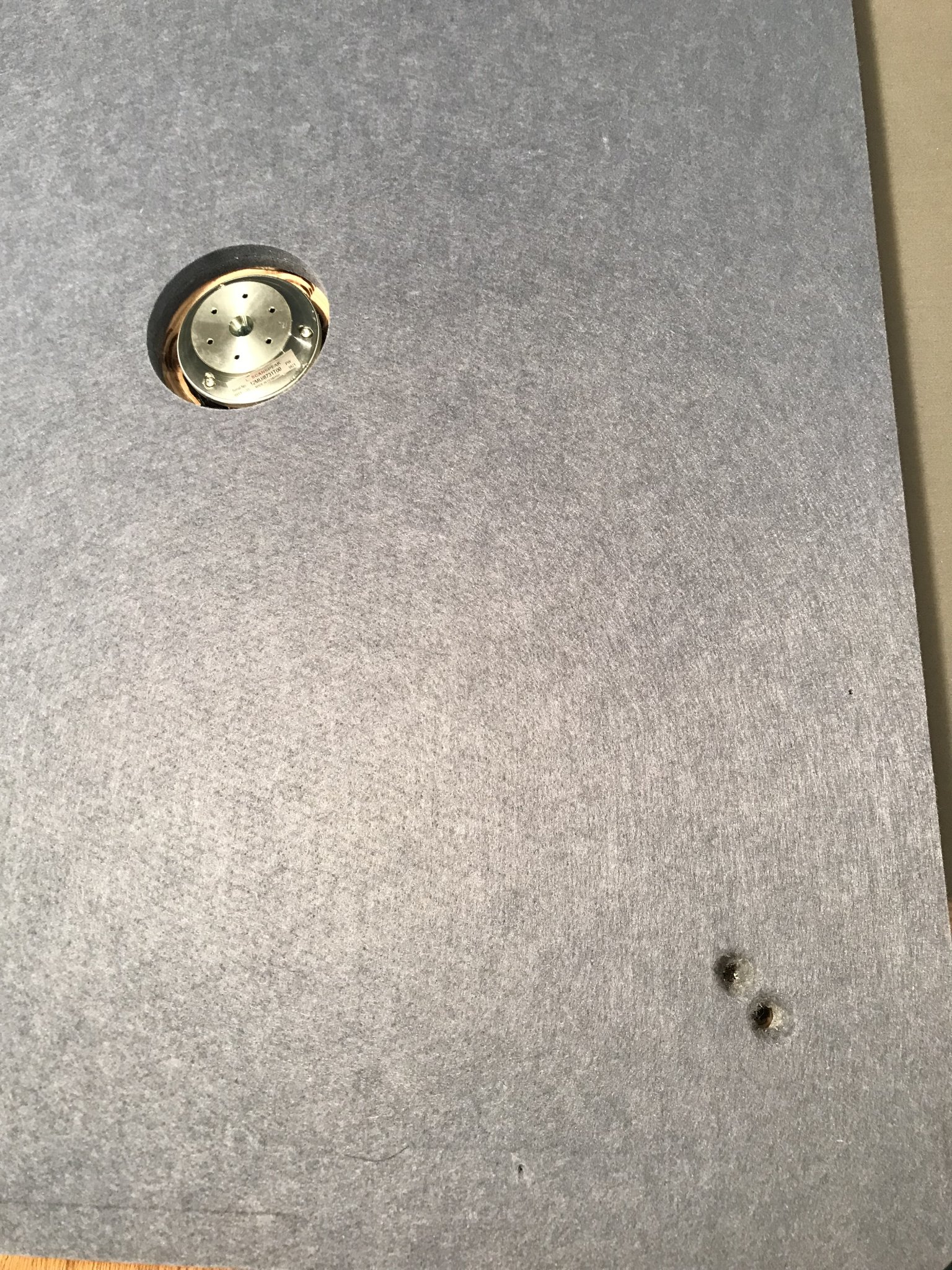

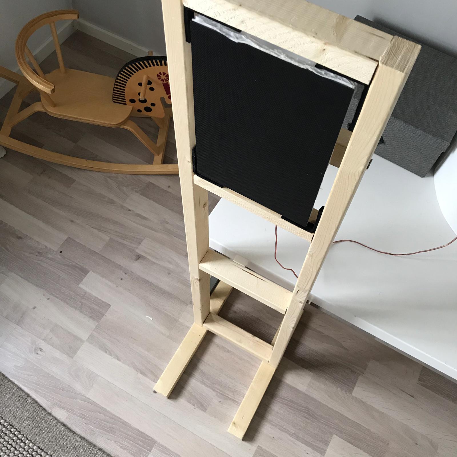

Could you please write more about your creation? Some photos, if possible? Thanks
There is huge difference between what I read, my expectations and what I experience when I build. Mostly my imagination builds expectations too high.

Agreed!
Await your description of your creation and your imagination. 🙂

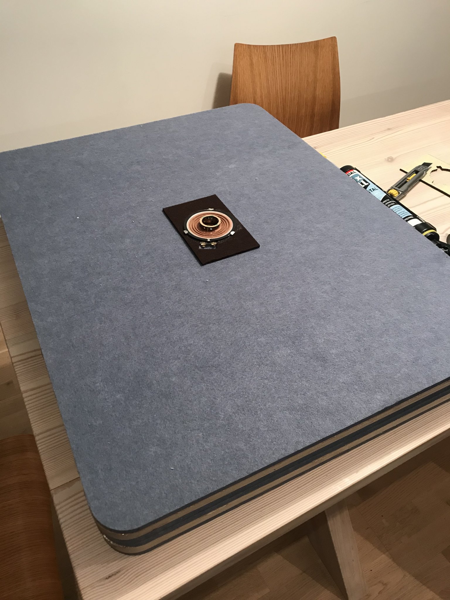

Sound and design are equally important to me. I will be in Munich High End show this May to touch and feel, get inspired.

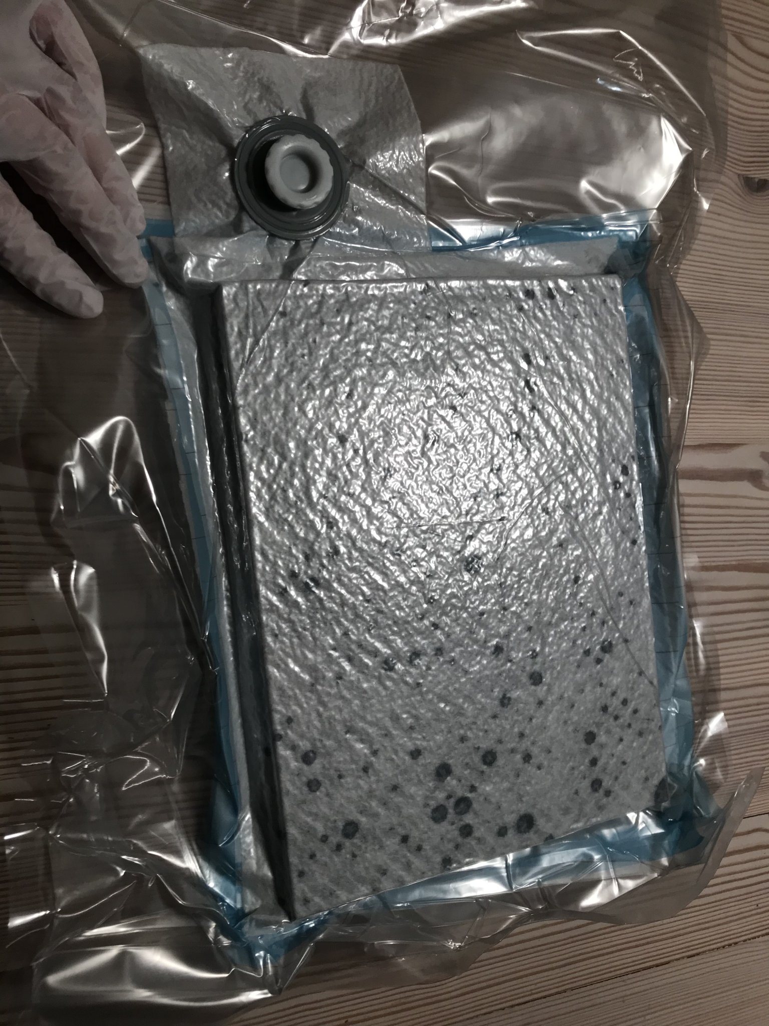

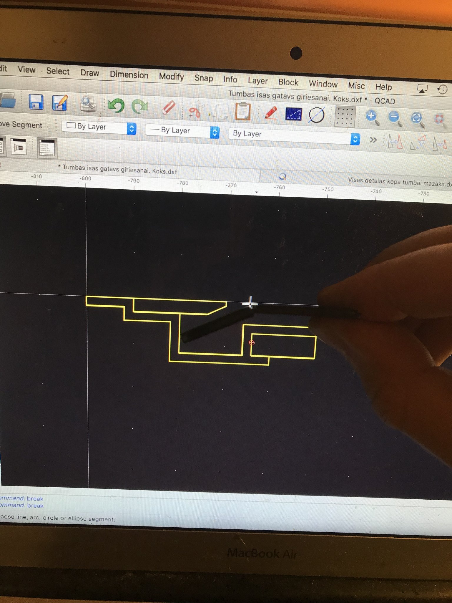

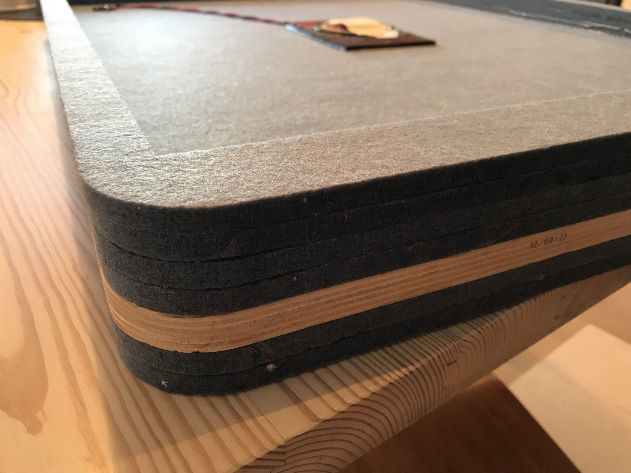

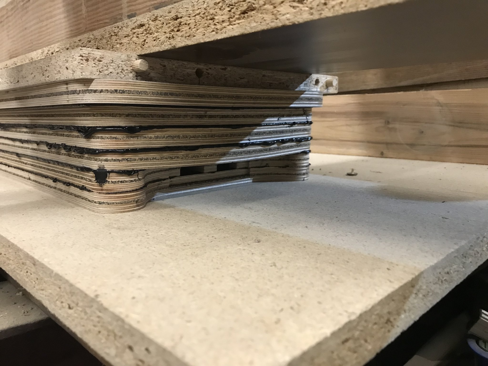

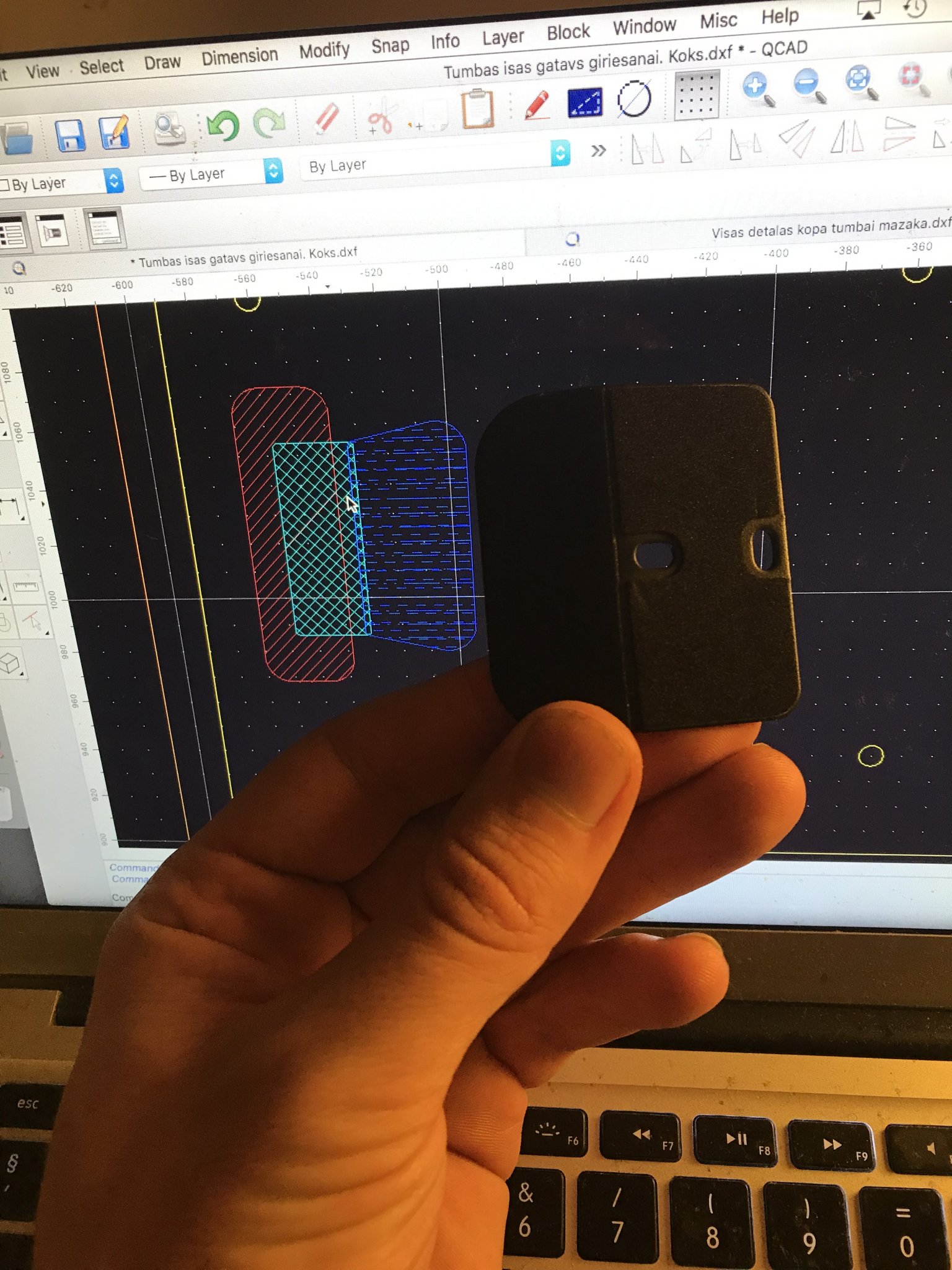

A lot of things I had to learn with this hobby, like woodworking, 2d Cad drawing, CNC wood cutting, hand tools, material science, epoxy resin vacum lamination, acoustics, speaker design programs, industrial design and many more.
More things to learn or need to create contacts who can help me with measurements, painted surface finish, aluminium cnc milling, 3d printing, 3D CAD drawing, active filters, passive filters, digital EQ.

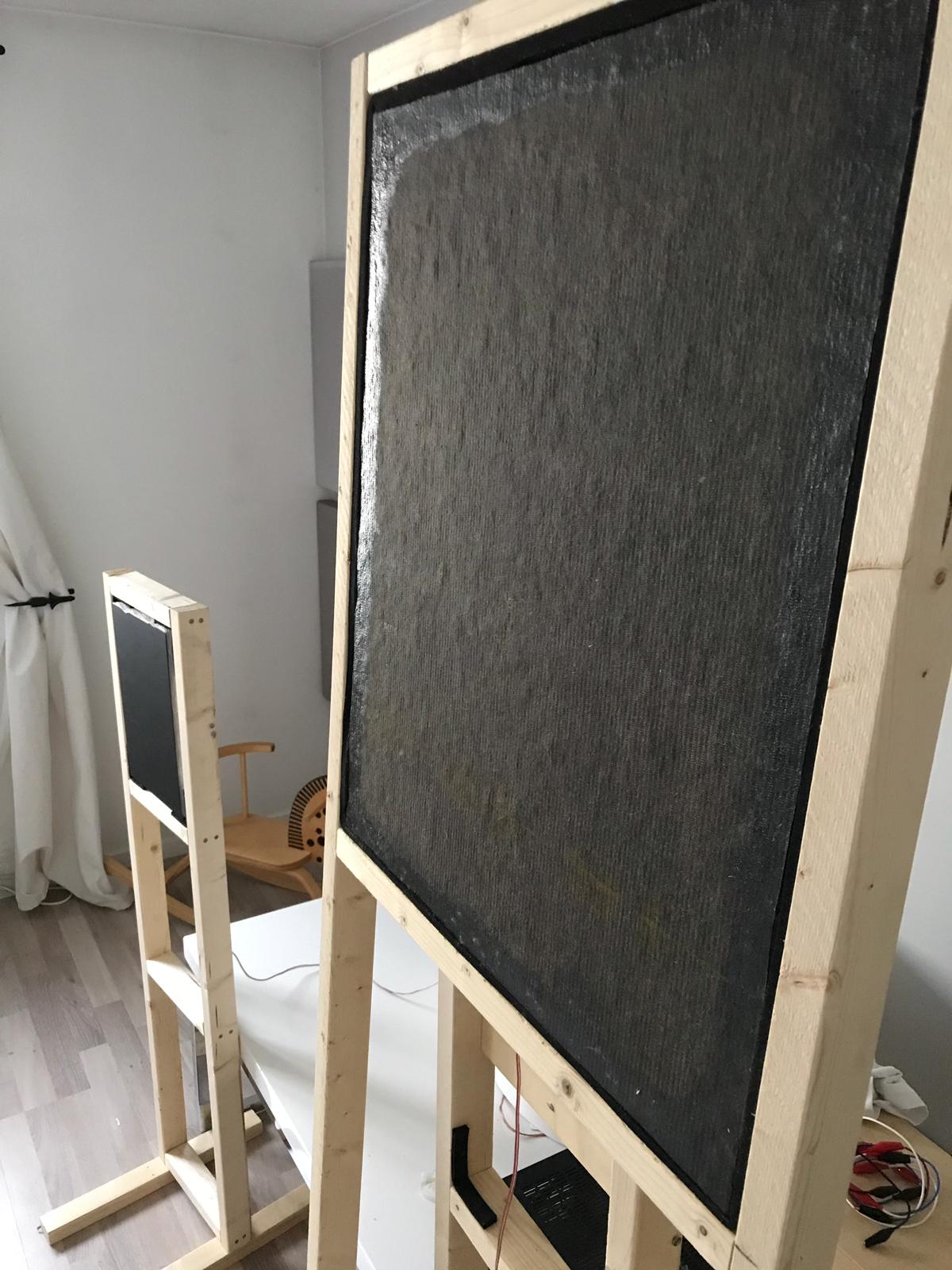

Test the panels on Klipell nearfield scanner would be valuable.
I use Lyngdorf amplifier with RoomPerfect wich helps to test the panels.

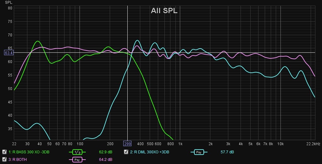

Here are my latest efforts with my OB bass / DML hybrids. I've attached a couple of images. The first shows uncorrected response curves with a 300hz 24/db octave Butterworth filter applied in the miniDSP HD together with the effects of driver EQ for both drivers run together. The second image shows the response with driver EQ applied and the predicted response with filters applied. All measurements were taken using the moving microphone method. The driver response curve EQ required some tinkering to get things right in the crossover region.
There's about a 6db difference between the efficiency of my 15" bass drivers in a topless asymmetrical U frame and the 2mm ceiba 30x40cm panels. Therefore, I reduced the bass driver output by 3db and increased the DML panel output by 3db in the miniDSP HD.
My previous efforts aimed for a 3db drop from 40hz to 20khz. However even at 67 years of age, I was finding this too bright overall. By switching to a 5db drop over the full frequency range, I still have good detail but also more warmth.
When the bass drivers go into H frames and the panels constructed rather more elegantly, I'll have to do it all again!

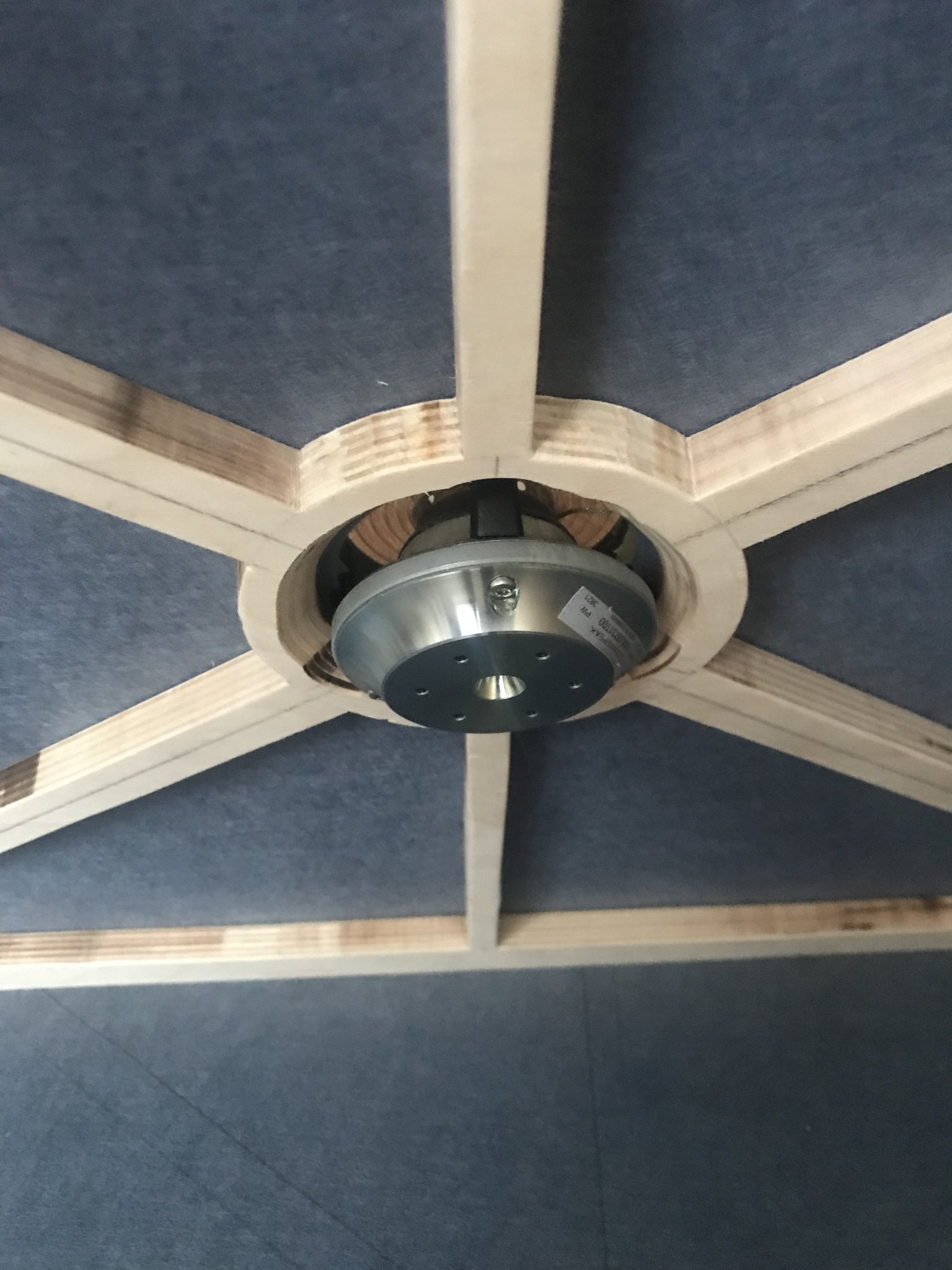

Yes, make the panel smaller, stiffer or thicker. It also lowers coincidence frequency. Compliant suspension on panels also increase pistonic motion even on stiff panels.
The thing is, the voice coil shouldn't move the panel, the exciter must only transfer the vibrations. This is the tricky part. Have a look at all those patents, I posted in the post #9,094. Might help.
Unless something has been lost in translation from some weird Himalayan Trans-Tibetian language that smells of Elderberries, that is utter BS.
In slow motion you can see that the whole frame moves, attention has to be made to make it rock solid and damped at the same time.
I would pay more attention to more important issues. I doubt you will even be able to measure or hear that small amount of magnet movement even if it was infinitely stiff with zero movement.

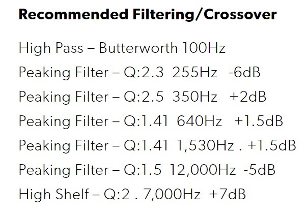

In the last few weeks I found that the DML500 type had been tested upon thoroughly, as early as 2013 by some people and had been discarded as they need the help of a tweeter and a subwoofer. (All kinds of panel material had been used for the testing.)
DML500 and it's variants need crossovers.
Tectonic DML products are more useful in large buildings, such as conference halls, churches, stadiums, airport foyers, gymnasiums etc, where the HF and LF is not really desired. Tectonic Audio Labs, as the surviving successor/heir to NXT/HiWave, practically don't advertise those DML speakers for the general public.

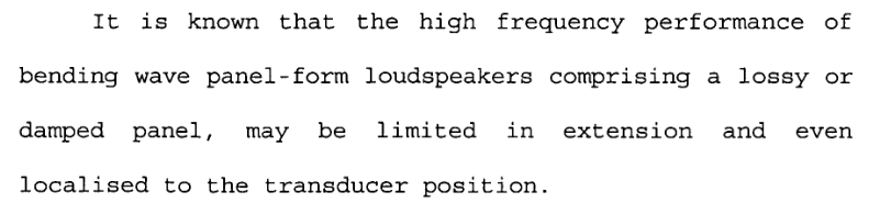

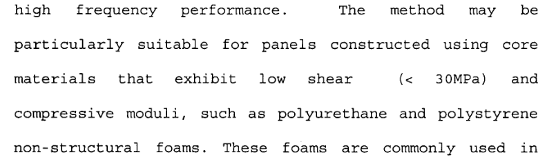

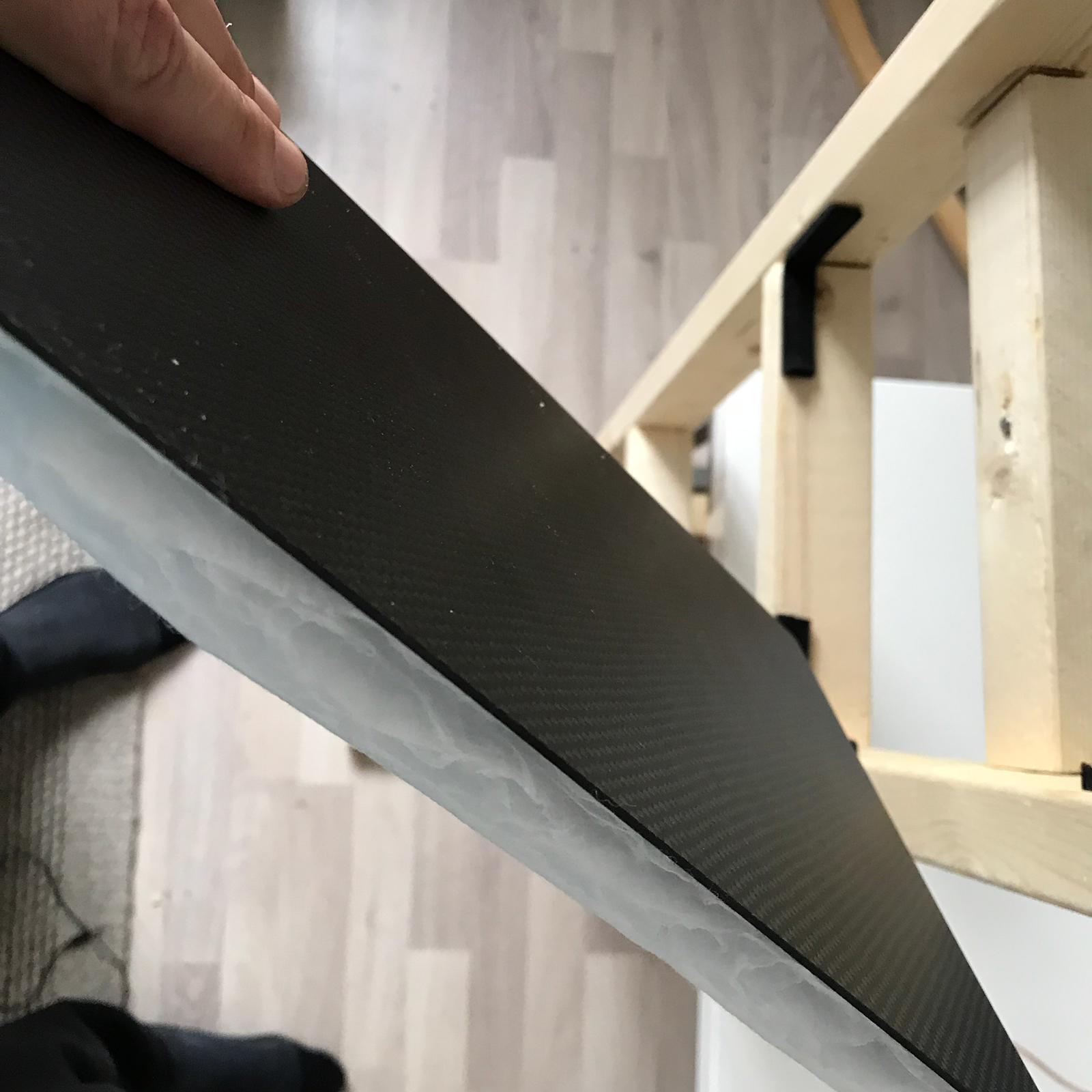

I have tested one of the solutions included in this patent application. I have included in one of my sandwich (carbon, balsa, carbon) a piece of homegenoius carbonfiber piece that is of the same size as the voice coil of the exciter 25mm. The CF piece is of the same thicknes as the balsa core 2mm. It’s Connecting the front and back CF skin with the exciter. It did help to extend the frequency range to 20k.
There are some more ideas in the application.
’Thomas
Hello Thomas,
Interesting patent. thank you. In addition to the reinforcement of the voice coil area, it points to facts often reported here :
This patent refers to another interesting one (WO2000015000A1)for a variable thickness panel. In the advantages of non constant thickness:

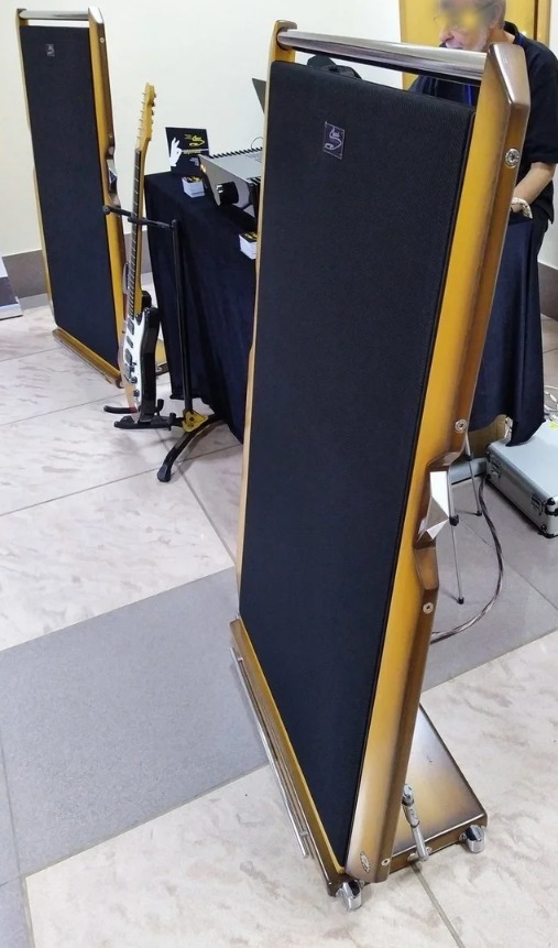

A successful implementation of NXT technology by those, who can analyse the patents well, and able to add their own analytical thinking to it...and with their own purpose-built exciters. At a Hi-End show in 2019...
Dimensions: 1125mm х 640mm x 50mm
Frequency range: 45-18,000 Hz
Type DML (NXT). - impedance: 8 ohm - sensitivity: 93 dB - power: 2×200 watts
All by itself, without the help of a twitter or a subwoofer.
Where can I find more info on these?
Thomas
