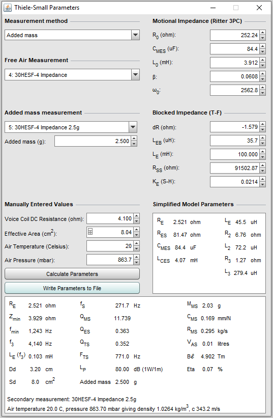

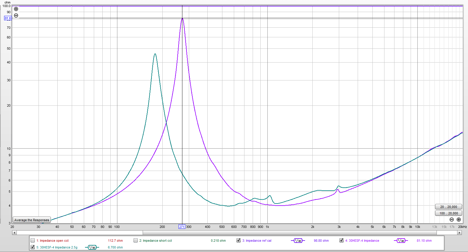

This is TSP's on the Dayton DAEX30HESF-4 driver. I'm measuring these HESF's because they are the only ones lying around at the moment.
I've used 2.5g added mass which seems to be the same as what Billionsound uses in their measurement of this driver.
Impedance axis is logarithmic.
View attachment 1137426View attachment 1137427
Note Re=2.5ohms?? Yes, I did check my reference resistor a few times.
Note the F3 and Le-at-F3 numbers... 😵

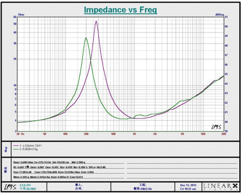

Here's what I think is the OEM driver from BillionSound. https://www.billionsound.com/product/177.html?productCateId=18
Their curves are virtually identical to mine.
The numbers below their graphs are almost too low-res to read...

The results are so clean that I wonder why I don't have a test gear ready beside me to do that! Near to me currently an old class AB amp no more used (most of the time I use a small bridged class D for testing which is not suitable for impedance measurement. Hmm.
Your results seem consistent and in line with the curves of the documentations.
The strange point is the difference between the Le you get (0.1mH) and the one in the Dayton spec (0.3mH) which itself is not consistent with the impedance curve. About F3 I have no idea as it is defined as sqrt(2)*Fs.

No Paul, From what I know from the equivalent models, we can fully use them to evaluate the electro-mechanical elements. The answer should be some where else. Looking more carefully what is strange is the low value of the impedance curve at low frequency. This is not in the physics of the exciter. The curve should be almost flat here just below 4 Ohms.Im not that familiar with ts params but I doubt they’re directly comparable for an exciter. If the exciter was not loaded (not on a panel) then it’s not doing work pushing air, and I guess that would explain a low Re?
@Andre Bellwood : would it be possible you have a kind of band pass limitation in the LF? Serial capacitor? Have you checked the Re with an ohmmeter?
PS : sorry I just have seen your answer André : Re = 4.3Ohms which make sense.

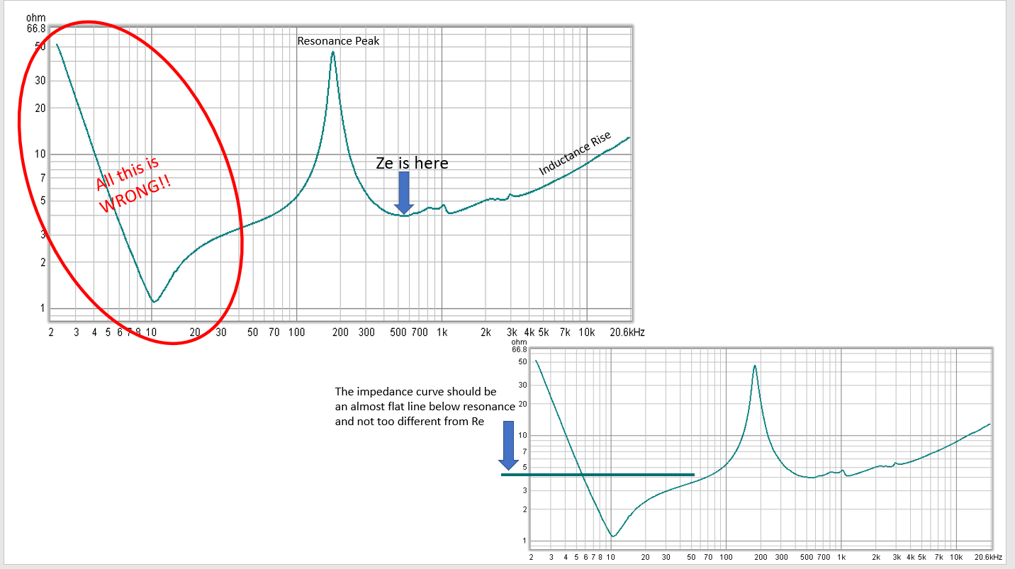

Ermm, I'm sorry Paul, Re in a speaker is DCR, that is, the DC Resistance of a stationary coil. It's not an impedance. So it doesn't matter whether the coil is loaded or not, and it doesn't even matter if it's in a magnetic field or not as long as it's all completely stationary. One could strip a cone speaker, take out the coil, and measure it with an ohm meter, and it will still get the same Re as when it's fully assembled.So the obvious prima-facie culprit for your low value of Re, is the cone. The cone moves air, and so the motor does mechanical work (W = F.s) So it expends energy.
The Re in my REW measurements is flat-out wrong because my meter measures it to be 4.1ohms DC (But maybe my meter is not quite accurate, and this will influence ALL of the TS readings. I might have to get it calibrated.)
The Ze on the other hand is usually the lowest impedance reading at that frequency after the resonant peak before the inductance rise, and this is influenced by coil loading, and the coil will obviously be vibrating at that frequency. See the pic below.

I checked out the lower frequencies. I think there's a problem with the circuitry in my USB converter. I might have to find schematics and take out the HPF parts of the buffers.
Side-note. It appears that REW measures Re at 20Hz.

Yes, I think you're quite correct there. As I said to Homeswing, it appears that REW infers the Re from the Ze at 20hz. But it's also obvious that there's something wrong with low-frequency readings in my setup probably due to high-pass filters in the USB converters.Yes, Im aware of that. Im not saying the REW got it right, only that maybe its inferring the DC reisitance based upon dynamic measurements plus some assumptions it may be making about the kind of device is being measured. Ill stop now, because I probably AM wrong about it, I just wanted to be clear about what I meant. If its actually measuring the resistance at DC, then so be it. But maybe it's deriving it as a difference.
