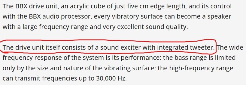

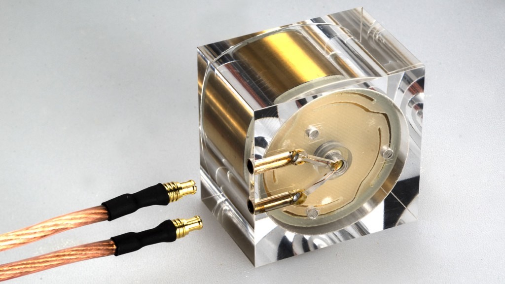

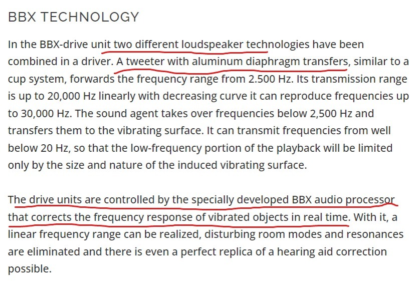

AER also is a DML maker, claims their exciters reach 40-30000hz.
The AER bbx exciter just touches the panel only at one point.

Well, if it is about AER bbx exciter, how it is made and its specifications are a business secret. They don't appear to patent their "invention." All I could find was just advertising jargon. But,
That exciter is quite expensive for a DIY project! 🙂

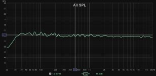

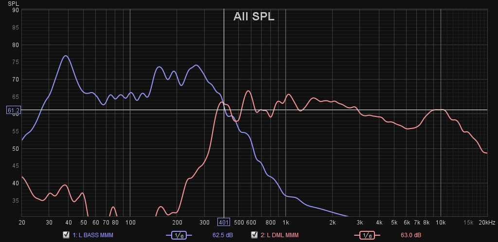

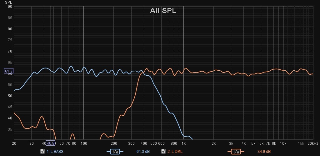

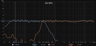

I've just been having a go a the moving mic method (MMM) for correcting driver responses etc. Here are the uncorrected curves (1/6th smoothing). My open baffle bass drivers (15" Monacor PA units) are much more efficient than the panels. The curves included the effect of LR 24 db/octave crossovers @ 400hz. My PEQ files aim for 61db. This means large cuts across the board for the OB bass. The panel response is pretty lumpy, but 61db is a reasonable compromise for a mixture of PEQ boosts & cuts.

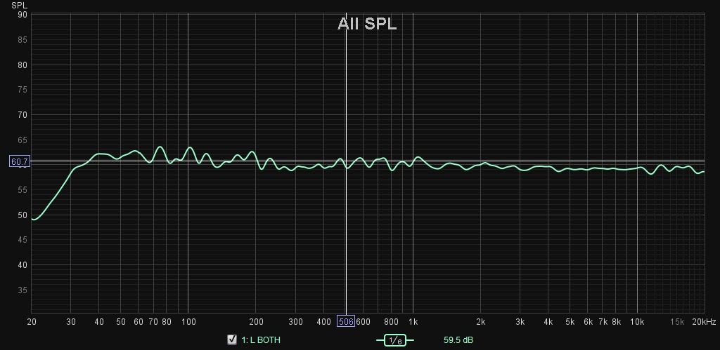

The second image shows the results of the driver corrections. You will see that around the crossover region, the bass runs too high and the DML too low. Therefore, I adjusted the crossover frequencies for both drivers.
The third images shows the final response curve for the left hand speaker, taking account of the crossover fudge and some other minor corrections.
All measurements involved using the MMM with typically 80-100 measurements averaged for each reading. All images show 1/6th smoothing.

There could be a small additional aluminium membrane within such a small gadget, but the vibration transfer is only through single point. On the question HF, more or less the same response could be achieved with aluminium foil disk between the "normal" exciter and the panel. Only, the commercially available cheap "normal" exciters don't even go above 12kHz without load.
The AER bbx exciter is, well, 3.600 €. Oops!

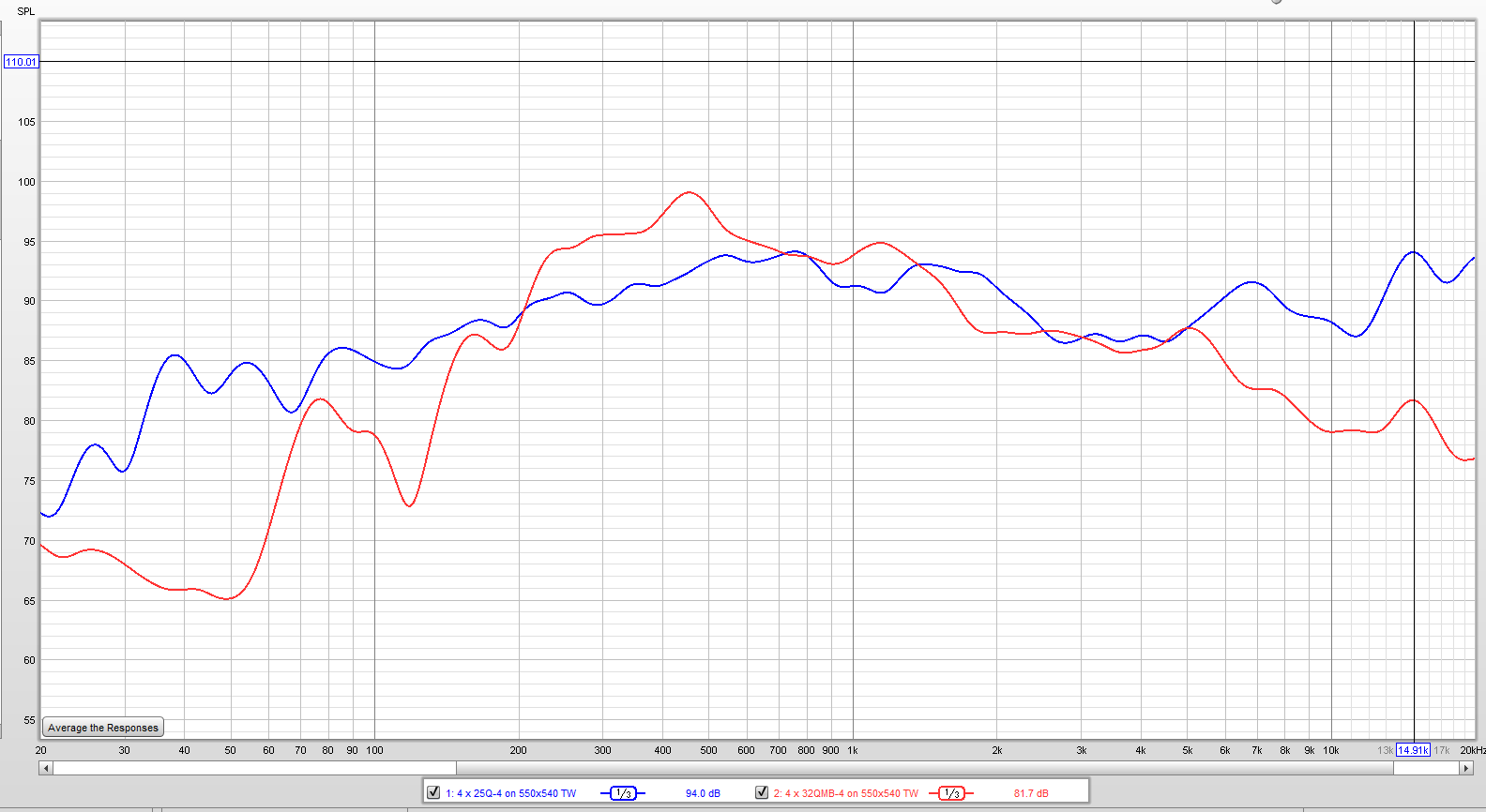

Here's a 40W, 32mm VC DAEX32QMB-4 MegaBass driver,(red curve) around $22-00, compared to a 20W, 25mm VC DAEX25Q-4 (blue curve) at around $14-00.

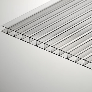

The panel was a 5mm polycarb Twinwall panel (pic attached), 540 x 550 in size. I think that's one of the dimensional golden ratios for the most even distribution of modes. The panels were un-damped, supported top and bottom only on 5mm foam tape.
I have adjusted the relative levels to make bandwidth comparisons easier.
There's a significant peak at 15k on both drivers which is not there on EPS (with Kevlar skins) nor on anything else I've tried. I suspect the peak is due to the size of the corrugations in the Twinwall. I need to test this by filling in some of the channels around the driver with silicon, or glue. Or something.

Interesting test André but difficult to analyze.
I had a look to the exciter specifications and compare to the only one I know and use the DAEX25FHE-4.
  • DAEX25Q-4 : inductance is twice the FHE (0.23mH for 0.1mH). The rest is similar
  • DAEX32QMB-4 : the spec is almost empty. Inductance is not very high at 0.23mH so same as your other exciter; the cutoff frequency due to the inductance might be the same. No indication of the moving mass but a frequency of resonance much higher, 480Hz against 224Hz. Having a 32mm voice coil, we can suspect the voice coil mass to be more important than in the 25mm and the stiffness of the spider much more important; important enough to change the LF response?
An other phenomena I can't evaluate is the impact of the voice coil diameter on the mechanical impedance seen by the exciter. We know the impedance for an infinite panel driven at a single point. For a circle? From a BMR patent, I read the impedance increase when the length of the contact line increases which not explain at all your observations.
You could probably evaluate the stiffness and mass of the exciter using the technique of added mass used to get the Thiele and Small parameters of a loudspeaker (technique based on the electrical impedance measurement)

Thanks Christian,
Yes, I find that the specs are fairly pointless. Even when they provide inductance measurements, I find that there's no discernible pattern where I can say "oh, look, low inductance, therefore good bandwidth." There are other factors involved (BL? VC Diameter? Compliance?) that might interact with the panel factors to produce predictable performance.
It's all down to tinkering and testing and measuring I'm afraid. Of course, the fact that most of us here (of a certain age) are not able to identify anything over 10kHz is another part of a different problem.
Yes, I will certainly be employing added mass techniques to find TS parameters. It looks like BillionSound does exactly this (it looks like they are the suppliers to Dayton, Tectonic and Pui. But not to Visaton nor Monacor) They provide obvious added-mass graphs and an attempt at TS parameters on their drivers, but the text is (purposely?) too low resolution to read.
