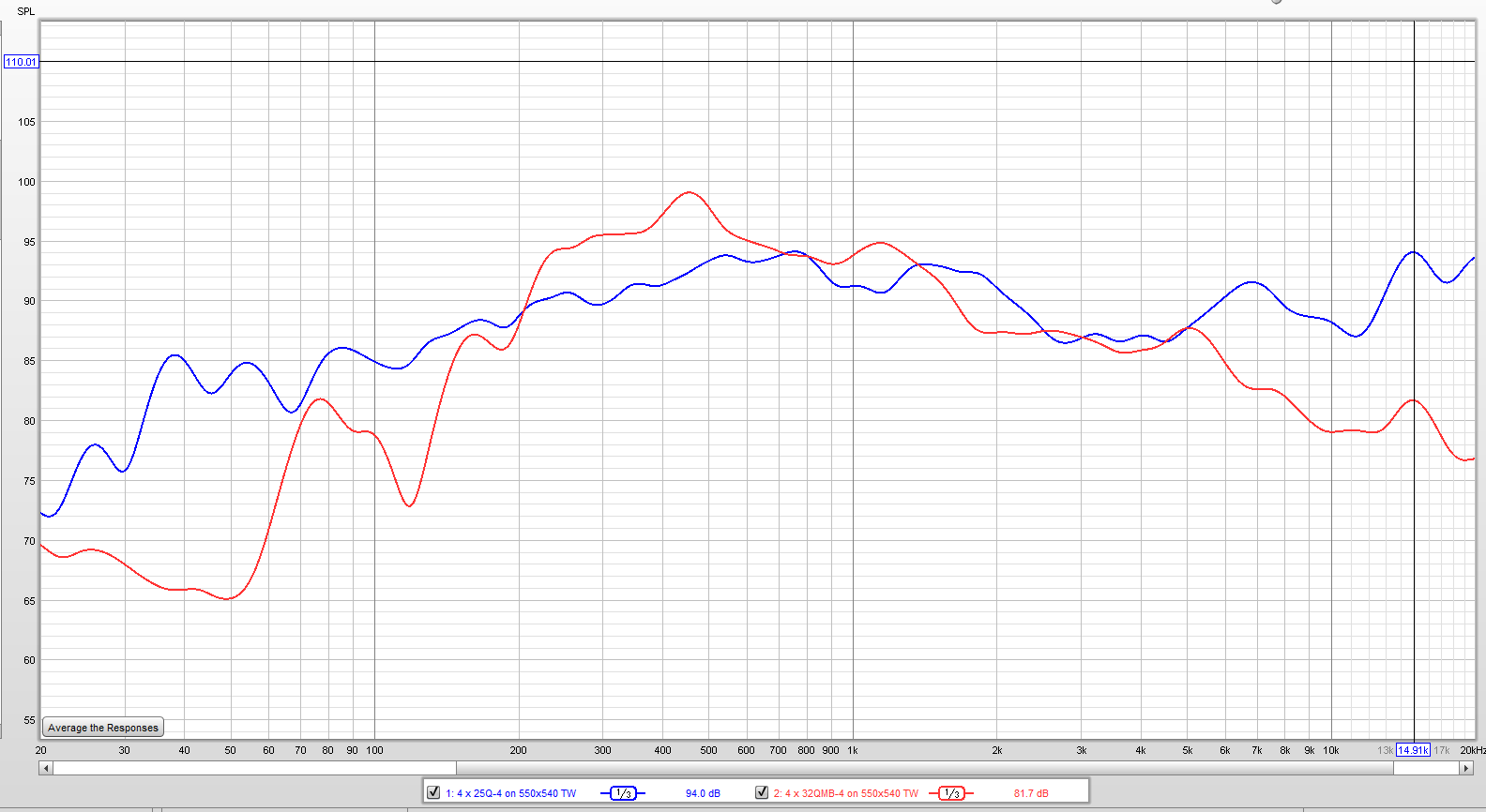

Here's a 40W, 32mm VC DAEX32QMB-4 MegaBass driver,(red curve) around $22-00, compared to a 20W, 25mm VC DAEX25Q-4 (blue curve) at around $14-00.Which 20w cheap driver?

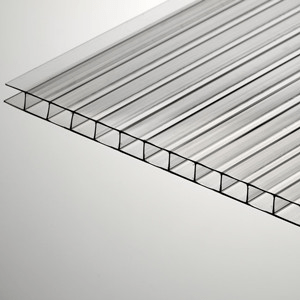

The panel was a 5mm polycarb Twinwall panel (pic attached), 540 x 550 in size. I think that's one of the dimensional golden ratios for the most even distribution of modes. The panels were un-damped, supported top and bottom only on 5mm foam tape.
I have adjusted the relative levels to make bandwidth comparisons easier.
There's a significant peak at 15k on both drivers which is not there on EPS (with Kevlar skins) nor on anything else I've tried. I suspect the peak is due to the size of the corrugations in the Twinwall. I need to test this by filling in some of the channels around the driver with silicon, or glue. Or something.

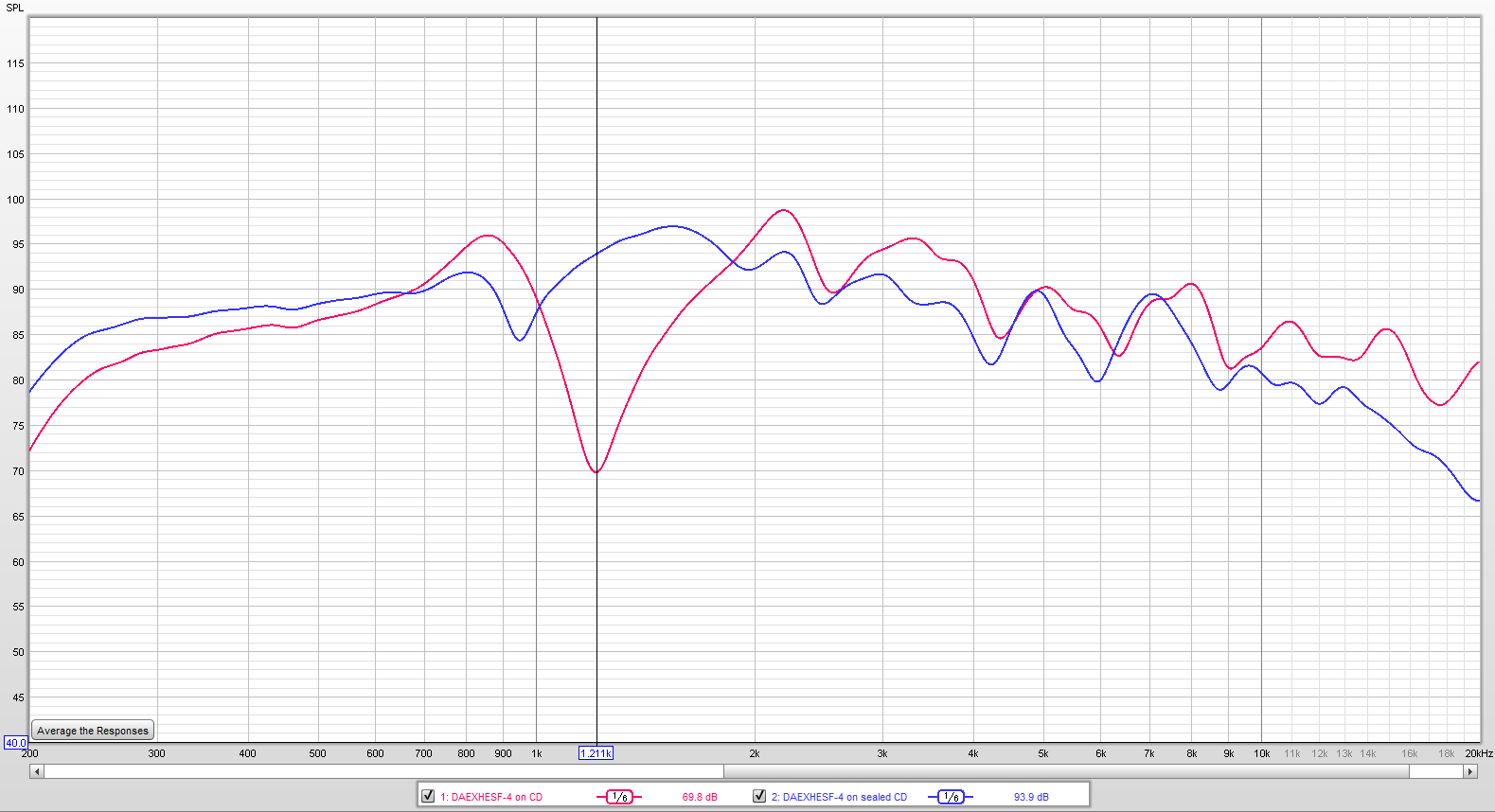

Here's the ($26-00!) DAEX30HESF-4 on a CD. That's the CD disc itself with the 15mm hole in the middle...I should fess up, I did the same with a cd case. Felt sure I would get some HF with the DAEX19-CT4 exciter. Nope. But if memory serves, not as bad as XPS.
Typical Ben channel on youtube got what seemed to be excessive HF with the dayton thruster on acrylic. Seems to be a resonance effect, but if that works....
The red curve is with the CD untouched.
The blue curve is with the hole sealed with hard, light plastic and superglue.
The hole causes a massive notch at 1.2khz.
But it seems there is something to be said for an improved HF above 10khz... This might be a result of a resonant cavity formed inside the voice coil, and then projected through the hole (exactly like the hole, which is carefully tuned, in an acoustic guitar) but which is completely suppressed when you stick a driver onto a normal panel without a hole (which is exactly what you do to prevent feedback on an acoustic guitar)
The normal application, on a normal panel without a hole, shows an obvious drop from around 9khz.
Things to try,I suspect the peak is due to the size of the corrugations in the Twinwall.
- Block the open ends of the twinwall corrugation with with some cotton wool and tape them shut,
- Add thin light damping material under the sheet on the perimeter 15-18% of the panel dimensions,
- Paste a thin alufoil disk between the exciter and the panel. The area within the bobbin should be free of anything.

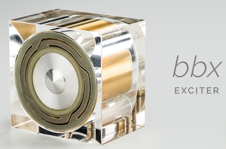

The AER bbx exciter reminds me of Toru Maruyama's single point conical transfer of vibrations to a panel, posts #7,115, #7,129
The point of contact here too is just a single point, the optimal transfer of vibrations.

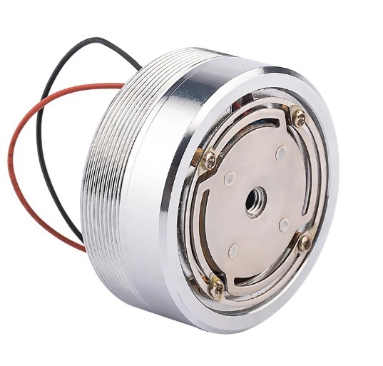

The Aiyima exciter (below) can also be made to work as a single point vibration transferring emitter, by fixing a cone-like screw, a somewhat crude attempt, though.
