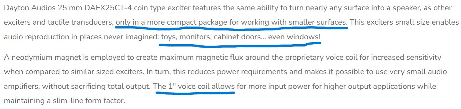

Also Dayton states this note on all its exciters.
Note: An exciter's frequency response and sensitivity are completely dependent on the exciter's designated surface. Thinner, smaller materials will tend to be louder and create a mid/tweeter response. Thicker, larger materials (with multiple exciters) will be slightly quieter but result in a more full-range sound.
On the 25mm CT type 10W exciters Dayton Audio sells today, they say,
Do you think is it possible to make 20-20000Hz DM panels with such a weak exciter? Even with 4 exciters à la Tectonic DML500?

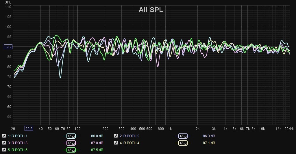

I can report that using multiple measurements when doing EQ type things is still working wonders. I've increased the number of measuring points from 3 to 5 with a spacing of about 10 inches between them. Here's the result with the mic height and position about where my ears would be.
