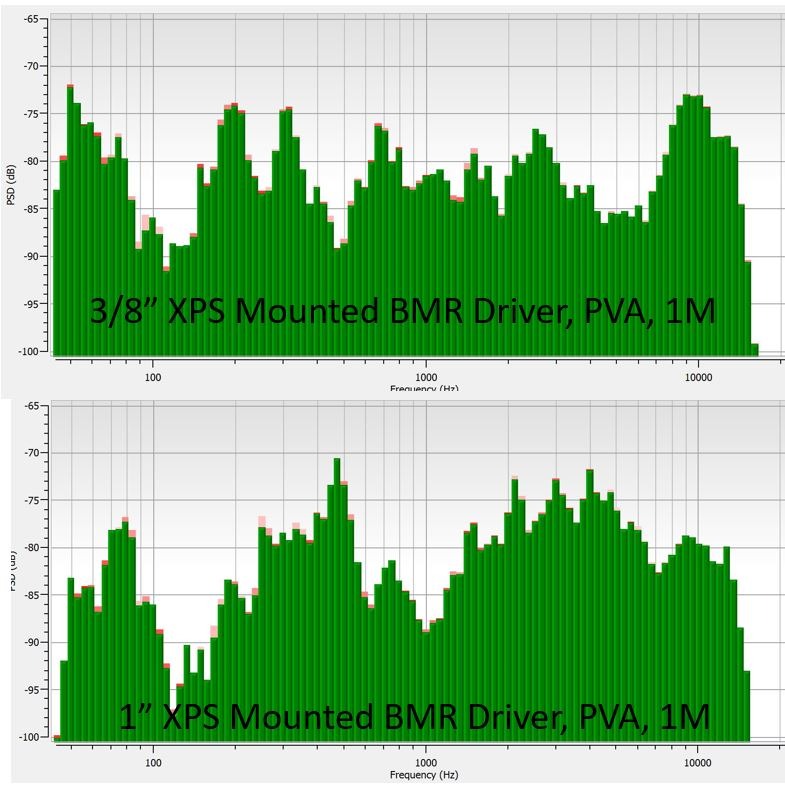

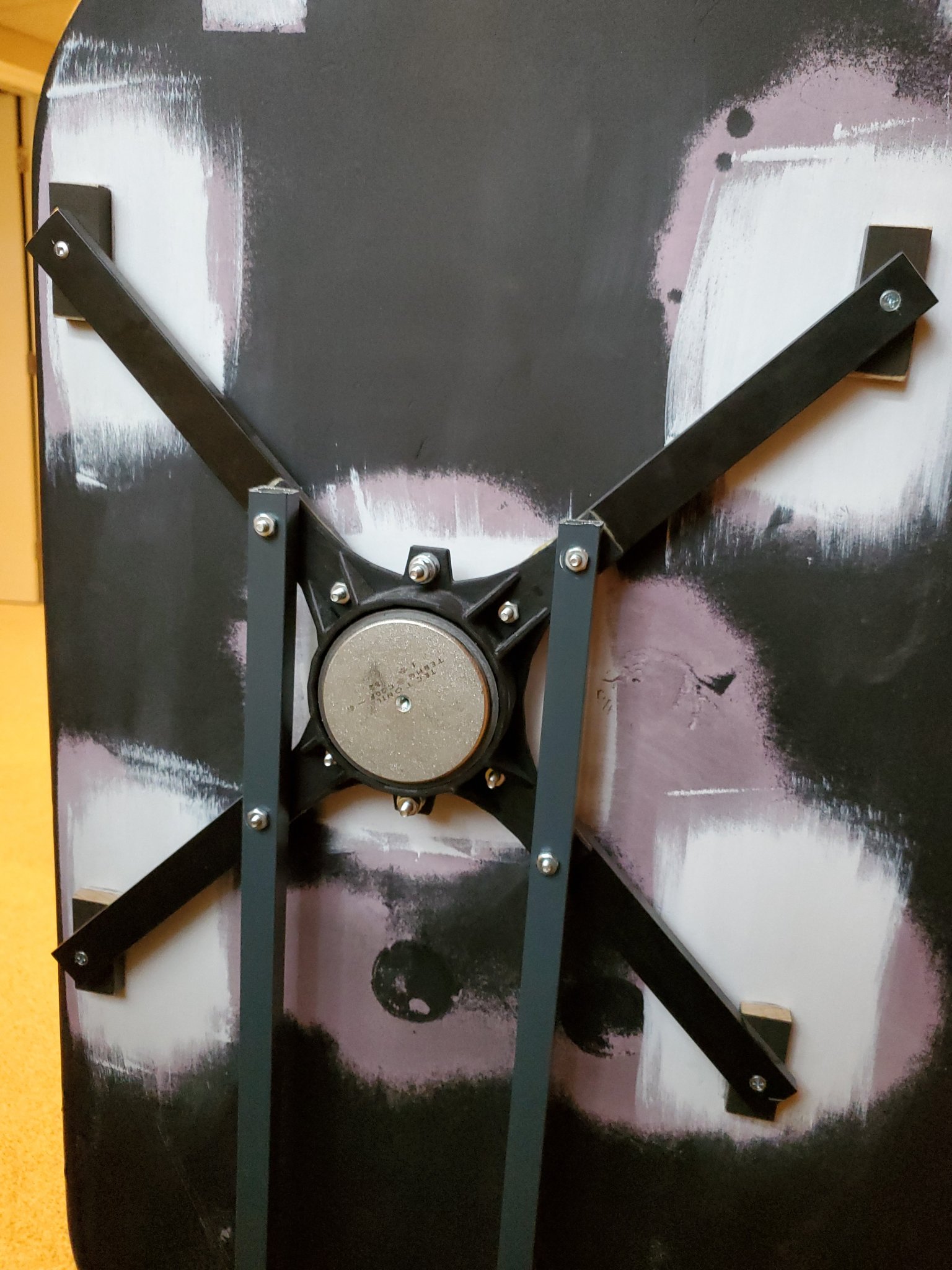

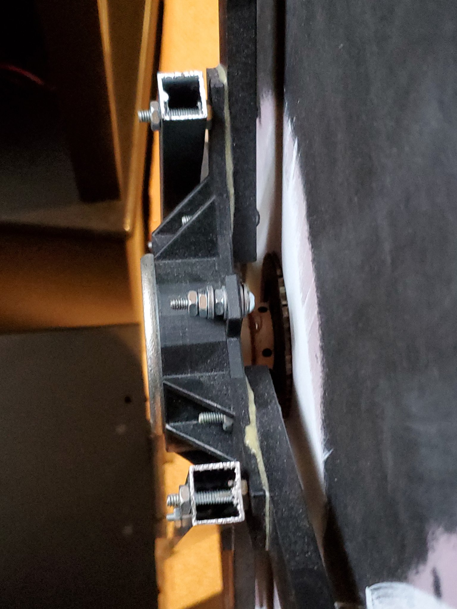

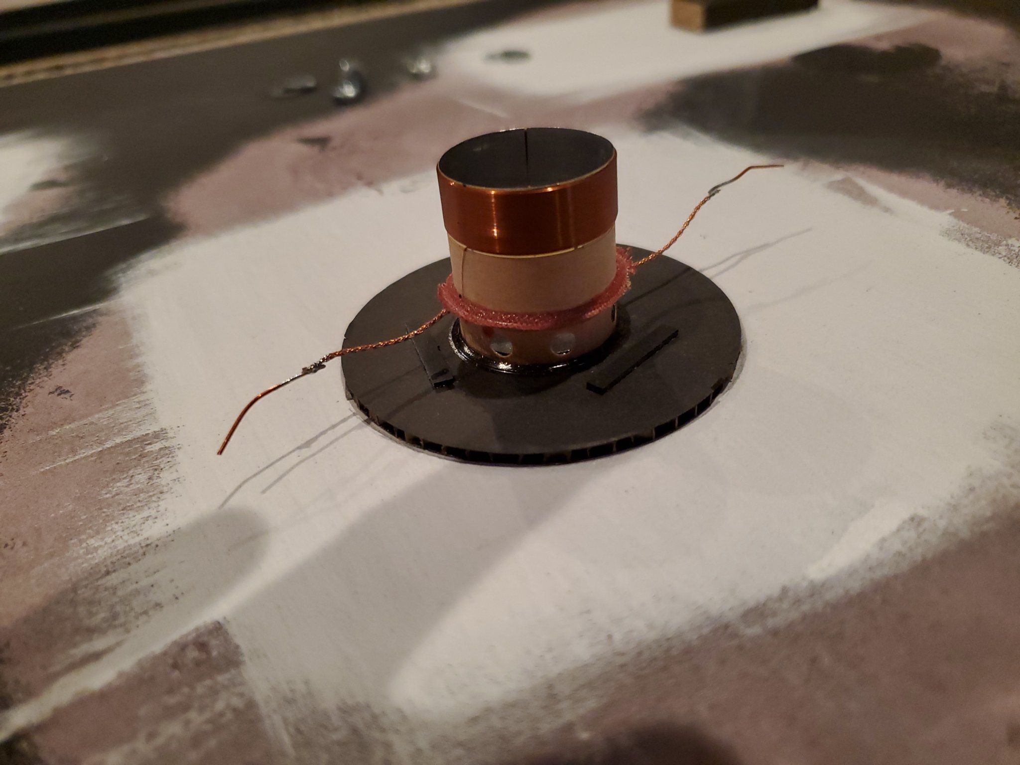

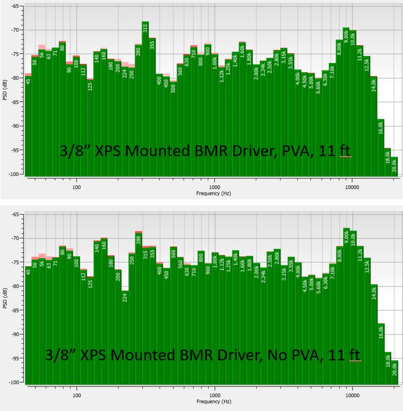

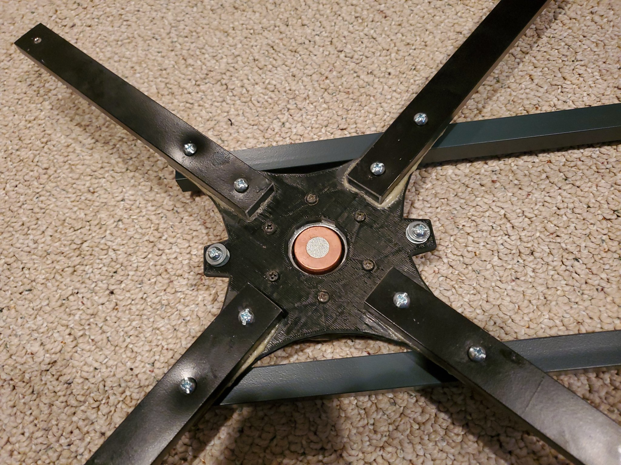

This post reminded me of something I was going to post some time ago but I was put off.Greetings fellow DML’ers! I want to pass along something I’ve tried that seems to have some merit. It started after ordering a pair of the 3.5” 8 ohm Tectonics BMR’s. One of the first two came broken from shipping damage and so did the replacement. Since I had two unusable units, my concept was to eliminate the spider and suspension of a typical exciter and let the DML panel be the spider and suspension – to avoid wasted energy and mechanical resistance to the force of the voice coil.
I 3D printed a mount to support the driver. I put tape around the voice coil to keep it centered on the magnet while the support was glued to the panel. After that I unscrewed the mount from the glued pads, took the tape off and reassembled.
My original panels are 1” XPS with PVA coating. The attached pictures are of the experimental assembly using 1” XPS, 3/8” XPS, with and without PVA. Also a comparison of the 3/8 and 1" mounted PVA experiment and my original 1” with a Thruster with PVA.
I'd appreciate your insights, and if this has been done elsewhere, please direct me to it. Great work you have there, Veleric!

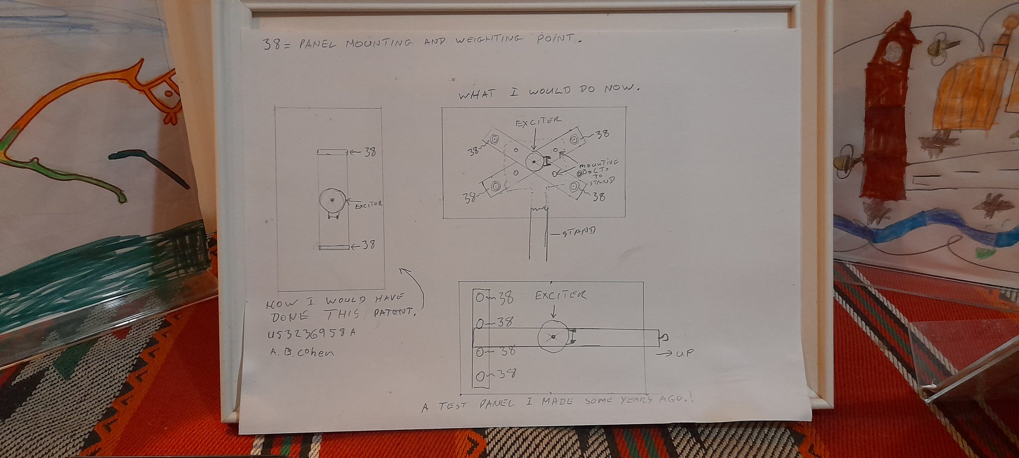

in this patent, you can see the weights 38 in figs 6 -8 and response in fig 9.
https://patents.google.com/patent/U...=priority:19610101&oq=inventor:+A+Cohen++1961
I have made a quick drawing of the way I probably would have implemented this( in the left drawing) using the weight points as mounting points, as usual two for the price of one😁 I love it when that happens 😆
The exciter, panel , and weighting points become one with no edge mounting and damping.
Frames for protection and edge damping points can be added as needed or wanted.
The exciter and panel are supported on the same brace for single point mounting to a stand.
In a modern panel I would probably do something similar to the top drawing .
The panel mounting points ( weighted areas) would be chosen for best performance filling in the dips in response somewhere around the 200hz point of there abouts.
I would probably round the corners as the exciter and mounting points would probably cause excessive visitation in this area.
It turned one of my panels corners into a fan 😧 i had to use a wooden brace to stop the corner vibrating.
Below in the third drawing ,is a small panel I made which was less than 12inches .
I use 4 wooden dowels glued to the panel and supporting frame,and on which the exciter was also mounted.
These 4 dowels extended the response of the panel to somewhere in the 100hz region, this worked for this panel.
I personally do not use these methods for my panels (so far , never say never 😁 ).
But they can be a useful tool for serious problem panels or pro work 😁.
I will not be doing tests as I am happy with my panels as they are.
I will be doing some tests at some time with a similar - ish idea but I'll have to see how it works on a larger panel ( I know it worked on a small panel ) I will have to see?
The picture will be on a following post as I cannot post using my phone 😩 so there will be no words.
Steve.

Steve - can a weighting point also be a mounting point ?? - there's no inertia involved in a mounting point...Or am I missing something?This post reminded me of something I was going to post some time ago but I was put off.
