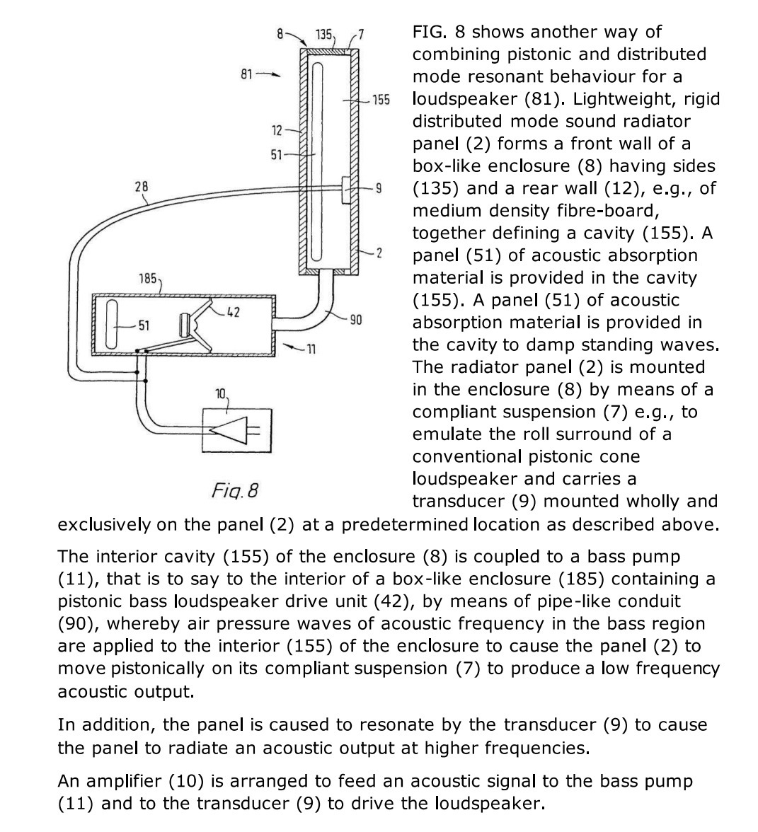

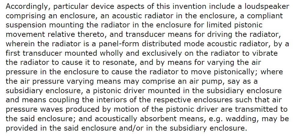

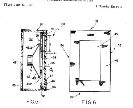

Anyway, one might notice in Stanley R Rich's 1962 patent, a "bass-pump". Maybe, we can simply stick an exciter(s) on the back of that flat panel(45) and change the panel's treatment.
Interestingly, all the companies that still build DM loudspeakers, make all their DM loudspeakers in boxes, and/or fix them in walls, ceilings, such as Tectonic, Amina Sound, Cerasonar etc.

Regarding NXT patents, for examople, Firouz Henry Azima, Neil Harris, Christien Ellis, Andrew Marchant were engineers, Dr. Graham Bank, Neil John Harris, are scientists and engineers.

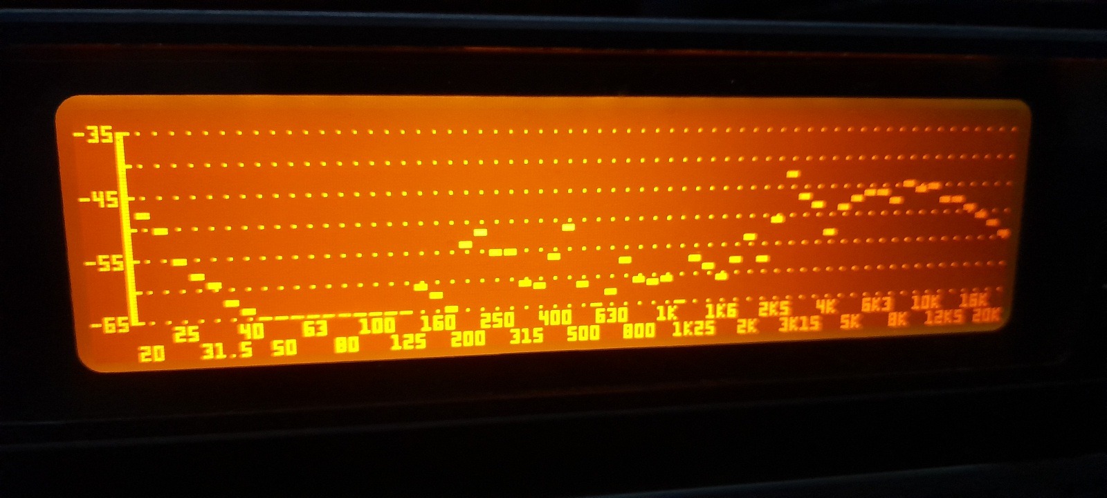

The sound of the ply panel is fine.

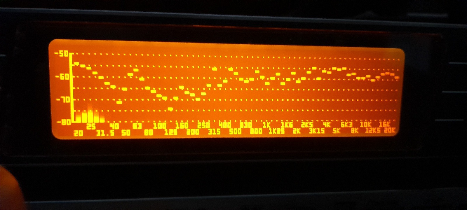

The first picture is of the in room response at about 10ft from my seating position.
This panel suffers from the usual dip in the response below the 300hz region to about 100hz where the panels usually have the low frequency hump down to about 40hz.
I use my TLs to fill in this area.
This is a single point measurement.
I noticed a 10k sibilance on some female vocals and decided to measure the sibilance .
The second picture is the response of my voice making ssssss and shhhhh sounds.
It spans from 2.5k to 20k.
any panel that has a resonant spike in this area will cause problems exaggerating sibilance, sometimes painfully.
This panel seems ok.
The pictures will be in a separate post.
Steve.

I posted that link because, one of the inventors, Christien Ellis also worked to create NXT patents on DMLs, and because you like creating tough projects. 🙂yes, its nice solution to transmission line. But, My solution is about removing the backwave through a reversed horn. I found this old patent when I researched b&w nautilus. The funny thing is that b&w got a patent approved for something that was allready invented and patented in 1940…
I think it is similar situation around bending wave based speakers…
I am also reading NXT patents much more carefully than before. I also found NXT mentioning the angled cutting on the front membrane of the composite panel for damping purposes in one of their patents. So, it is not an original Göbel finding. A lot of stuff Göbel patent says can be found in NXT patents. Only they are all over the place. There's no use trying to reinvent the wheel. 🙂
I apreciate your enthusiasm in research! Can you post NXT paper where they mention angled cutting on the membrane?I posted that link because, one of the inventors, Christien Ellis also worked to create NXT patents on DMLs, and because you like creating tough projects. 🙂

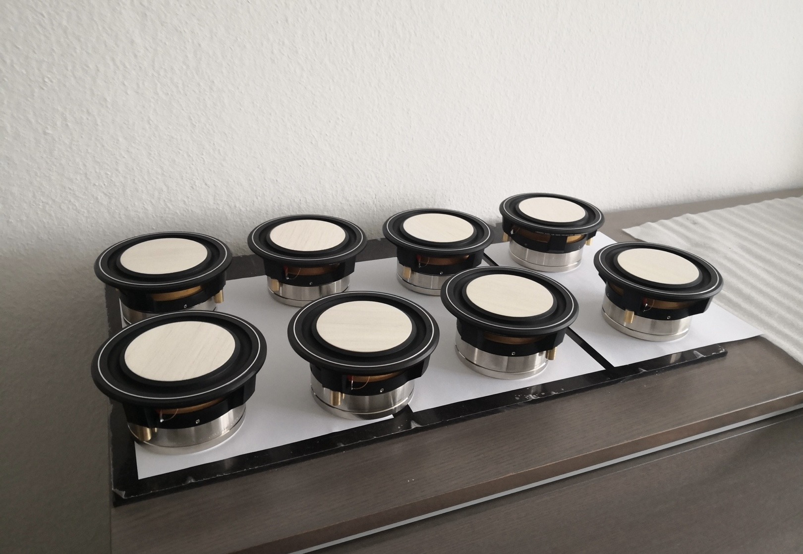

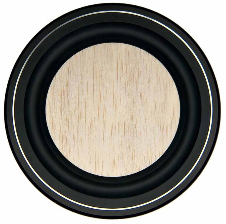

I have made some prototypes along these lines i.e. BMR. I have used a regular 7 inch foam surround in both cases. The diaphragm is 2mm balsa an CF. The black one is 3D printed as you can see. It uses the tectonic driver as I have used in previous speaker. The box is a reversed exponential horn , similar to B&W nautilus.
The other is using a sallads bowl from ikea🤪 and an exciter from dayton (It is closed box).
View attachment 1131709View attachment 1131710View attachment 1131711View attachment 1131718
Do you prefer round membrane?
What are you working on at the moment?

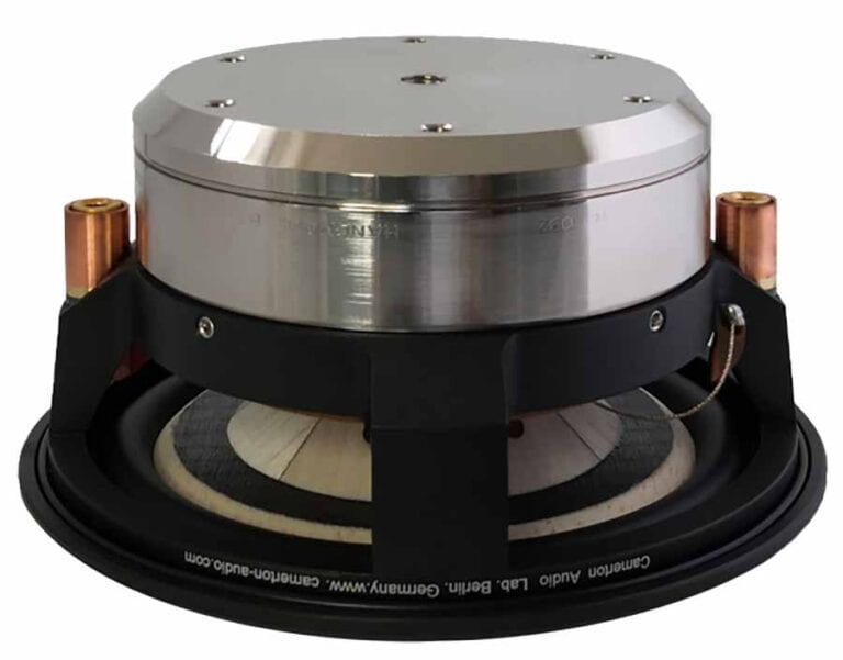

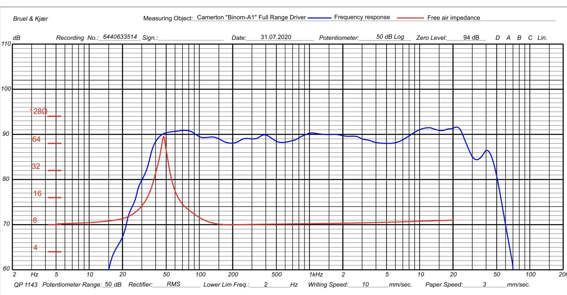

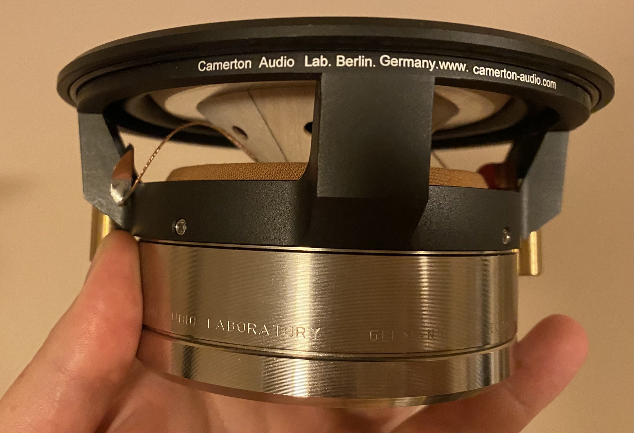

Have you seen Camerton audio and Contrast audio balsa Bmr drivers?
