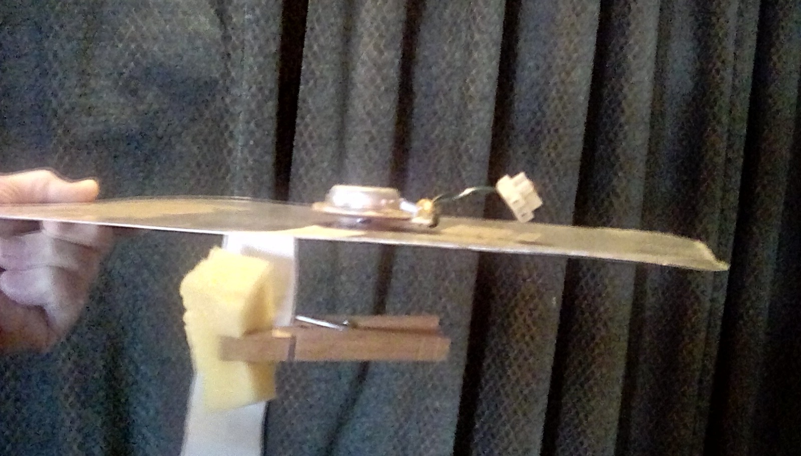

I've tried this, and the result is okay-ish. I used 20kg/m3 EPS, 10mm thick, and kitchen alu foil @ 6.5g/m2. I think the final panel weight (600mm x 410mm) came out to 290g including adhesive. But 10mm is too thick for EPS, and because of its low compressive strength, the highs get lost (Thomas suggested that I measure front and back when doing FR testing to confirm the highs actually do or do not transmit through the core.)
For me, a better solution would be a higher density EPS (or maybe XPS) and maximum 5mm thickness.
Yes, very stiff indeed. But I got an Fc of 2,140Hz to my surprise... I expected much lower.If you try skinning EPS with aluminum, you probably want a very thin EPS sheet, otherwise it could be monster stiff.

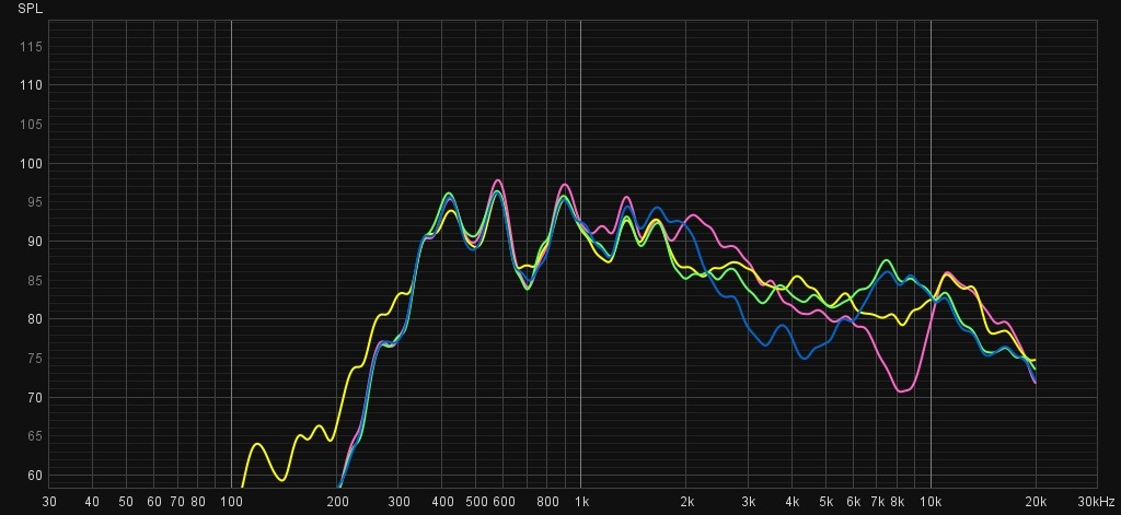

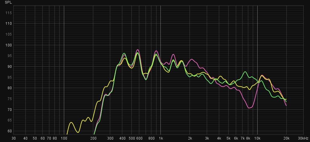

Three way comparison on a 30x40cm 2mm thick ceiba ply panel secured to a frame at regular intervals.
YELLOW - Standard panel with no bits added on
PINK - Panel with aluminium 30mm 'dome' fashioned from a food tray
GREEN - Panel with pea sized bit of blutack on the front in the exciter area.
All measurements taken from my listening position. 1/6th octave smoothing.
The green peak between 6k & 10k is interesting with the blutack.
The aluminium dome offers a bit more between 1.8k & 3k.
I wonder what happens with the dome AND the blutack. Only one way to find out...

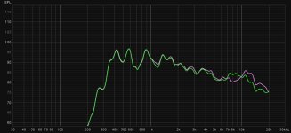

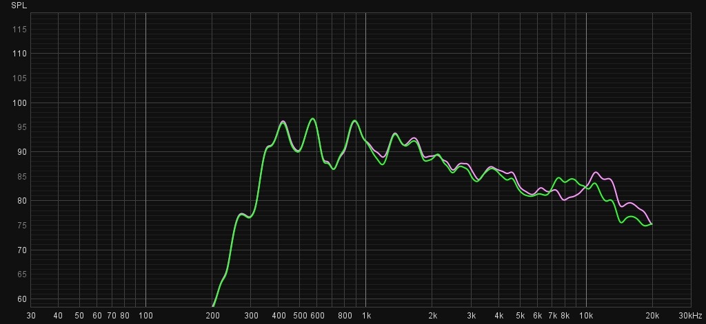

I've reduced the amount of blutack by 75% to the size of a Waitrose petit pois rather than a Co-op garden pea. It has smoothed a peak at 11k and shifted it to the left. Overall response above 10k is reduced, but more easily fixed with EQ.
PINK - Plain panel
GREEN - small blutack
PINK - Plain panel

I was going to suggest using a much smaller peace of blu-tack .
The blu-tack is reducing the peak at 11k too much and also filling in the suck out at 8k .
with the right size, and weight of blu-tack these two will level out.
what is more worrying is the roll off above the 2k to 3k points.
Steve.
