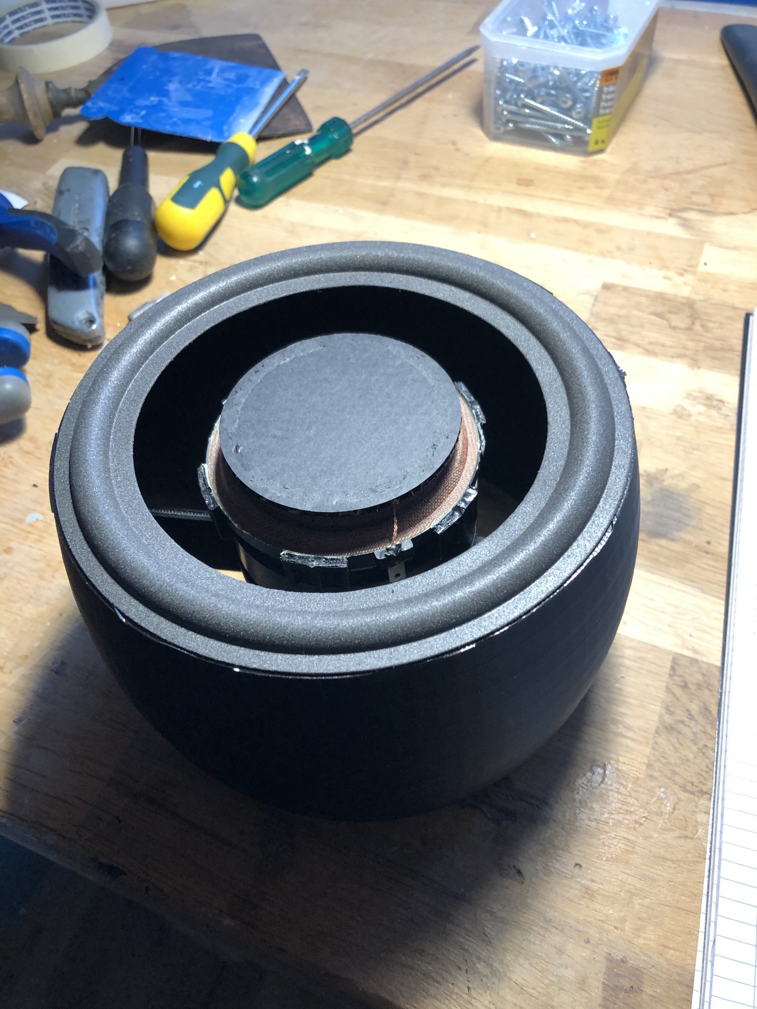

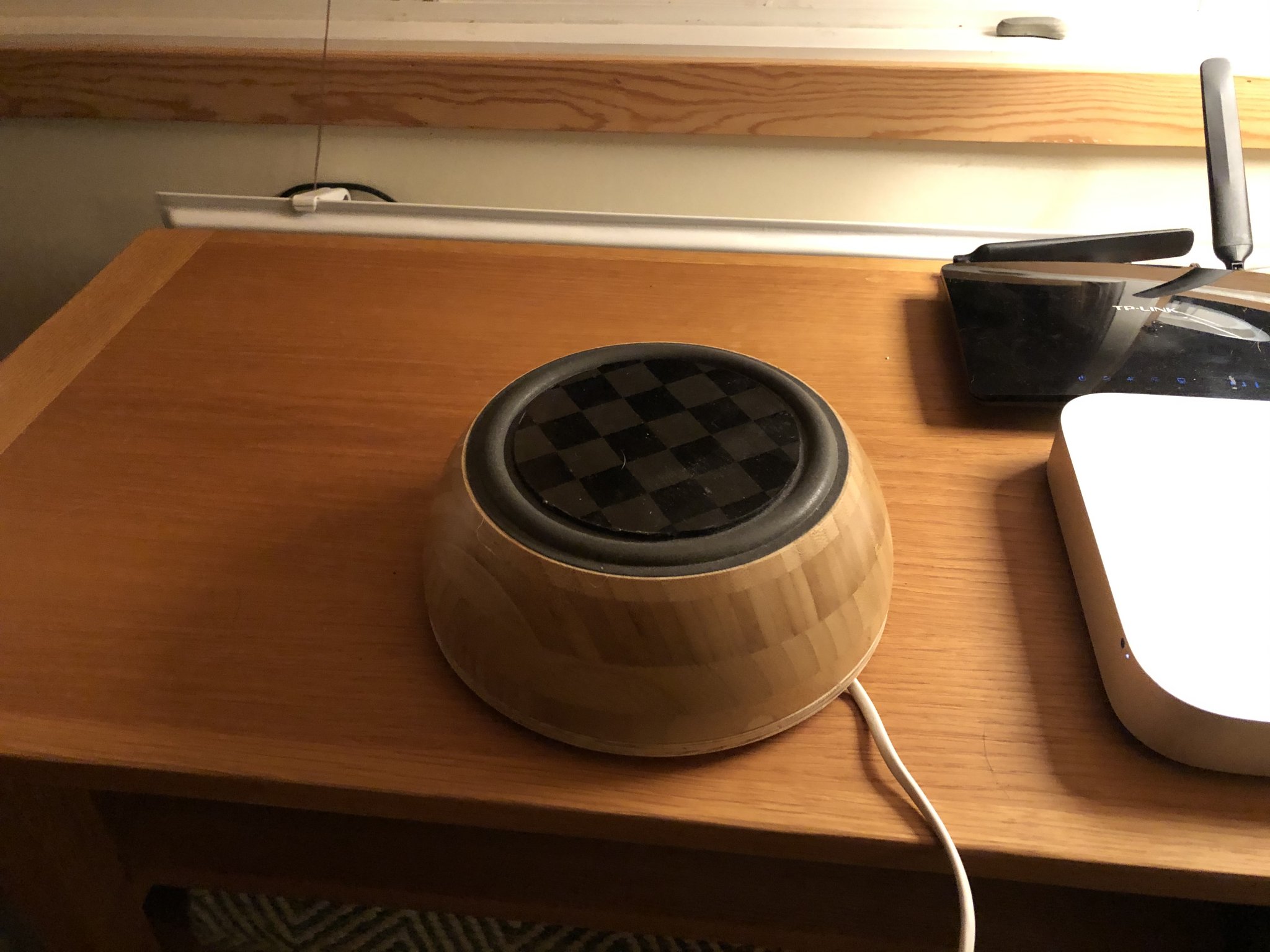

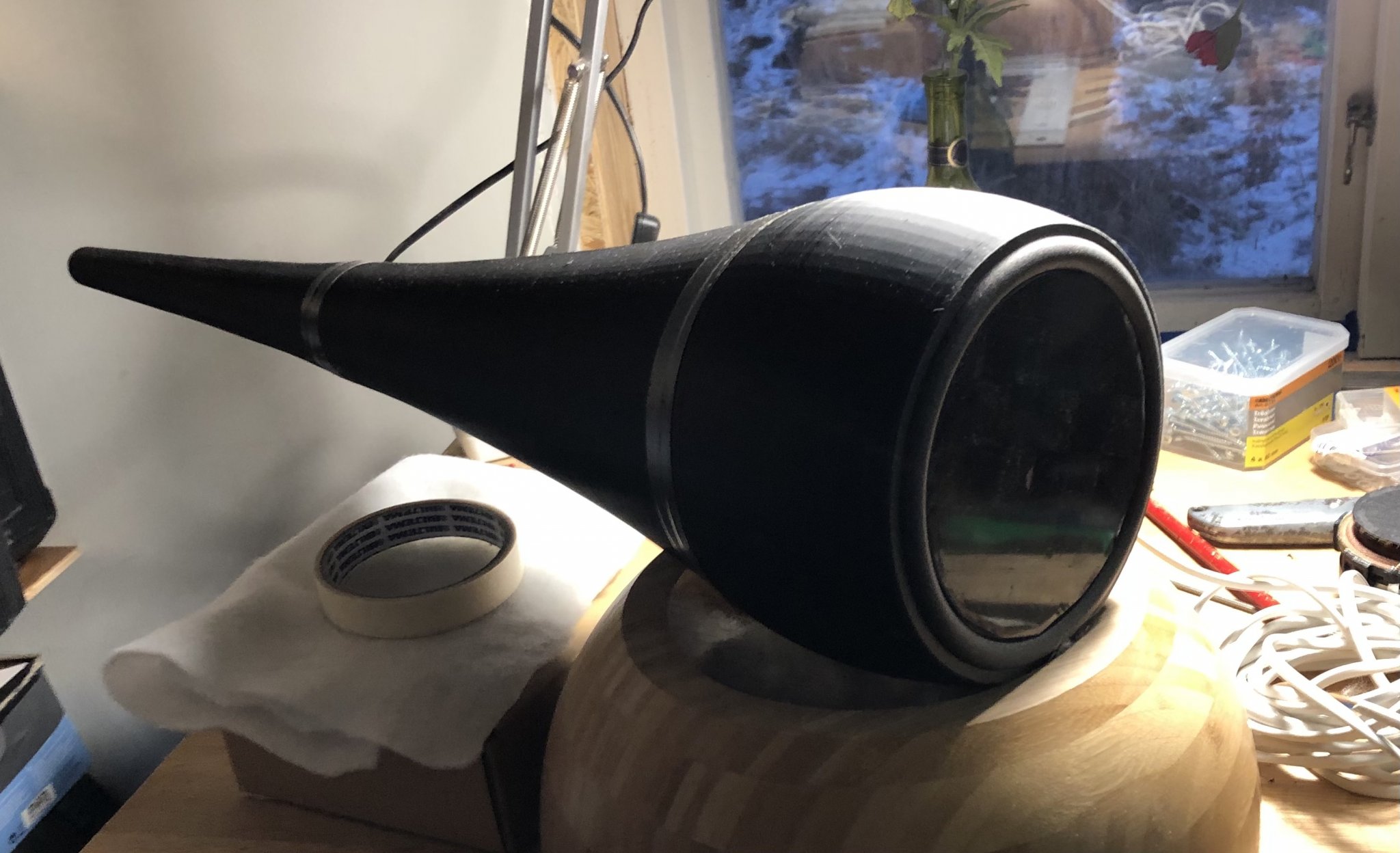

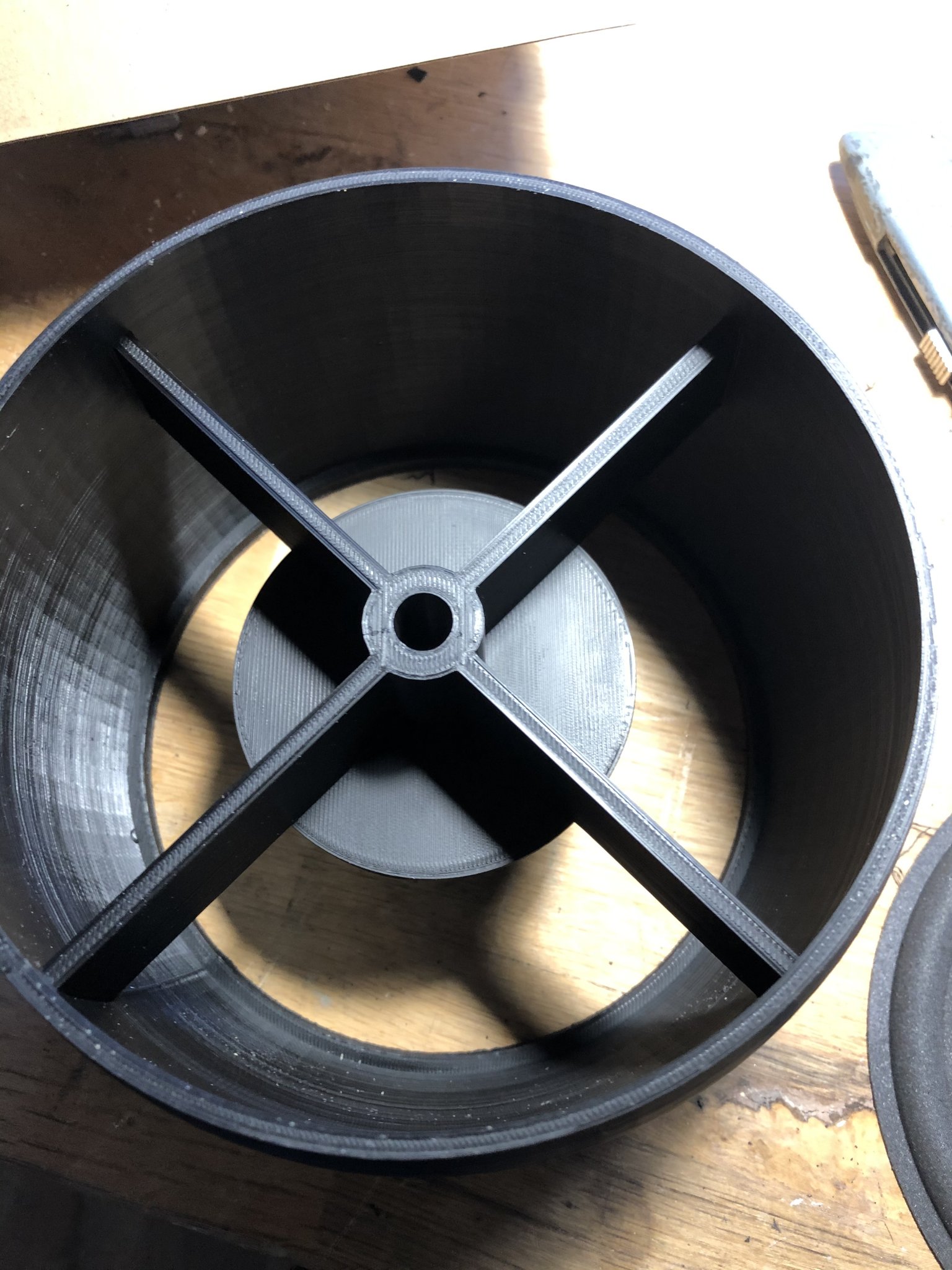

You might like this patent.I have made some prototypes along these lines i.e. BMR. I have used a regular 7 inch foam surround in both cases. The diaphragm is 2mm balsa an CF. The black one is 3D printed as you can see. It uses the tectonic driver as I have used in previous speaker. The box is a reversed exponential horn , similar to B&W nautilus.
The other is using a sallads bowl from ikea🤪 and an exciter from dayton (It is closed box).
View attachment 1131709 View attachment 1131710 View attachment 1131711 View attachment 1131718
It is not DML, though.

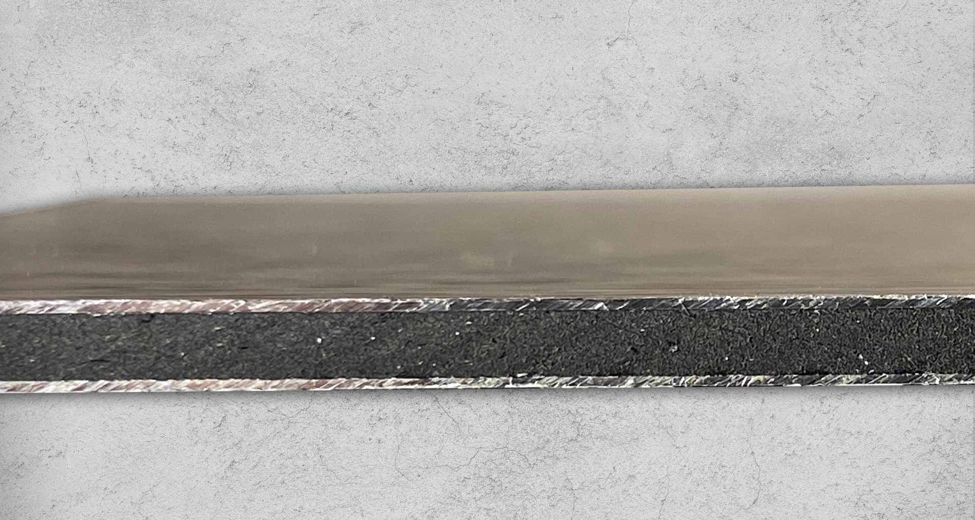

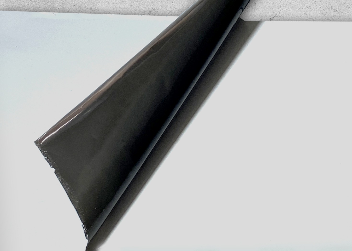

I have a Dibond plate just like that. It's too heavy and hence the efficiency is too low. It's lighter than solid aluminum, but not enough for me.I can get something like this,
View attachment 1132524 View attachment 1132525
3mm composite sheet, two 0.3mm aluminium sheet bonded with expanded polyethylene called Dibond cut to size, already covered with foil on both sides, factory pressed. That's how they normally sell, anyway.
About 20EUR for 2 sheets 40cm x 60cm including transport. Even, if I buy in 3-4 months time, it won't cost more, if at all few EUR.
The idea of foil cover comes from registered patents.

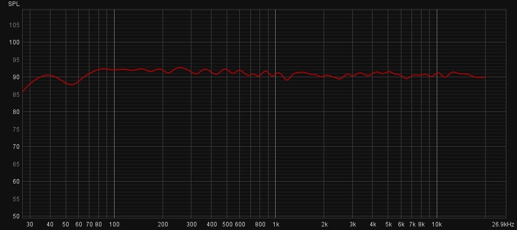

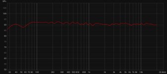

I have decided to do the dome tests on an old 20inchx14inch x 3mm ply panel coated in paint.
I might try my thinner dome first as it is at hand.
I took some quick measurements .
I have to post them separately as I cannot type using my phone since the Samsung update, I believe.
Pic1 hopefully will be the response at 12inches in front of the exciter area.
Pic 2 will be at 12inches in front, but 2ft up .
Pic 3 will also be 12inches in front But 2ft from the side.
The last 2 were just to show the response from different angles.
Steve.

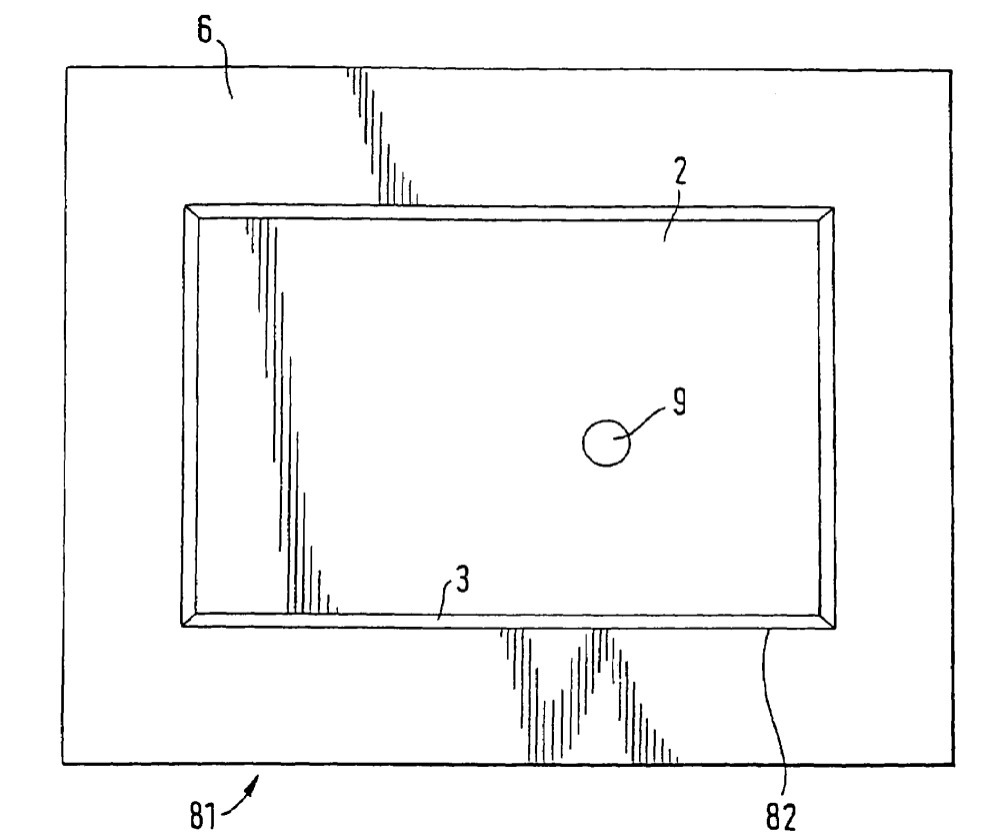

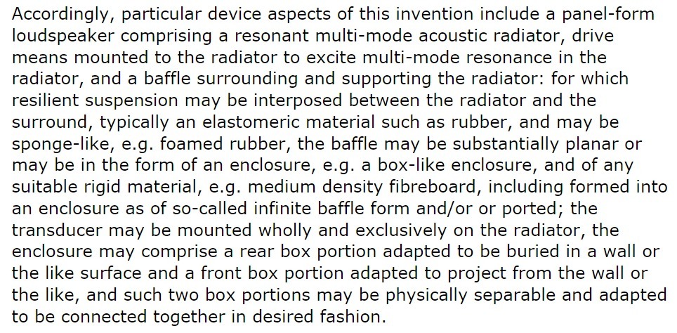

Has anyone tried this?
NXT states,
The above figure shows a distributed mode panel-form loudspeaker (81) in which a baffle-board (6), e.g., of medium density fibreboard, having a rectangular aperture (82) in which a distributed mode radiator panel (2) is mounted with the interposition of a resilient suspension (3).
The baffle-board (6) can help with low frequencies and/or if very close to a wall.
A transducer (9) is mounted wholly and exclusively on the panel (2) to excite the panel to cause it to resonate to produce an acoustic output.
Somewhere in the patent, NXT also states, "... are given in good faith after extensive testing, calculation and investigation etc.,..."

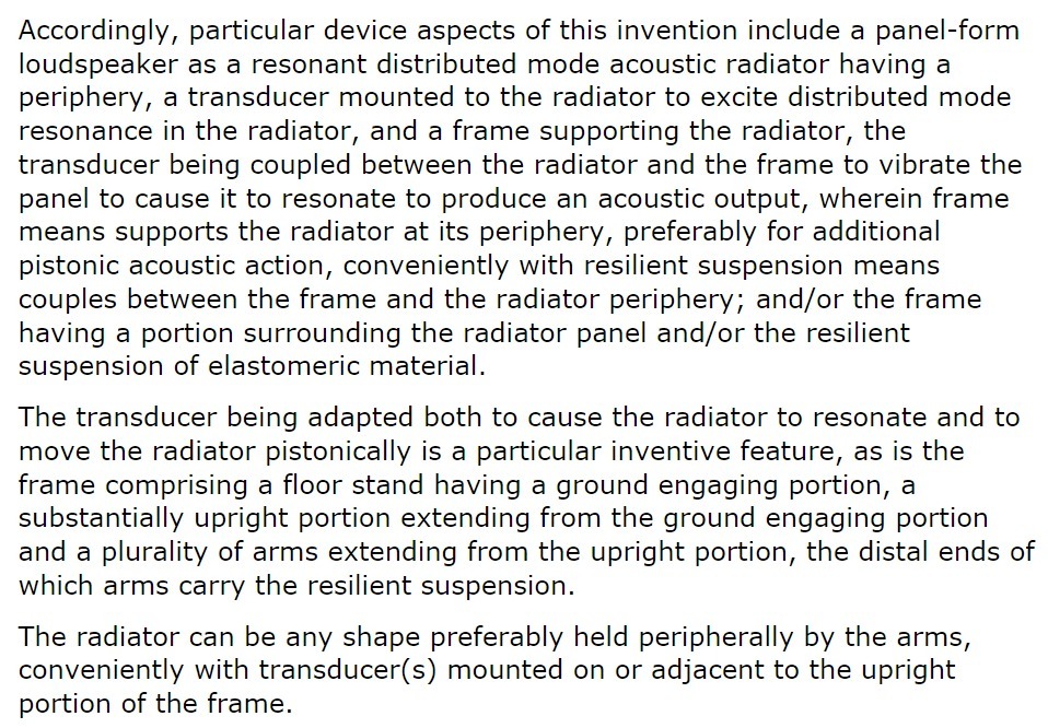

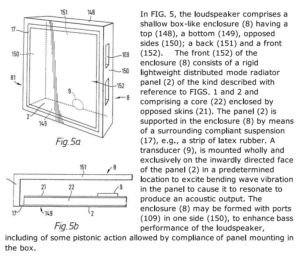

Another one from NXT,

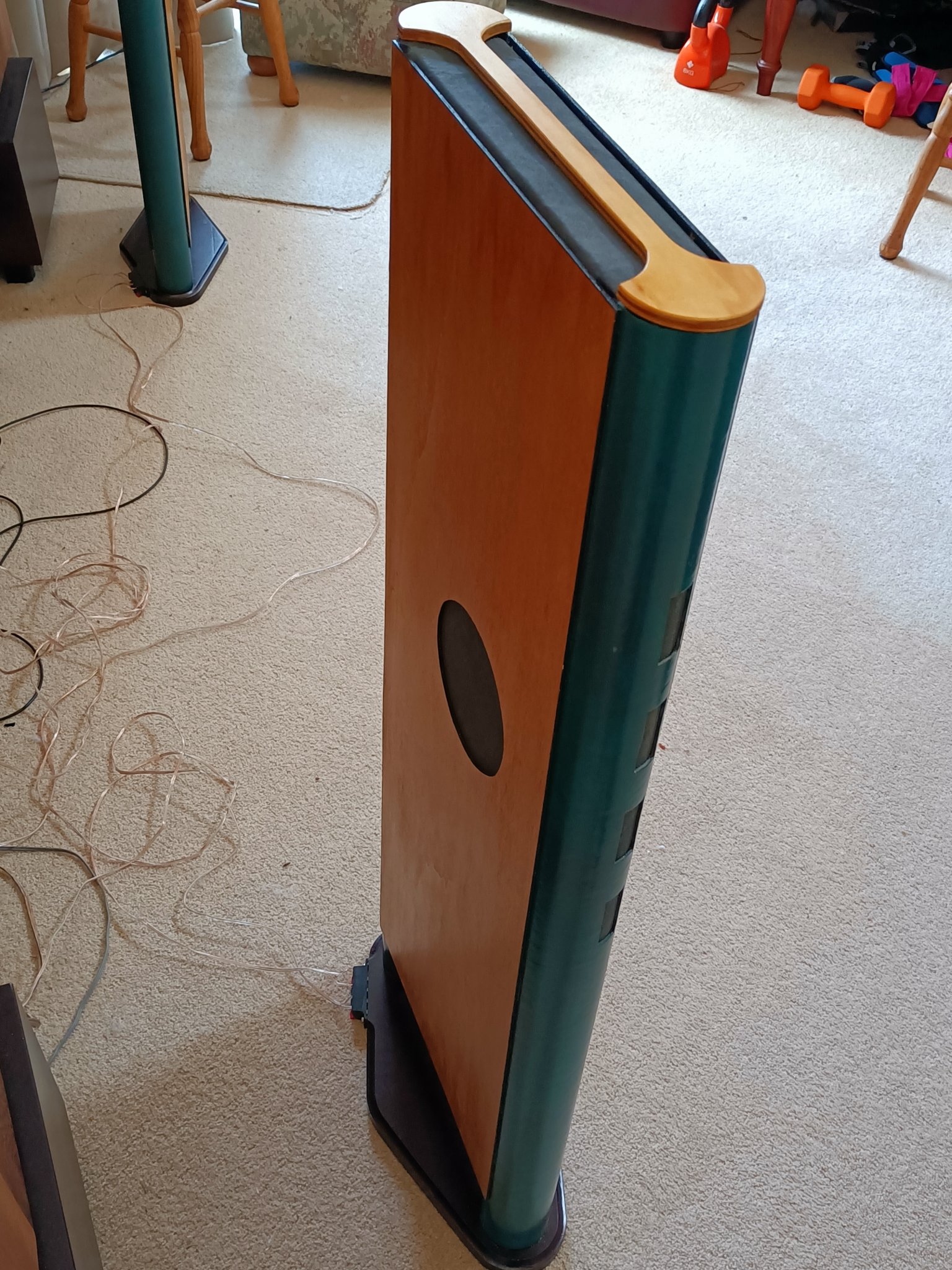

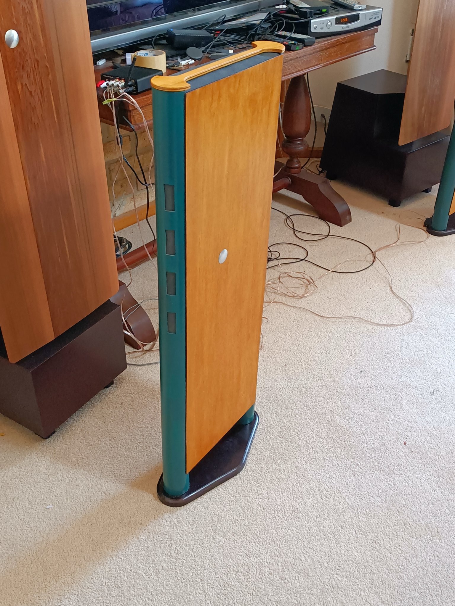

Something like @Veleric had made, but with the back closed.Such loudspeakers are relatively simple to make and can be made to have a relatively shallow depth, or apparently shallow depth, in comparison to conventional loudspeakers; and have a wide angle of dispersion in comparison to conventional pistonic loudspeakers. Where the radiator panel is made from or is skinned with metal foil or sheet, the loudspeaker can be made to be shielded against radio frequency emissions.
Enter Concept 2-Viridian....Another one from NXT,

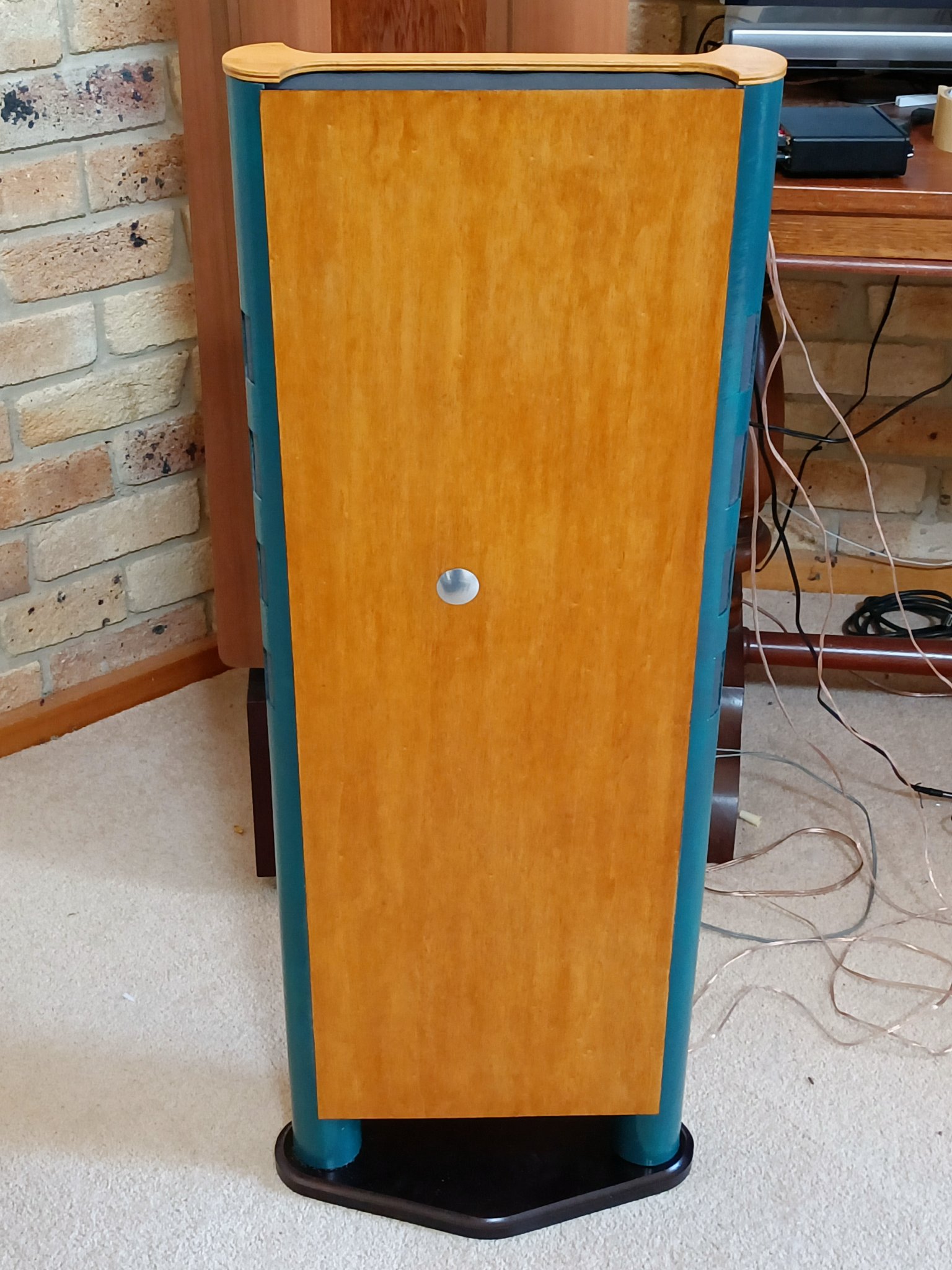

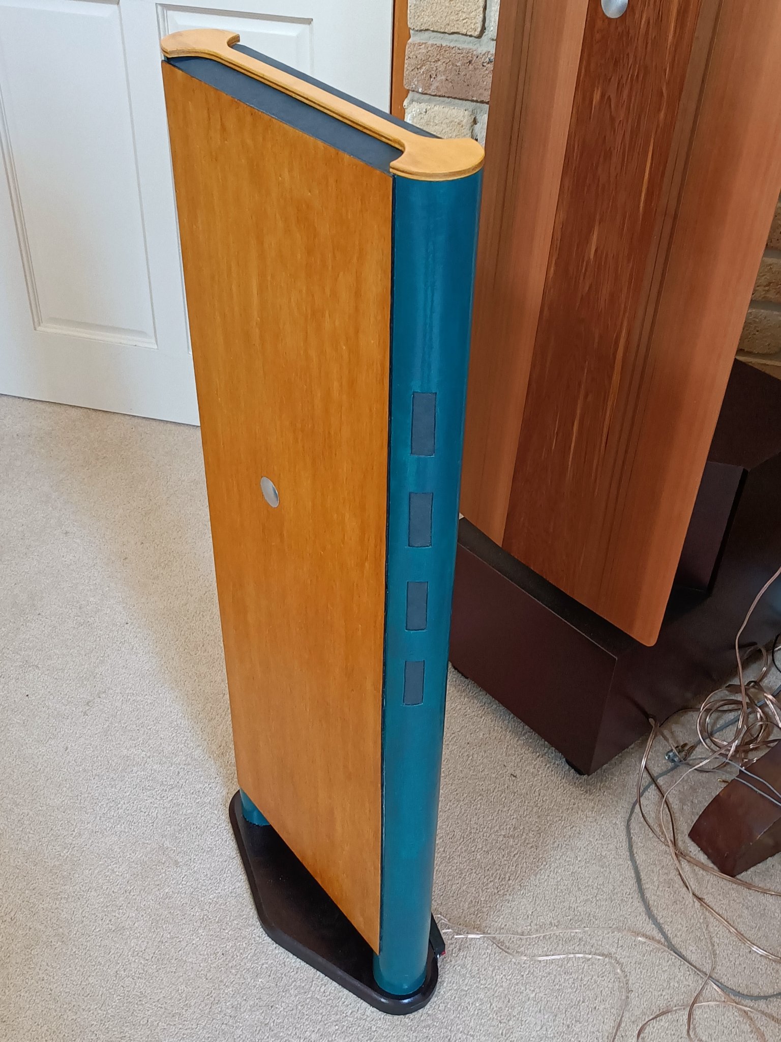

Very cool looking. More details please!Enter Concept 2-Viridian....
Eric
