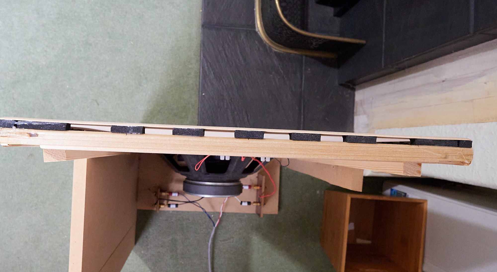

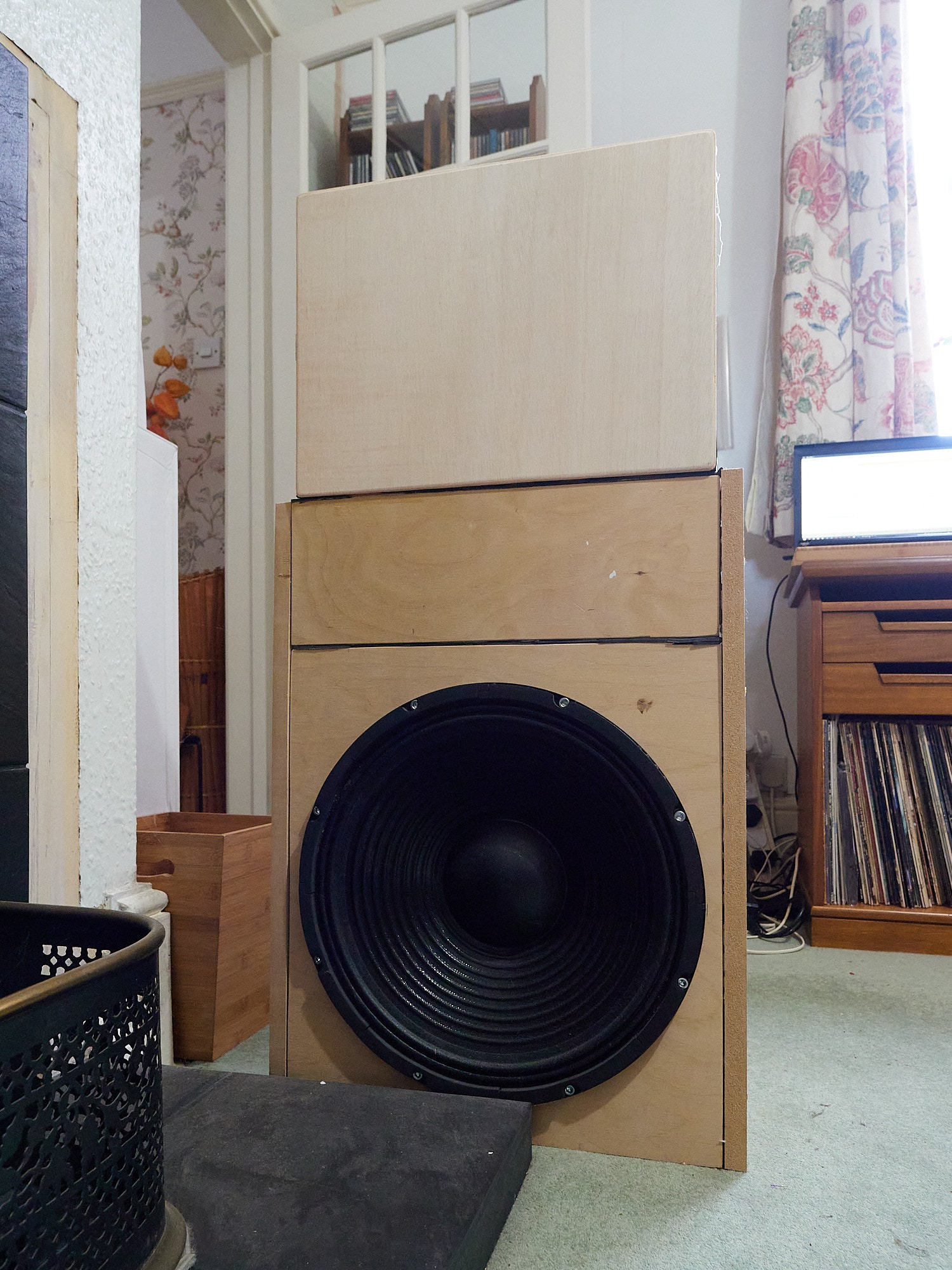

Hi Steve.
It's been a while! I'm only recently getting back into the speaker side of the hifi, having been concentrating on getting my Thorens TD150 mk1 fully set up in my self-designed skeletal plinth.
Your post is a timely reminder to apply the pea sized bit of blutak to the exciter area (I think this was one of the methods you mentioned, the others have escaped me a little.)
My panel arrangement differs from the norm insofar as I've gone for the old DMBLES method of attaching the panel to a 30x40cm canvas frame minus canvas, attaching the panel using a series of short lengths of 6mm neoprene foam with similar sized gaps between them.
Picture attached. They are a pig ugly prototype, but once the bass drivers go into H Frames, I'll be able to experiment far more easily with different approaches including minimal contact areas such as your approach. I can perch them on top of the H frame. I'm thinking of something like a retort stand type arrangement with the panels resting on a couple of old washing up sponges and against the top of the 'retort' stand, again with a bit of old sponge between top of panel and the retort stand post. Some sort of isolation arrangement between bottom of stand and the top of the H frame could help reduce unwanted vibrations from the H frame.

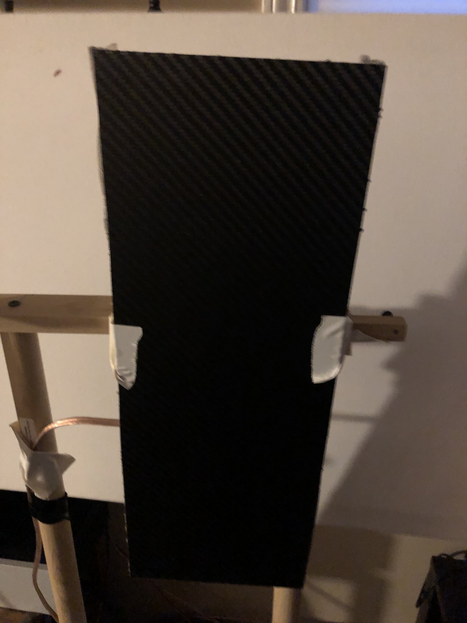

Dave,
Thanks for sharing those. The thing I find most remarkable is that I don't see any evidence of "ringing" at the panel's natural frequencies, in either spectrogram. I kind of expected that perhaps the "before EQ" might show more ringing than the "after EQ". But I don't see clear evidence of ringing in either spectro. What I mean by "evidence of ringing" is what I showed here:
https://www.diyaudio.com/community/...ing-of-dml-speaker-panels.394465/post-7234486
in my first two spectrograms, where the damping was apparently poor, there are vertical lines in the spectrograms, corresponding to frequencies that "ring" long after the signal is gone. Only the third one, with a well damped perimeter, approaches either of you spectrograms.
Can you tell me what is the foam you have around the perimeter? I would not have guessed that a strip of foam around the edge (but not attached to a frame) would be as effective as your foam appears to be. Did you ever do a measurement before adding the foam? If so I'd be really interested to see that too!
I guess another possibility is that your core (nomex, right?) has good damping properties. But I never recall hearing that about nomex before.
I also don't quite understand exactly how the panel is mounted. I know it's a "temporary mount" but still I'm curious exactly what you've done there.
Eric

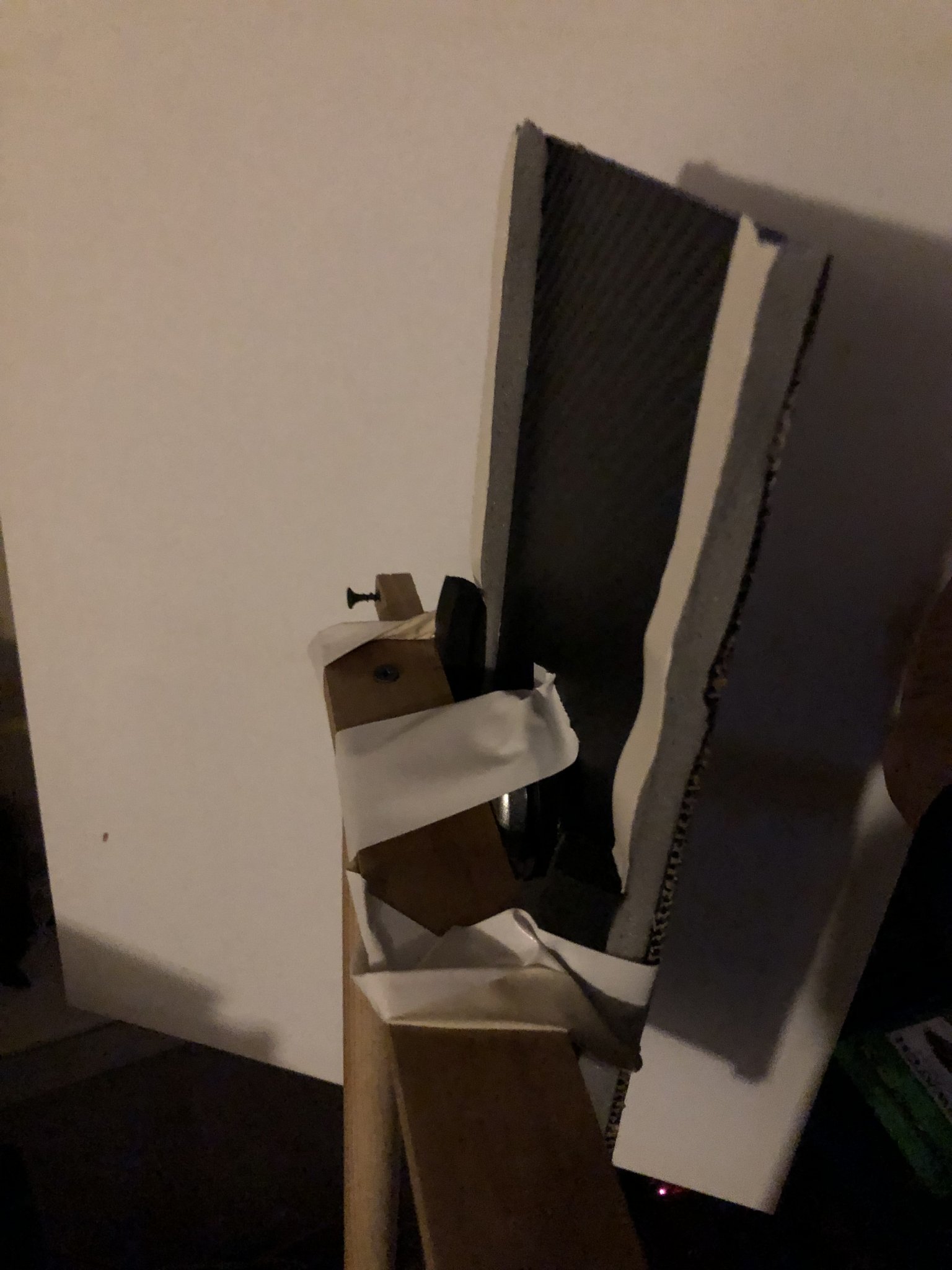

Eric,
I used 1/4"x1/2" foam strips along the two long edges. The "temporary mount" is actually duct tape attached at the center and wrapped around behind the exciter which is against a horizontal piece of wood. I've attached photos. If I have time this weekend I will try to take measurements with the foam strips removed.
Thanks, Dave

Eric,
Thanks, Dave
Thanks Dave, pretty (haha, I know it's a mockup!).
And that look like the soft gray window sealing foam, Frost King or similar, right?
I'll be really interested to see the spectrogram without the foam.
As I recall, you had that panel made for you from China, nomex,/CF right? What were the specs? (i.e. thicknesses of the core and skins? Do you know the areal density, or have you weighed it?
Eric

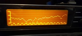

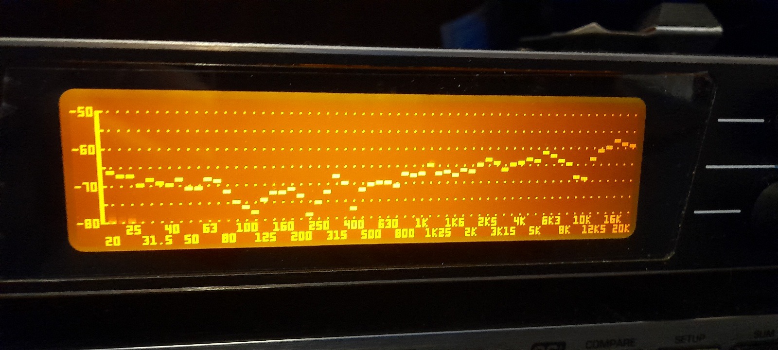

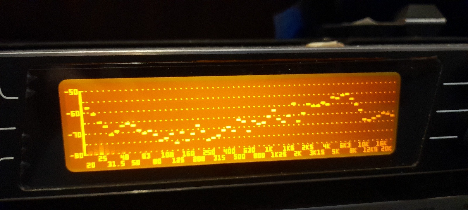

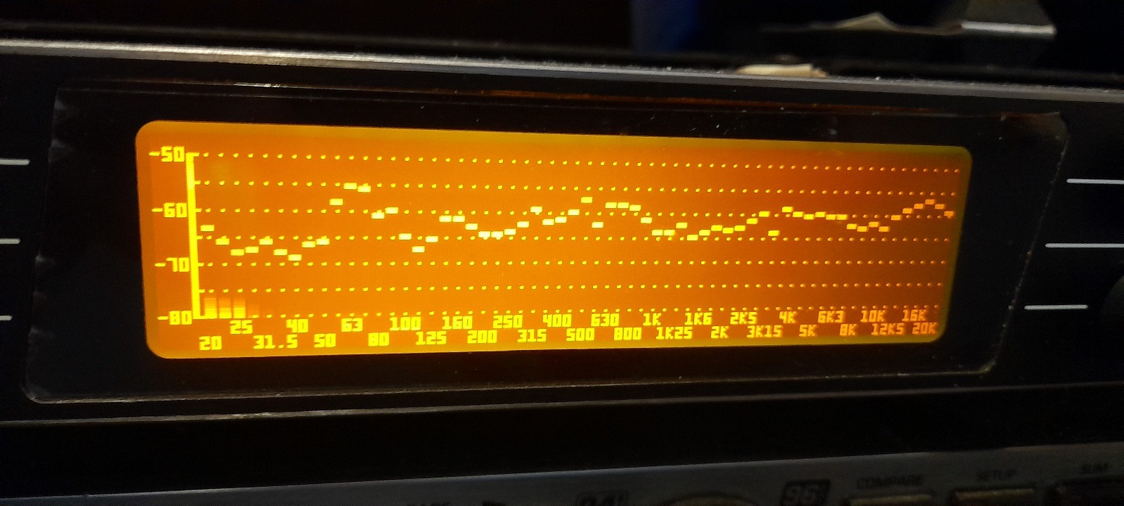

Eucy.
I have decided to do the dome tests on an old 20inchx14inch x 3mm ply panel coated in paint.
I might try my thinner dome first as it is at hand.
I took some quick measurements .
I have to post them separately as I cannot type using my phone since the Samsung update, I believe.
Pic1 hopefully will be the response at 12inches in front of the exciter area.
Pic 2 will be at 12inches in front, but 2ft up .
Pic 3 will also be 12inches in front But 2ft from the side.
The last 2 were just to show the response from different angles.
Steve.

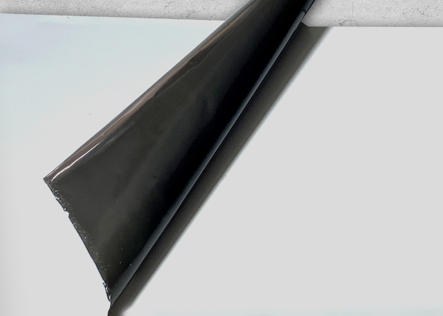

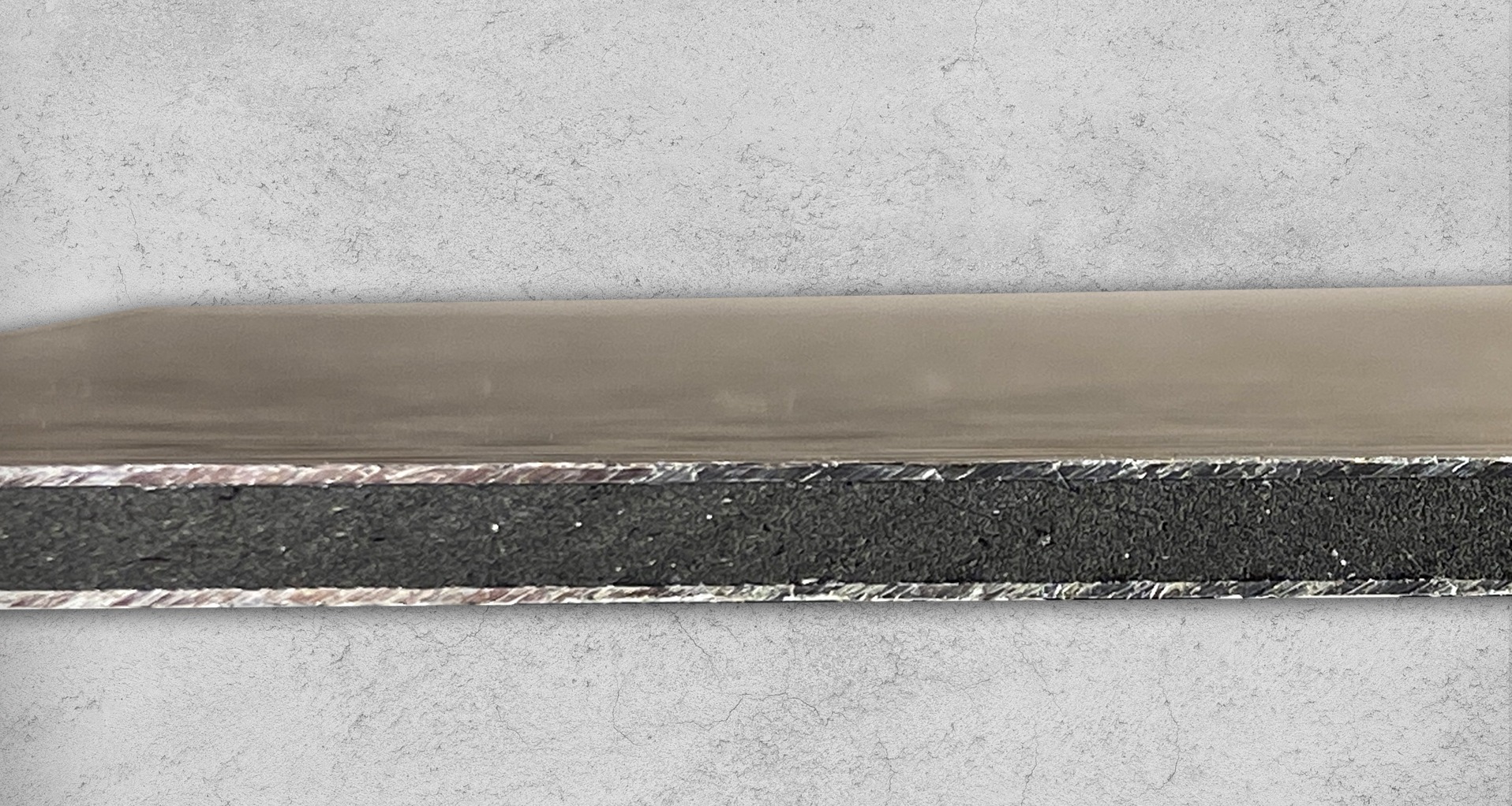

I can get something like this,
3mm composite sheet, two 0.3mm aluminium sheet bonded with expanded polyethylene called Dibond cut to size, already covered with foil on both sides, factory pressed. That's how they normally sell, anyway. 🙂
About 20EUR for 2 sheets 40cm x 60cm including transport. Even, if I buy in 3-4 months time, it won't cost more, if at all few EUR.
The idea of foil cover comes from registered patents. 🙂
