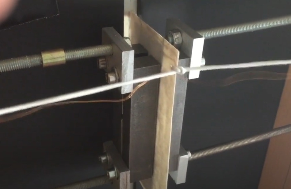

Thanks, but my idea is much more primitive. I don’t have a voice coil, but a solenoid. I don’t have delicate suspension, I have a couple of magnets repelling.Joppe is experimenting with 4 neodymium magnets 5 years ago.
At 51 seconds, you'd see how the sound was transferred to the DML. They look like two panels held together and the sound is transferred through the a little area of the edge in the middle to both panels.
The flat (printed) voice coil is pasted between the two pieces of paper, which are also pasted to each other. The elastic string is to bring back the voice coil from jumping off and keeping it centred between the magnets.

The voice coil must've been printed from an alu foil. He'd been using an ink printer those days. Before this, he had been experimenting with Haddock's ideas, the rubanoide etc.Thanks, but my idea is much more primitive. I don’t have a voice coil, but a solenoid. I don’t have delicate suspension, I have a couple of magnets repelling.

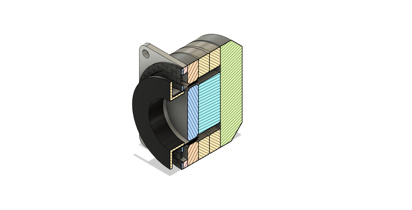

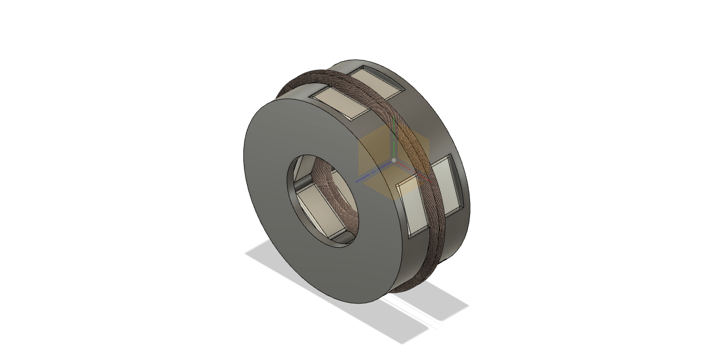

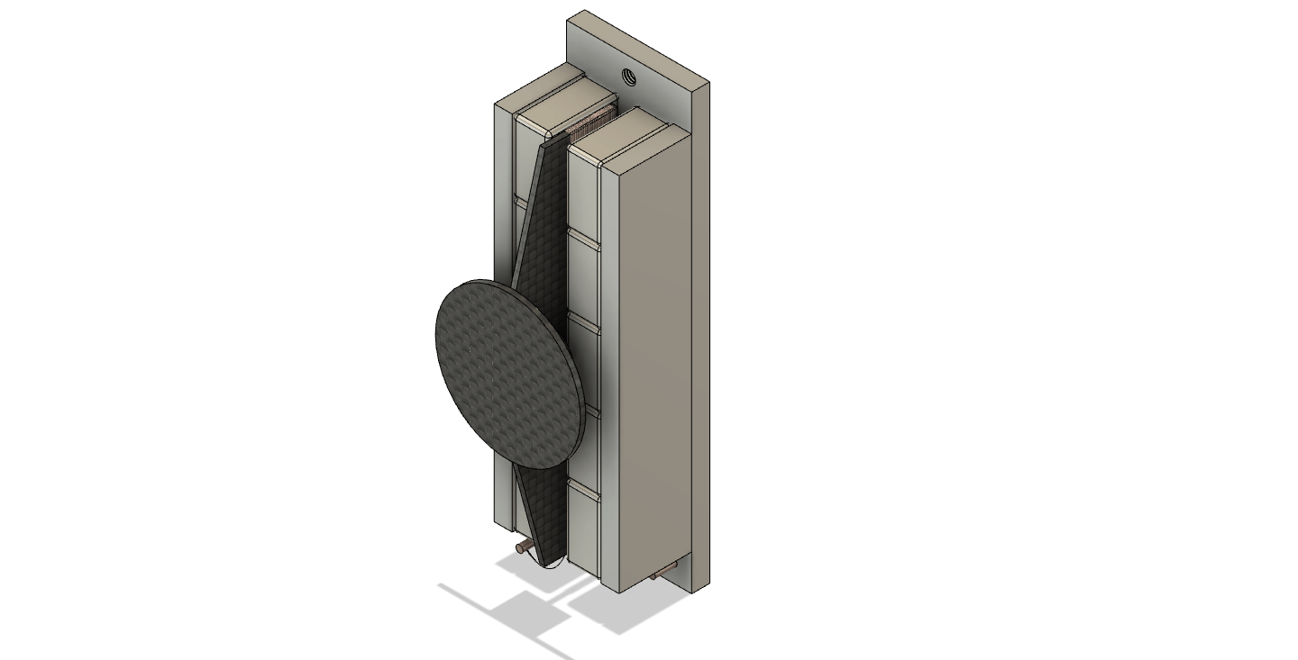

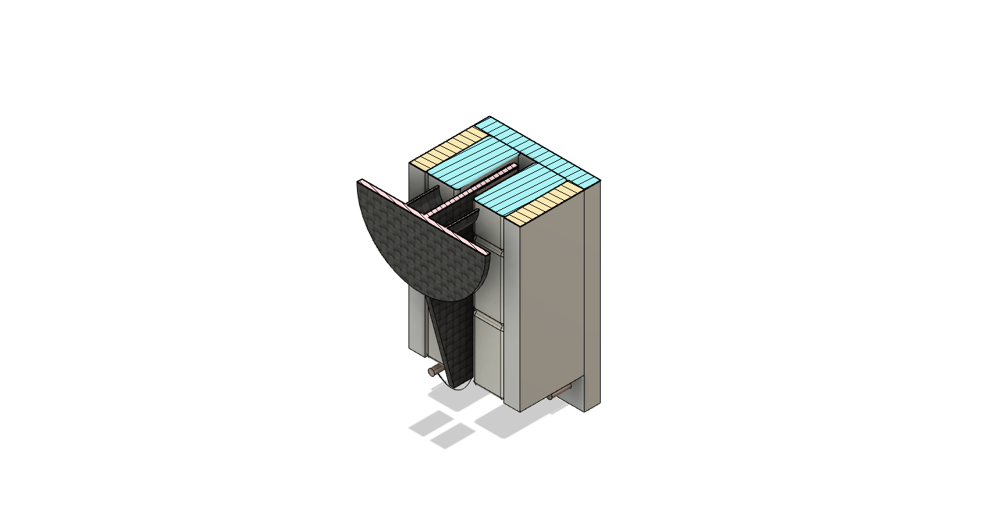

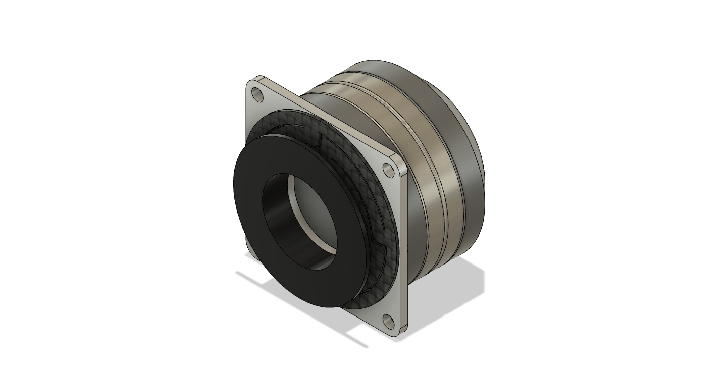

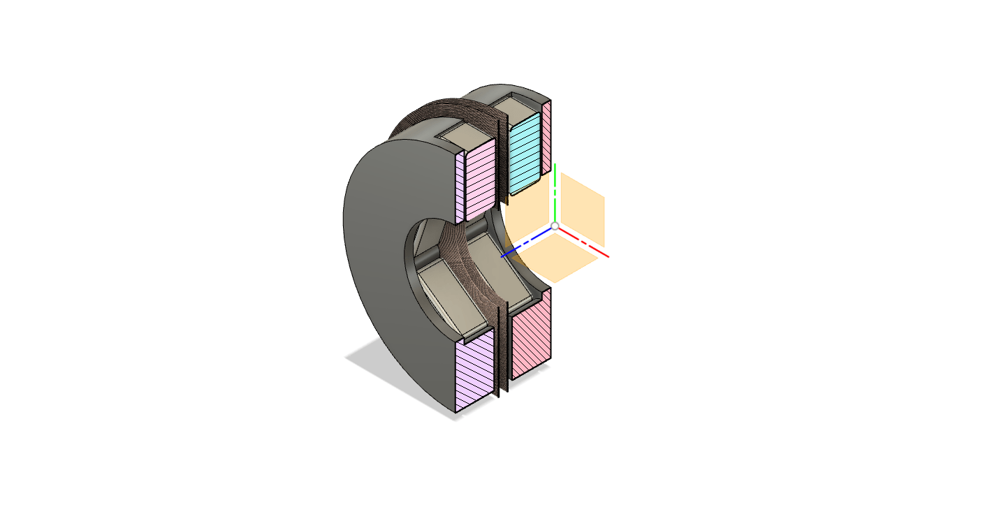

I am exploring three possible directions at the moment. A preview below.Burntcoil.

Burnt

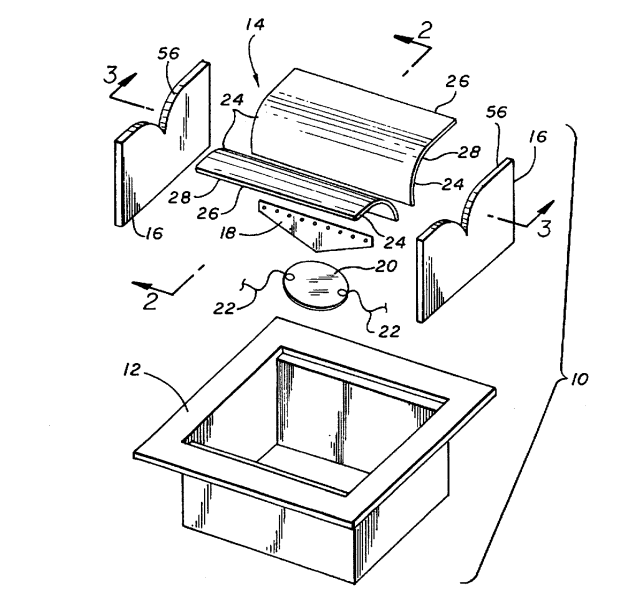

4) Why the curved flat surface, paper in this case, gives out even more clear and full sound than the same paper kept straight with edge transfer of sound? Telefunken Arcophon from 1926 and Paul Haddock's patents from 1990 to 1998.
A piezoelectric driver (20) is the sound source. Flat upturned triangle (18) is the bridge. The curved paper membranes (26) are the DML panels. The membranes are fixed and damped along the perimeter, half of which is practically flat. Of course, this is just a patent, probably the speaker had not been made after the patent was issued, but Telefunken had sold Arcophon speakers with the same idea from 1926-1932. The point transfer of the sound vibrations/waves to an edge of two curved flat panels, in this case paper. In this patent, the perforated edge of the bridge transfers the energy/waves/vibrations to a thin strip at the edge of the two DML panels. Why it gives clearer, fuller sound is not yet answered.
