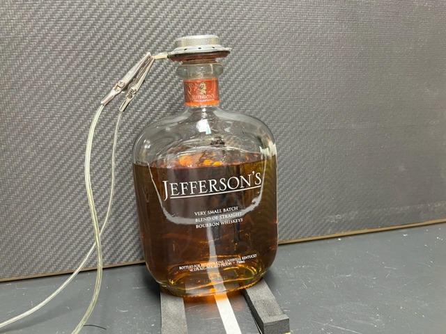

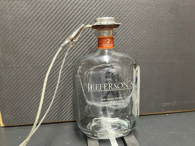

Did a new test yesterday. I put my exciter (DEAX25HFE-4) on the top of my bourbon bottle and played one of my favorites (Dire Straights, Telegraph Road). Fortuitously, the top of the bottle had a nice flat surface of the perfect diameter for the exciter. When the bottle was (nearly) full, the sound wasn't great. Low efficiency and very biased to high frequency. Luckily, the exciter has a little hole, so I was able to pour out the bourbon little by little. By the time the bottle was empty, it sounded great!
I did some REW frequency measurements, but curiously, they were almost identical full and empty. Can't explain. Is anybody willing to verify these results with their own tests?
Eric

Hello Eric
Low efficiency and biased to HF fit with my current model (meaning knowledge). Heavy => low efficiency, heavy and stiff => high mechanical impedance => less HF cut off with the coil mass.
No problem in your experiment when you poured out the liquid it goes in the voice coil/spider area?
The FR are the results of several treatments of the raw IR. The FR shows the result of the FFT over a time window. Basically 0.5s if I remember.
Have you had a look to FR with lower or even no smoothing (more peaks in one FR?)?
Have you had a look to the spectrograms that can show what happen over the time?
Christian

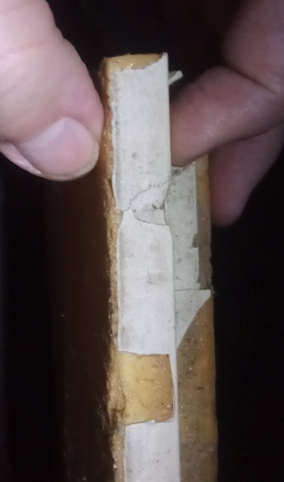

You mean polyurethane foam?
Yes . A typical can pictured below and my existing foam material.

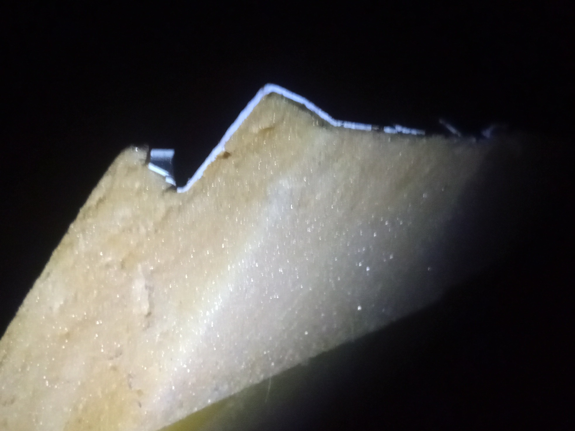

About existing material: At the 1/2" portion I can squeeze with all my might and my finger will indent only about a quarter of the way into the foam and will re-expand to almost flat again. We're talking dense, thus the lower efficiency compared to EPS though I'm not sure how dense EPS gets.
I took these photos at night to capture the glistening that the raw material has. Note the plastic shell of the old cooler. There is no telling how old this cooler is from just the sun damage because down here the sun during summers is brutal. It was a large 4' x2' cooler possibly used on boat by fishermen for their catch which I see a lot. But there are a lot of bars down here and it did have Corona on the side, sooooo?
Anyway, when I compare the materials with a sturdy tap test it seems as the poly and the EPS are very similar with each having a "thud" sound compared to XPS which has a "ding" sound. The poly tone is tighter and seems to carry it's sound slightly after striking it where the EPS just stops. It's sort of a sweet spot between the mellowness of EPS and the higher range of XPS without the "tunnel effect". I think that is why I like this material because it gives off great, smooth, mids and highs as I let the subs do the rest. I'm not going for full range and if I tried, say for some shop speakers, it would be some sort of canvas/tonewood combo.
I'm not sure just how different all the spray foam in cans differ and experimentation would start adding up $, but I'm sure I'll give it a go making at least a couple of panels.

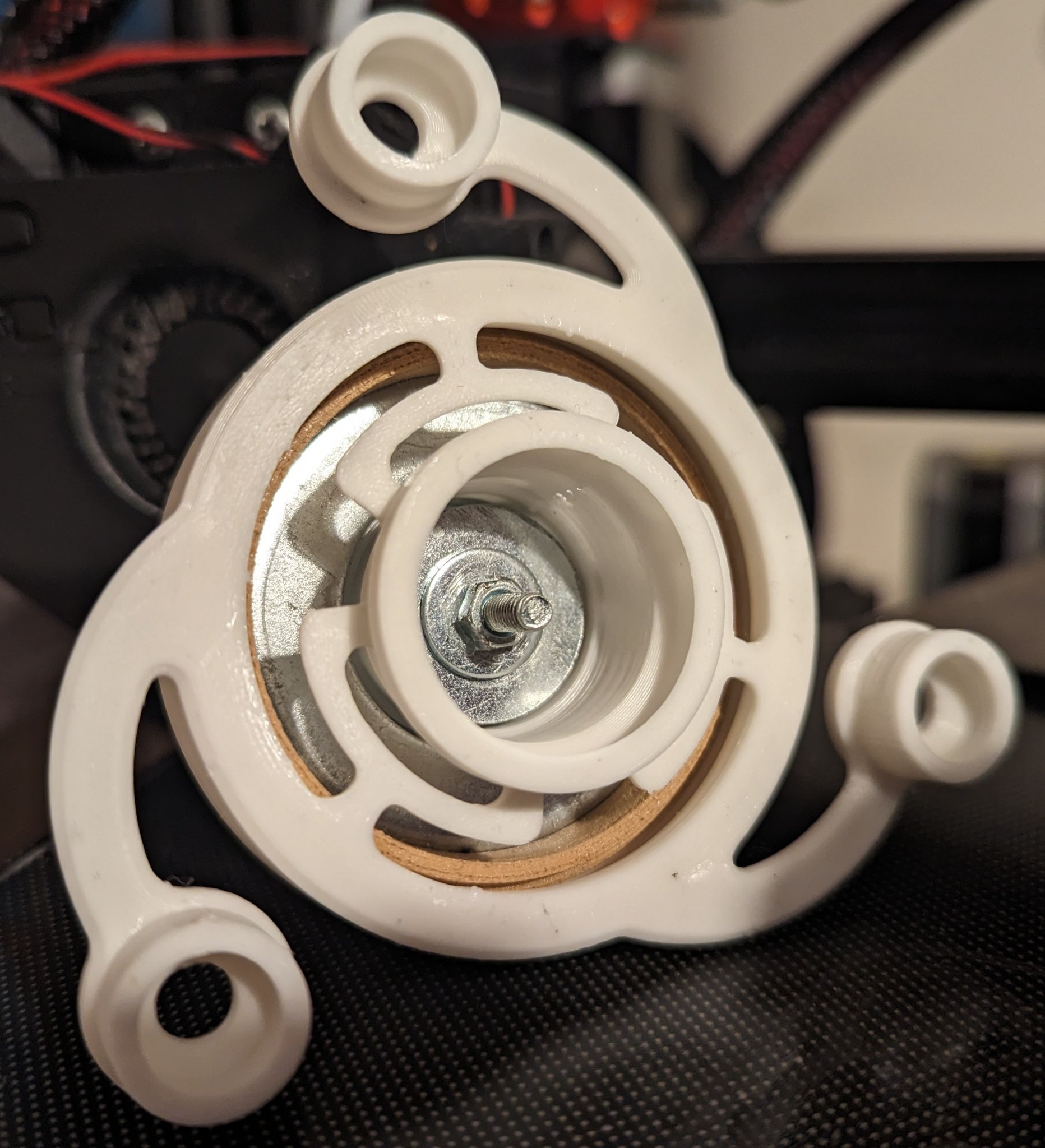

Hello everyone
A long long time ago I mentioned about possibly making a exciter with 3D printing. Now wanting a quick break from my full range driver work, I made this one this week:
It uses my screw in interchangable magnet motor so its easy to swap out most of it from one to the next. Is uses a 20mm VC and design shape is just based upon previous designs. Bl is around 1.9Tm @ 3.2 Ohm and inductance around 0.14mH
I will be getting better materials for the board after taking some time to read through this extensive thread. Just wanted to share that I have gone ahead with producing one as a fun side project.
Terrible video on some old cardboard showing it works in some form is available here:

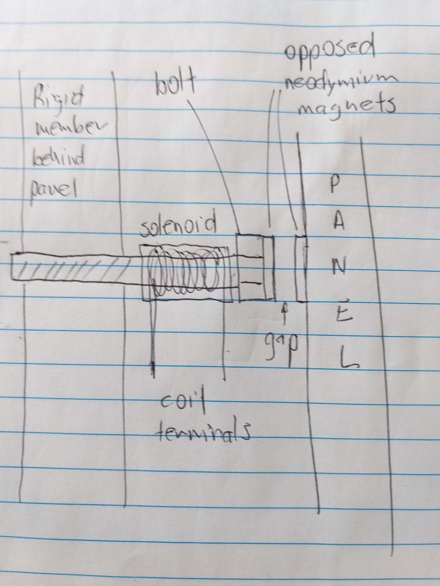

What about this for a simplest-possible exciter idea aiming at directly exciting directional bending waves. Is it worth a try, or doomed to failure? Probably highly non-linear at LF, but idk how much that would matter. Would also have high inductance. Could try first with one bolt only, to see if enough force might be generated to give reasonable efficiency.
The idea is that the neodymium magnets provide repulsive force that prevents contact between the external solenoid, and the panel, so that an oscillating magnetic force (the signal) is added to an overall repulsive force.
1) Wind two solenoids in series on two mild steel machine bolts. Make them opposite magnetic polarity (one head is N, one S). Use enough wire for 4 ohms total. Or maybe make one U-shaped magnet with two heads instead.
2) Glue two small neodymium disc magnets onto the head of each bolt, so that (say) the N poles of each face outward.
3) Glue two more small neodymium disc magnets to the rear of the panel where you wish to excite, again N outward.
4) Mount the bolts through a hole in a rigid member, so the magnet on the bolt head is closely opposed to the one on the panel. Adjust distance by turning bolt.
5) Wire up to amp & listen!

I tried this with 2 different bottles - one very heavy single malt bottle and one Jim Beam Black. I just held it to the neck ring. Failed to get excited about it and ditched the bottles (they were already empty) 😊
Probably needed more patience..😒

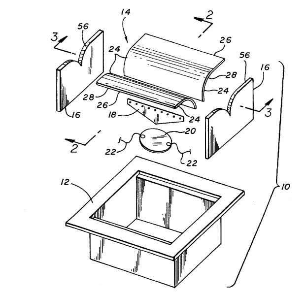

4) Why the curved flat surface, paper in this case, gives out even more clear and full sound than the same paper kept straight with edge transfer of sound? Telefunken Arcophon from 1926 and Paul Haddock's patents from 1990 to 1998.
A piezoelectric driver (20) is the sound source. Flat upturned triangle (18) is the bridge. The curved paper membranes (26) are the DML panels. The membranes are fixed and damped along the perimeter, half of which is practically flat. Of course, this is just a patent, probably the speaker had not been made after the patent was issued, but Telefunken had sold Arcophon speakers with the same idea from 1926-1932. The point transfer of the sound vibrations/waves to an edge of two curved flat panels, in this case paper. In this patent, the perforated edge of the bridge transfers the energy/waves/vibrations to a thin strip at the edge of the two DML panels. Why it gives clearer, fuller sound is not yet answered.

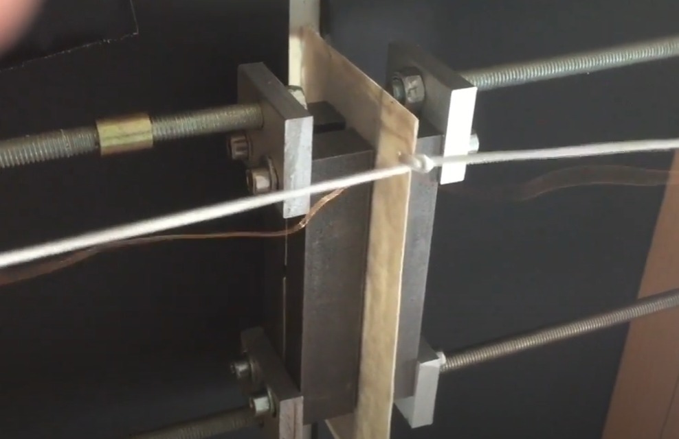

Joppe is experimenting with 4 neodymium magnets 5 years ago.
At 51 seconds, you'd see how the sound was transferred to the DML. They look like two panels held together and the sound is transferred through the a little area of the edge in the middle to both panels.
The flat (printed) voice coil is pasted between the two pieces of paper, which are also pasted to each other. The elastic string is to bring back the voice coil from jumping off and keeping it centred between the magnets.
Reactions: spedge
The two panels are somewhat separated from each other. There's a thin strip (paper, aluminium) pasted on the edges of the two panels vertically in the middle (1.33 mins into the video). That is, most probably to get the high frequencies.
