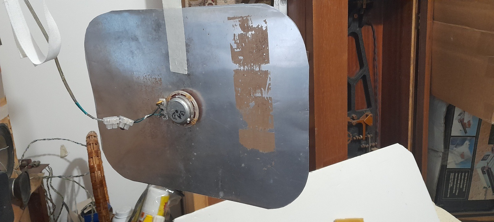

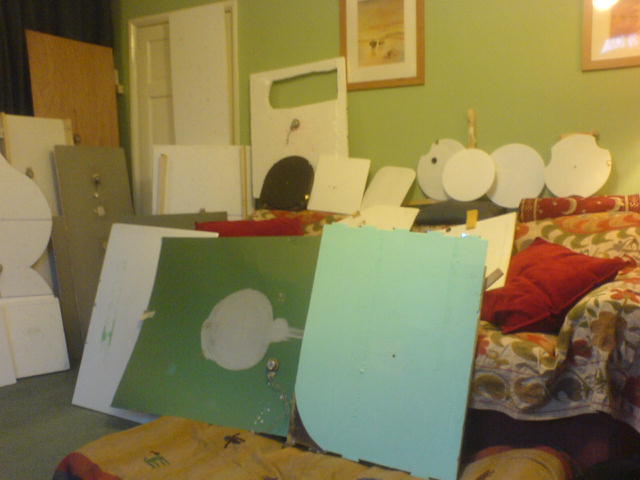

The new small aluminium panel is the first picture .
The second was taken in 2014 with some of the other panels I had.
The green one in the front with the grey circle is the aluminium panel with exciter still attached.
I found the third picture on my phone while looking for the aluminium panel photos.
