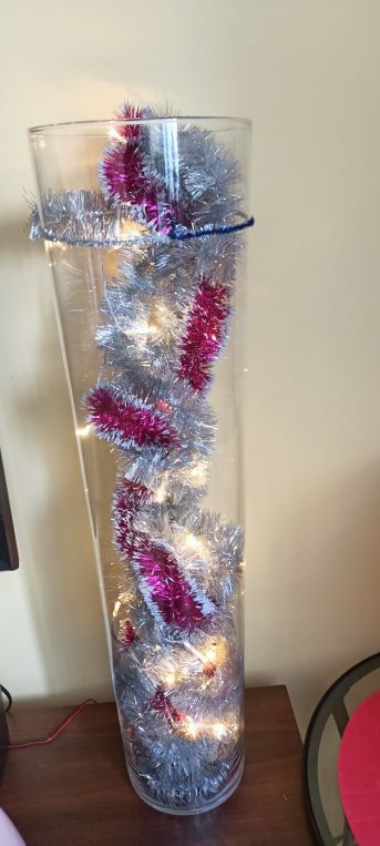

The idea here is to search for means, reasons why sound comes out of surfaces, flat or otherwise, once a sound source is attached to it. Maybe, how the sound travels from that surface to our ears could be important, but is secondary. Why the same flat surface gives out more full sound when curved is more interesting (Telefunken Arcophon 3 speaker of 1926). It'd be pretty hard to send waves on a curved surface. Inner surface is much stiffer/tougher than the front. The fully closed curved surface, a cylinder is the most stiffest, still it gives fuller, clearer sound, than a flat surface of the same material.
The diameter at the bottom of this glass vase is 12cm, open top diameter 18cm, the glass thickness is ~3mm, the glass bottom is 1 cm thick, height is 70cm. We have two of them. They have been tested for sound amplification for a brief moment, once with the 'exciter' at the centre under the thick glass bottom, once with the exciter touching the open side holding the vase upside down. Not an easy thing to do, though. It was much easier to place the 'exciter' underneath, fix the vase in a wooden cylinder, so it won't topple. The resulting sound amplification was very nice. That experiment was done for a few minutes. They have been bought for X'mas decorations. Might be used later for other kind of decorations.
But the preliminary testing for sound was done. Once the exciters are hidden in a decorative wooden cylinder/box, there'd be no way to tell where the sound is coming from. Decorations can stay in. I suppose the X'mas decorations won't come off until February, so got to wait for further testing. Someone might say this vase looks like a horn, but there's no opening at the bottom, only a solid block of 1 cm thick glass. Interestingly, sound doesn't come from the open end, but from the surface of the vase, a curved enclosed panel. If the sound come from the surface, then that surface is DM surface.

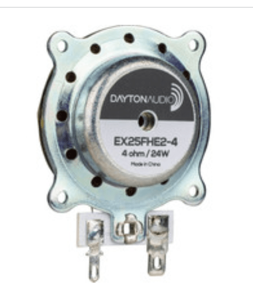

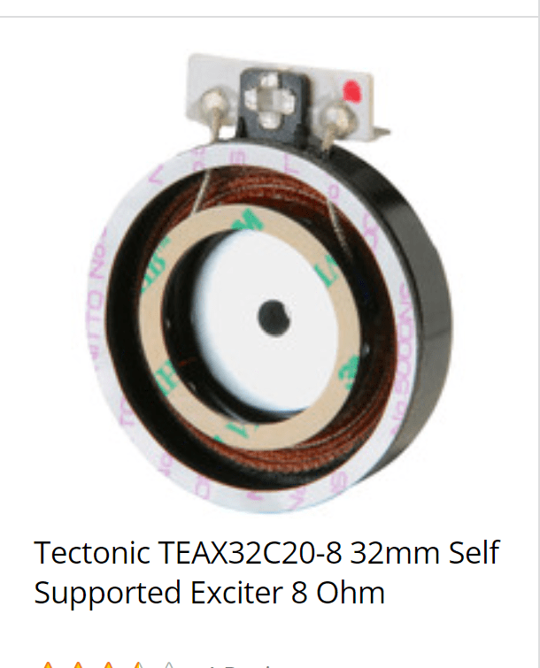

Another thing I’ve been thinking about is exciters. Seems to me that exciters derived from conventional speakers are an inefficient way to excite a bending wave. Voice coil exciters are designed to create a velocity, which in turn shakes the panel and creates bending waves, which ultimately gives the velocity of the panel moving at any particular point. But to create a bending wave directly, presumably what you want to do is apply a bending stress to the panel. So you need at least two points on the panel moving in opposition. I would guess this simple arrangement would be more efficient than the flexing cause by the inertia of the exciter and panel. Two points let you change the distance between the points to excite different frequencies optimally. It would also leave open the possibility of directed waves, and more potential for adjusting the frequency response by changing the direction of one exciter, or using multiple exciters in different directions, possibly EQed separately. Or maybe a three-point or four-point exciter where the bending direction is rapidly rotated, giving a more random excitation. Then again, I may be just delirious from lack of sleep. Goodnight.
Sorry about your indigestion problem. Hope, it'd be over by tomorrow.Another thing I’ve been thinking about is exciters. Seems to me that exciters derived from conventional speakers are an inefficient way to excite a bending wave. Voice coil exciters are designed to create a velocity, which in turn shakes the panel and creates bending waves, which ultimately gives the velocity of the panel moving at any particular point. But to create a bending wave directly, presumably what you want to do is apply a bending stress to the panel. So you need at least two points on the panel moving in opposition. I would guess this simple arrangement would be more efficient than the flexing cause by the inertia of the exciter and panel. Two points let you change the distance between the points to excite different frequencies optimally. It would also leave open the possibility of directed waves, and more potential for adjusting the frequency response by changing the direction of one exciter, or using multiple exciters in different directions, possibly EQed separately. Or maybe a three-point or four-point exciter where the bending direction is rapidly rotated, giving a more random excitation. Then again, I may be just delirious from lack of sleep. Goodnight.
When you wake up tomorrow, let's know what you think about the "pebble in the pond" type waves on a much more solid surface than water. Any wave would slow down and die in/on water. Waves on water might hit an obstruction and turn back, and obstruct the oncoming waves. When there's no movement, the water surface would settle and stay still. I've seen this still water in/on a private lake. After all water, is a liquid.
Now, if on a EPS sheet surface, which is very poor in terms of rigidity, waves starts moving, the ups and downs of the waves should stay on the surface. It is not a liquid to settle down. After a while, the EPS sheet should have wrinkles. But it doesn't. A very thin paper might flutter, but as paper is also a solid, so too much flutter would deform it. The "pebble in the pond" doesn't cut it, does it?
If you were to use the holes on the frame of the first exciter image below to screw the exciter to the panel, wouldn't that create a bending moment?But to create a bending wave directly, presumably what you want to do is apply a bending stress to the panel. So you need at least two points on the panel moving in opposition.
I think the inner and outer rings of the second exciter would also create such a bending moment.
Neither is as sophisticated as what you were imagining, but at least they should create a bending moment directly.

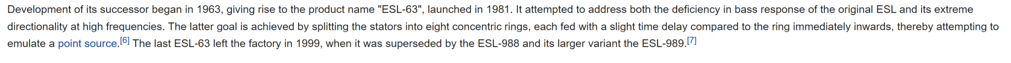

Other than the Goebel, the other speaker that supposedly tries to create a wave that expands from the center out (i.e. the "pebble in the pond" type), is the later version of the Quad ESL.-63.
What are the characteristics of the ESL-63 and it's later variants (ESL-988 and 989)? And would a highly damped panel as I have described have similar characteristics to it?
