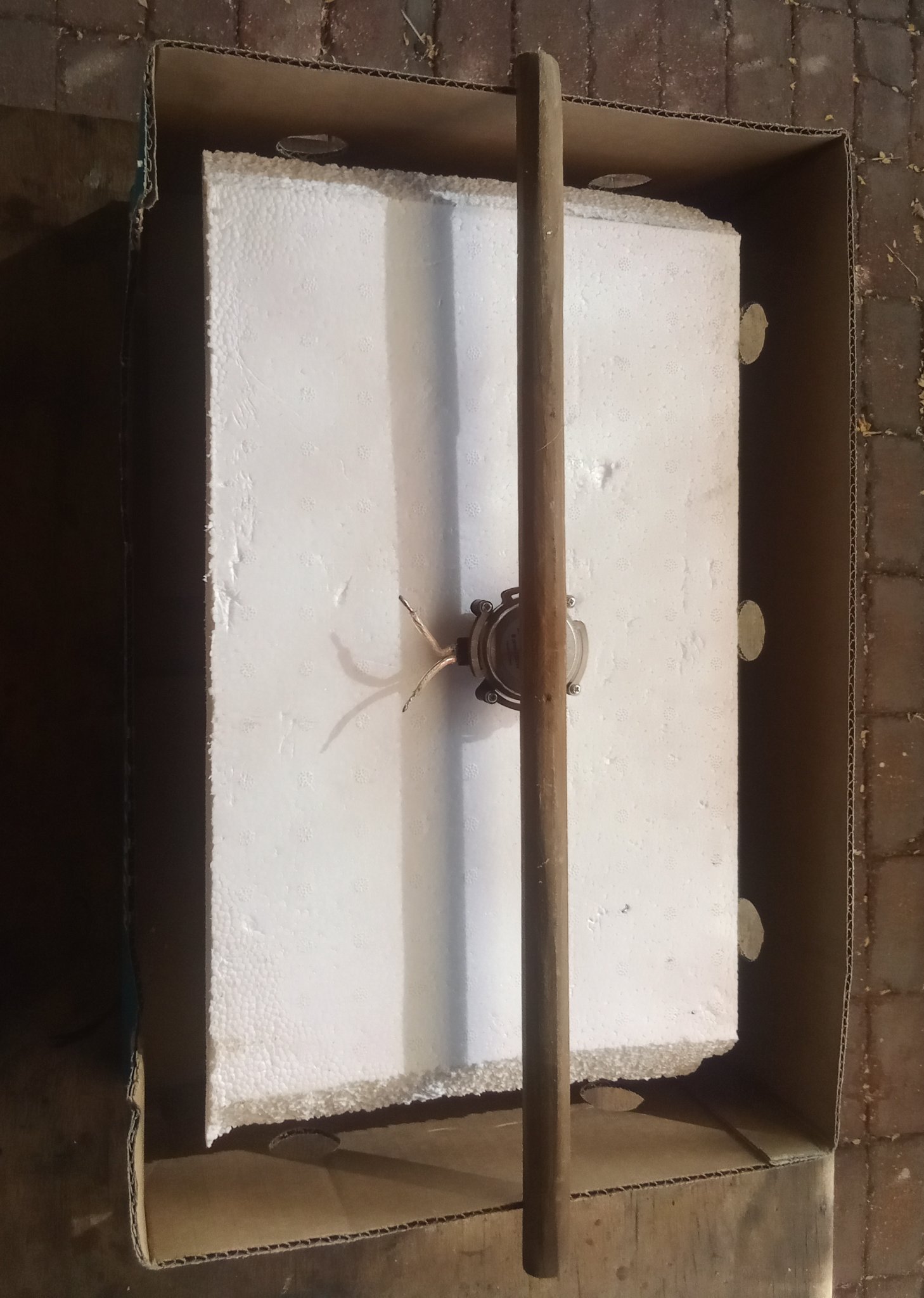

@pixel1,
Have you sorted out your exciter issue yet?
I think Steve and Todd and others have suggested some of the same things I would suggest.
That is a heavy exciter, it it looks like the wires and connectors you have hanging it too are also a bit heavy.
I too think it's most likely that the support of a spine will likely solve your problem.
In post linked below there are some images showing how I make the spines I use to support my exciters. In the images, the black block between the exciter and spine is a piece of soft foam with adhesive on both sides. I like the soft foam there as it allows you to a little more room for error in positioning the spine the correct distance from the panel to avoid pressing the exciter too hard against the panel. I think attaching the exciter to the spine with a screw instead of the foam block is fine also as long as you are able to precisely position the spine.
Eric
https://www.diyaudio.com/community/...s-as-a-full-range-speaker.272576/post-7121486
Eric
@pixel1Sorry I'll add more I'm not sure if you see the first one
Can you share more details of your build here?
I recall you were looking at CF/nomex panels, and I assume that is what you are showing, here right? I seem to recall you were looking at two different thicknesses, which did you get? Can you reshare the link describing the panels? Either one seemed like it would be very high efficiency, equaling or perhaps even exceeding PS foam.
What size is the panel and frame, and how is the panel attached to the frame? I think I see some screws in the panel at the perimeter but it's not clear how they are being used. Can you explain?
Thanks,
Eric

thank you@pixel1
Thanks,
Eric
I think I will follow the advice of the structure to support everything
even if I have to see the photos to understand how to adjust the pressure, I imagine that the squeeze must stop at a slight push
