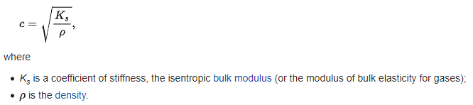

The fact that "the speed of sound is much faster in a solid than it is in the air" has been brought up several times recently, and it got me thinking about what exactly is meant by the "speed of sound in a solid". And I realized only then the irony of our situation. And that irony is this: "the speed of sound in a solid" (as it is most commonly understood) is virtually irrelevant in the discussion of speakers!
Typically when someone refers to the "speed of sound" in a solid, they are talking about the speed of sound of a compression/longitudinal wave. However, when such a wave is travelling though a solid, the deformation of the solid due to this wave is so miniscule, that the only way you can typically "hear" the so-called "sound wave" is to put your ear directly into physical contact with the solid. So in the sense of being a wave that creates any meaningful level of sound, well, it's barely correct, I would say, to call such waves "sound waves". Being that these waves do not produce meaningful sound levels, the speed of such waves is largely irrelevant in the discussion of speakers.
Such waves might be reasonable to call sound waves in the sense that they are similar to sound waves in air, in that both waves are compression/longitudinal waves. But compression waves in solids don't produce significant compression waves in the surrounding air, and in that respect aren't really (significant) "sound waves" at all.
There are several types of elastic (or "sound") waves that can travel through solids. In addition to compression waves there are bending/shear waves, Rayleigh waves, Love waves, and perhaps others. But of these, only bending/shear waves typically have enough displacement to produce sound waves in the adjacent air. Hence, the speed of bending waves in solids is very relevant to the discussion of bending wave speakers.
On the other hand, the "speed of sound in a solid" in the usual sense, that is, the speed of compression waves in solids, which actually produce no significant sound, is largely irrelevant.

Eric,
What you just posted is correct, but now what axis do you have the shear wave propagating in? By definition shear waves can only exist in solids. Liquids and air can not support shear waves unless the shear wave is longitudinal, but shear waves are transversal waves by definition. So they can only exist in solids and propagate 90 degrees to the longitudinal wave which can propagate in liquids and air.

Agreed, except that the speed of bending waves is related to the speed of longitudinal waves, and people may be referring to bending waves as 'sound' or 'source of sound' in the solid, without knowing the technical meaning of 'speed of sound in a solid'. To be unambiguous, we should say 'longitudinal' or 'compression' when we mean that. In many cases in discussions here, I simply assume people are talking about bending waves (unless they are one of the couple who apparently don't 'believe' in them, then I don't assume, and don't care). You can also get mode conversions upon reflection, so longitudinal waves can create sound that way.The fact that "the speed of sound is much faster in a solid than it is in the air" has been brought up several times recently, and it got me thinking about what exactly is meant by the "speed of sound in a solid". And I realized only then the irony of our situation. And that irony is this: "the speed of sound in a solid" (as it is most commonly understood) is virtually irrelevant in the discussion of speakers!
