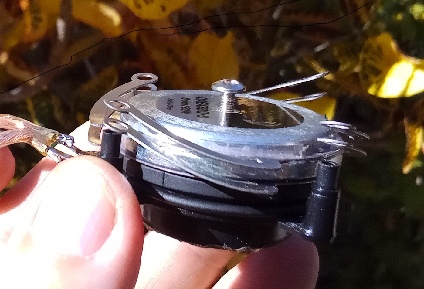

Pictured below are the springs bent away to let the 32Q be tested to see just how much they come into play. I couldn't tell much difference, seems there was some more high end, nothing crisp (not sure how much of all that plastic crap has to do with this as well). The springs are also used to keep the voice coil centered so going without them is a no go, had to hold everything just right to test. I did verify that the plastic is glued to the voice coil with some black glue.

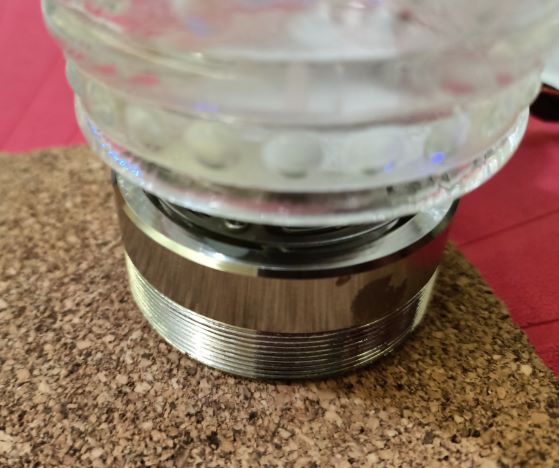

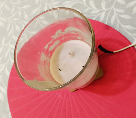

The little spiked glass candle holder. Height 8cm, bottom diameter 6cm, top distance from spike to spike 9cm. Sound quite nice and full at 30% - 80% volume control. Didn't try more. Have two of them.
3mm thick glass candle holder, candle practically finished, about 2cm still left. 1cm thick glass bottom, diameter 10cm. Total height 13cm. Lovely sound coming out of it, bass and all. Most probably the 1cm thick bottom and the 2cm thick candle wax must be adding to the sound quality. Got two of them, that is, wife buys them.

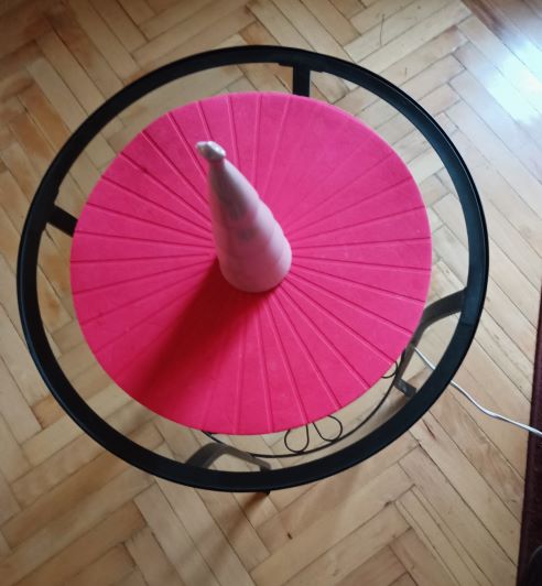

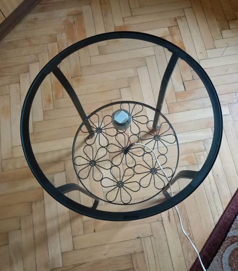

Ikea glass side table, glass panel diameter 47.5cm, glass thickness ~4mm, height from floor 61cm. Nice sound, gets better, when the Ikea mats were placed over the glass. The porcelain X'mas tree must be adding some value too. At the moment, glass is lying free over the steel bracket. It must be isolated and fixed permanently to the round metal groove. Something heavy (and nice) has to be placed on the shelf below. The steel legs are isolated from the floor, but have to be given better isolation. Got two of those side tables.
By the way, the best sound came from the practically empty thick glass bottom candle holder.

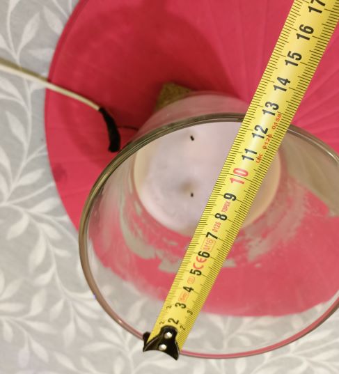

Please give us the dimensions of the candle holder. I'd like to try that myself. A side view would be nice, too.
Glass thickness: 3mm,chdsl,
Exact total height: 13cm
Glass bottom thickness: 1cm,
Glass bottom diameter: 10cm
Open top diameter: 13cm
Candle wax left: ~2cm
