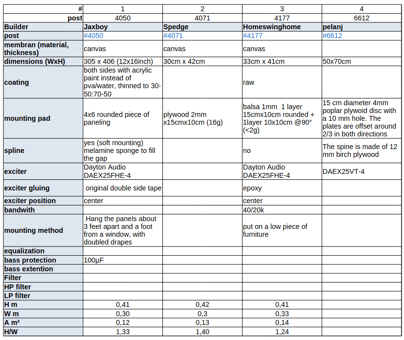

There are few realizations (or communication?) about the canvas panel and in my knowledge no scientific approach... so on my side, I tried to copy the already existing panel. Where mine are different (by accident) is the pad (central wood piece) is made of real balsa where most of the other are from real light plywood. In a first intention, I would encourage to copy to have a starting point... and not be disappointed. It is up to you to follow the standard path or the pioneer one.
My panel are made with a 33x41cm canvas and go down 40Hz.
Compare to a standard DML, there is a kind of boost of the first mode (first resonance). The only reason I see to go to a larger canvas is to change the mode separation to get a smoother response but then what is the best ratio (see Veleric work on plywood?).
One drawback might be to have to low resonances which might be to long to stop.
No other way than somebody makes the test...
Christian
PS : below the panels I know (see the historic file with link with my signature on the left of the post frame)
PS2 : my canvas have now a spine (needed at least to avoid any effect of the exciter mass)

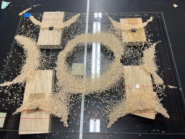

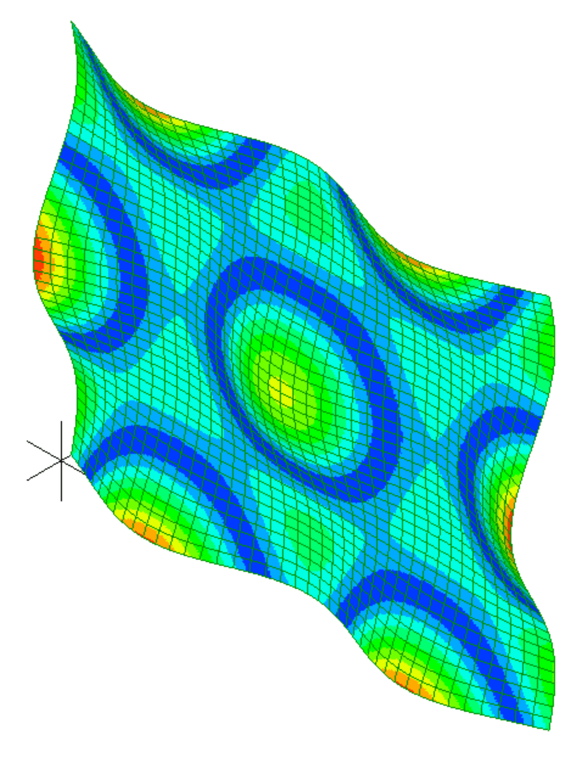

Smokin' Chladni Plate!
Ever since I started playing with DML's, I've been trying to perform a decent Chladni plate demonstration. My previous attempts were disappointing. But after playing around with a glass plate I started to wonder if a glass plate wouldn't be ideal, considering that it is low damping (and hence had very strong resonances), combined with its exceptional flatness. And today: success! Well kind of....
My FEM predicted this mode shape at about 554 Hz, which I thought was pretty cool:
And at virtually the exact frequency my plate did this!
Sadly, at virtually the same moment, I began to see (and smell) the smoke from my overheating exciter! oops...I think the exciter, which was taped to the plate on the lower left, just outside the image, is fried! I never even felt one get warm before, but I was a little afraid to even touch this one!
Eric
