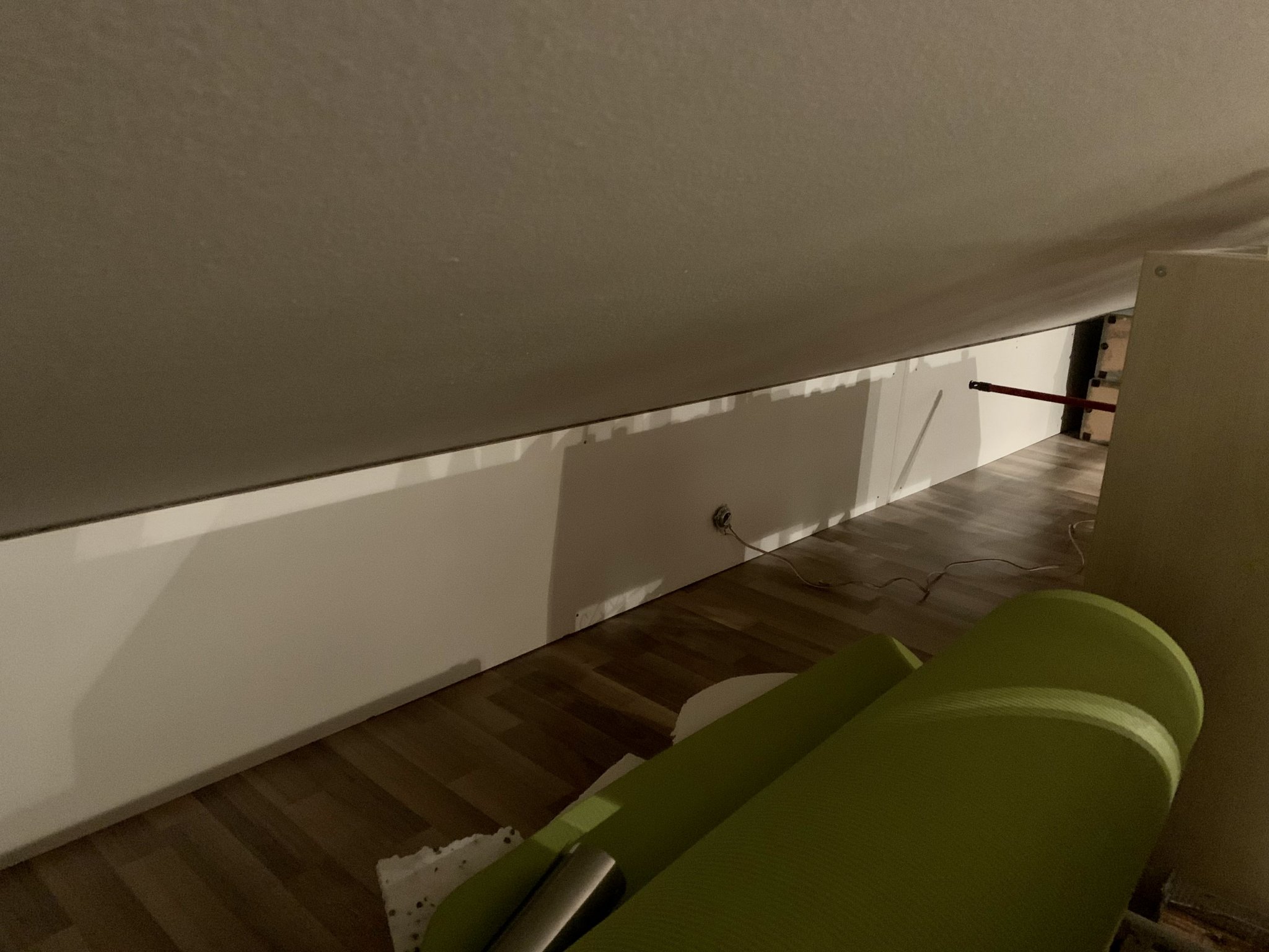

I just received the Dayton exiters. feel much more solid than I thought.
We have some unwanted guests in the attic. You can hear them right behind the hardwood wall. so I want to try to expel the little mice with high frequencies in the 13 to 15 khz range. I tagged one of the exiters onto the hdf panel.
I am really amazed!
there is fine fullrange sound. Judged just by ear there is only a little eq needed for really flat sound. the 35 hz sine signal is full and solid. 30 hz is also there.
I don‘t know about the hf as my hearing ends at 14khz. would have to do some measurements to erruate this. hope it is good enough for the mice.
the side panels are about 3mm thick hardwood of about 8ft length.
This is only one exciter, so only mono. but for backgound music or audiobooks this would be perfect as it is.
I am thinking about using this also as a subwoofer for tv sound.
really invisible speakers in this case.
