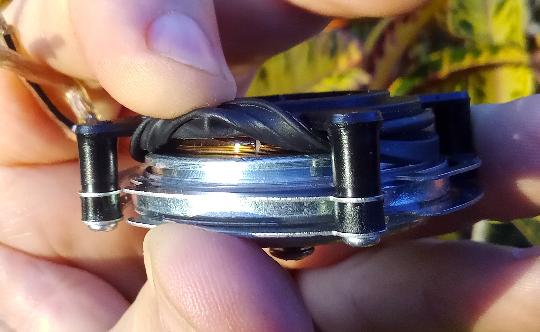

32Q's lack the higher frequencies. The DAEX30's are better then the 32Q's. The problem is they dont make an 8ohm version of the DAEX30s.
Deconstructing the 32Q's show they don't incorporate a typical spider. The voice coil is glued to the plastic with arms that reach out and attach to the springs which become the "spider". Also there is the rubber boot which is also glued to the plastic underneath and directly beside where the voice coil is glued. (photo below)
The strength of the 8 springs and the thick rubber boot all participate in holding them back from the highs. It looks as though the boot could be (carefully cut) removed from the equation without ill effect on the operation of the exciter and use only the lower 4 springs to keep the coil centered while allowing less resistance. (That boot may be keeping a lot of nasty resonance at bay?)
If I can't find a use for them then I'll go that route. I'm going to keep them as is for now and use them to experiment on hard materials, different forms of glass as chdsl is doing for sure, they may be just what glass needs.

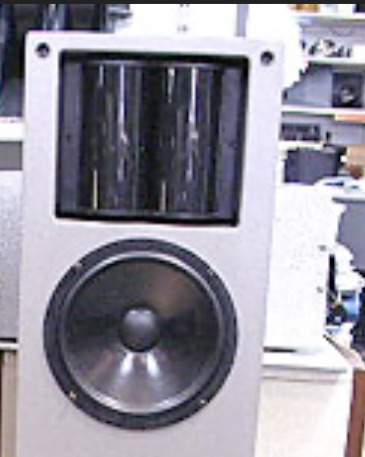

Here's something quite interesting, right here in DiyAudio, one flat coil, flat magnets, curved flat panel into a cylinder (2 of them). Electricity goes through the flat coil, music comes out of the two cylinders. I saw this video quite sometime ago, somewhat forgot about it, until I saw it again here in diyAudio. It is called a Rubanoid, or ribbon-like. Don't see any ribbon, though. This work is real DIY, who understood the idea, and made a working model out of it. Maybe, some of us join our member in that thread?
A French engineer had found this idea in the 1980s, and as usual not commercially marketable to the general public. A Swiss company Audio Consulting appears to be making some speakers, and as usual, must be horribly expensive. Or, they are not producing any speakers right now. Any videos from them are 8 years old.

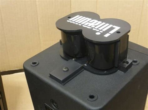

The idea is from linaeum a dipole tweeter which is more or less omnidirectional.
in this way made as on top tweeters.

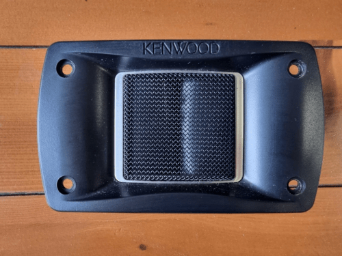

Also made as halves to use in closed speakers. Kenwood used them in the past.
the original linaeums were made of silk. later on these are made by optimus. they used a plastic film instead.
