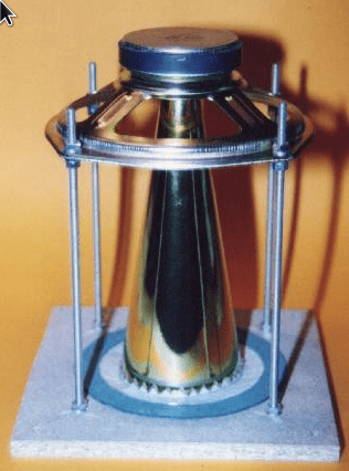

But I do remember something in the book about a free edged cone speaker from about 1930 that he was very impressed with,(a free resonating cone?)
Sounds familiar?

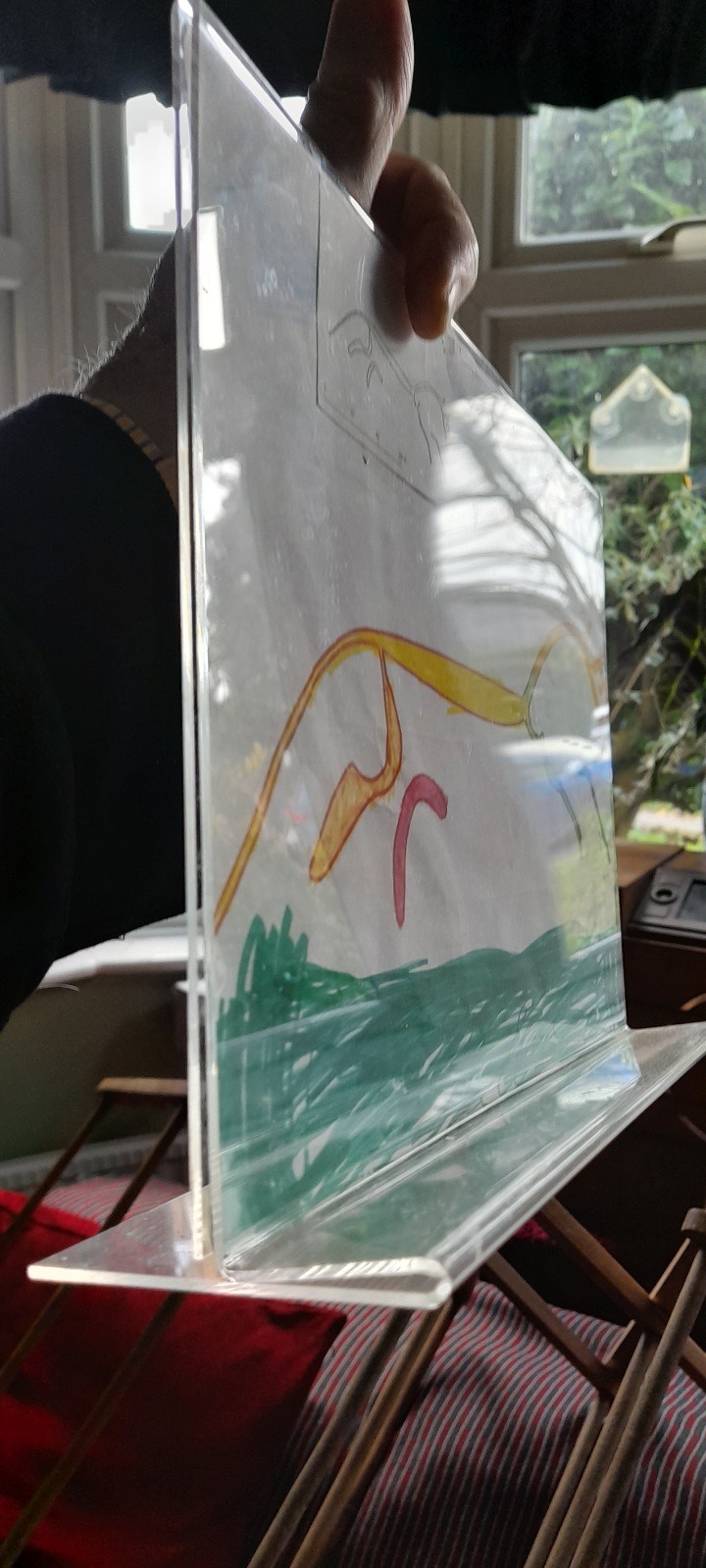

My wife bought this perspex frame some years ago to hold the grandchildrens drawings.
I'm not that keen on the sound of perspex, but have always thought this frame could easily be converted into a computer speaker or TV surround sound speaker.
I would have tried this by now, except my wife would probably notice it is missing and give me ear ache ☹️
But I thought some might find this interesting for an easy project.

If you can dismantle a old photo frame, you'd get 2 or 3 mm glass panel, would you try that, the normal way and up-firing touching the edge? You'd have to hold the panel very tightly over the exciter/actuator.My wife bought this perspex frame some years ago to hold the grandchildrens drawings.

I have some thin greenhouse glass down the garden somewhere.
I have my orders to sweep the garden of leaves and could use this as an excuse to borrow a pain of glass to measure .

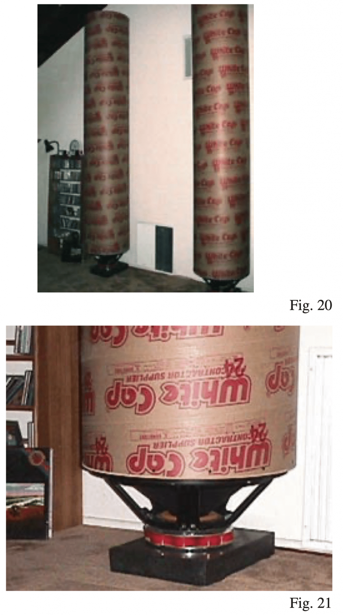

Since I came across Nelson Pass's El Pipe O, I always scan construction sites in Manhattan to see if I can pick up a couple of sonotubes.
They would most likes get followed by divorce papers, but a man can dream.

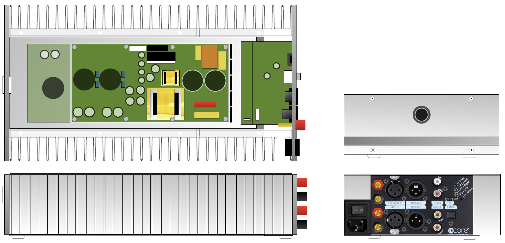

I have an old Hypex FA123 - its companion (long out of warranty) has failed ;-( I've started to repurpose it into a new case | form-factor to drive these.
The new configuration uses a pair of 12" heat sinks from Heatsink USA (that I had tucked away) as sides, most of the face plate of the FA123 as a bottom, and rearranges the input DSP | DAC module. Overkill for its use. I'd just as soon simplify this amp build|reconfiguration to just use the Hypex stereo NC-MP122 board with only analogue inputs, but not certain I can get the little bits and info I need to make it work.
This new amp configuration will hide neatly in the cabinet below the window.
