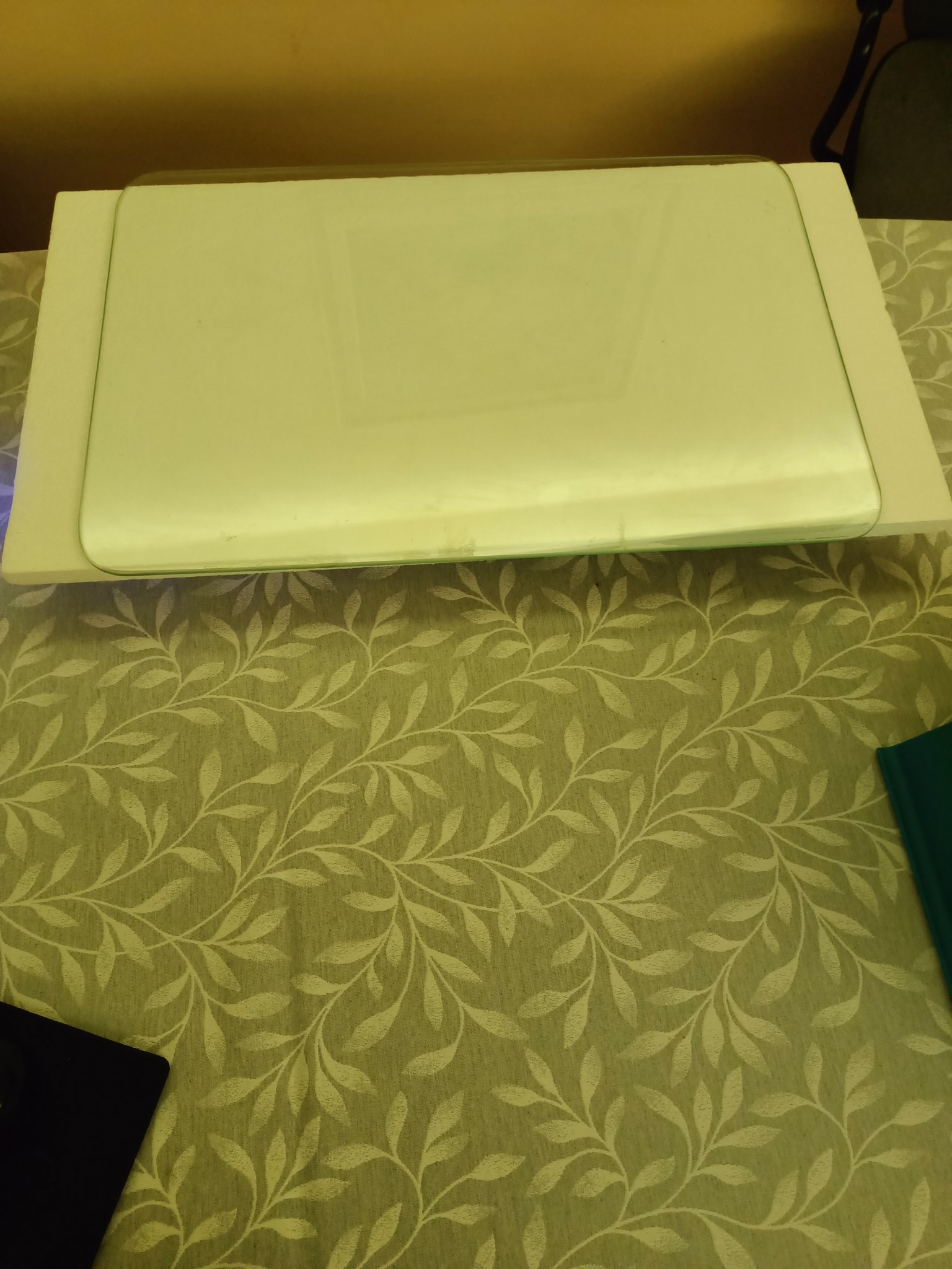

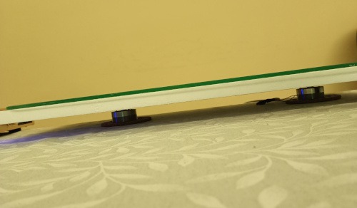

By the way, I played a bit with a glass panel I found in the basement. It was once a cover of a side table. It is 6mm thick and 60 cm x 40 cm sheet with curved corners. The sound was not good with the exciter at 2/5th, 3/5th position, or any other position, or on the edge. Too sharp. Took my EPS sheet out (70cm x 40cm x 2cm) to compare. That I know it works quite well with two exciters (two stereo channels) on edge, so this time I pasted the exciters 14cm from both the long edges in the middle line. 2/5th, 3/5th doesn't matter when the 2 stereo channels attached.
When held tightly from the top, that is, somewhat pushed to the table, I felt nice bass sounds coming out of it. I even managed to stand in line with it, and the sound was practically same. Then I placed the on the table with Exciters isolated from the table by cork supports for glasses, and let it play. Then, I placed my hands over the area where the exciters were, the sound became fuller, with sort of more bass. I was thinking something heavy to put over the exciters, I thought I'd put the glass sheet over it.
The sound became somewhat nicer, fuller. This glass sheet is quite heavy. Listened to some instrumental music, some classical music and some pop, jazz etc. More cork supports, better the sound. Maybe, if this was inside a back-box, it might give an even better sound. I still wanted to check how a thin glass sheet would do. Someone promised me a 2mm or 3 mm glass sheet next week. Well, when you get the experiment bug, it's hard. I suddenly remembered we have those Ikea tempered opal glass plates. First, I pasted the exciter in the middle, but the sound is nothing much to speak about, but then, I held it vertically over the exciter without its aluminium plate, only over the spider plate/frog legs.
The Ikea Oftast plate could touch the exciter only on one point, which is interesting, the point transfer of audio vibrations. The sound actually is quite nice. I did all that while France beat Denmark. Now, Argentina is having a hard time with Mexico. Edit: Messi just scored a goal!

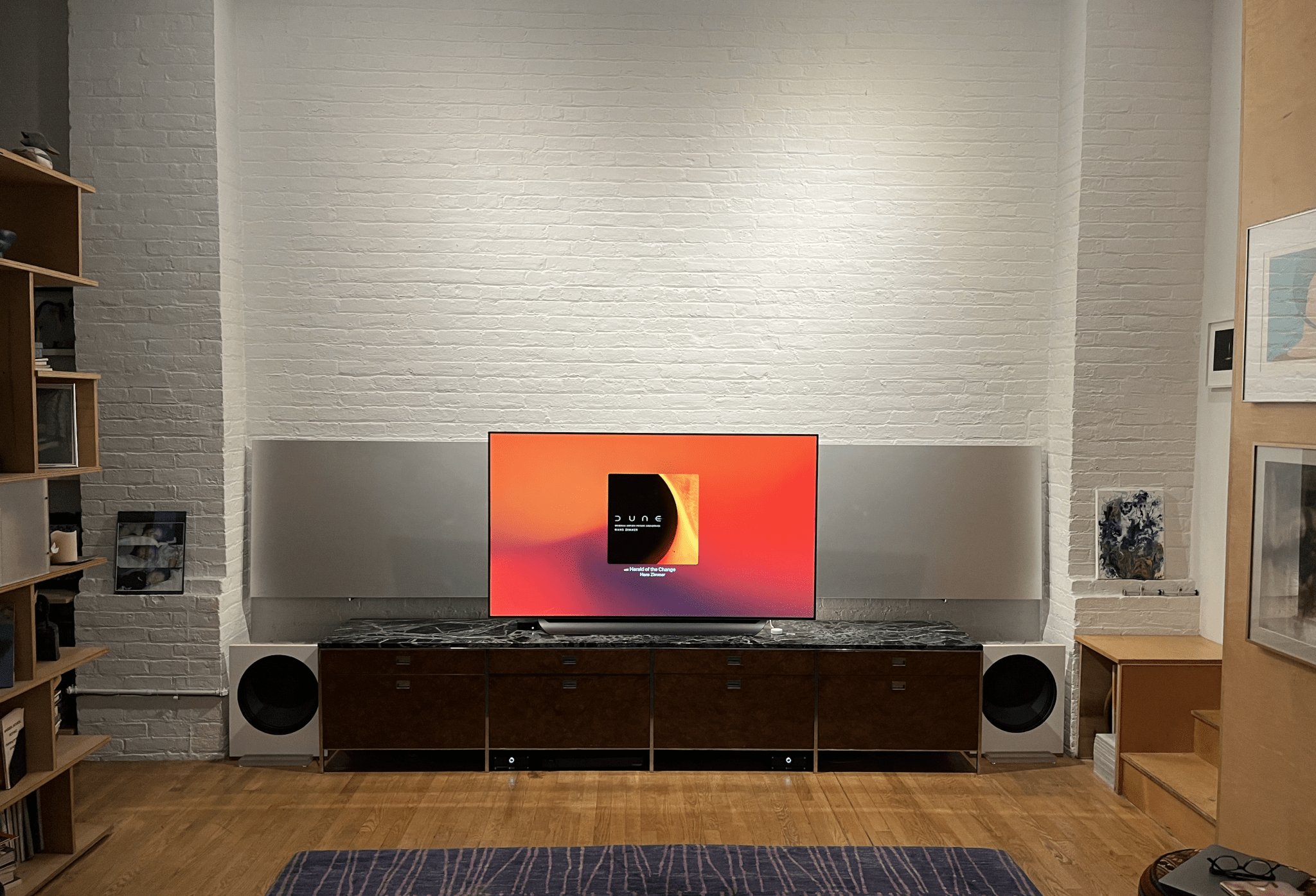

The new way I place the DMLs makes it easier to experiment with moving the exciters.
Suggestions welcomed.
Hi Andreas,The new way I place the DMLs makes it easier to experiment with moving the exciters.
I don't understand what I'm looking at in your picture. Can you explain?

I consolidated my two audio systems into one.Hi Andreas,
Erc
I turned my aluminum DML panels on their sides and mounted them on the wall behind the TV (base 4” from wall, tops 3/8”) tilted (under the speculation it might help prevent standing waves).
Because they sit several inches behind the TV I don’t notice any degradation in sound quality from my earlier setup.
Again, speculation, the reflections just bounce around and get to my ears.
I plan to do measurements later to day to optimize the SPL curves for the room and between the DML panels and the subwoofers.
I mentioned in an earlier post that I also stuck an exciter (Thruster) on the back of the LG TV’s OLED panel, which amazingly functions as a center channel speaker and has done much to improve the spoken voices on video and films.

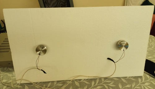

I used to watch what people throw away, but I didn't go about much last year. Anyway, my wife tells me why not use glass from old picture frames. The EPS gives quite good sound, but is pretty brittle stuff, can break anytime. Maybe, I'd try to paste the glass over the EPS sheet. Must think about this until next weekend. Maybe some mental bulbs might light up. 🙂I did.

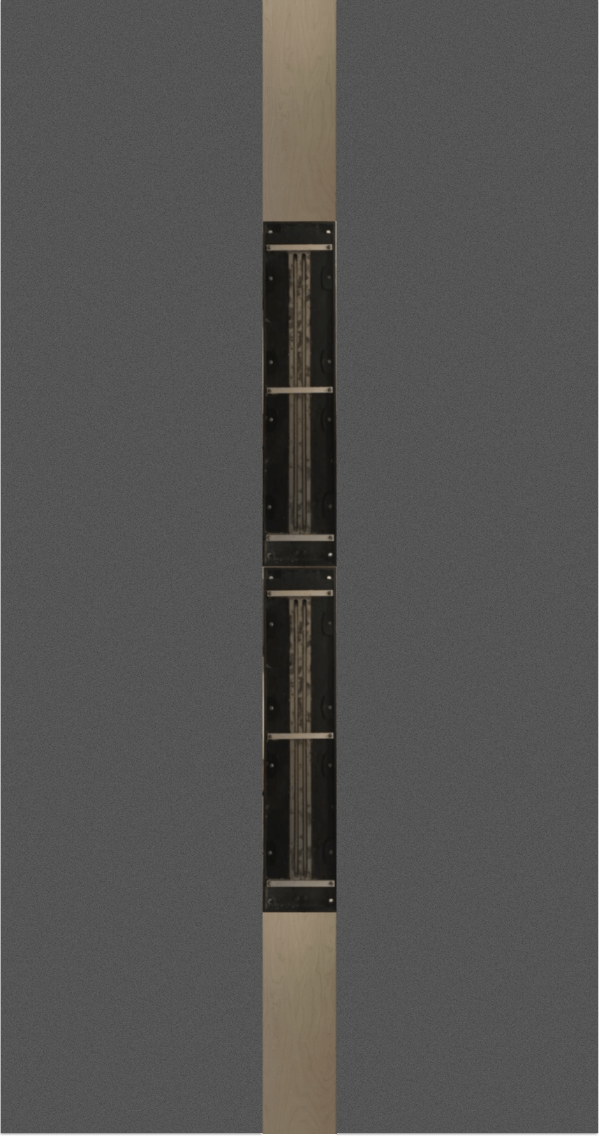

The Stratherns?aagas.
They look like ribbon units ?
Steve.
Yes. I learned about them from a group of audiophile DIYers out in Dayton, Ohio in the early 1980s.
A surprising hot bed of audio DIYers. Lot's of aeronautical engineers from Wright Patterson Airfare Base's development lab that liked to do home projects.
Dayton Audio and Parts Express emerged from the milieux.
Around that time Speaker Builder magazine had profiled them and - if memory serves - suggested some modifications to improve them even beyond their already wonderful sound.
They did not have deep bass so all of us at the time tried matching them with various kinds of woofer and/or subwoofers. A couple of guys had built transmission line subs.
By pure luck, I purchased a pair of the Magnepan bass panels (two per channel), from I guy who had previously matched them with stacked Quads. I think I paid him him a couple of hundred dollars.
I mounted the Stratherns between the bass panels. They did shake the walls, but within the range of the system's operation, their sound and musicality impressed every one that heard them.
I powered them with a pair of stereo Nelson Pass designed A40s.
The system would very much have benefited from what we have now in DSP and digital source material.
The guy that I think later founded Madisound had some of the ribbons and I also bought some crossover components from him.

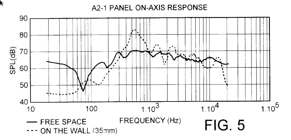

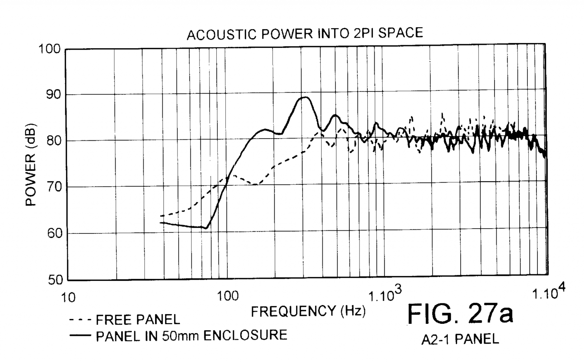

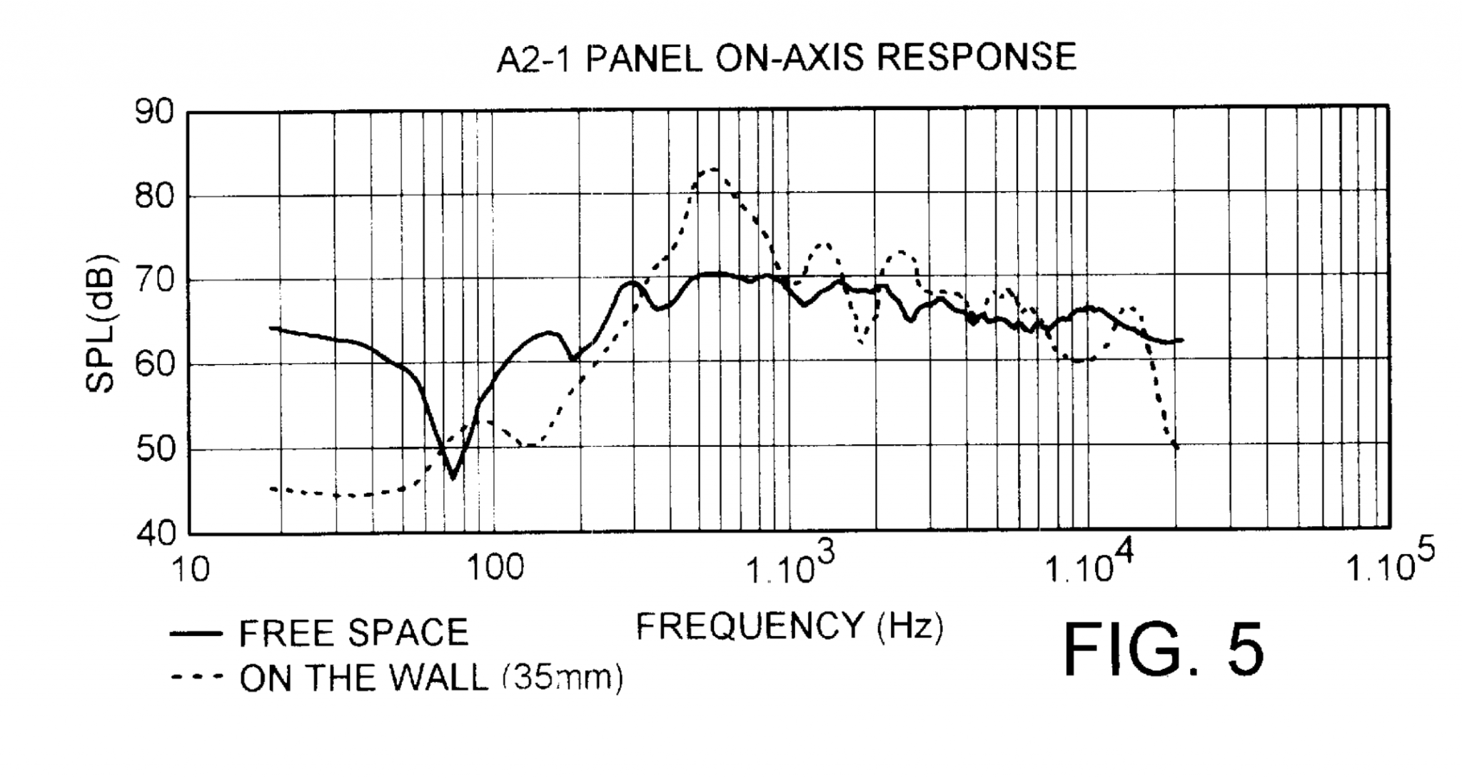

Here it is : US6553124. Extract below.
Thanks Christian.
I tried an "unsealed" enclosure two months ago, with results similar to figure 5 you posted.
I'll have to try a sealed enclosure to see if I can get an effect more like figure 27a.
But I do wonder if the sealed enclosure approach is more applicable to a low aspect ratio panel, than for the the high aspect ratio panels I have been successful with lately, which already have good output down to their fundamental frequency.
Eric
Ahh, that's it Steve.aagas.
Steve.
I thought the picture was showing how his new arrangement made it easier for Andreas to change his exciter position. But that wasn't what he was showing at all.
Ribbon tweeters and the like are off my radar screen. Plywood panels with the DEAX25FHE-4 typically go up to 10 kHz or more, and I don't hear anything significantly higher than 12 kHz, (like for most of us closing in on 60 years or beyond), so adding a tweeter would be only for the benefit of my children!
