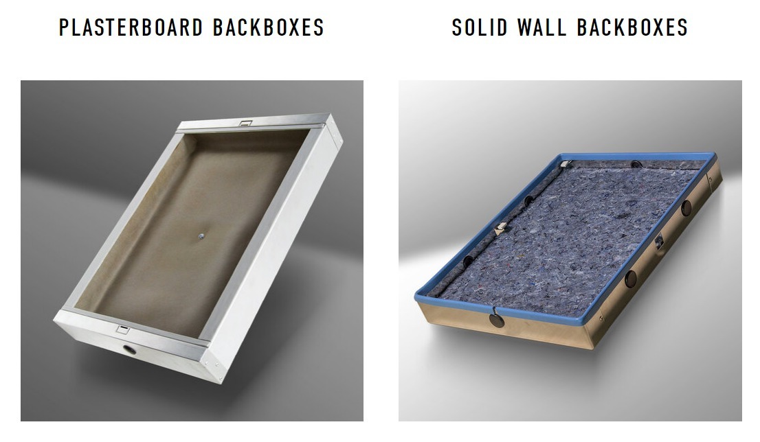

InterestingHere's a detailed wall installation guide of Amina Sound speakers in the drywall. On the 9th page, you'd see the back of the DML system.
Does somebody have information/explanation on :
- marker 2, the exciters. There are 3 of them. 2 on the center in a balanced placement, ok. What is the third one(black) ? No XOver visible. 3 exciters working in parallel?
- marker 5, tonerelief technology. Seems like some damping?
- marker 3, mechanichal tuning device. Some mass to adjust the FR?
- panel ratio 4/3
- exciter 1 and 2 : H 5/12=0.42, V 2/5 = 0,4 (2/5, 2/5?)
- exciter 3 (upper one) : H 1/2, V 3/16=0,18 from the top

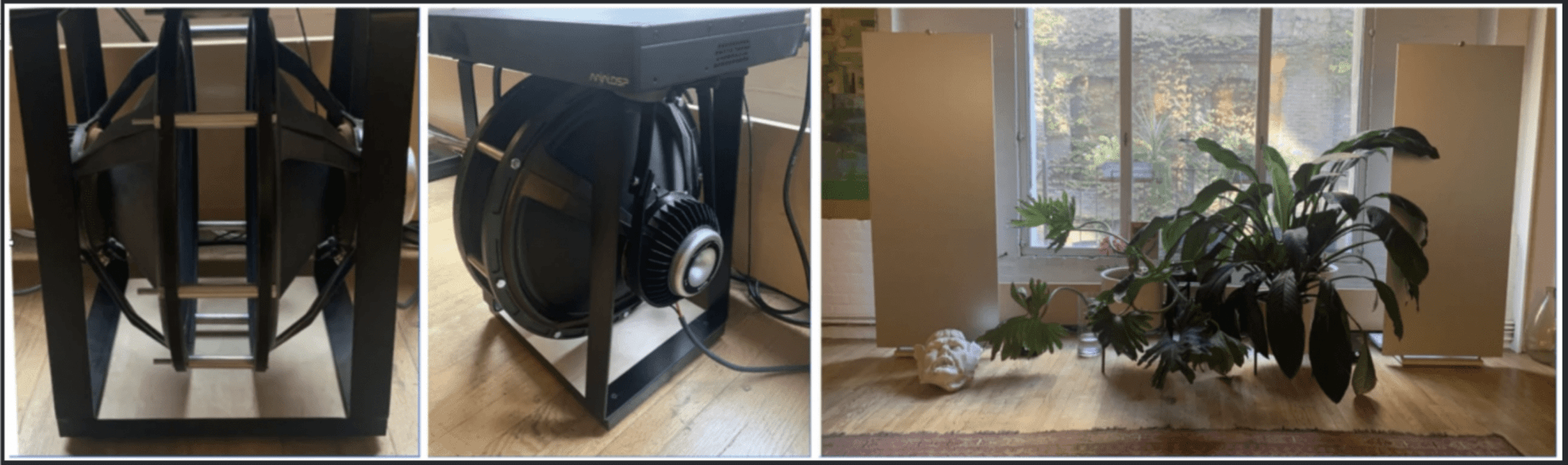

Turned my large aluminum honeycomb core DMLs sideways and leaned them against the wall behind the TV.
It just shouldn't sound good, but gees, it does.
No tweaking or equalization yet.
I have it set up with an Apple TV by HDMI to LG TV optical to minDSP SHD out to a pair of NCore stereo amps driving both DMLs and the woofers.
I plan to raise the panels so they center (vertically) on the TV.
More to come.
Like if the wave back is not able to escape or go through the membrane. If I remember your design, the panel is quite heavy no?
The panels are just on the TV furniture leaning with a small angle on the wall?
I hope you will enjoy the sound as before.
Christian

In this current temporary setup, I think some portion (maybe 100%) of the back wave escapes from behind the panels and reflects off of the two foot thick exterior brick wall. As omni directional drivers with front and back waves in phase (back wave doesn't cancel the front), it seems to work.Like if the wave back is not able to escape or go through the membrane.
Placing conventional box speakers directly against a wall can produce better performance than placing them too short a distance from the wall. If you can't place conventional speakers far enough from the back wall you get wave cancellation.
I've also seen installations (recording studios or high end home theaters) that mount conventional drivers In the wall, essentially creating an infinite baffle - not out of phase cancellation.
Heavy because of their size (approximately 71.5" x 28.25" x 3/8"). I think I remember them weighing 14 lbs each. Aluminum honeycomb core + aluminum skins + an embedded thin aluminum finished edge.If I remember your design, the panel is quite heavy no?
Yes. Each panel rests - on top of the cabinet - on 2 pieces of a dense foam rubber (used in molding Kydex).The panels are just on the TV furniture leaning with a small angle on the wall?

__________The top of the aluminum panels lean - isolated from the wall - against a singe additional piece of the same foam rubber.
The bottom of the panels sits about 3/8" off of the marble top of the cabinet 4" from the brick wall.
The top foam rubber at the top of the panels holds them about 3/8" from the brick.
I've thought about mounting the panels with some kind of 4" standoffs (3 per panel) parallel to the wall and (as I mentioned earlier in the thread) centered vertically on the TV.
That said, while falling asleep, lost in audio reverie, last night I had a thought, which might lead me to reconsider this.
Does the angle created by leaning the panels against the wall fortuitously reduce standing waves?
Thoughts appreciated?

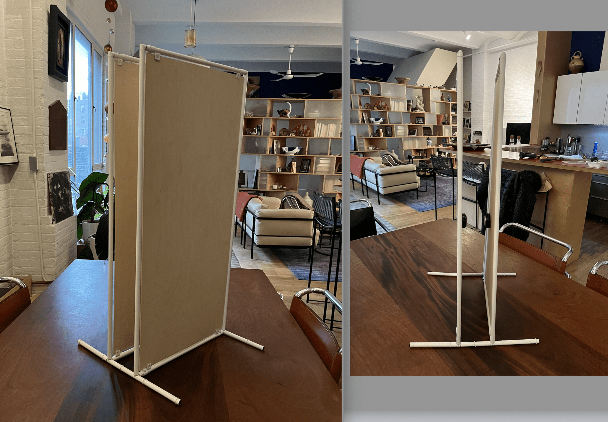

If you've referenced my aluminum panels, I previously had them vertical with the width of the panels facing the listening area. I haven't had the occasion to turn the panels 90 degrees to the wall behind them. That said, I previously had the panels in a very wide room and they sound good to either the left of the left speak almost in line with the plane of the two panels or right of the right speakers in line with the two panels. Subjectively, they supply|present a sound stage and listening area far wider than their physical placement as well front back almost anywhere in the room.@aagas
How do you hear your panels when you are sitting/standing in plane with one of them? When you place them 90 degrees to the wall, facing each other how do you hear the music at you normal listening position and when you walk around?

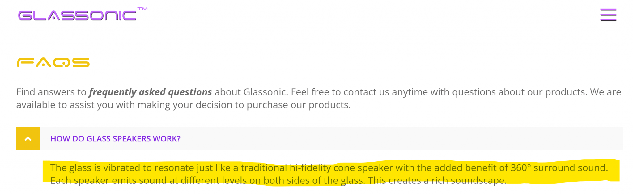

I'd like to know more about the Glassonic speakers - mired in mystery it seems - the glass may even be non-functional??
The edge vibration mode is intriguing - I'm keen to try it asap
Cheers
Eucy
Eucy,I'd like to know more about the Glassonic speakers - mired in mystery it seems - the glass may even be non-functional??
Eucy
Yeah, they are oddly opaque for a company that makes transparent speakers!
But from their FAQs, it seems the glass is functional. But they "resonate" just like a traditional cone speaker? Really? They are clearly not marketing to the audiophile market. Rather, the luxury market.
But my best guess is that it is indeed a bending wave (i.e. DML) panel speaker.
It's curious to me that they (and Ammos too) both chose glass for their panels, except for the aesthetics. Certainly it's a poor choice as far as radiation efficiency is concerned. It wouldn't fall within Christian's dashed box for sure!
Eric

Many things to try.
Still trying to figure the simple mechanics of raising the panels above the TV cabinet. How to hang them from but off the wall. I'd like something that self levels or has some adjustability. Time to wander the hardware store and see if something makes sense.
More to come.
