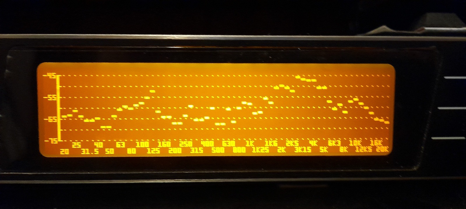

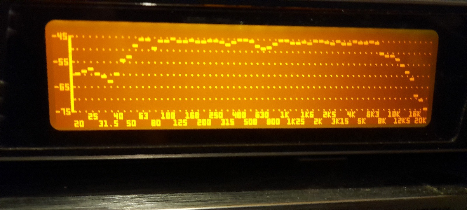

First picture is the glass resting on my hdn8 screw point.
The second is the response at about 50cm.
The third picture shows the response you would get from a side angle.
But not directly from the side.
You tend to get a rising response to a peak in the HF.
Any reflections from close side walls or ceilings and floors will give you a very painful shock with some female vocals.
All the reflections will hit you at about the same time.
Not just from the nearest wall but the opposite wall as well .
This is also the response I would expect from panels turned so that the edges face you.
That is why I suggested toeing them out a bit for a flatter response.
Steve.

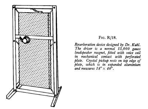

By the way, from Briggs book on diffusers,
It is a reverberation device. with an exciter and some sensor on the edge (top edge). Searching papers about plate vibrations, I found dealing about making a synthetic reverb by simulation of a plate.Chdsl.
Thank you very much for the book link.
Quite a bit is lifted from my Loudspeaker book.
And I noticed while quickly browsing through, that on page 175 there is a drawing of an acoustic resonator, which is so close to a dml panel design.
If only he had use a different material without holes.
Steve.
I like the last sentence : "What is distortion, what is perfection?"
That was created by Mr. Cooke, who helped to write the book for Briggs. It'd be nice to find any details of Dr. Kuhl's and Mr. Lauridsen's designs, patents or any writing.It is a reverberation device. with an exciter and some sensor on the edge (top edge). Searching papers about plate vibrations, I found dealing about making a synthetic reverb by simulation of a plate.

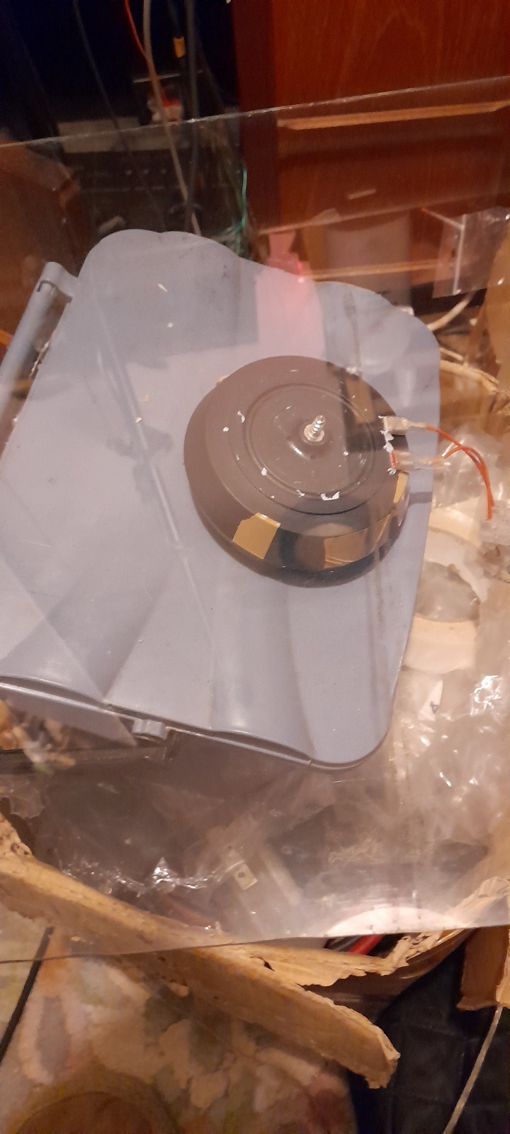

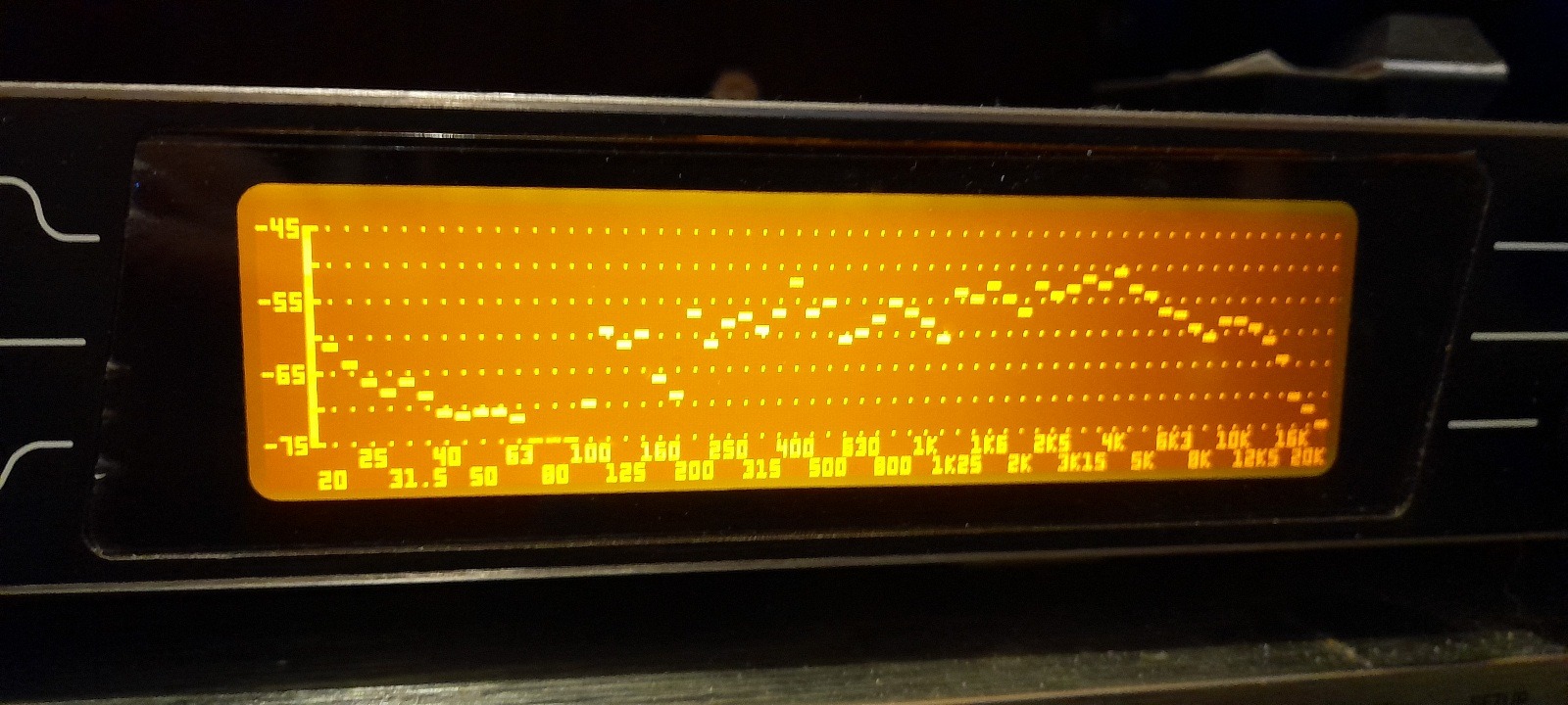

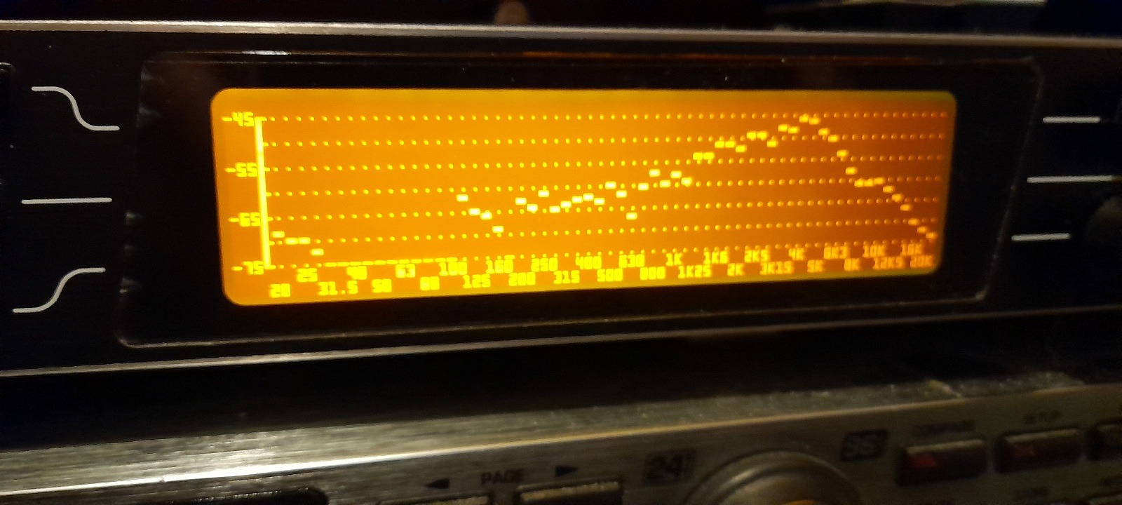

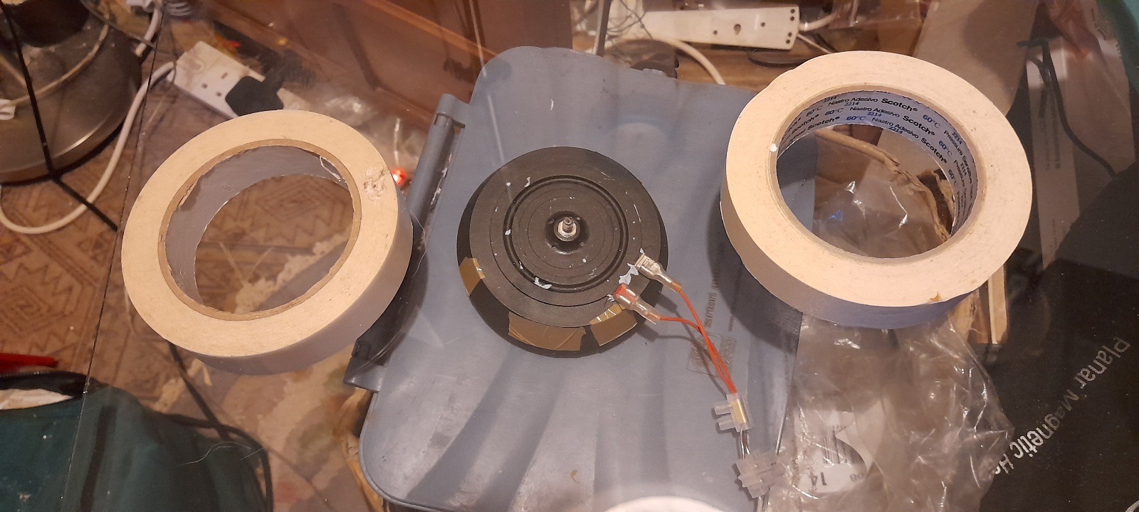

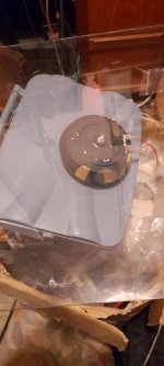

The glass panel was resting on top of the exciter as shown in the photo.
The second pic is of the response with the exciter thread touching the edge of the glass.
Everything below about 1.5k was me moving about and putting the microphone and exciter down.
There was very little output below 1k.
Pic 3 was with the exciter placed in the middle on the surface .
The output shoots off the scale with a much higher output than on the side edge.
Microphone in the same position.
The rolls of tape in the first picture were placed there to help stop the glass ringing while playing music.
A lot of damping is advertised if using glass.
Steve.

The problem taking measurements with the hdn8 exciter was that the exciter itself is very noisy.
The exciter casing makes a lot of sound.
Surprisingly the exciter sound (noise) reduces when I placed the screw tip on the edge of the glass.
The exciter sound was louder than the glass.
But the exciter sound practically disappeared when it touched the glass edge ?
So that when I made the measurement, I would remove the exciter ,and then the sound of the exciter would swamp the measurement.
In the end I had to hold the heavy exciter with one hand and turn off the pink noise with the other, before removing the exciter.
That was why the graph shows so much going on below 2k with me moving about.
Under the conditions it was the best could do.
Steve.
