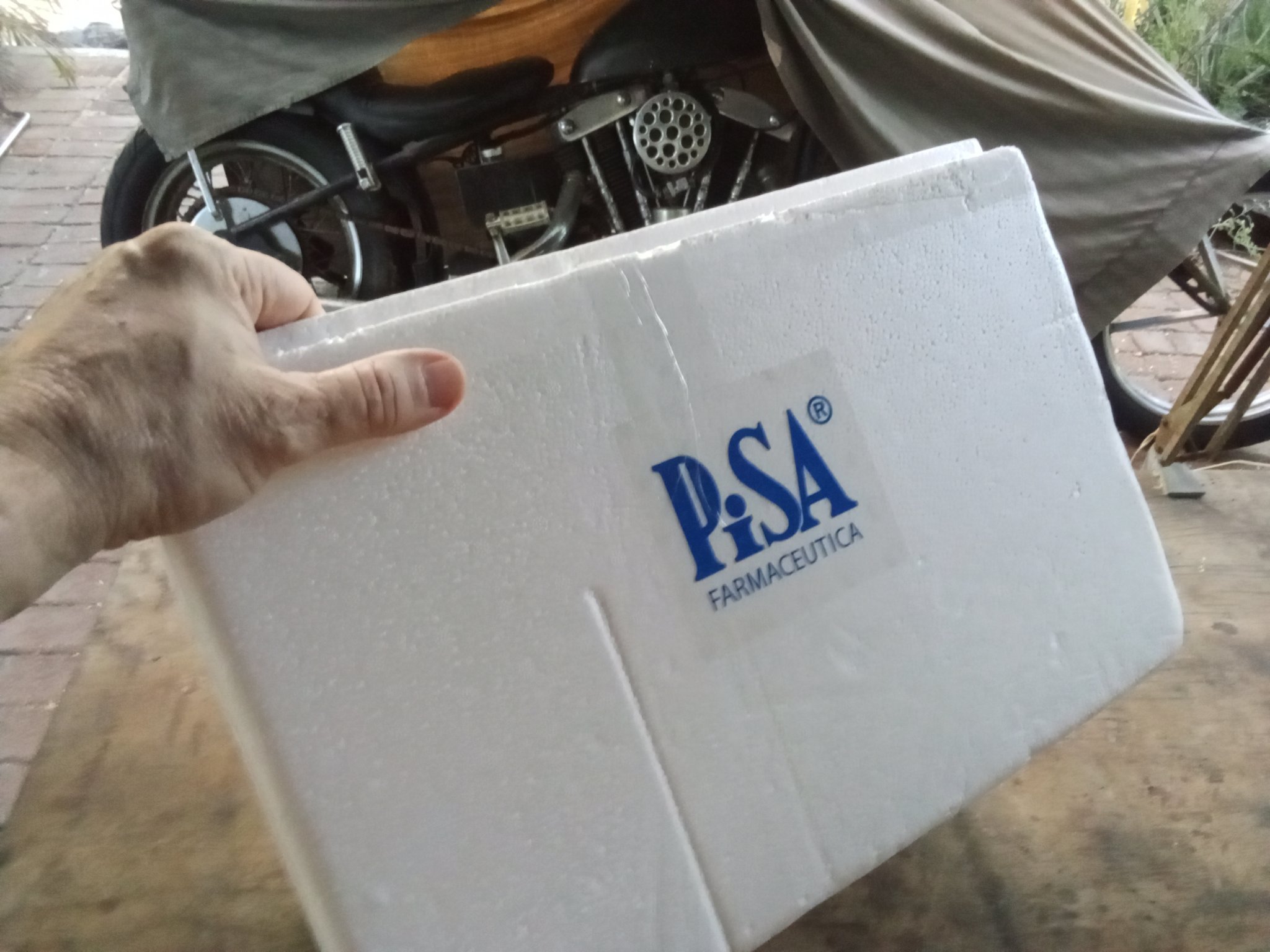

No surprise there, at least with regard to the relative volume (booming) of PS vs glass.Good sound, but somewhat tiny, compared to the 2cm thick EPS sheet, which was actually booming compared to the thin glass or the this HDF sheet.
The "T" factor gives a pretty good prediction of relative efficiency of materials where
T=E/(12*rho^3)
and E=Elastic Modulus (Pa) and
rho=density (kg/m3)
For glass, with E=70 GPa and rho =2500 kg/m3, the T factor is only about 0.37.
In comparison, for PS foam, T is on the order of 50-100.
You could do worse than glass, however. For example, here is T for some other materials:

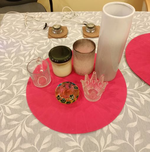

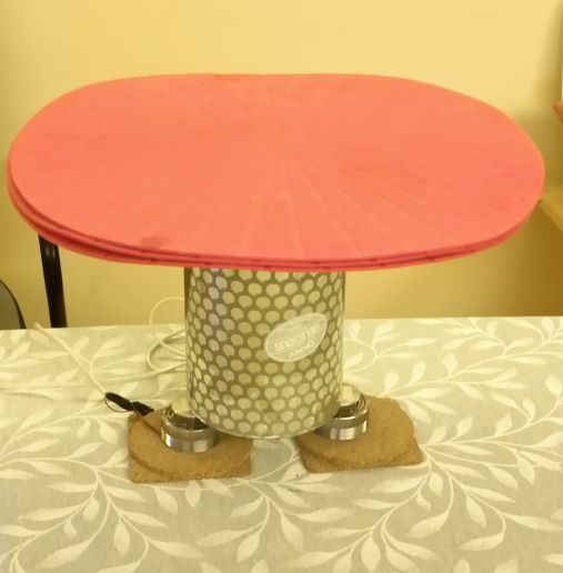

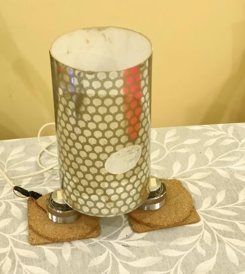

Experimenting with round objects found at home, all sitting on base this time.
The ceramic tall vase gave a bit more bass, but sound was tubular. Small drinking glass gave a nice sound sitting on its base and on edge. The pinkish half full glass candleholder was also good, but the closed glass candleholder gave a fuller sound. The smallest coloured one was just as good. Most interesting sound came from the crown like one, maybe the spikes added something extra. On all these I could use only one exciter.
Also tried all the cutting boards at home, on face and on edge. Plastic boards were not that good either way, but the timber ones were really good, the bamboo one being the best. It was 1cm thick, 28cm x 22 cm in size. On edge was much better than on face. Both stereo channels were used.
Then I found an old DKNY cosmetic box/tube without the lid, made of paper, and covered with some glossy foil. Wife didn't care what I do with it, so used it for experimenting.
Tried to place it on the open edge, but the edge was not in a good shape, so hard to keep it strait, the paper just bent. So, placed it on the bottom edge, which protrudes about 5-6mm. Pasted it over both exciters with double-sided tape. Sound was quite good for an old paper tube. It was even better, after I closed the top with few Ikea mats. They also gave some weight to the paper tube. By the way, it was omnidirectional.
I suppose the paper tube is much better than a glass tube, but the paper is much weaker than glass. I don't have a timber or bamboo tube at home to try. Actually, covering the tube from above gave a fuller better sound, even with the ceramic vase. Can understand why Sony covered their glass tube omnidirectional speakers from top, the cheaper LSPX -S1, 2 and 3 and the very expensive Sountina NSA-PF1. Of course, a paper tube won't be marketable gadget, but a glass tube would. Sony LSPX-S3 is now selling at 250USD, but who would buy it to dismantle it to check which actuators Sony had used? Those 3 actuators must be pretty tiny.
Anyway, actuators can be up-fired and through the edge. Closed empty objects would give better sound output than flat 2-d ones. These are my subjective feeling. My ears are not the same as few decades ago, though. As this kind of stuff is available in every home, you can do the same (and better) experiments.

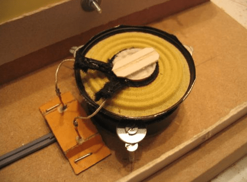

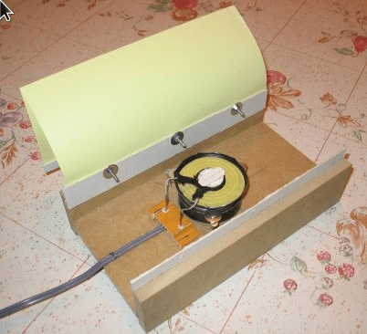

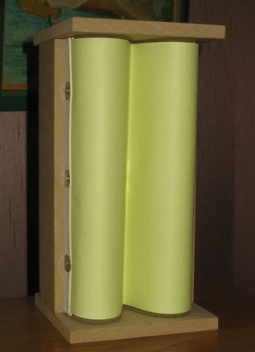

To show you loudspeakers close of the driving method you are experimenting: in post 7366 a DIY inspired by the Walsh speaker and the one below inspired by the Lineum. Both have an initial driving direction almost in the plane of the membrane. I made them years ago... what I remember is a lack of high frequency. The yellow membrane is a simple A4 80g sheet of paper. The exciter is full range for car without membrane, the frame was cut. A more rigid material would have probably get a better bandwidth. My trial was inspired by an article from Audioxpress which used a membrane made in the material of drum membrane.
I made those tentative long time ago before crossing the threads about DML. I stopped despite the not too bad results because of a lack of information on how to improve them, how they work. DML have the advantage of quick better results (wider bandwidth), a large documentation (not always easy to understand), a dynamic community of DIYer (like our here). This open a question : why the DML knows such a development when other solutions (Walsh, Lineum, should I include Manger?) are more limited?
About DML, one characteristic to keep in mind is their diffusive characteristic. The physical aspect of that is the low correlation of impulse response in different directions; The consequence is I think the low sensitivity to the boundaries, in other words, the high quality of the image which is the most remarkable quality of DML A loudspeaker like a vertical tube or cone won't have this property. The lineum probably.
Your experiment is pretty good. Did you paste the bent edge over the voice coil top plate? Why did you bent the paper like an half a cylinder to both sides? Did the paper gave a better sound than it was standing straight up? Whether the transducer plate/voice coil plate transferring the vibrations to a larger surface on face, or to a very thin surface (on edge), it is still a distributed mode loudspeaker, if the panel, sheet flat or curved amplifies the sound. Like to know what you did and why you did that experiment.Chdsl

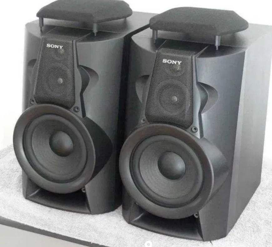

Here's a video where a Russian is dismantling 1986 Sony DML acoustic system, APM-66ES. It is interesting how Sony had transferred voice coil vibrations to that small aluminium honeycomb square flat panel. You can see that at 2.44mins into the video. In another video, you hear them playing on a Luxman l-570 from 1989.
Interestingly, the DMLs doesn't have to be big, and can be boxed, and bass-reflexed. Even the tweeter is a dml.

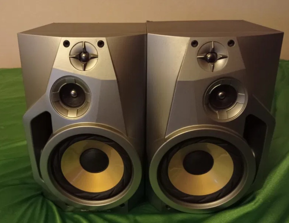

A Soviet DML speaker restoration project. The LF DML speaker driver in this video. The USSR stopped existing in 1991, so this 35AS-021 Estonia speakers must have been made sometime in the '80s. I've seen all kinds of Soviet speakers, but never saw this one before. This too looks like an aluminium honeycomb sheet. Too bad this guy is not dismantling the driver, or even take the plastic cover off from the back.
And here's guy showing the dismantled Technics SB-X500 honeycomb speakers 13 years ago. Technics transferred the sound vibrations to the DML through a stiff aluminium (or plastic) cone. Here's another guy showing how they work and sound. The video was done 10 years ago.
Any thoughts?
Any thoughts?

Hello Chdsl,Your experiment is pretty good. Did you paste the bent edge over the voice coil top plate? Why did you bent the paper like an half a cylinder to both sides? Did the paper gave a better sound than it was standing straight up? Whether the transducer plate/voice coil plate transferring the vibrations to a larger surface on face, or to a very thin surface (on edge), it is still a distributed mode loudspeaker, if the panel, sheet flat or curved amplifies the sound. Like to know what you did and why you did that experiment.
The Linaeum idea, I suppose.
Yes the I pasted the edge (the folding of the paper) over the voice coil plate.
The half cylinder is part of the original design like in the link about Linaeum (sorry for the missing "a" in the previous post).
I didn't test with paper in another position. At his time, I had few inputs on bending waves speakers; It was more a first trial than a real design.
