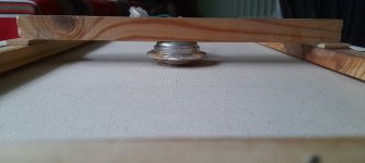

As written in previous posts, I built a pair of canvas panel and I am quite happy with them. I prefer my plywood one. The canvas are really easy to make.

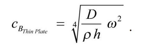

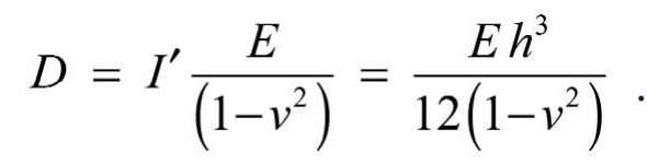

Christian,

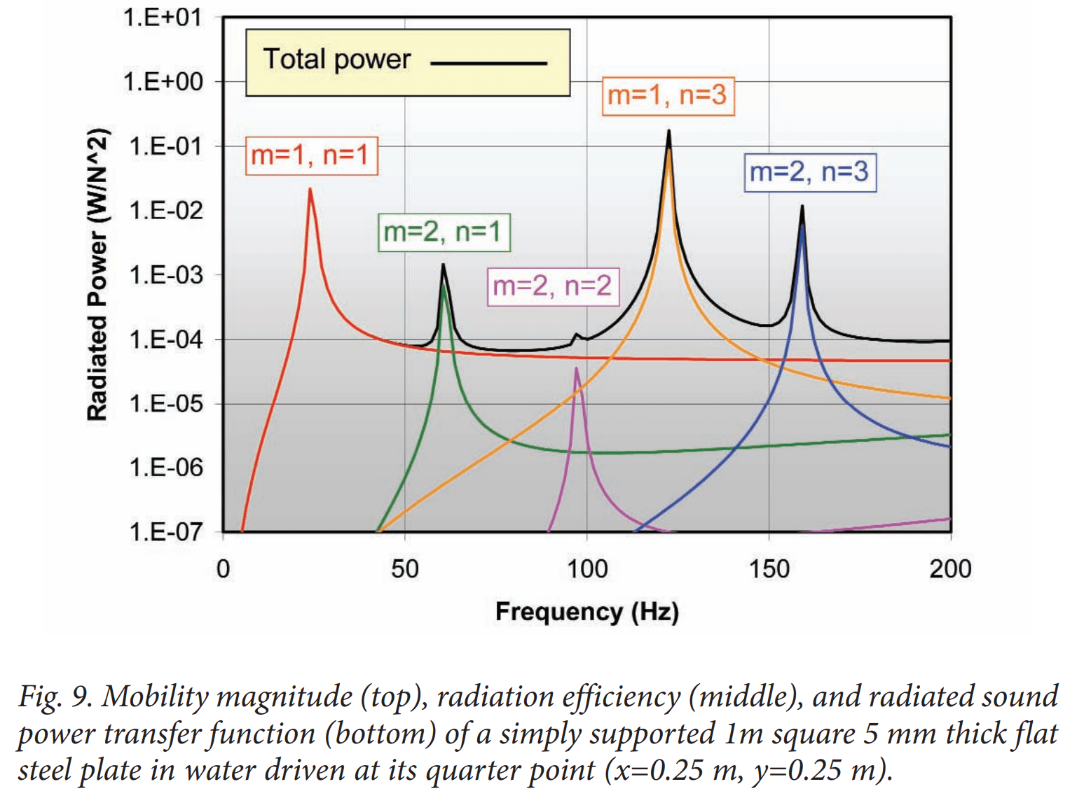

Good question! Like you, the limitation on the wave speed due to the shear modulus caught my attention. It is making me wonder if that is the reason I am not seeing evidence of the coincidence frequency (such as beaming at wide angles) where it "should be". Maybe (due to the shear modulus limitation) some of the panels I'm testing never actually reach coincidence.
But another interesting point is illustrated in Figure 9 of the second tutorial. In my simple (and wrong) mental model, the fall off of radiated power above a particular modes natural frequency occurs as sharply as the rise before it. And while that seems roughly true very close to the natural frequency, it's wrong well above the natural frequency, where the contribution of each mode falls to non-zero plateau. And while the figure stops as only 200 Hz, it seems to suggest that the 1,1 mode is providing a huge portion of the radiated power far, far above the fundamental (1,1) natural frequency.
Eric

Not much change Eucy,
If I use t=3, rho=425 and E =5 GPa (my guess), I get 11.2 ms for 50 cm at 100 Hz and 1.2 ms at 10,000 Hz. Feel free to check my math!
This is using the formula for wave speed.
where:
But...I have to admit to some uncertainty about whether or not this equation applies for all plate boundary conditions. The reason I say this is the following: Consider for example a simply supported rectangular (but NOT square) plate. The wavelengths in the long and short dimension of the fundamental frequency are obviously different from each other, since both the length and the width of the plate constitute are half of a wavelength, while the frequency is the same for both (i.e. the fundamental). Then, since speed =wavelength x frequency, it seems that the speed of the wave must be different in the two directions. But the speed equation above only has one answer, not two! So either this equation doesn't apply to simply supported plates, or I'm missing something.....but what?

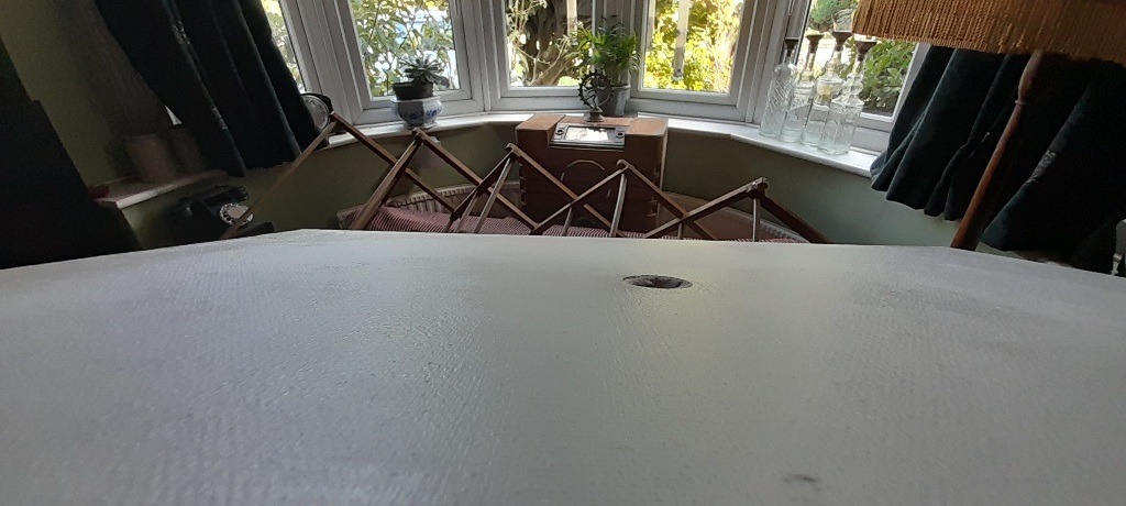

These are the other 2 types of canvas panels tested so far.
The panel on the right in the two photos is the canvas only panel with home made dome , now concave, oops.
This is to minimise exciter noises.
The one on the left used an ordinary 6x4inch 3mm ply ,but glued to the front ,to try and get a more exciting sound.
I would now use a much larger crate ply panel for this last panel , the crate ply is much more exciting, similar to the EPS, but not quite as much.
Steve.

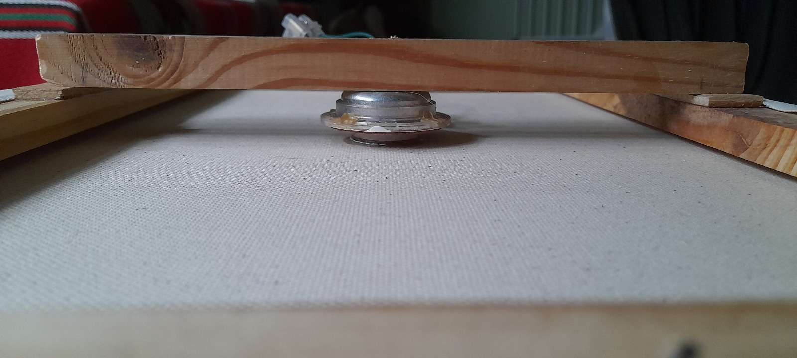

Hi hkguy6
If not with spine. Yes it easy to make.
I'm still can't build a spine with the exciter perfectly horizonital and zero pressure against the ply. So I give up the spine.
I just think maybe I'm too serious on this. A little slant and pressure may not affact the sound. But spine system must be difficult to change exciter this's sure.

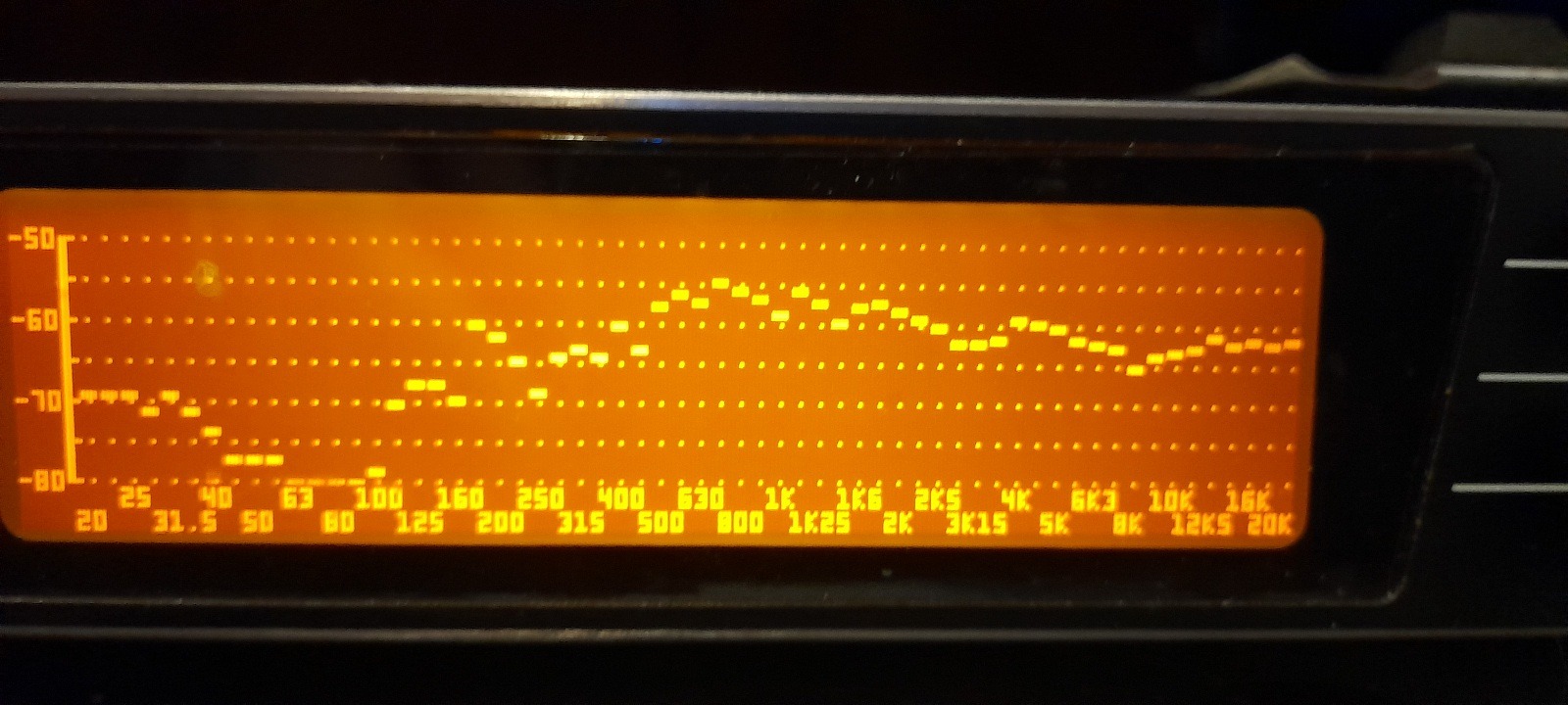

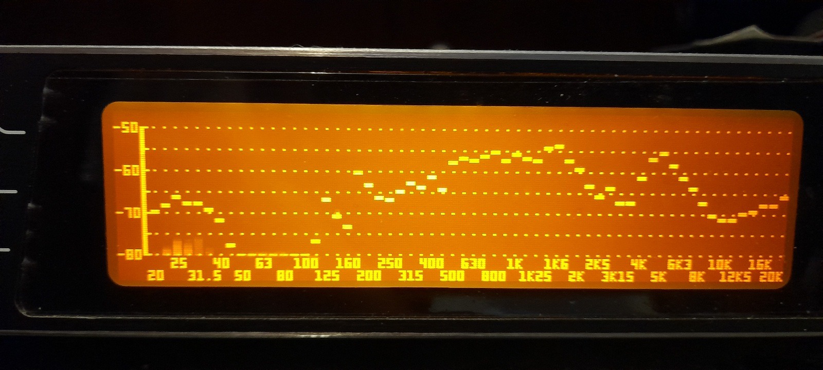

I just made a recording of the 2ply aluminium sheet while moving the microphone around the room.
I was then going to cut the panel down another size to match the size of the card panel.
But while I was measuring, I noticed the slight peak at about 5k.
I was a little suspicious of what this was, so turned the panel around.
As you can see in the third picture of the reverse frequency response, the dips either side of the 5k peak.
It does not sound too bad in my room , but if up against a reflective wall this could be a problem.
Also I added some weights to the edges , which improved the output in the 90 hz to 200hz area.
This aloud me to turn the volume up a lot higher, although the exciter is now getting hot 🔥 .
This aluminium panel might actually sound better with some sort of frame or damping?
It does wobble and flex a lot, and when holding the sides the sound does not alter too much higher up in frequency range.
So I am going to play around with this one for a little longer and see what happens.
Pic 1 with smaller 12 x7 inch card panel.
Pic 2.
Frequency response of aluminium panel at 1m.
Pic 3.
Response form exciter side of panel same microphone position.
Pic 4.
Panel With the small weights attached.
Steve.
Hkguy6.
In picture 3 in this post you can see what the affect the exciter has on the frequency response from the rear.
The direct sound from the back surface of the panel is nice but the exciter blocks the HF and causes phase problems.
If you can live with this , then it will be fine ?
Steve.

Christian,
Eric
Eric
At the moment i don't understand the concept behind this graph : some math trick seems used to "insulate" the radiated power of one mode. I say math trick because I don't understand that from a practical point of view, or let say it doesn't with my internal model.
The plateau is 1/100 of the peaks (vertical axis is almost log) so I guess not a big contribution compare to other peaks/modes.
Christian

In a first step, my canvas panels were without spine. Very easy to build as it is cutting a piece of plywood and gluing. In a second time, I added a spine in the same way as Steve's pictures just before. The key point is to find some piece of wood with the right thickness to avoid any extra force on the exciter. No problem of orientation if the sides of those pieces are parallel. You can use several pieces of different thickness to get the right height. Depending of the frame, the wedge(s) is (are) between the exciter and the spine or the spine and the frame. In my experience, making a panel in a frame with a suspension and a spine is more difficult.

I just made these two measurements of my Ali panel at 60cm, but it is the same from 3m.
Pic 1.
From the front.
pic 2.
from the back.
This panel suffers quite badly from the rear, not all panel will be as bad.
I did I believe, make a recording not so long ago of the noise produced from the back and front of some panels ?
It is a little difficult to separate the noises, cavity, coil area, and exciter suspension , plus the hole in the magnet.
I can minimise the first two but not the suspension and exciter vibrating in sympathy with the coil and panel.
This is why I would love to try a powerful piezoelectric thin film an the front of a panel.
You could drive the front surface without a large magnet and suspension in the way.
I agree that the main driving surface at the back of the panel sounds much better than the front secondary driving surface.
But the exciter itself is the main problem, which I can only try and minimise.
Steve.
Maybe a pecture will show how easy it is really.
This is a picture of my canvas only panel which has to have a back bracing as the canvas cannot support the exciter.
The method is the same as with a ply panel attached.
I just lay the panel down onto a flat surface and glue the exciter into position.
I place the wood bracing on top of the exciter, and find odd pieces of wood to fill the gaps between frame and bracing.
I found it handy to turn the wood over a few times as a slight bow in the wood can make a big difference and help line things up.
If you have a gap , you could always fill this with silicone or pva or a harder filler.
Or you could do this at the sides where the frame and bracing meet , but I would probably have the bracing going down the panel to stop sagging if silicone was used.
There is a little bit of play( forward and backwards) in the canvas, which is handy ,as this does not put any strain on the coil , and allows the coil to move freely.
You should not be able to see an imprint of the coil or ply panel on the front of the canvas, it should look flat.
As in the photos
Steve.
