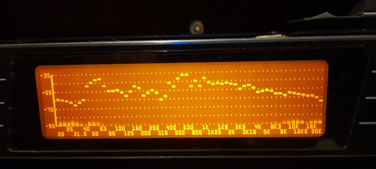

This picture shows the room response of this panel actually playing the music on peak hold at 3m into the room.
The vocals , drum and violin are mainly in the 500hz to 1k hence the raised response in this area, so don't panic😱
Ignore anything below 40 hz as the response of this panel with my exciter drops off like a brick below this.
Obviously 2 combined panels will have more low end power.
Steve.

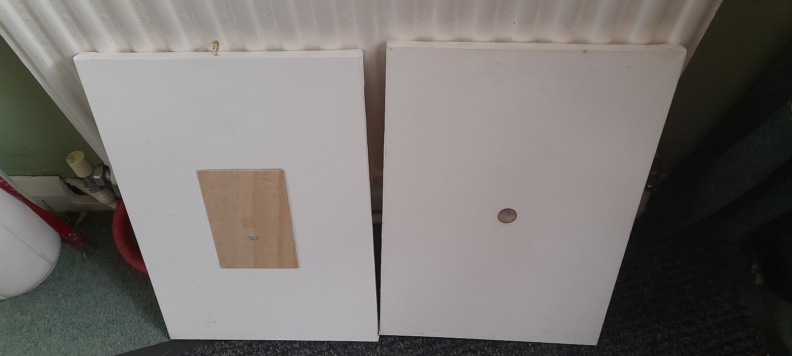

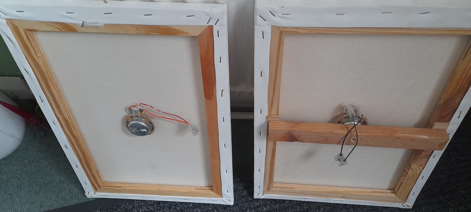

These are the other 2 types of canvas panels tested so far.
The panel on the right in the two photos is the canvas only panel with home made dome , now concave, oops.
This is to minimise exciter noises.
The one on the left used an ordinary 6x4inch 3mm ply ,but glued to the front ,to try and get a more exciting sound.
I would now use a much larger crate ply panel for this last panel , the crate ply is much more exciting, similar to the EPS, but not quite as much.
Steve.

By the way, I just checked , and I also cut a hole in the canvas so that the exciter was directly mounted to the 6x4inch ply panel mounted on the front.
When or if I get some more crates , I will remove the 6x4 ply panel and replace it withe the larger crate ply panel.
With the canvas only at the edges as a surround similar to cone speakers.
Steve.
