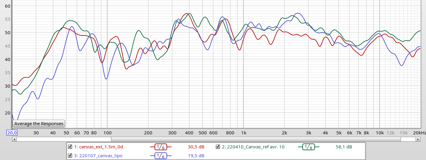

Hi homeswinghome,
does DAEX25FHE needs any support to reach 20KHz with canvas.
do we miss any treble with it or it sounds well regarding the high frequencies.

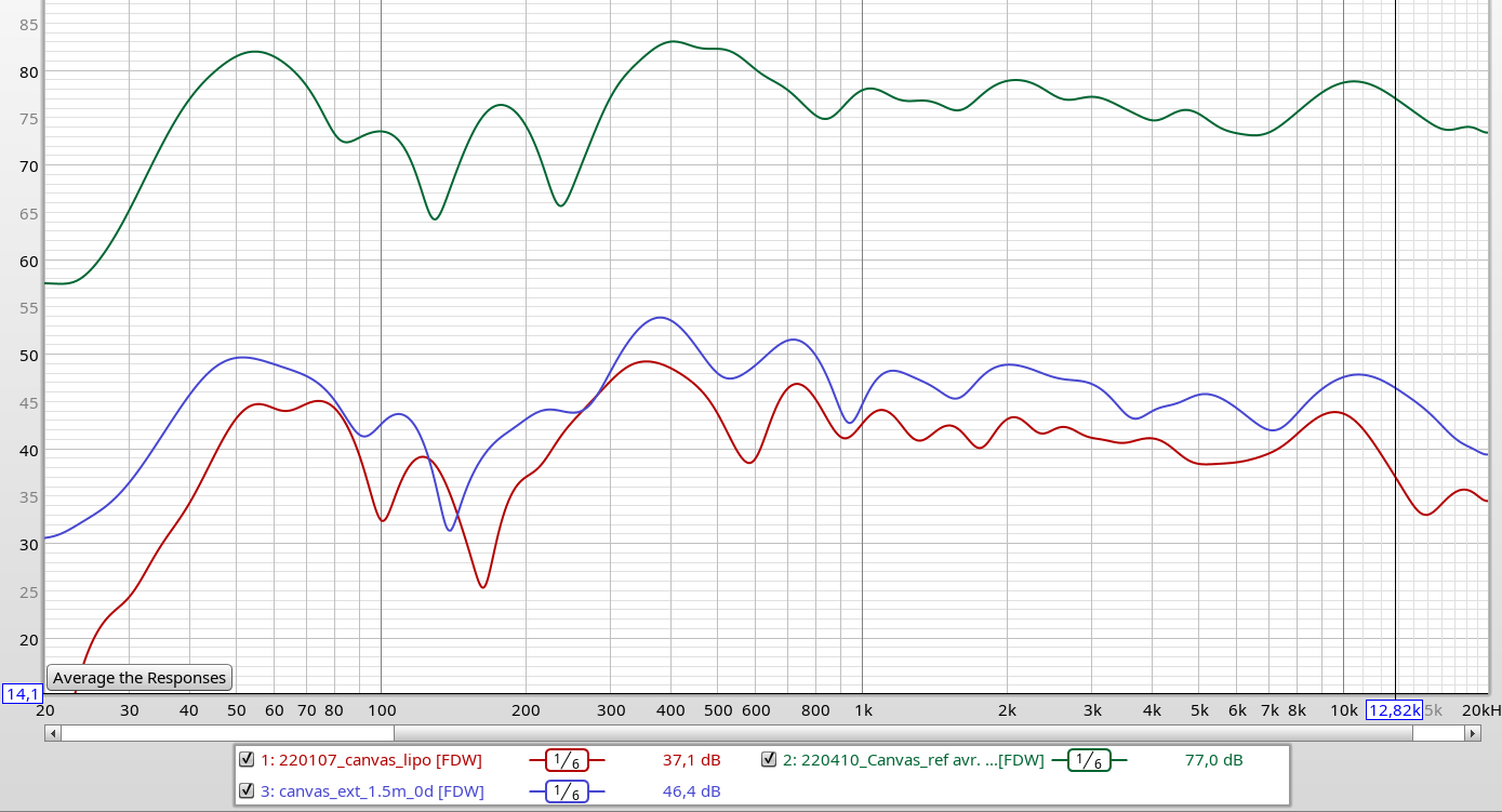

Hi Sarathssca
The DAEX25FHE in the canvas I built keeps a quite good level at 20kHz (see the different FR below : different conditions/locations, distance from 1.5m to 2.5. red curve is in my garden. blue and green in different rooms).

It is interesting to see your plots have an upwards trend at 20k.
the three plots have the peak at about 10k ,with the dips (cancellations) before and after, this I believe is caused by the exciter coil area, which I am always banging on about 😁
Which no one seems to pay any attention too ?
what is also interesting is the hump in the response in the 2k and 3k area , this I believe is the exciter noise being reflected back from the walls, which is not in the red outside plot .
this happens in various degrees and frequencies depending on panel materials ?
Personally I would bring in my TLS at the 300hz point ,producing a slow roll off similar to the room response idea ?
I would roll off the panel at about 100hz or so depending on listening tests ?
I would also recommend using a material similar to the cheap crate material, as this is a performance changer !

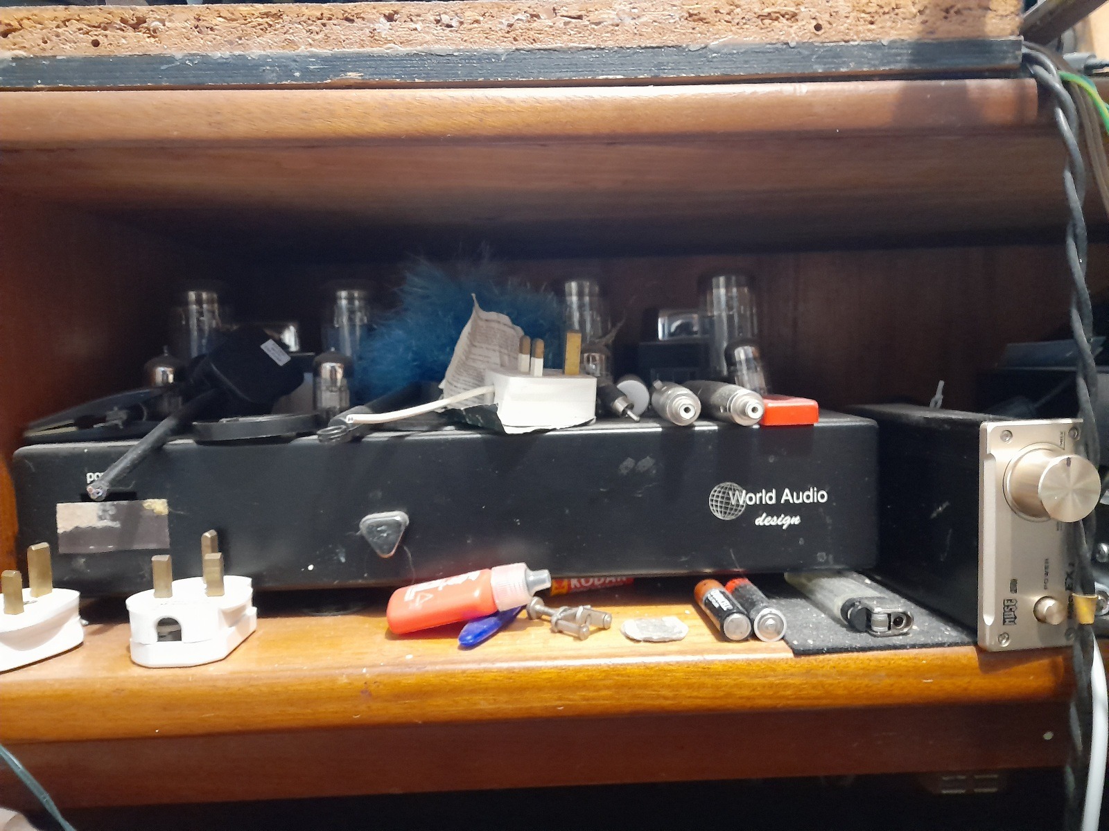

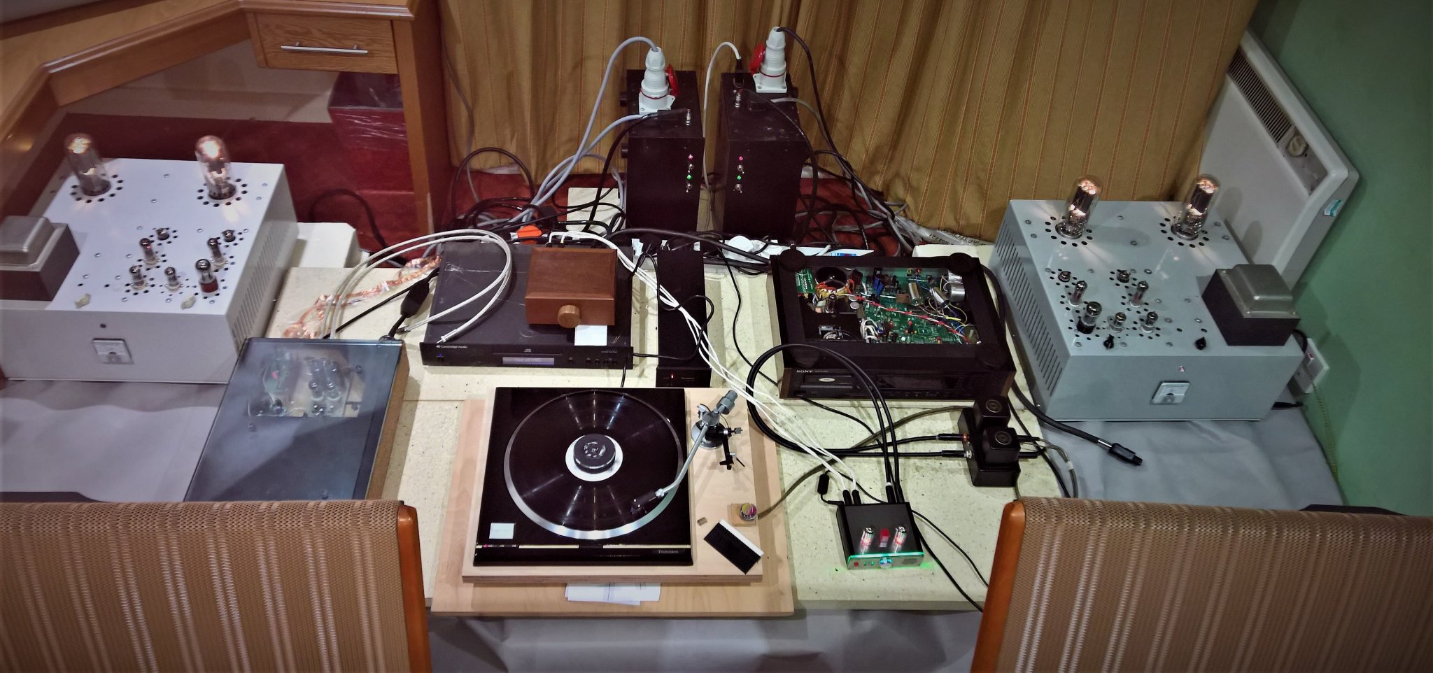

Mine has been sitting here for some years now gathering dust, waiting for me to alter it back to its original state.
I made alterations to try to improve things ,but have come to the conclusion, I was wasting my time !
The little box on the right is the digital amp I have been using for some years now.
I turn the amps off and on all the time testing panels ,which is not good for valve amps.
The only thing I miss is the warm glow of the valves at night , before I nodd off 😴 😁

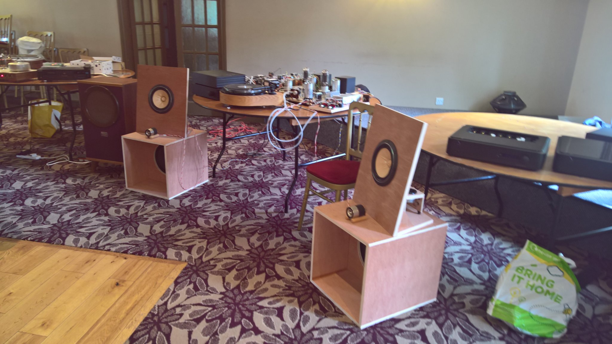

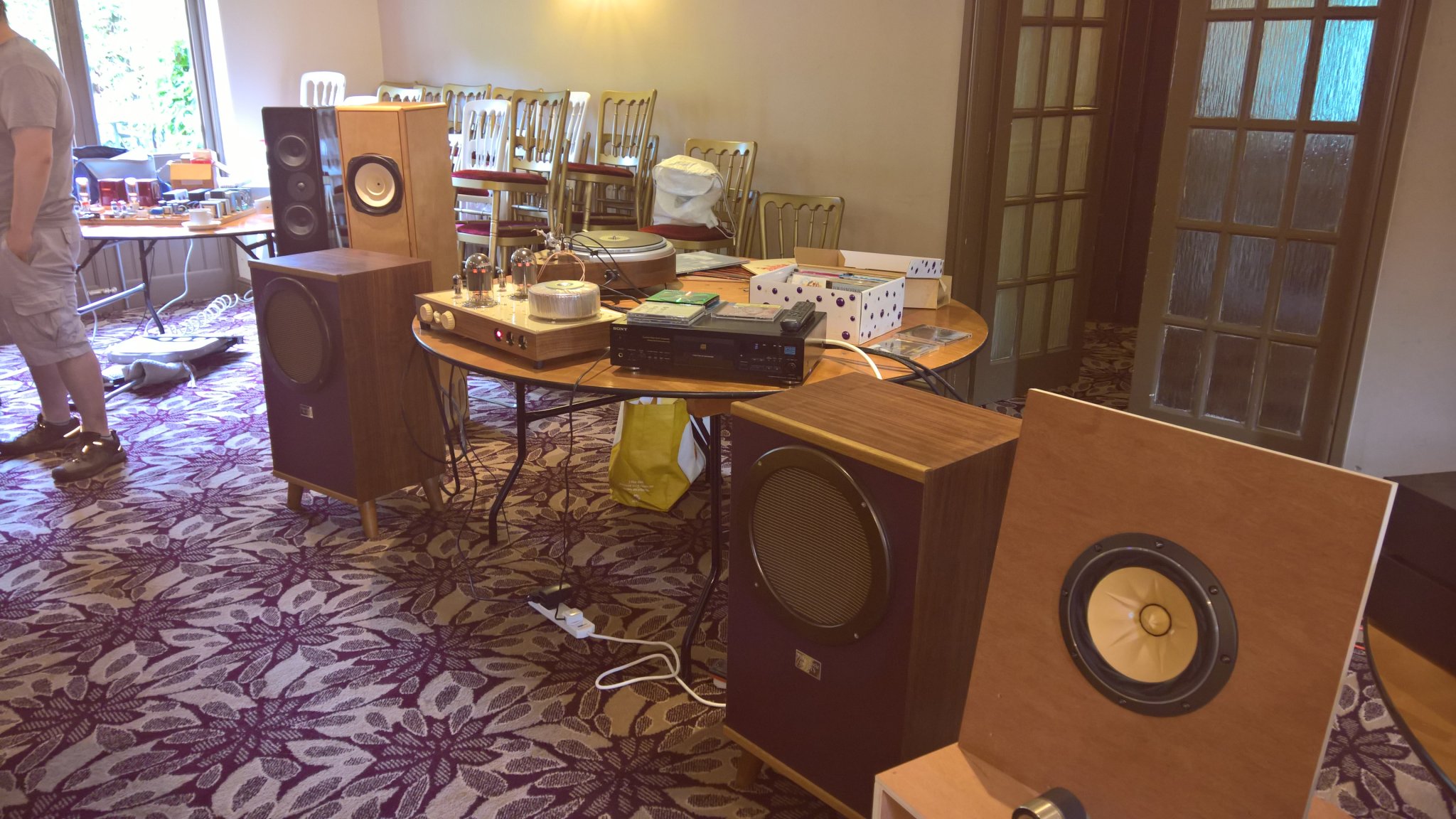

The following images are from The Owston Show, which nr Doncaster, plenty going on at this to keep a DIY minded individual interest attuned, the event has been good to me over the years, I even met the foundation members of my local hifi group here 😎 .
The Bottom Image with the Quad ESL 57's encroaching the image, is the Home System exhibited at The Wam Show.
I met so many people on that weekend, I was overwhelmed by the interest being shown in the system, I did not see the exhibition room developing into the place of interest that it did 👍.

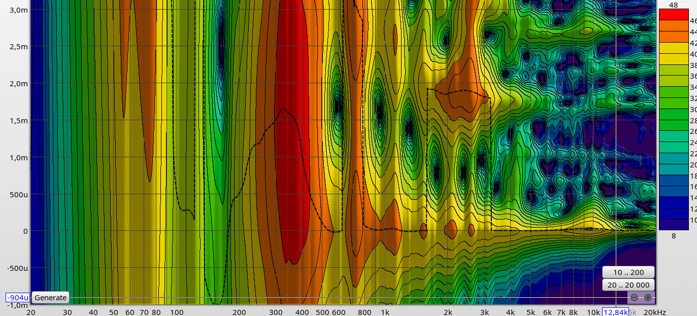

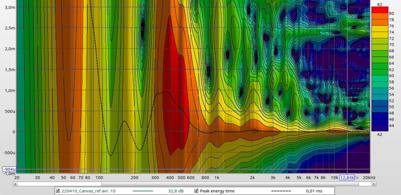

Steve.
Thank you for your feedback Steve
  • The 20k upwards trend is "unusual". Only seen on this panel in what I built. The explanation might be this panel is able to produce 20k which is reflected. You will see on the spectrogram below the delayed energy which enter in the FR of the previous post. The last FR here is the same records but with a frequency dependent window that rejects the reflections.
  • The 10k is the hump seen on many realization and as you suggest probably coming from the coil area (see discussion before on the possible countermeasures : add mass, hole, dome...)
  • For the 2k to 3k area, the causes seem different in the 2 FR. In the blue curve, it is a reflection from the rear wall (see the spectrogram below at 1.8ms which is 30cm, the distance of the rear wall in this case). For the green one (second spectrogram) , no reflection delayed so is it an effect of the distance (1m)? the floor? I change I made and I don't remember?
  • Your suggestion of filter sounds good. I have in preparation an amplifier with a filter for such test but this project is going to be delayed...
  • Crate material was in my scope when I did this canvas because it is an easy way to get light plywood but I was afraid by the weight and reading your post about balsa plywood (you remember the plywood from Amazon which is not balsa?) I did it with real balsa. As everything is glued... that's too late for this one.
Christian
Reactions: sarathssca
