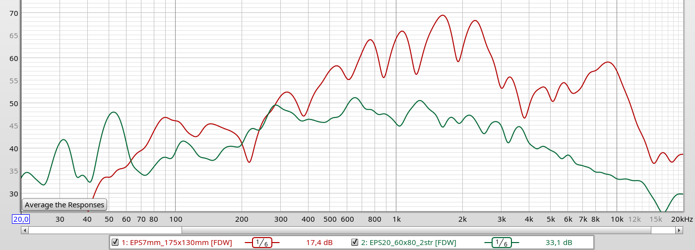

Hello Leob, hello Steve,
Steve, this is an "old" question. You reach 20k with EPS. Leob can't and with the few tests I did with EPS I can't go to 20k.
Below 2 EPS I tested :
  • a 175x130mm 7mm thick not coated from a packaging (quite dense) - red
  • a 600x800mm 20mm thick 15kg/m³ PVA coated - green.
Where is the difference? with what you do?

Hi Christian.
It would seem I can only guarantee the hf performance with my exciter ?
The green 20mm eps line starts a downwards trend at just over 2k, and a smooth roll off from about 3.5k to 10db down at 10k ?
with my exciter , neat 15kg/m3 has no problems until after about 10k ,which can be sorted.
If you are using tape , this is also reducing the hf above 10k .
I presume the microphone was at least 1m distance ? Because of the drop below 300hz ?
The red 7mm line is all over the place, this does have a peak at 10k, but is still well down .
I have no suggestions for these response curves, as they are already beyond my help.
If I glue my exciters on in the morning using pva , with a little help from a hair dryer, they can be tested that evening.
But the hf will not reach its full potential until at least a few days later !
This is easily measured.
Is the frequency response of the green 20mm line any better at 50mm in front of the exciter ?
Steve.

Hi Steve
Yes the mic was at 1m for the red curve and 1.5m for the green.
Unfortunately I have no record at close distance
Leob.
Your measurements don't make much sense to me ?
Bog standard 25mm eps should be pretty flat to about 10k
So 10db down by 2k and 30db down by 10k ?
You can't be measuring correctly or there is something wrong with the exciter of mounting ?
your other measurements also have similar heavy roll off also ?
This cannot be a coincidence
they should not have similar measurements.
Steve.

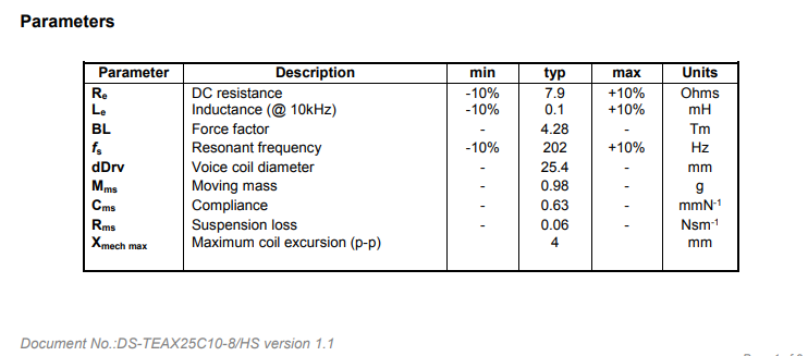

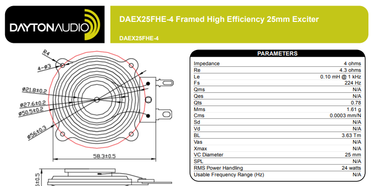

Hi Steve,
To have more criteria for the exciter choice would help but up to now I have no real way... My basic criterias are high BL, low mass, low inductance. Previous posts shown the role of the inductance. My tests around the voice coil mass haven't shown it is very critical.
When I come back to the comparison of specifications :
  • The TEAX25C10-8/HS you use (see post #3433)
  • The Dayton Audio DAEX25FHE4 commonly used
The TEAX has a lower mass (1g vs 1.6g) but no evidence it is an advantage
Their inductances are similar at 0.1mH... but the TEAX is 8Ohms which means the cut off frequency is higher. This might be a good point.
The problem is the TEAX or HIAX seems not easy to find. Do you know some suppliers or equivalences?
Extract of the specifications
