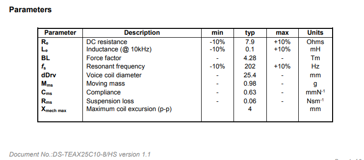

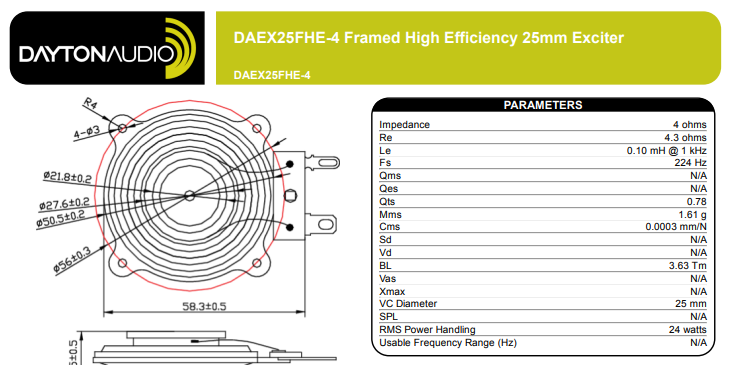

To have more criteria for the exciter choice would help but up to now I have no real way... My basic criterias are high BL, low mass, low inductance. Previous posts shown the role of the inductance. My tests around the voice coil mass haven't shown it is very critical.
When I come back to the comparison of specifications :
  • The TEAX25C10-8/HS you use (see post #3433)
  • The Dayton Audio DAEX25FHE4 commonly used
The TEAX has a lower mass (1g vs 1.6g) but no evidence it is an advantage
Their inductances are similar at 0.1mH... but the TEAX is 8Ohms which means the cut off frequency is higher. This might be a good point.
The problem is the TEAX or HIAX seems not easy to find. Do you know some suppliers or equivalences?
Extract of the specifications

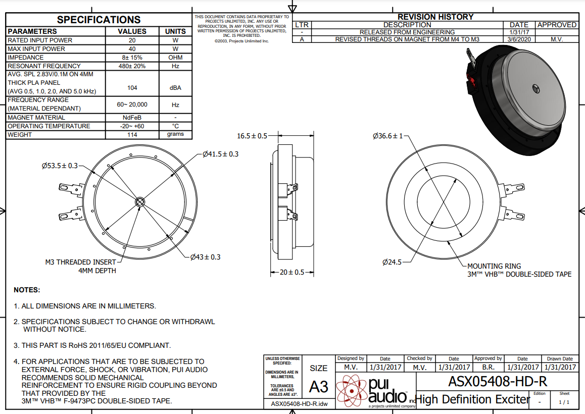

One of the reasons I started using the following PUI exciter is they provide some worthwhile specifications including frequency range.
Thanks, Dave
Thanks, Dave
I did look at that exciter but was very disappointed with the spec sheet since they basically only publish nominal impedance, resonant frequency and frequency range. The Daytons are specified as having a range to 20k as well according to soundimports. Doesn't say anything though without specifying at what deviation. Even my really high impedance 50w exciters, that had very little HF reproduction, did have a range up to 20k.
Hello Dave
Do you know what is "PLA" (PolyLactic Acid?) as material in the efficency specification?
Christian
Interesting. PLA is the most commonly used plastic for 3D printing. It is a plastic made from starch, relatively brittle and with a low glass transition temperature. You can also get plates like this: https://www.amazon.com/Tamiya-70122-Plastic-Panel-Pieces-White/dp/B001Q150W0
Not sure why they include that data, since PLA is not that efficient to start with, and from what I have seen very uncommon choice. Measurement is at 0.1m, so translating to typical 1m measurement it would be 84dB efficient.
Thank you Leob
PLA is about 1250kg/m3 density so 5kg/m² in 4mm thickness so abit higher than acrilyc. That's right : not good for efficiency. Strange choice.

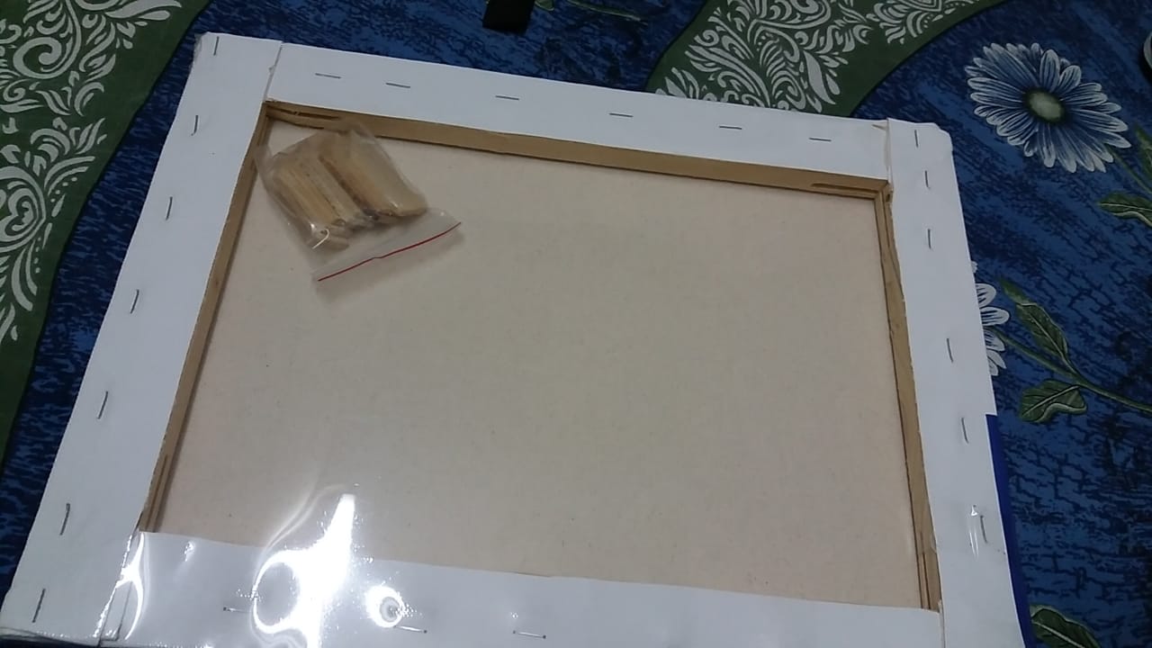

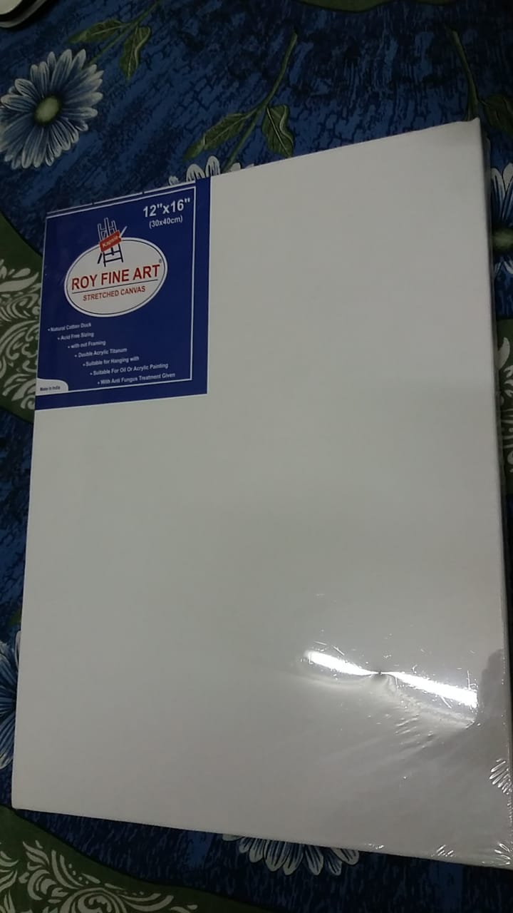

Finally got a couple of stretched canvas frames of size 16 x 12 inch, as in attachment.. 🙂 ..
