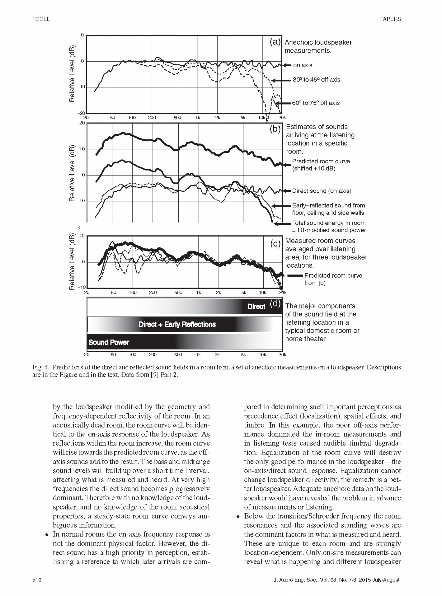

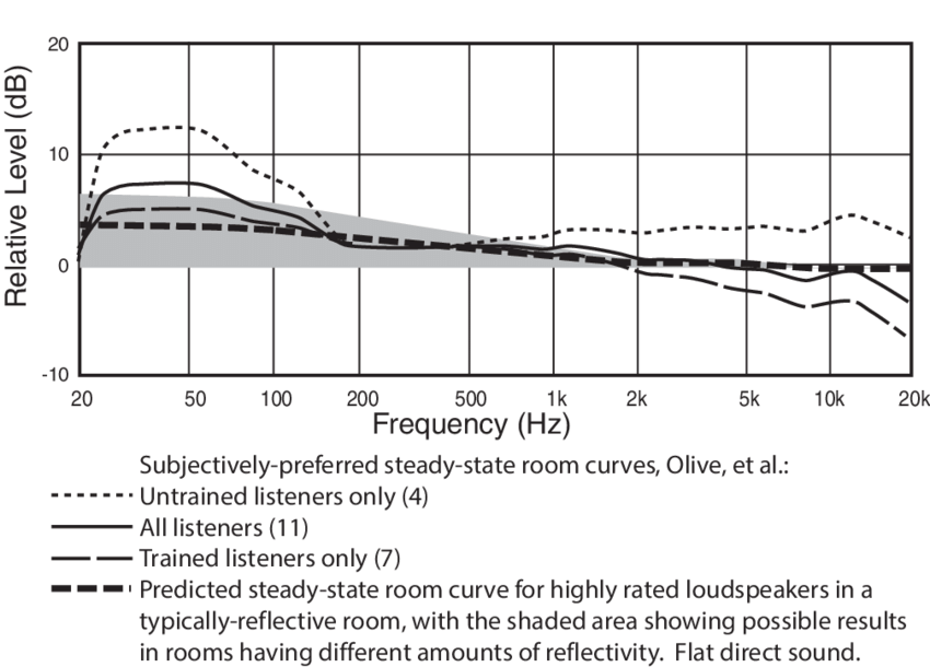

I'm forgetting that published response curves are measured in an anechoic chamber.
Maybe these - the second indicates a 10dB roll off in room approx = anechoic flat
  • Subjectively-preferred-steady-state-room-curve-targets-in-a-typical-domestic-listening.png

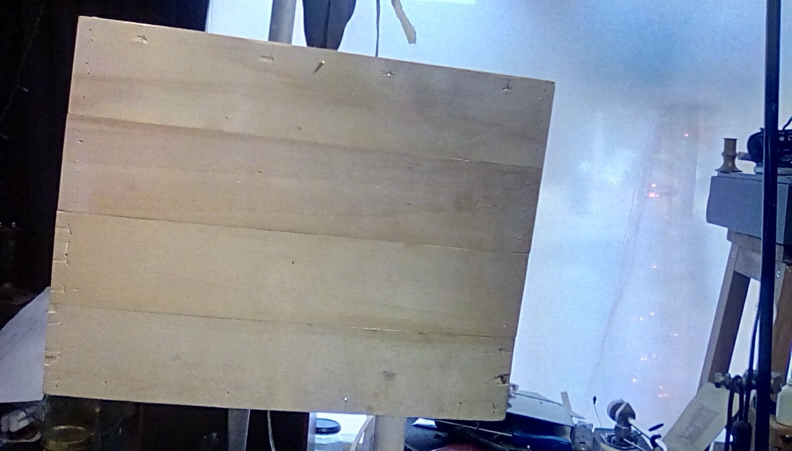

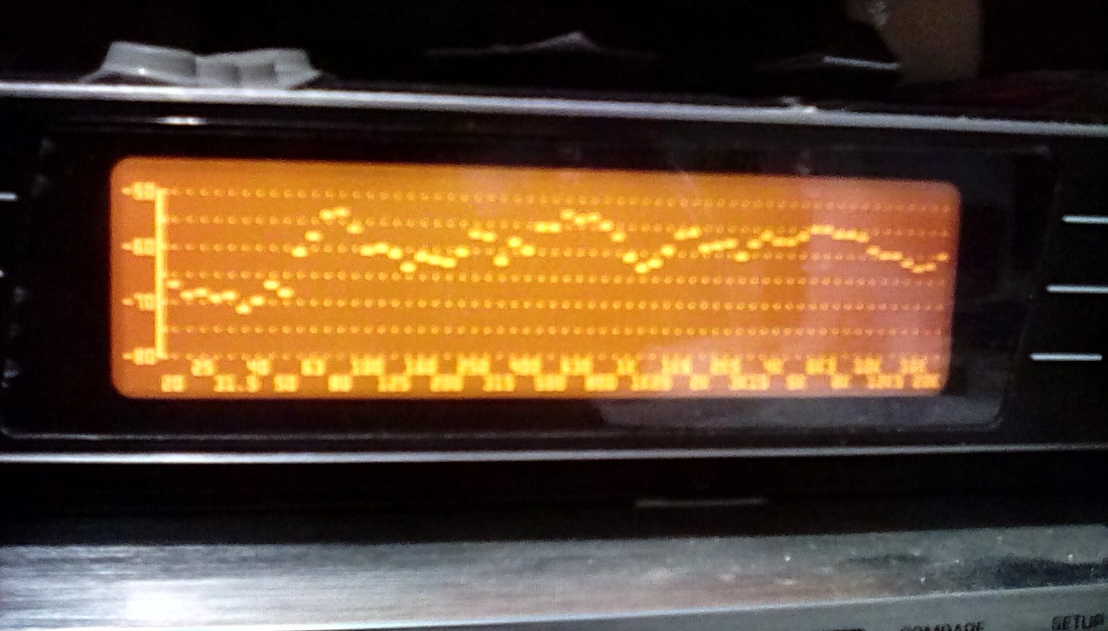

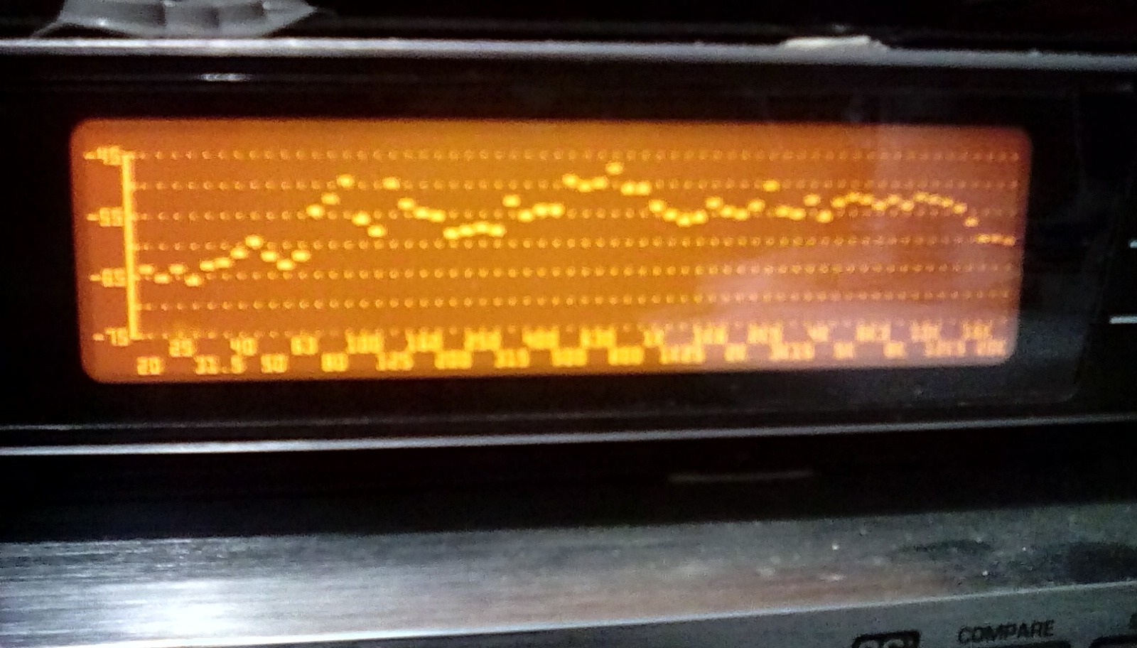

These pictures show the new 4 strip panel.
The second picture shows the new response, not as flat as the 3 strip panel ,with a more exaggerated hump just below 1k.
The third picture shows what happens when I hold the ends of the panel in my hands (the microphone was just placed on the side).
The low frequency hump increases and moved down in frequency to about 60hz.
I did try using weights (sound bridges ?) But the blu-tack wasn't strong enough to hold them on, as this made the panel vibrate more, this is not what I would normally want to happen.
Steve
Steve

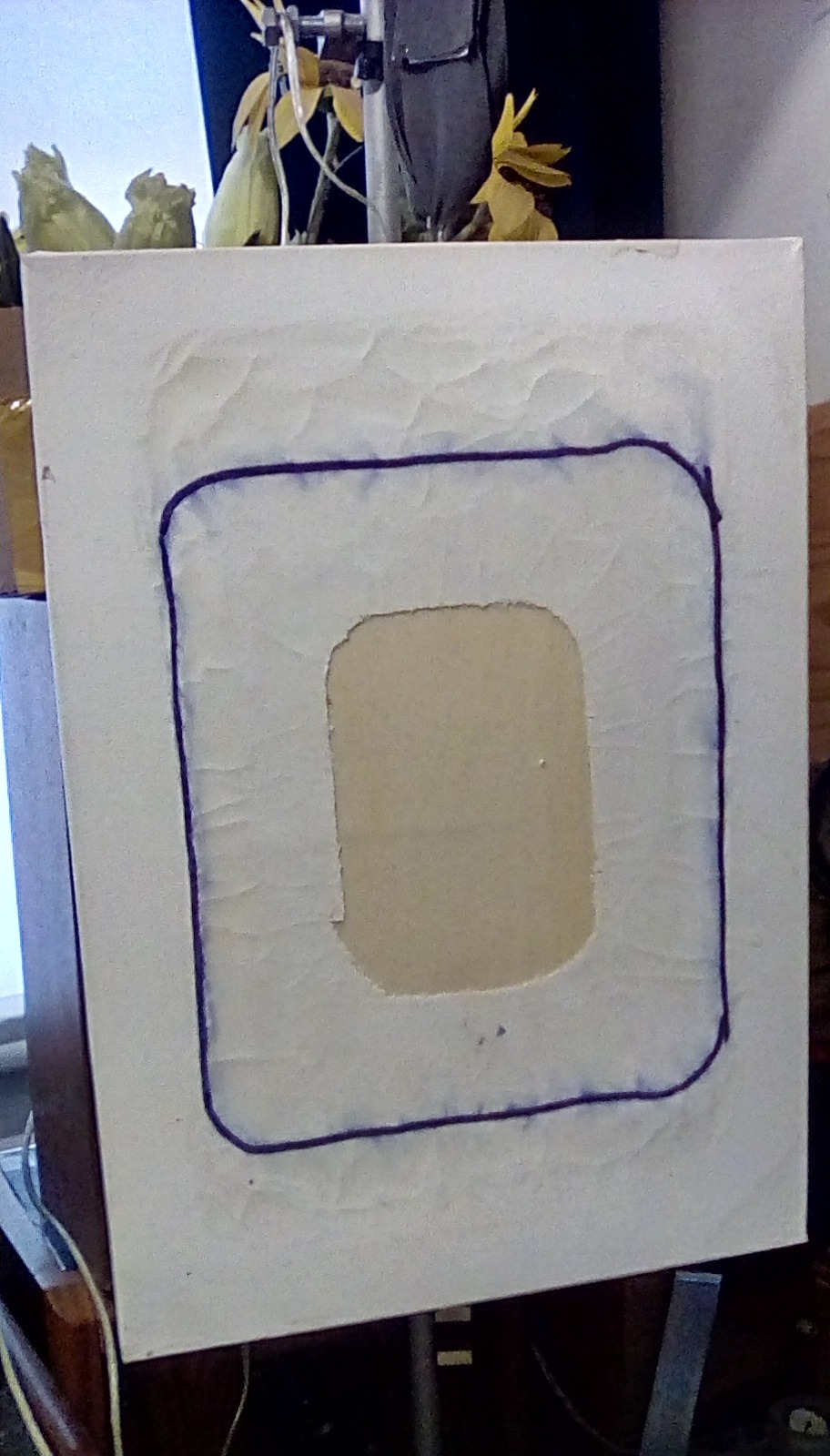

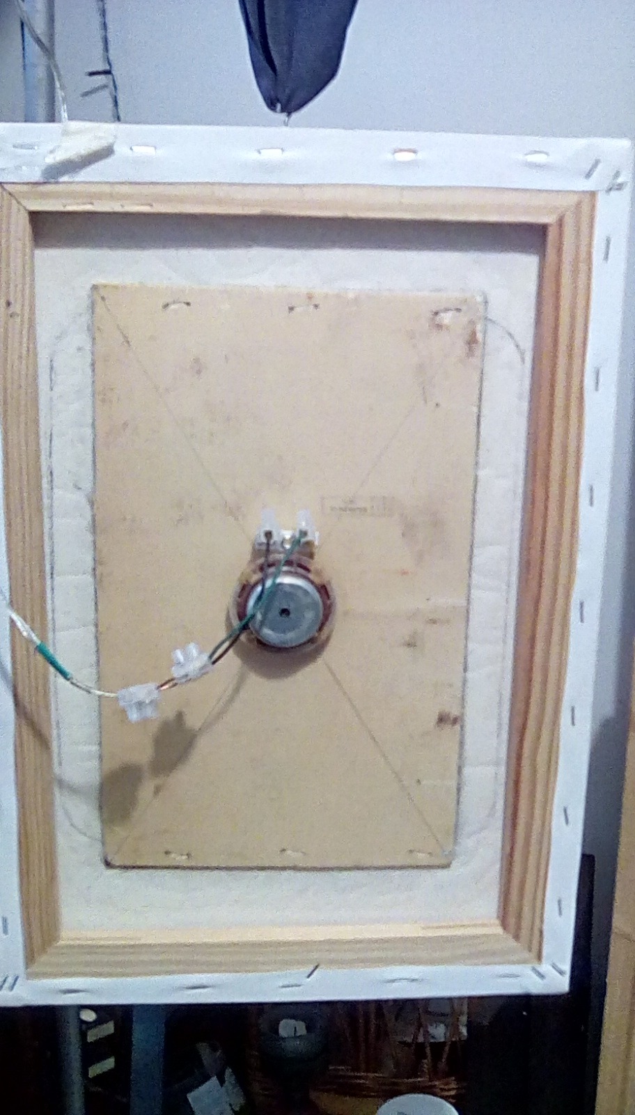

I'm forgetting how this started , I just used this handy material I just had lying around ,with the intention of trying out some of my ideas to improve the sound of the art panel .
So I was a little taken aback by the improvement made by this material.
As you can see in these pictures ,I had to cut out the old 6x4inch x 2mm ply panel and glue in the larger lower quality panel.
This leaves the new panel undamped by the canvas ,over the 6x4inch gap in the canvas.
This works well with this material, the panel could even be bigger with less canvas covering the ply ?
If anyone was building a new art panel or thinking of improving the panel they have already built, I would recommend this.
This is a vast improvement.
Steve.

the exciter is now glued firmly to the 4 strip panel.
I noticed that when the sun shines ,the light shines through the panel, which the other plys do not.
The small 3mm 286mm x 176mm is about 64g .
The strips on the larger panel seem to measure slightly less than 3mm sometimes getting close to 2.5mm ?
I've been looking, to try to find out what the material crates are made out of , without luck so far.
Steve.

I understand your question... how to reduce or identify what is added by the room.
Saying that the change from log to lin is not a solution. It might be a tool to have another look at the FR in the low frequencies. Up to now it is not in the missing tool for me.
About the room, as you say, if the goal is a comparison between different solution, keeping the source and the mic at the same point is ok. To make analysis of a design, changing the speaker or mic position helps. A large room or even just a standard garden (french house scale, not a castle or even a desert ;-) ) also help. I think some DIYer lift the speaker on a structure (a ladder?) in their garden to avoid the reflections. DML have a drawback in outside conditions which is the possible sensitivity to the wind (large dimensions, small foot print, weak membrane).
I spent time at my beginning with DML to try to understand where such problem comes to end on the fact that most of the problems (not saying all) we want to solve are from the panel. This is probably not so surprising due to the reputation of the DML to have a low room influence (coming from its diffuse nature = the sound source is not located at a single point for all the frequencies).
So at the moment, I don't worry really about the room effect as I was before coming from standard loudspeaker paradigm.
As mentioned by Spedge : mic at 1m (my tests shown me that 30cm is a bit short even for a 30cm panel - I made some series of measurements 0.25m, 0.5m, 1m, 2m showing the FR becomes "stable" between 0.5 and 1m) with some frequency dependent windowing or wavelet spectrogram do a big job. This even is more true that our frequency range of interest is mainly above 100 or even 200Hz.
Christian
Thanks Christian and Spedge
I do test @ 900mm and @ listening positions - I'll continue on as the Nullabor Plain is just too far away. 🙂
