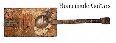

Why am I now envisaging a packing crate guitar with lots of jagged edges and nail holes 😆??Eucy.
I'm not sure a low grade crate material is going to be listed on a tone wood site 😲
steve.
Spedge - I knew it! -
You need some Cigar boxes !! 👍😉
https://www.cigarboxnation.com/page/free-plans
Eucy.
I just love seasick steve.
I'm sure he has made one.
He even made one out of a hub cap,not sure what it is called in US.
Steve.
Steve.
