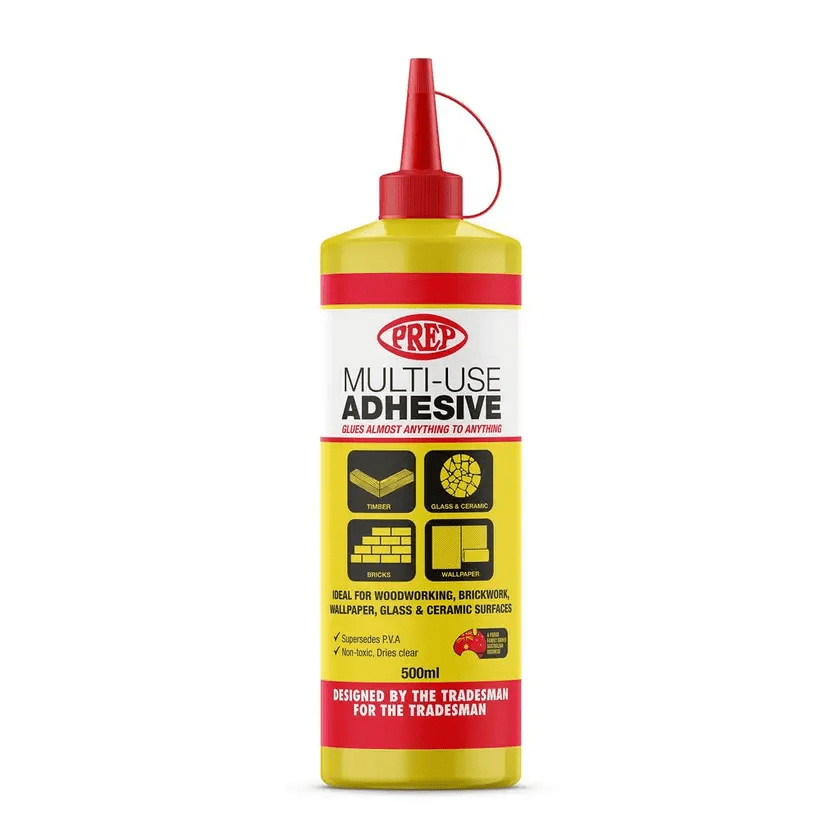

Christian (and others) - I highly recommend this glue if you can get it - It's Styrene based - looks line PVA but isn't - adheres to more materials than PVA - quite strong and dries about the same as PVA - I have used it to glue exciters to panels instead of epoxy and it's worked wellDoes somebody can tell more about this glue? Advantage or drawback? The Titebond website said it is an alternative to the epoxy bi-composant... for a newbie like me using almost PVA, neopren or superglue it sounds like something easier to use than epoxy.
- the glue type : Titebond liquid polyurethane glue (information here, example of source)

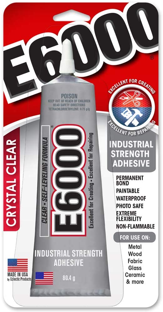

The E6000 glue is a thick semi-elastic glue similar to glue gun glue, except in a tube. When I need to drop the voltage from 12v to 5v, I use it to glue the converter pcb directly to the project. It's fast and works well for that. For dmls, I would say it's much too thick.

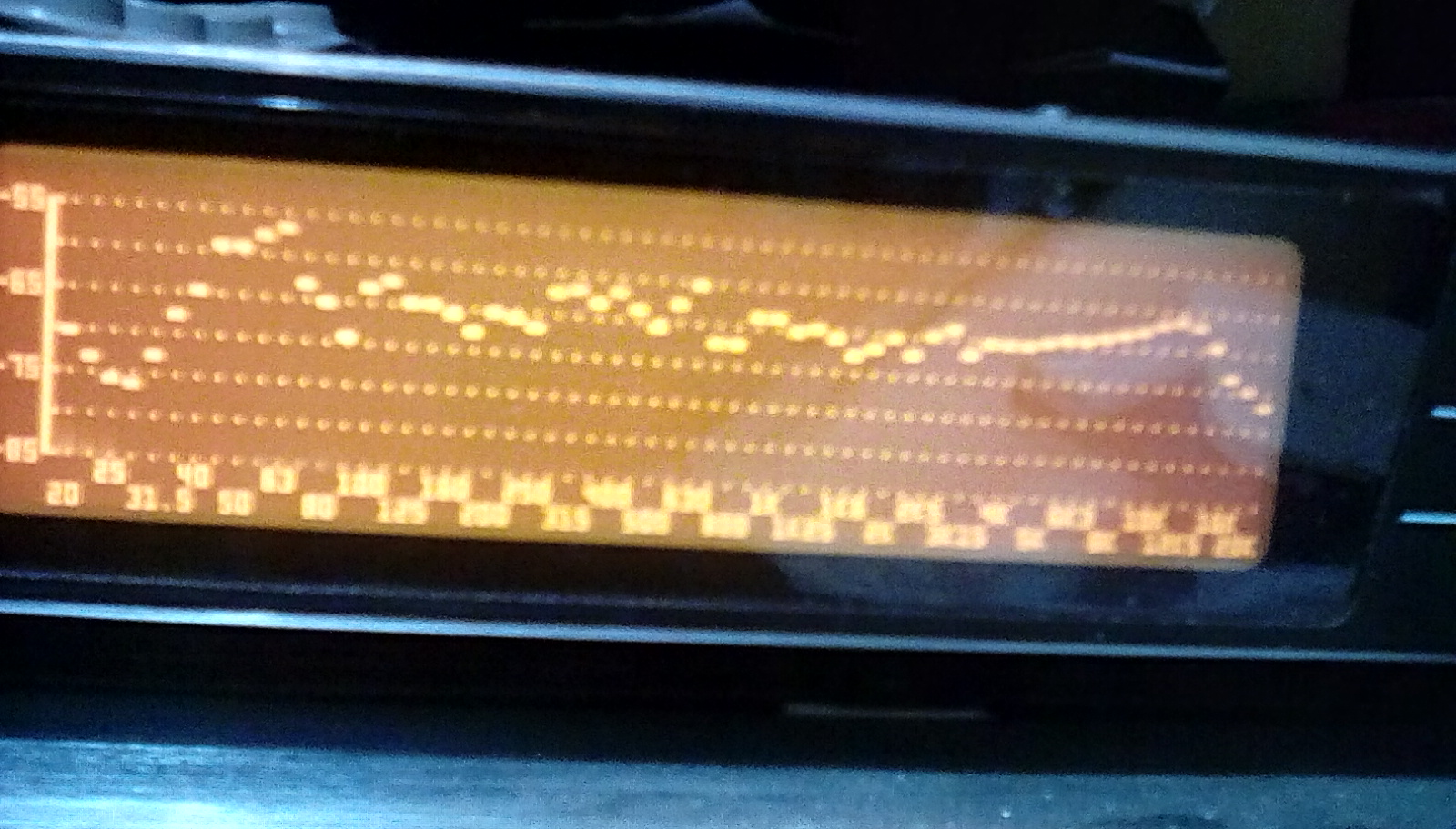

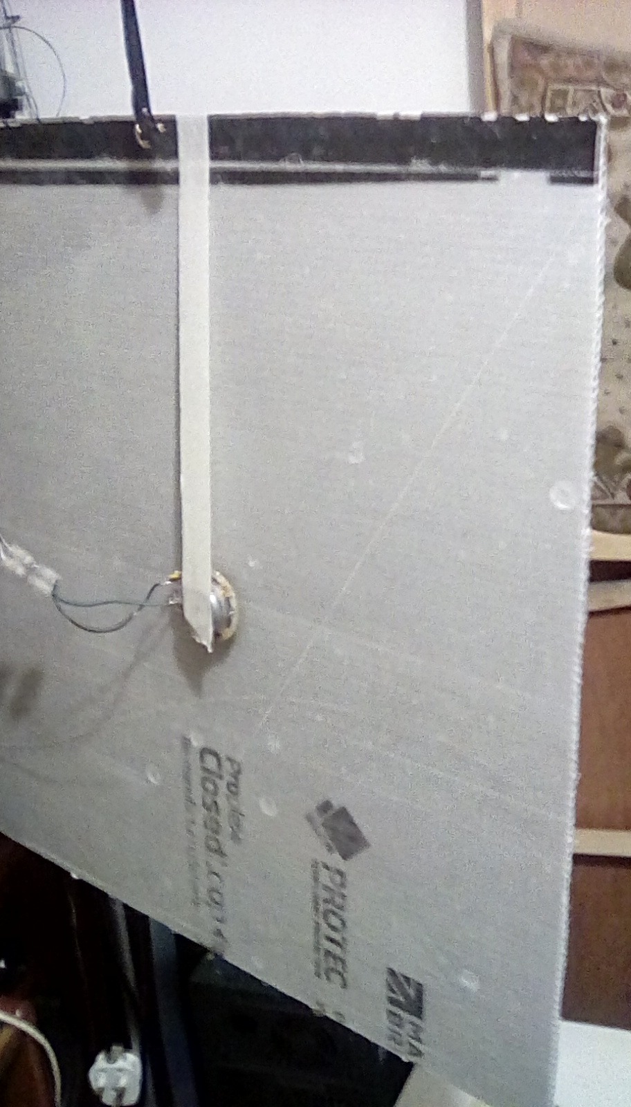

Two quick pictures .
The first of the frequency plot ,which was unexpectedly good.
The second of the exciter on the panel, held on with double sided tape ,so the hf should improve when glued on properly,and some masking tape to support the magnet.
My exciters are getting slightly warm, but I am using them full range so far.
So looking and sounding not too bad, I'll have to get another exciter from one of My other panels again.
Then I'll make a recording of the two panels.
I'll reserve judgment until I have both panels up and running, but first impressions are , I'm glad to say, very promising.
Steve.

Now I have taken to the concept of a DML and responded by immediately looking at materials for panels that were available.
The Ribbed Material with Cavities, set myself of pondering if a method to fill the ribbed cavities with an inert gas would have an effect that could be measurable and seen to be an improvement.
The air is exchanged for an inert gas as an alternative internal resistance within an speaker enclosure, where there is a change to the force that is usually in place behind the drivers.
Filling the ribs cavities on the board with inert gas, does create an alternative being filled with air.
To create the type of experiment I have seen, the board would need an inert gas filled chamber in place behind the DML Panel to produce an alternative rear force to impact on the function of the Exciter and flexion of the board.
This is all conjecture on my behalf for a DML Panel , but is quite achievable on the HD 3P Tweeter.
