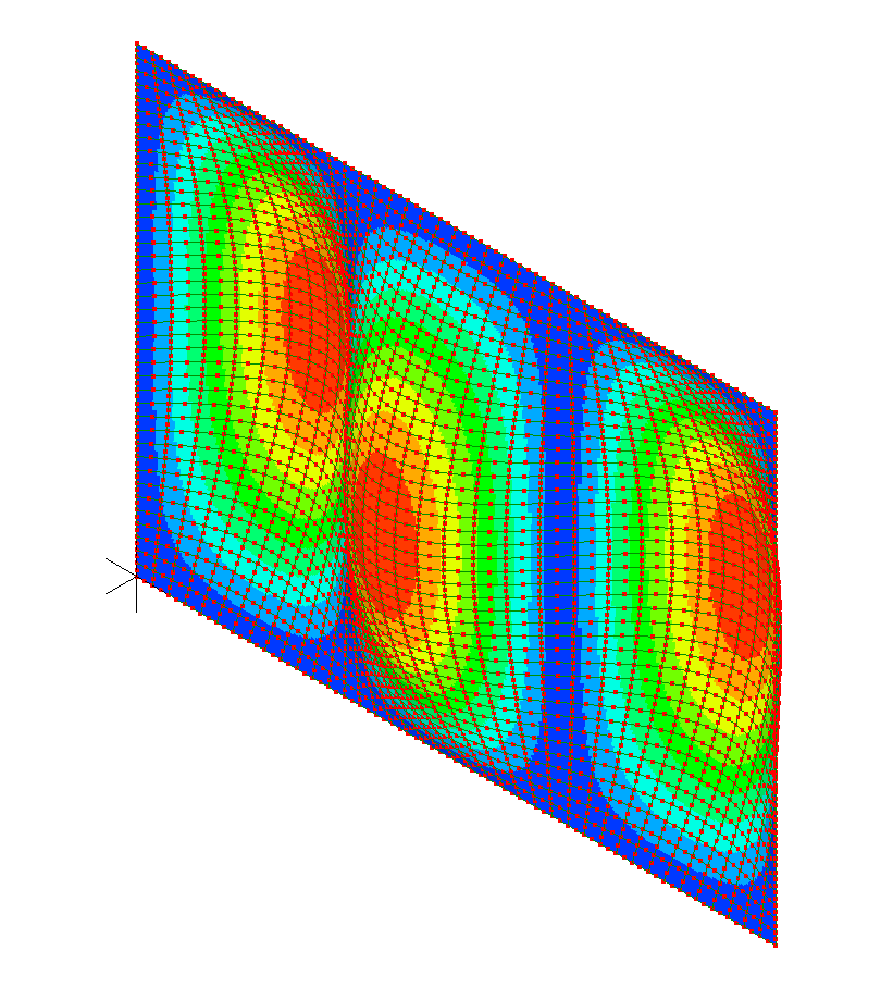

The sources I have found mainly talk about how, below fc, the modes with the highest radiation efficiency are the odd, odd modes. I have always assumed that the reason for this is that those modes (like the 1,3) shown below, are unbalanced and hence not fully "cancelling". That is it has two regions that are out of phase with the one other region.
While modes like this (1,4) on the other hand, have identical regions moving in opposite directions, and hence tend to cancel each other in the far field.
But this effect is not dependent on damping, so perhaps it is still not what you are talking about.
Eric

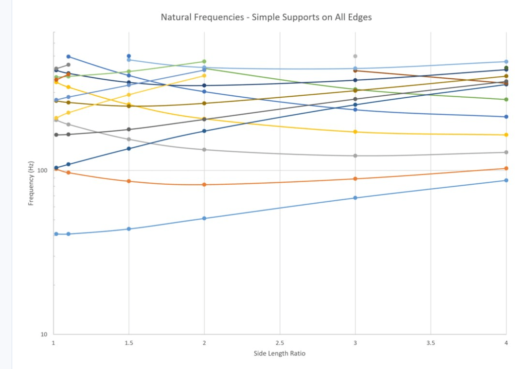

It stands to reason that an elongated panel would give better spacing at low frequencies than a square one, because you are giving the waves a longer and a smaller distances to traverse, accomodating a greater range of wavelengths.
This is what Im aiming for with non-rectilinear shapes. Not just to eliminate the most obvious standing waves, and to randomise, but to give the waves a smooth distribution of path lengths across the panel body in any direction, in the hope that that relates to a more even distribution of SPL with freq. At the lowest frequencies, again I hope that the addition of some small number of lobes of different resonant frequencies could be designed to augment the bass - ie fill in gaps at the bottom end.

The uniform spacing of modes doesn't guarantee a flat frequency response at the low end, but it gives you a fighting chance!
Eric

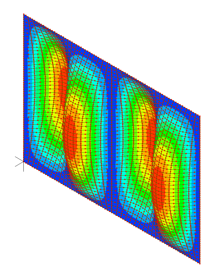

I guess the problem with even modes is twofold. First, they don't have a central antinode, some of which will survive cancellation due to damping, and which will be larger anyway if the exciter is centrally placed. Secondly, after cancellation you are still left with a + on one side and a - on the other side. Which even if they can reach the far field will cancel out at your listening location directly in front - which I think is what you were saying.

Yes I made a comment recently about the guitar video where where he said the (1,2) mode (forget what he called it) was the most projective for the guitar. I guessed some asymmetry allowed that. Then later I saw again in the piano thesis, it was mentioned that the asymmetry allowed a (2,1) mode to have a reasonable SPL.Hello Paul,
The non (odd, odd) modes have a chance to produce sound (or at least to have not strong cancellation).

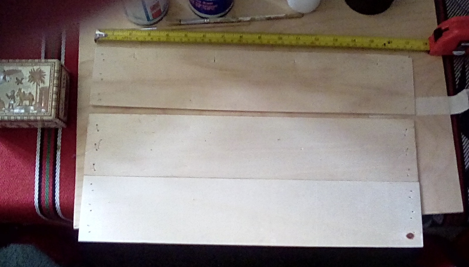

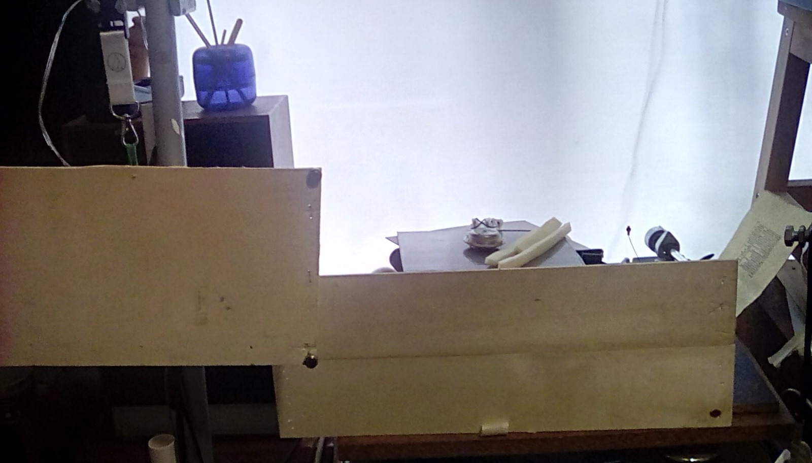

The first picture on the left is one of the side strips ,it's only about 3. 5 inches wide and manages to get down to 400hz or 500hz depending on weights .
The second picture is two of the strips glued together to match the width of the single panel.
I have not listened to this as yet, but am toying with the idea of gluing on the third strip to make a 10inch by 17 inch panel as in the third picture.
It will be interesting to see how this affects the sound.
Steve.

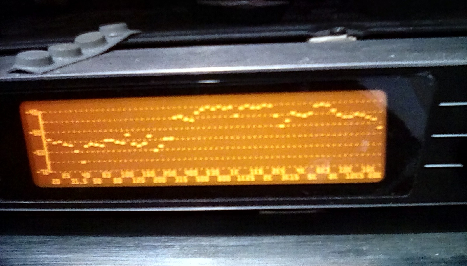

I've been playing some music on the low quality ply panels and thought it was interesting to mention that even though the plots show a fall off below 250hz .
when playing music with the microphone at 3m there is a mutual linking of the panels below the 250hz point .
as can be seen in this photo, the hump in response between 250hz and about 3k is the vocals and guitar.
but below this there is a half decent response down to 40hz which is easily heard.
yes it sounds thin ,but not as much as expected from individual pink noise plots.

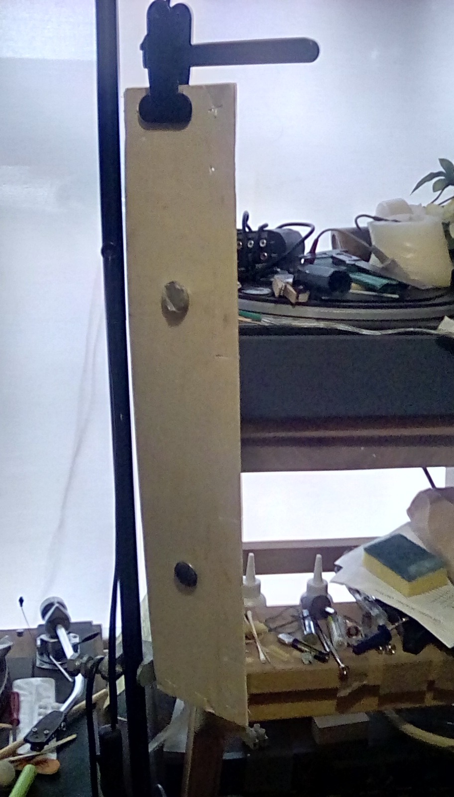

I just stuck the exciter on the two strips panel with double sided tape for quick testing.
I think I will glue another strip on now , and do some more listening tomorrow.
Steve.

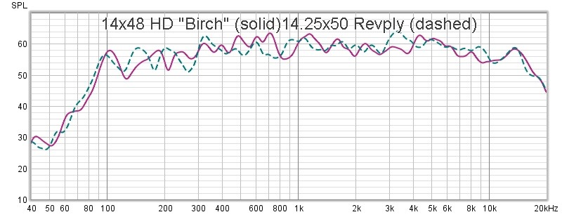

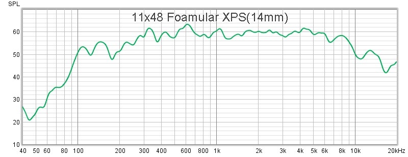

Christian,I agree on the "theoretical" interest of elongated rectangle. My question is just "Which evidence do we have from a working design?"

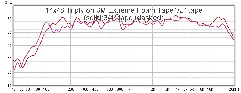

Here are some examples of several (in my opinion) working designs of elongated rectangles.
The first two are both the exact same 14"x 48" (3.4 aspect ratio)"Triply" 5.4 mm 5-ply plywood panel with different widths of mounting tape on the perimeter.
The next two are two other similar sized 5 mm 5-ply plywoods. All four sound similar, but I like the HD Birch best, because it is the lowest density, and highest efficiency of them, although that's not obvious in the FR plot. Probably the volume setting was different. But when played side by side the HD Birch is loudest by a few dB. HD just means "Home Depot", and I'm pretty sure only the skin layers are birch (if that!) otherwise it would be much heavier.
The last is 11" x 48" (4.4 aspect ratio) 14mm thick Owens Corning Foamular XPS (the pink stuff). Of course this is maybe 10 dB louder than the plywoods, but falls off a bit more at both ends of the spectrum. As you know, I'm not normally a fan of XPS, but this one actually sounds pretty good. The best of any XPS panel that I've ever built for sure.
All are using a very sturdy frame and 3M double sided mounting tapes (3M Extreme or similar) around most of the perimeter. I leave about 2 to 3 inches free at each corner. Not because I think it makes a difference (I don't think it does), but rather so I can remove the panel from the frame without destroying the panel in the process.
No EQ on any of these.
Eric
Eric
