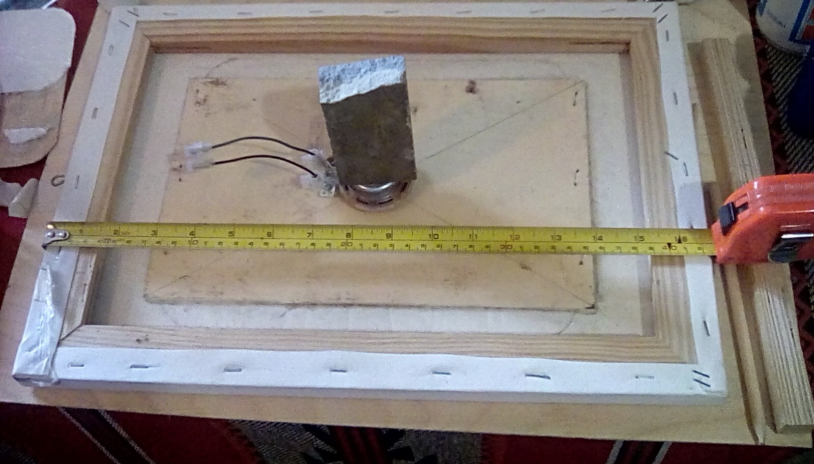

The art panel has now got it's exciter attached.
The panel feels quite stiff , not a lot of movement, we will have to see if my exciter is powerful enough to drive this ?
I will be very interested in the response below 300hz.
I don't expect any change in the response in the HF region.
Would a eps of xps panel be better for this, maybe even with epoxy skin ?
Similar to a KEF B139 ?
For bass duties obviously.
Steve.

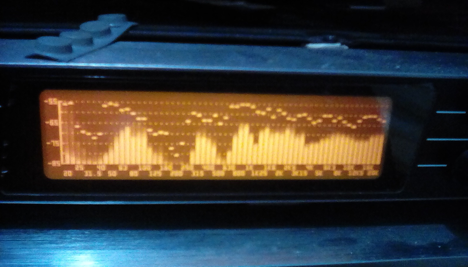

Well , I couldn't wait any longer ,so hooked up the art panel next to my eps panel.
I did my usual adjustment to the channel levels, but something was wrong ,the panel was too loud.
It was only a few db lower than the eps ?
So I put up my art panel with the ply on the front side and took down the eps panel.
It is still too loud , the photo shows this.
The upper dotted line is the new art panel the lower thick line is the actual real time response .
The new panel is between 5db to 10db louder ?
I'm going to have to swop them over to make sure that nothing has gone wrong with the amp ?
The responses seem similar but the larger ply panel handles the bass better, as I suspected.
Before I say anymore I'd better try and figure this out ?
Steve.

Well, yes, the new panel is louder ?
A lot louder !
The bass peak is not as loud as the cascamite panel with 6x4 inch ply but this panel handles it much better and gives the panel a much flatter response curve.
So far it sounds very good too, but I need to do some more listening.
The low end drops off below 40hz still , so I am rolling this panel off at 45hz at the moment to stop the very low frequencies getting to the exciter, which helps stop unnecessary vibrations and power needs.
So this panel can go loud with my exciters, but probably could do with a little more push lower down , I could double up the exciters for more power or a more powerful exciter ?
I know that mounting my large ply panels in a very rigid frame increased the db output , but am a bit mystified as to why this panel should be louder.
I will have to now, make a panel out of the other half of the box to see if it is the material ?
But I think it is not ?
I will have to wait and see ?

I realized my pictures are too big for the forum rules so that's why they aren't there.
Been experimenting....different driver positions and combos and panel positions and suspension or sitting....and nothing comes close to the high frequency response of the other panel. I'm wondering if the braced XPS is just too stiff. The 6 foot panel is quite wobbly. I think I have two very large pistons. In the smaller panels. Rather than cut the bracing off, I'm considering cutting some slots in the face along the edge to free up more movement.
