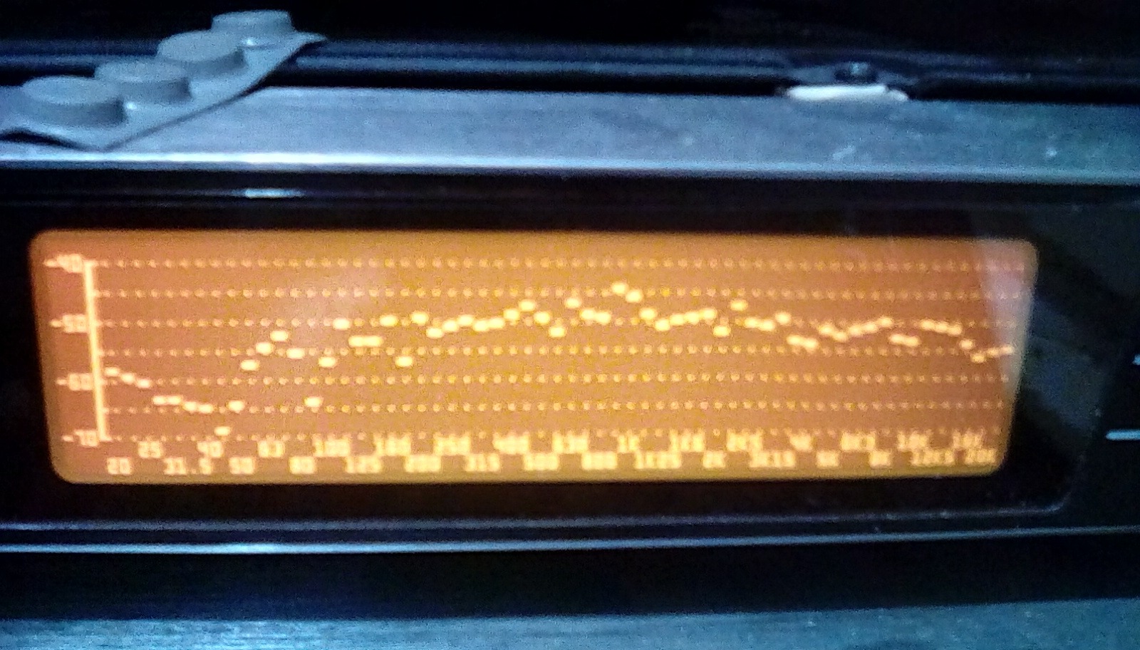

I just took a quick photo of my low grade EPS panel.
As you can see in the fr plot the hf extends up to 16k before dropping off a little and then carrying on up to 20k and probably beyond.
This is easily attainable even as I say with low grade EPS ,the higher grades have no problem reaching 20k on there own without modifications.
I have still not heard the echo-y sound that you mentioned.
The only sound that I thought might be the echo you mentioned was on untreated panels with the original EPS hard skin ?
The plot is at 12inches but is pretty much unchanged in the HF at 3m.
Steve.

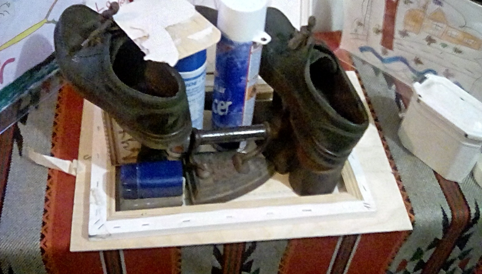

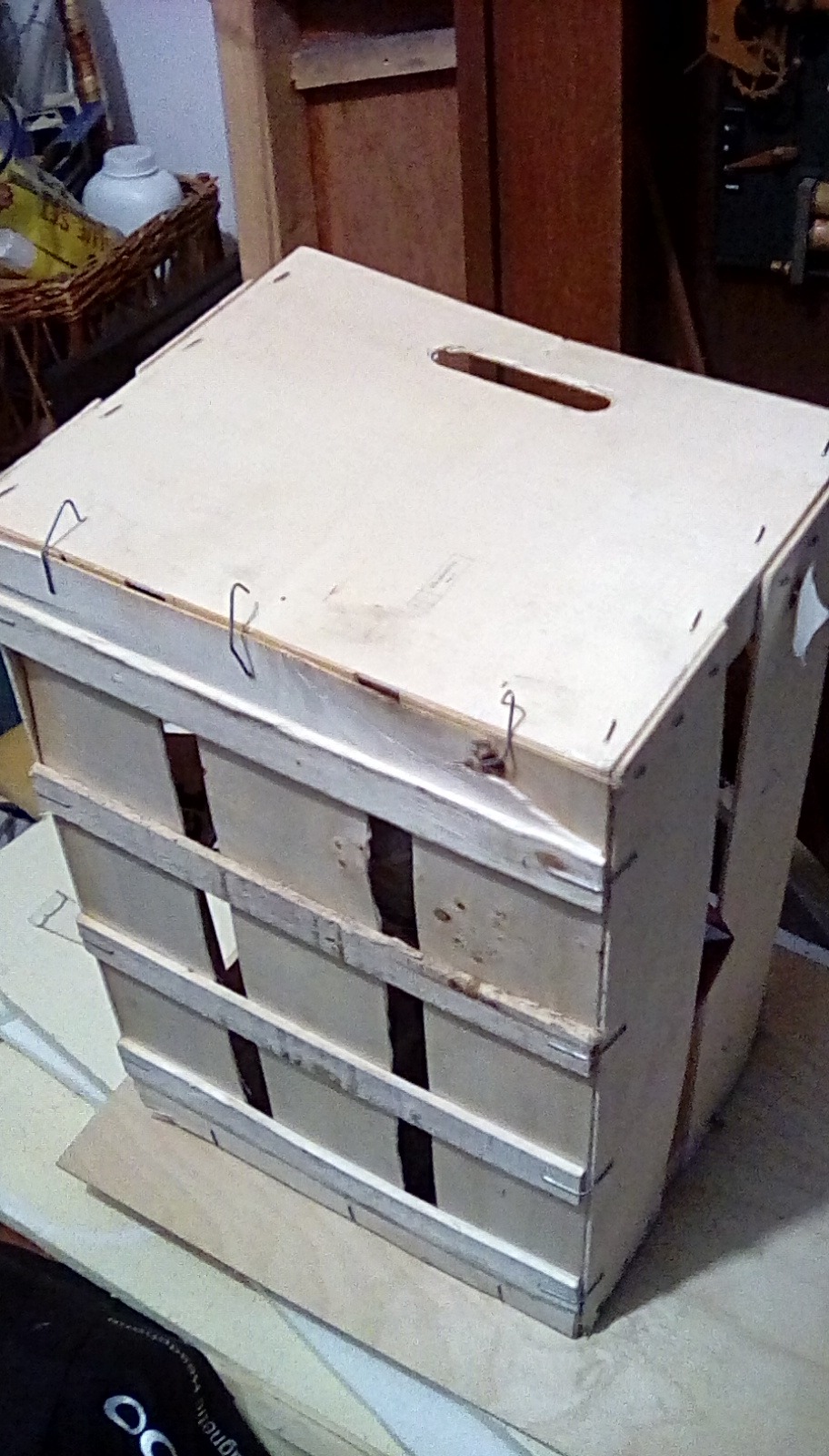

I have just gone mad , and pulled apart my art canvas panel so that I can try and attach a larger panel.
I had to cut out the old small ply panel as the pva was not going to let it go without damaging it anyway.
Hopefully the panel will be dry enough tomorrow to glue the exciter in place.
I found an old crate that had 2mm thick sides that fitted nicely after cutting.
I know it's not great quality , but will do for testing to see if the low frequencies improve ?
Steve.
