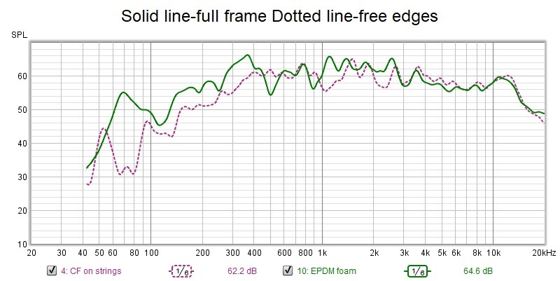

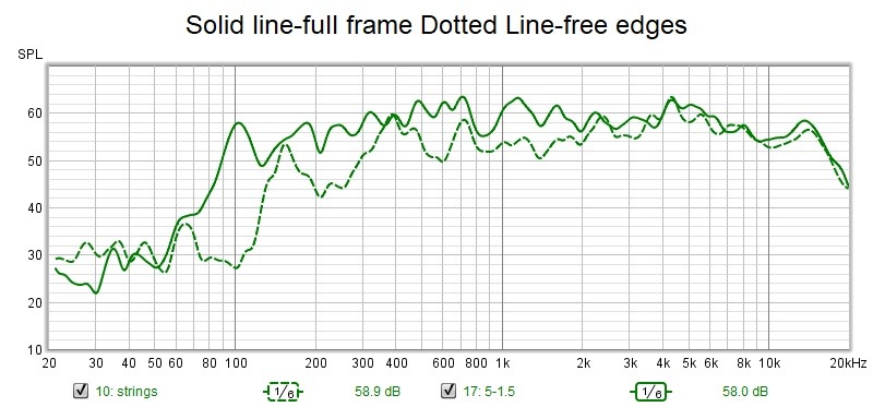

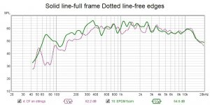

For me, so far the best constraint seems to be attaching the panel to a rigid frame around most or all of the perimeter using a double sided foam tape. This approaches what engineers refer to as "simple supports" which implies that the edges of the panels can't move (not much, anyway), but can rotate. So the perimeter is mainly like a hinge. I think this is effectively what the Tectonic supports do, although their combination of rigid and compliant supports may be more nuanced.
Here are two examples comparing panels with frames and foam, compared to the same panels hanging from strings (free edges). In both cases the biggest difference is at the low frequency end, where the framed panels provide much greater output than the free panels. At higher frequencies, the responses tend to converge. The first is for a 16"x23" CF/balsa panel, and the second is for a 14"x48" plywood panel. In both cases, the same exciter was used for both test, and the amp was set to the same volume, and the mic was placed at 1 meter. I have done this many times and see pretty much the same thing every time.

Your frequency plots show clearly that the foam with frame is louder.
The ply panel is much louder below about 3k.
The cf panel only below about 400hz,
The problem with using foam is that it softens the dynamics .

Rigidly mounting my ply panel has the effect of strongly reflecting the waves back into the panel, increasing the dml on the panel.
The 3mm ply is more flexible than the cf so is probably affected more ?
You have to be careful though, reducing the size of the 3mm panel started to make the panel sound more screach -y , like glass ,the panel was getting too rigid !
Holding the panel at the edges gives the panel a more warmer sound as it fills in the dips in the 200hz area , small weights at these points does improve fr, and I used this method on my rigidly clamped panels also.

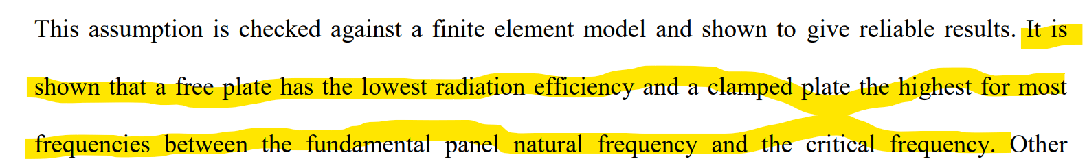

Now I recall at least one source of that information: it was this paper:
https://eprints.soton.ac.uk/369232/1/Eprints.pdf
where they say:
But the caveat is (as Loeb pointed out), the the clamped plate has a higher fundamental frequency than other boundary conditions. So while it might be most efficient above its fundamental, its fundamental is higher. So there is a trade off. My experience so far is that a "simple" boundary (i.e. like a hinge which limits displacement but not rotation), rather than clamped is a pretty good compromise between high radiation efficiency without driving the fundamental needlessly higher.
Eric
