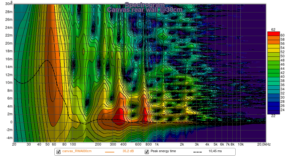

The exchanges at the end of December raised questions that led me to do some testing.
I think it could interest some of you.
Basically I wanted to see :
Some results are expected, others not!
Christian
Christian
- The frequency response of my canvas panel compare to an OB of same size made with a Visaton FRS8 (one available at home...)
- If it is possible to see something about the phase of the front wave and the rear wave of a DML compare to an OB
- If it is possible to see the effect of a rear wall for the panel, for the OB.
- Frequency response : the frequency response of the panel clearly extends to the bass, not the OB. It was expected but better to see for me. The proximity measurement shows even a very good response. For now I don't explain the dip at 150hz seen at 75cm. Not present in the proximity FR, it seems to be a kind of boundary effect (recombination of the front and rear due to reflections). I found similar things with other panels (loss of low freq level due to the boundaries). An additional test shown it is not the floor. Additional investigations are needed (outdoor? extrabaffle?)
- Front wave / rear wave phase : at least for the primary emission (if secondary exits!), I haven't found waves in phase for DML. DML and OB behave about the same with the rear wave out of phase. The canvas DML has even the propoerty to have a rear FR very similar to the front. This is probably due to the low masking of the exciter compared to the FRS8
- Rear wall influence : the tests where done for different distances (1m, .5, .3, .2, .1, .05m). I had first a look to the FR (without windowing) where we can see peaks linked to the rear wall distance. The 30cm standard is confirmed to be critical... Using the spectrogram function (wavelet 1/6 octave) make clear the reflections. If we just look at the FR, the peaks for the canvas are a bit higher than the OB ones. The canvas has perhaps the advantage to keep the reflections more consistent with the main signal than for the OB. So for now with this test nothing to explain the reputation of a better behavior of the DML against the boundaies. It is perhaps just written in the basic DML characteristic which is its low directivity. One result of this test for me is the use of the wavelet spectrogram to visualize the reflections (I attach on here in addition). I like the wavelet analysis because I understand it much well than the FFT and it is close of how the hearing works. The difficulty is to understand which value to focus on as it gives an amplitude versus time (FFT gives only on value but masks the time).

Steve,Just made some quick measurements of the panel ,one with the panel edge close to the ceiling as in the photo and one with the exciter side up close to the ceiling.
The microphone was lying on the listening area seat and the panel was about 2.5m in front, but on the ceiling.
The roll off in The top end is more to do with the CD and mic position.
Steve.
I think you got the same type of FR the one I got testing the influence of the rear wall (see #4311) with the effect of the rear wall bounces.
In the same post you will see also the contact of the canvas with a wall by the edge doesn't change a lot the FR. In my test it wasn't a vertical wall but the floor.
Christian

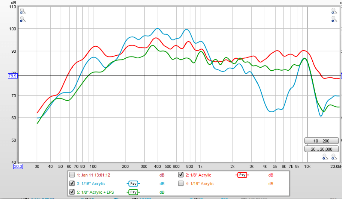

The thinnest I am seeing around here that's easy to get is about 2mm thick. Next question is where to put the exciter. I imagine the plexiglass sandwiched between the EPS and exciters would work best. I'm gonna run to Home Depot today and give it a tryWhat I imagine might work would be an EPS core, with plexiglass skins on both sides. But the plexiglass skins would have to be pretty thin, like 0.5 mm or less, I think. Much thicker and it wouldn't be much different from solid plexiglass, I think.
Eric
Why not just use aluminum flashing as the skins? You can get it very thin. You can trim it with a router. You can probably use contact adhesive to fasten it to the EPS.The thinnest I am seeing around here that's easy to get is about 2mm thick. Next question is where to put the exciter. I imagine the plexiglass sandwiched between the EPS and exciters would work best. I'm gonna run to Home Depot today and give it a try
Maybe this is a dumb question........... but what is the point of the skins? I'm not trying to be snarky; I'm genuinely asking. I am only looking to combine materials in the hopes of getting the best properties of both.Why not just use aluminum flashing as the skins? You can get it very thin. You can trim it with a router. You can probably use contact adhesive to fasten it to the EPS.

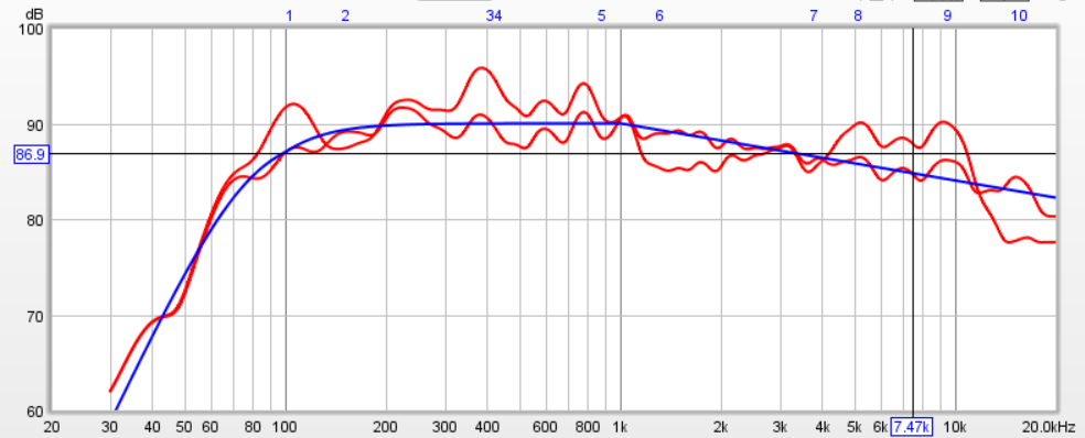

Speaking of which, I just tested (all 18"x24"):
- 1/8" acrylic alone (red)
- 1/16" acrylic alone (blue)
- 1/8" acrylic + 1" EPS (green)
Here is the 1/8" acrylic alone:
Not shabby at all. With very reasonable filters it looks like it will be able to get pretty smooth with EQ (sorry for the red on red):
I can't connect this to my DSP at the moment but I'd be the "life" I was looking for might come from the ~7dB boost from 10k up. More importantly, it will be so nice to not have my sub filling in all the way up to like 250 hz. It's annoying for stuff like panned toms to get all scrambled because of the higher bass coming out of the sub. I should be able to set my sub's HPF around 70-80 Hz which will be great.
Oh and even better- with the Aiyimas I can screw/unscrew the mount and bolt the exciters directly to the panel. Hopefully that will help with efficiency and response. I just hope this performance translates well to the listening space. I think with enough exciters, watts and EQ these could possibly do "bookshelf" full range.
A word on the 1/16" panel- it was way too flabby. 1/8" is a lot more rigid. Seems to help a lot with taming resonances, albeit at the expense of efficiency. But like I said... watts are cheap, and so are these speakers.

My second panel was a 9mm XPS 50x60cm PVA coated (so light and flexible) and I got from it a FR similar to your 1/16" : a kind of bad bandpass. No bass, no treble. If somebody has explanation/hypothesis...
The 1/8" is surprisingly flat for a panel close to a "wall". What was the mic distance for your measurements? Would you share the Impulse Response and the spectrogram of this one (wavelet, 1/6oct as REW proposes. See my post 4313).
What is the weight of such a panel ? 1kg for 18x24x1/8?
Christian
I think part of the good low end was the panel basically being on the floor. Still, the 1/16" looked a lot like my EPS panels when I measured them long ago, so I think there is something to this thing's heft. It def feels hefty... Amazon says a sheet like this is about 3kg which seems nuts but not too far off.Interesting!
