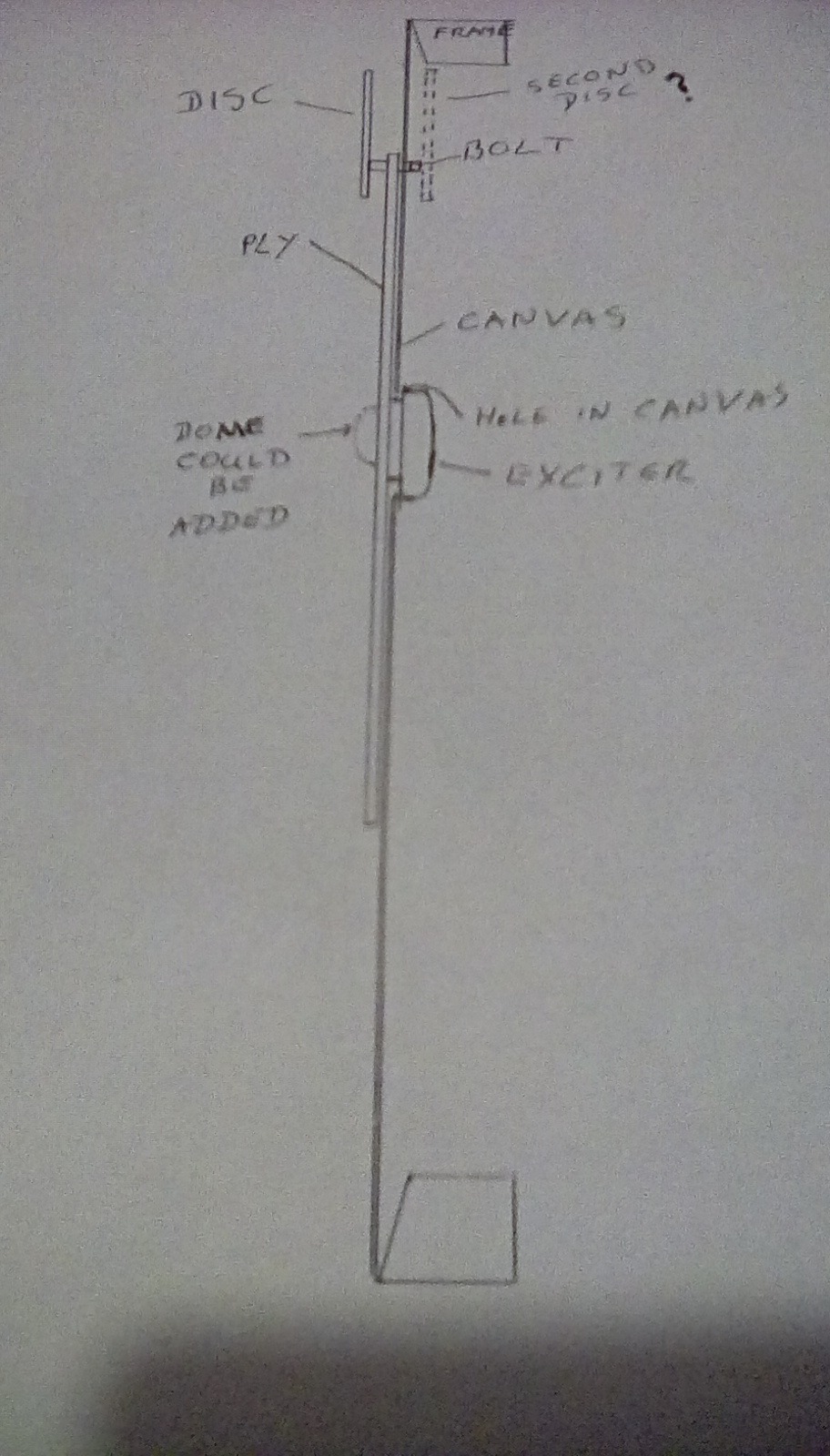

A drawing to show the alternatives I mentioned.
Hope this helps.
Steve.
I'm not saying that bolting the disc to the panel would be any better or worse, just interesting ?
the more of the disc that is glued to the ply the more the ply will damp the disc and vice versa.
having the disc with a small bolt may cause the disc to vibrate too much , or even ring ?
but it is easy enough to test.
If the disc is needed or not is a matter of taste ,I should think.
Steve.
